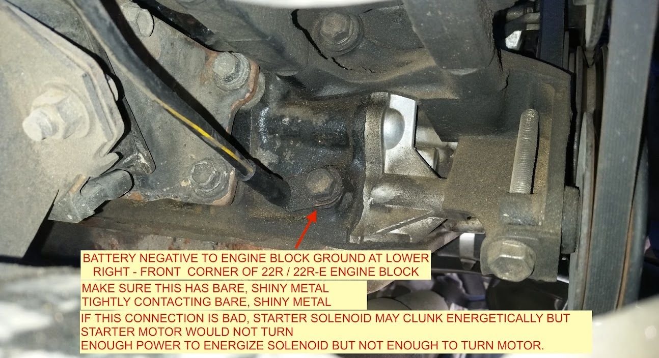

AND check to make sure you have a good engine block ground:

That is because the starter solenoid is not actuating ENERGETICALLY and does not completely close the contacts because of power loss on wiring, etc. Adding a starter relay will fix that.
