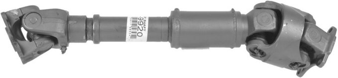

Originally Posted by xxxtreme22r
EDIT: dang there was another page, haha. Oh well, at least some of you guys know what a gimble joint is though now.
Some of these things came factory with 31 x 10.50's from the factory, your fine.
Oh and the joint your talking about is normally called a Universal or Cardon joint in vehicle world. I suppose in the industrial world you can call it a gimble joint though.
Gimble Joint
Cardon/Universal Joint THe joint all the way on the left is also called a Double Cardon or CV joint
Not to be confused with this CV joint which is a drive axle not a driveshaft like above.
