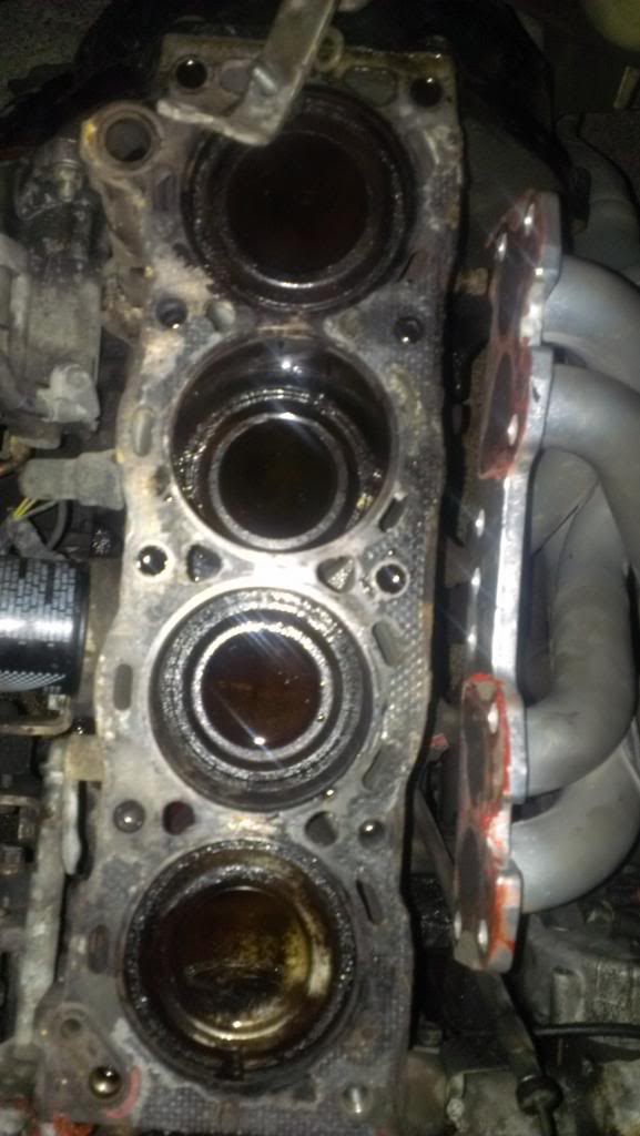

Old Nov 24, 2013 | 09:03 AM
catfish21's Avatar
Joined: Feb 2013
Posts: 447
From: baton rouge,louisiana
http://s1358.photobucket.com/user/wi...bd3cd.jpg.html
Before I cleaned up everything

Look how fancy
