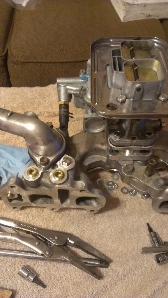

Yeah I'm doing the complete emissions delete well I already had it but some of the plugs were leaking a little so I wanted to change them out but I managed to get them out with a propane torch and wax so that went well and the triangle piece us that spacer they use from the factory for the air compressor mount you want have it unless you have factory ac. I was able to get a good bit done today got the oilpan installed changed some hoses and got my intake all clean with new plugs so tomorrow morning I'm gonna bolt the ol head on and just pray that I do it right this is my first major job so its a learning experience for me the whole way but it's went pretty good up to this point

Old Nov 29, 2013 | 06:52 PM
  #45
catfish21's Avatar
Joined: Feb 2013
Posts: 447
From: baton rouge,louisiana
http://s1358.photobucket.com/user/wi...438fc.jpg.html
This is all the emissions delete stuff plus some progress
http://s1358.photobucket.com/user/wi...256fb.jpg.html
http://s1358.photobucket.com/user/wi...c4afd.jpg.html
http://s1358.photobucket.com/user/wi...d73f2.jpg.html
http://s1358.photobucket.com/user/wi...11fa9.jpg.html
http://s1358.photobucket.com/user/wi...ba459.jpg.html

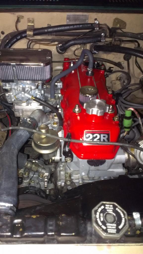

Old Dec 1, 2013 | 04:01 PM
  #51
catfish21's Avatar
Joined: Feb 2013
Posts: 447
http://s1358.photobucket.com/user/wi...0fcdd.jpg.html
Here is a pic of the finished product and man I was nervous to start it but when I did it ran like I've never heard it run before PERFECT it is so great to know it's all new now and it is so quiet now with no ticking noise, I'm just very pleased at what I done for my first major job like this, and the 261 cam from engbuilder I can't really tell a difference from the stock one so Idk maybe I'll find out when I pull my boat if it helps with that. I do have a question though I filled the radiator with red coolant and water and ran the motor for a while then added more coolant but I'm not getting preasure on the upper hose the heat is working ok but now great, what do I need to do to get this right I'm stuck its not running hot and I did test the thermostat to make sure it work so I'm lost now with that but other than that.it's great

Old Dec 1, 2013 | 04:19 PM
  #52
HighLux's Avatar
Joined: May 2010
Posts: 2,587
From: Ofallon Missouri
get the front end high up as you can to get all air out of cooling system. Pop the cap off....run it till warm with cap off....top it off....keep doing till its full.
And GRATS. I told ya you could do it!! Feels great doesnt it?
Old Dec 1, 2013 | 04:21 PM
  #53
HighLux's Avatar
Joined: May 2010
Posts: 2,587
Just clicked the picture....that looks awesome....Ill fix it one more time....lol

Old Dec 1, 2013 | 04:27 PM
  #54
kawazx636's Avatar
iTrader: (3)
Joined: Jan 2012
Posts: 3,218
Likes: 26
From: Salisbury, MD
The system needs to be "burped" to get the air out of the coolant system. Just let the engine cool completely (don't do this with a hot engine as it will overflow and likely burn you) and take the radiator cap off. Start the engine and let it run. You'll see some bubbles work up and out. Keep adding fluid as it burps. Should take just a few minutes to get the air out.
BTW, Engine looks great!
Old Dec 1, 2013 | 04:29 PM
  #55
catfish21's Avatar
Joined: Feb 2013
Posts: 447
When I leave the cap off water wants to pour out the top I'll just keep messing.with it I guess thanks for the help through this project to
