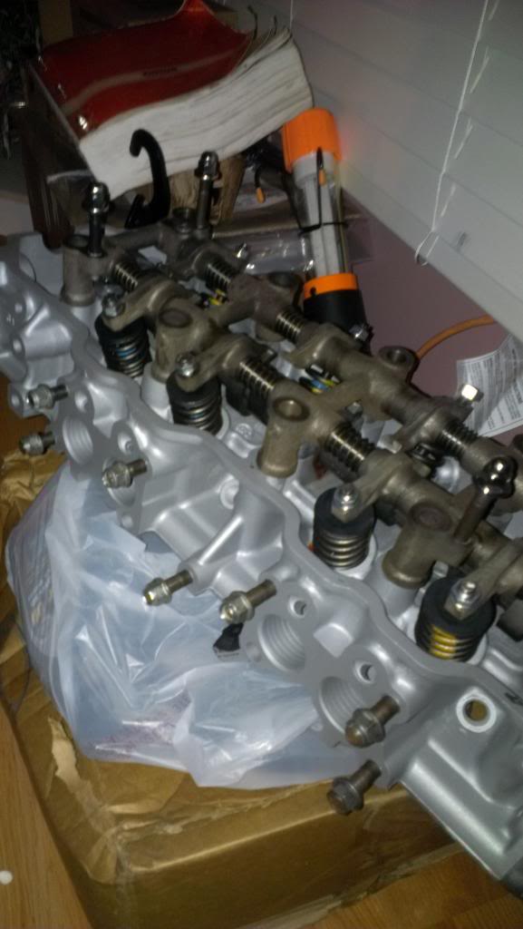

http://s1358.photobucket.com/user/wi...5fb06.jpg.html
Ok here you can see how it looks well the bottom is shiney metal everything else is that gray color but he did mill the intake and exhaust its like its paint but its everywhere in the ports and all AMD Idk if I should sand it off the gasket surface or leave it

This looks like a clean head to me. There's no paint. It would be pretty silly for a machine shop guy to paint your head without asking, and without charge.

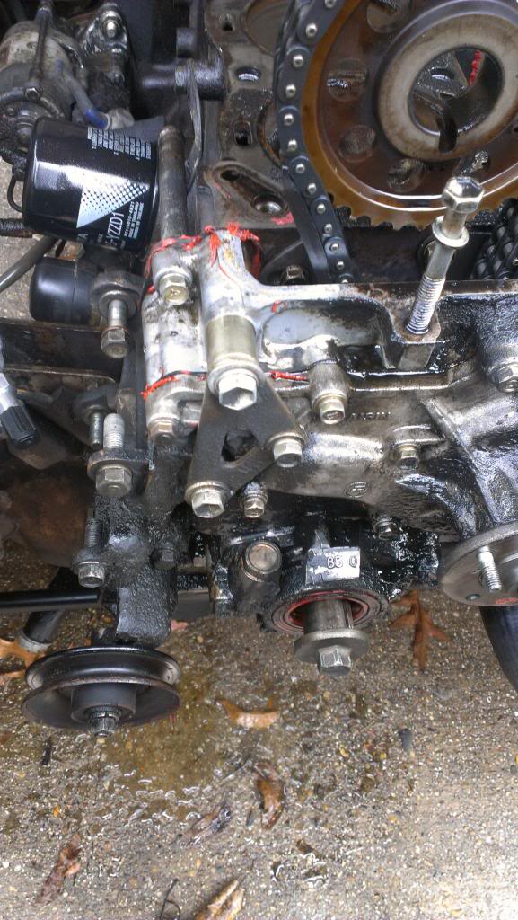

Looking through your photos...good thing you're doing this work. Your engine looks like my 83 did. Whoever was in there last thought if a little rtv is good, a TON must be great. They even used red on the exhaust manifold! Wow.

Yeah they did a horrible job it was all inside the cover in the water passages everywhere I'm going to be so much cleaner with mine I'm gonna start tomorrow tryin to get her back on the road if I can stand the temperature it in the 20's and wind is bad and yeah I have just a phone I don't have a computer maybe the wife will surprise me for Christmas but I'll get some pics up when I'm cleaned up and my process and maybe you can post them for me
