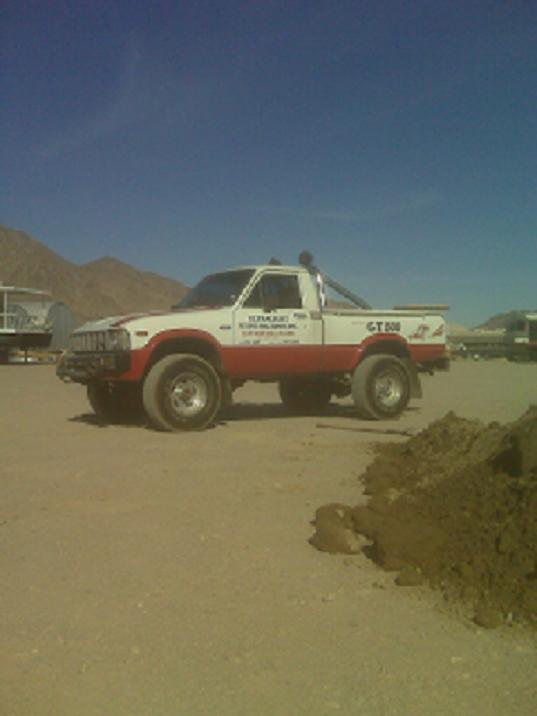

Hello all.......My name is Chris. I've follwed the Yotatech forums here for years and gained much useful insight and many ideas to help influence my trucks. I have recently aquired a fairly clean 1983 4x4 and I am currently rebuilding this truck. I am going to attempt to post pictures and short descriptions as I go. (I'm no computer whiz.) Any questions ask away.
My 83 as it appeared when I first purchased it.

Okay, a little delayed, work has been hectic, but here is a quick update on the progress so far.
This is my 83 as it looked at the time I purchased it.
Engine removed for rebuilding. Future...engine bay will be stripped and prepped for paint.
The truck originally had business logos and info painted on. I removed all of this with 1000 grit wet sanding and plan to buff the paint in hopes of restoring it.

looks like a great base for a build
I notice the towbar mount. I hope the rear driveshaft is removed when flat towed.
According to Marlin the transfercase doesn't get lubed properly when flat towed, the oil in not slung around properly on the output shaft. It is still spinning even with the TC in neutral...
And I have personal experienced...learned the hardway

Did not know of the transfer case flat tow issue. Definitely an issue to look into. I have the t case seals, may look into output shaft bearings while I'm there to be safe. Rather buy bearings than a casing. I know that the rear drive shaft wasnt removed, no way around checking now. Thanks for the info!
