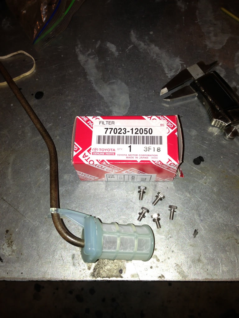

  4. Check your fuel pickup tube/sock. The whole assemble unbolts from the top of the tank (mark your fuel lines as you take them off) and it is possible to get it out without dropping the tank. Sometimes the fuel sock gets clogged. The part number is 77023-12050 and is available at the dealership for something like $20. Here's a picture of it:
  5. Check your fuel tank for debris. Take of the tank skid plate and you'll find a drain plug. Drain the fuel out into a bucket and look for rust scale and other debris. If you have debris coming out of your tank then you'll want to drop the tank and get it cleaned out. You can drop a handful of screws in the tank and vigorously shake it until you can't lift your arms to knock off any rust scale. Usually, this is good enough, but there are gas tank sealers out there that you can use although I've always been weary of them. If you have old fuel in the tank, you'll definitely want to drain it and toss it. As the ethanol in modern fuel breaks down, it attracts water and creates large particulates that gum up engines and fuel delivery systems. Rinse the tank thoroughly WITH GAS. Just grab a gas can with a couple gallons of fresh fuel in it and run it through the tank until no more debris comes out. When I cleaned my tank, I used a coffee filter in a strainer to strain the fuel as it came out of the tank so that I could run it back through again if I didn't get all the debris out.
