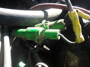

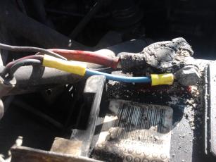

you might want to check your fusible links by the batery and there conectors, these pictures are the ones on my 83 toyota truck the one wire link did kinda what your talking about it would click and then kill the bat, the 2 wire link would kill all power to everything. jumping the starter would still turn it over but it wouldnt fire.

on my truck when the one wire fusable link was bad it acted as if it was a fualty ground or a grounded power wire. you would turn the key, starter would click once and kill the battery.
