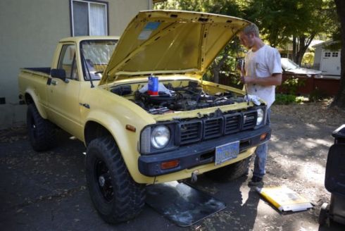

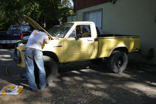

heres the truck
Attached Thumbnails 22r dies in the morning-truck.jpg   22r dies in the morning-download.jpg
