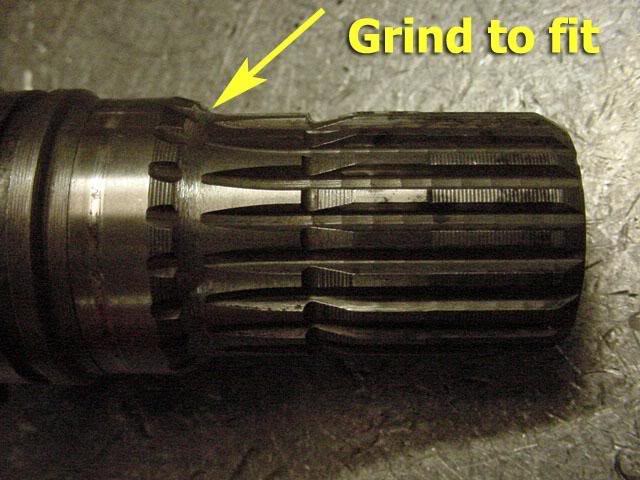

The spline issue is with the t/c splines, on some 79/80 transfercases

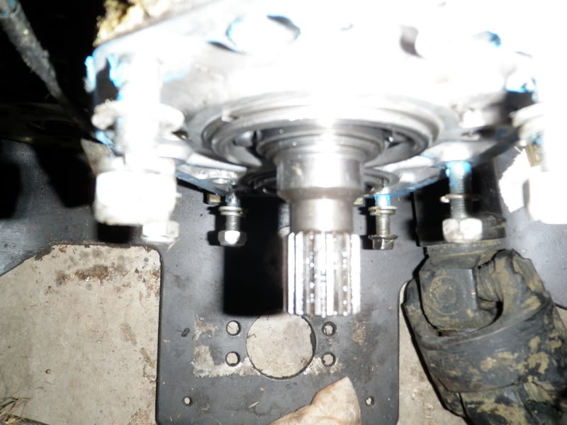

if your t/c splines look like below, you are good to go:

Any time. I ran into this issue on a t/c i pulled out of an '80 parts truck. Big Mike of Marlin Crawler either posted the top two pics here or I pulled them from Marlin's forum a few years ago. This question comes up every now and then so I went ahead and saved'em..
