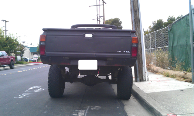

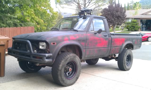

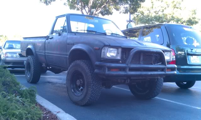

l'm running 31's on mine. They seem to be just right to still get around town with stock gearing. l'm pretty satisfied with them for a stock setup.
Thuroughly impressed by the randomness of those shots.. a different parking space for every angle!

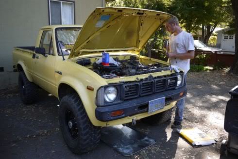

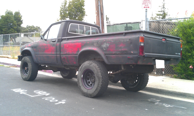

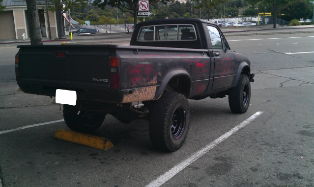

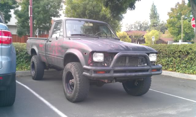

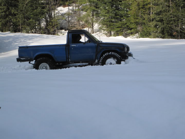

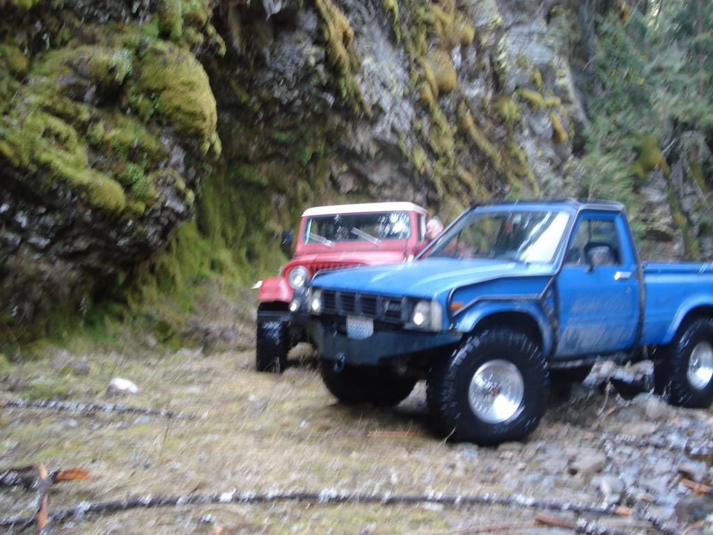

heres mine not the best pics its a 1980 with 32inch tiresName:  truck.jpg
Size:  30.4 KBName:  download.jpg
no problemo (i got a 22r from an 81)

Nice truck foolio. Look just like mine before I did the 83 headlight/grille swap..... looks to be pretty rust free?
Dude. Hell yeah!
Thanks so much for posting those pics. I'm jealous..

yea its pretty incredible how little rust there is. you got rid of you're round headlights? i think the round headlights are badass.
