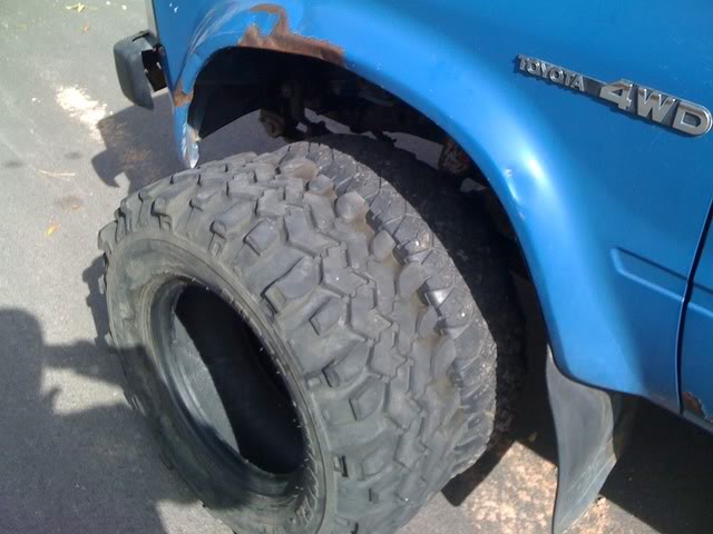

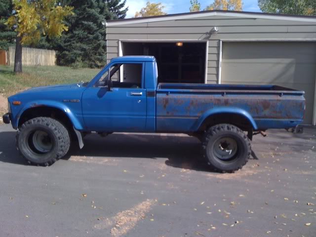

Here are the tires.. they're Interco TSLs.. pre-current models I'm pretty sure; vintage. Honestly the tread seems nearly new as far as depth.

I'm definitely going to need some rims for these though But at least there is someone else out there running massive spacers! I'm really going to avoid it if at all possible, but it is an option.
I'd like to go back to the steelies and put some 34x9.50 Narrow SS Intercos on it at some point. Apparently I just want it to look like a duece and a half haha.
