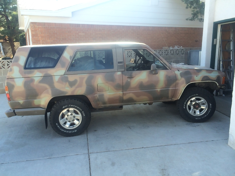

So finally got a new toy! always wanted a 1st gen so here it is! Not sure about the odd faded.... pink ish camo??? I kinda cut up my DD so with this build I'm gonna just keep it simple and will leave the plasma alone..... I hope.
Probably going to start with the 3.4 swap first. I will update as this progresses.

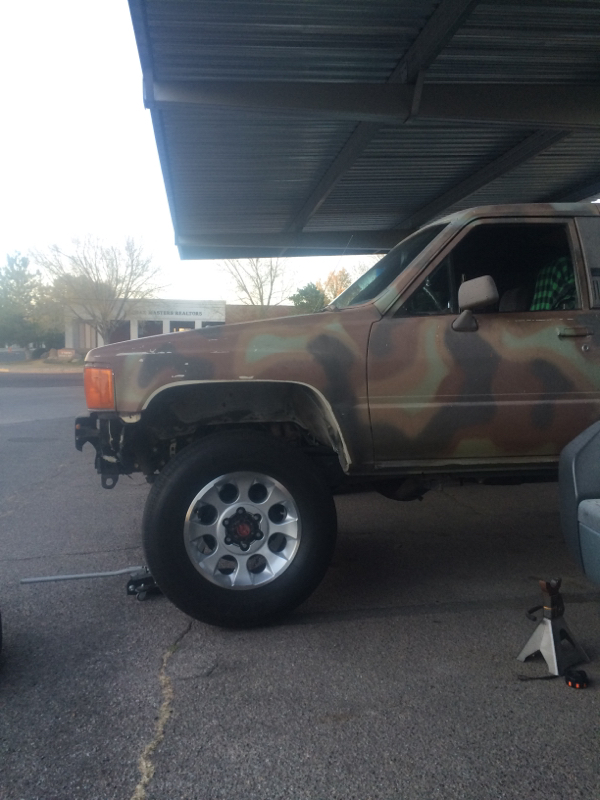

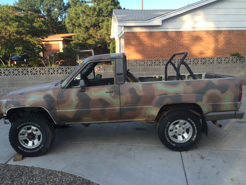

I don't have to cut the top on this one!!!! This thing is sweet!
Attached Thumbnails TheBack40 89 High Desert Runner build & 3.4swap-image-989009452.jpg

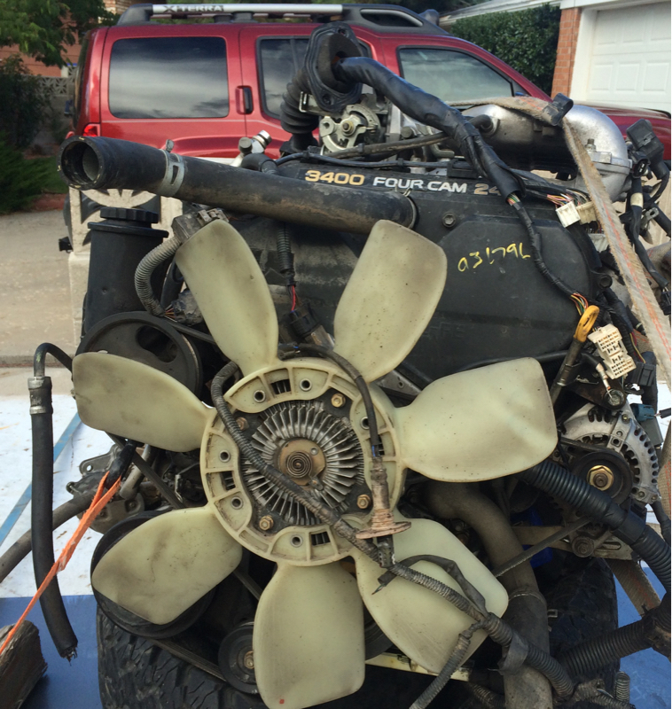

1996 3.4 M/T with harness!!!!!! Ecu, air box, O2's, 5 plugs, and some other odds and ends.

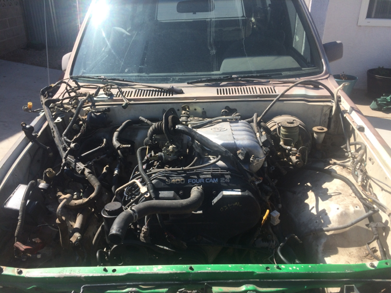

Old POS in rig
Attached Thumbnails TheBack40 89 High Desert Runner build & 3.4swap-image-119727415.jpg

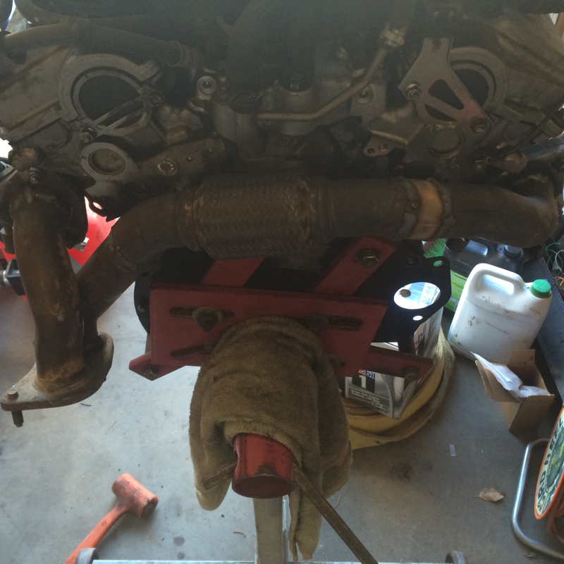

Old POS removed from rig
Attached Thumbnails TheBack40 89 High Desert Runner build & 3.4swap-image-3225065650.jpg

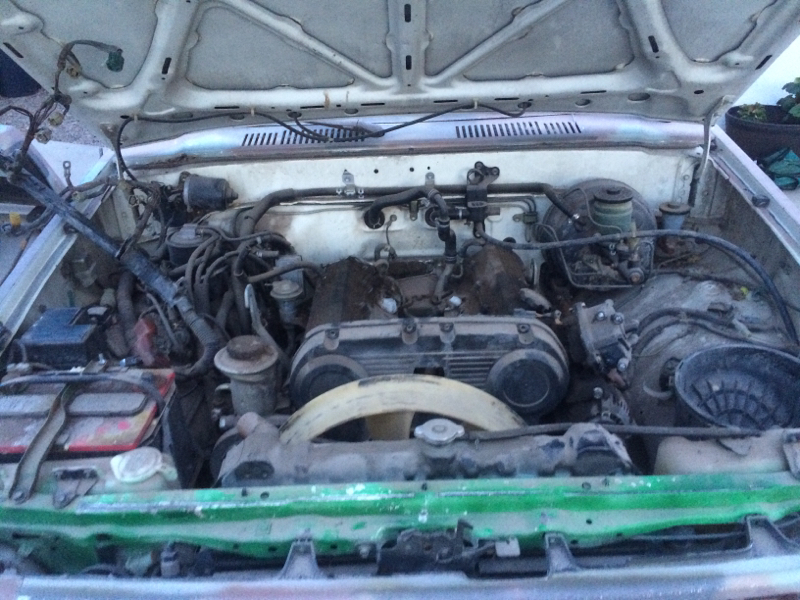

Filthy engine bay. I will fix that later.
Attached Thumbnails TheBack40 89 High Desert Runner build & 3.4swap-image-2094201690.jpg

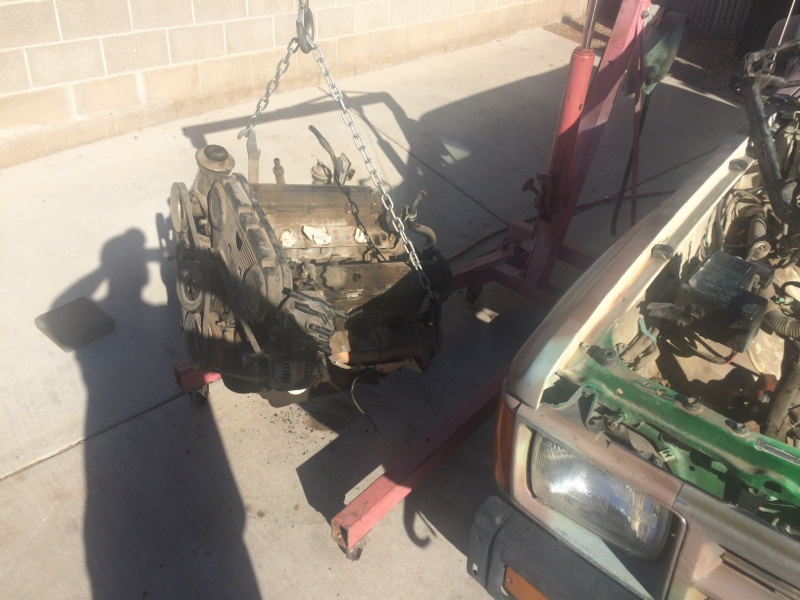

New 3.4 in rig!!!! Now onto the wiring and such. Reused the 3 liter pan, dipstick and tube, pickup tube, alt bracket, and a/c head.
A small tip here would be to use the old driver side hoist hook off the 3.0 and bolt into a vacant bolt hole on the pass side 3.4. It worked great for the swap but only one bolt made me a little uneasy. I will mod it so two bolts can be used and re install.

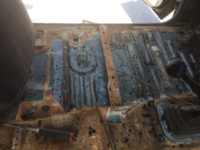

While I'm waiting on the EWD's I thought I would prep the inside for some bedliner. Took all weekend to hammer out the sound deadening black tar. Did it with a hammer and chisel. If I had to do it again I would have used an air chisel.

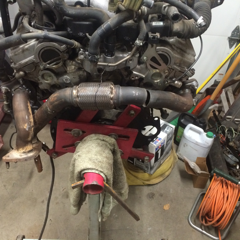

This the old crossover chopped up and reconfigured.

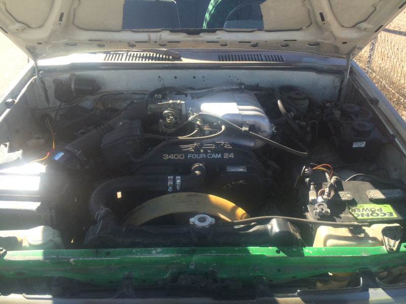

3.4 in and running! I can't believe how much nicer this engine is then the 3.0 or 22re!! This thing is a blast to drive! It even passed emissions!
