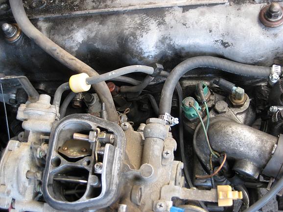

Hey guys havent been on here in a while but wanted to thank you guys and gals for all the help and I did try out the octane booster and it still didnt help, I actually picked up another yota 88 actually and swap the fuel tank and carb over and what not but I got confused with the vacum lines. I attach two pics of how my vacum line is set up in my truck, please let me know if I got it mixed up. =(

Are you saying you put the 88 tank & carb on your 81, or what? Get the vacuum diagram for both models.

yes I switch the carb and tank over but got confused how the vacum lines are set up with that upper diagram, the truck currently doesnt have any smog equipment on it
