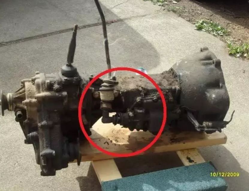

Are you sure it's an 80? your grill/headlights indicate 82 or 83.. but as you know people do all kinds of crap to trucks over the years
there were 2 4 speeds available in the 1st gen trucks,
the L43 side shifter and the L45 top shift. Shift pattern was the same for both
1 3
2 4 - R
something like this.
If you have the L43 side shifter it is probably pretty dang sloppy. They suck, not a lot of parts available but from your post it sounds like you have
the L45
you can try to tweek the shift levers by bending them, don't attempt to do it with them mounted in the case.
I had to dog leg the t/c selector (cut and sectioned a bent piece) in my 81 when a transmission I ran for awhile was so sloppy due to interference between the levers, shift to 2nd or 4th and it would kick the transfer case out
