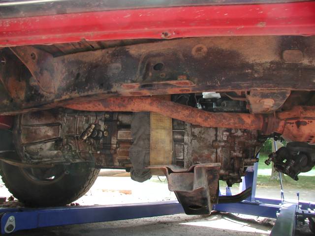

Take a couple of 1" tie-down straps. You can support the rear of the transfer with it while you are pulling out the cross-member. The second one is so that you can support the rear of the engine with it while you pull the tranny/transfer.

Floorjack
JackstandsX2
Tranny adapter
Other than the $52 for the tranny adapter, everything else would be multi-purpose.
