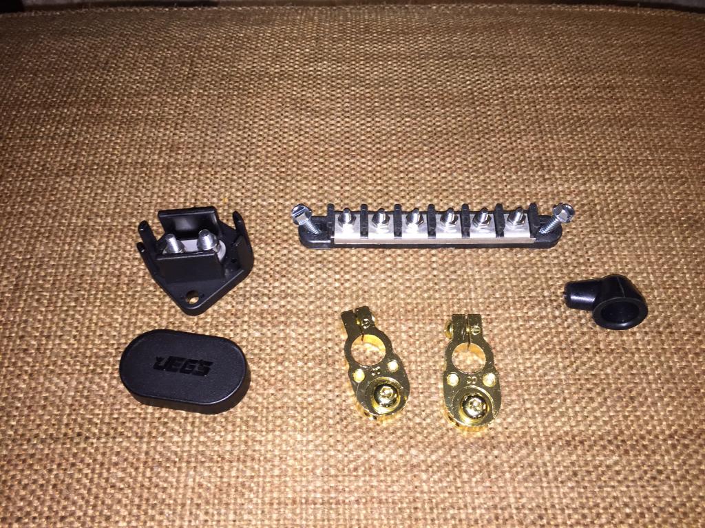

Here's the power distribution block that I used (on the left), new battery terminal post connectors and ground bus bar (top right) to organize my accessory grounds (radio, gauges, lights, etc):

Here is how everything is mounted and wired in. Red 8ga wire comes from the positive batter post and the 3 fusible links connect to the corresponding protected circuits. Ground bus bar is to the right.
