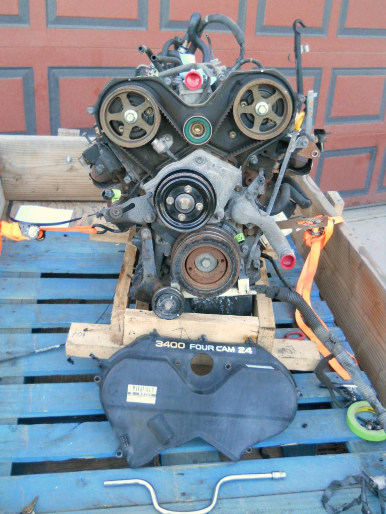

With 203,000 miles on my ever faithful 94 MT 3.0, I figured since I had the cash I would source a 3.4 and take the plunge into more power and of course better gas mileage then the 12 mpg I was enduring with my 32" tires and the gutless 3.0. Now, if I can just keep the head gasket from blowing before I have it in I will be a happy camper.
So off I went and found a 97 donor with 97,000 miles, a 97 MT ECU and the plugs. The yard said it would not have the harness, but I suppose they decided to include it plugs intact. However, they said it would be the complete engine, but looks like I will have to swap over the needed parts and get the brackets for the alternator and the MAF. I figured I would leave it wrapped for now.

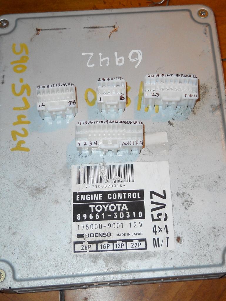

Man those plugs look huge!! Now it is off to get all of the diagrams I don't know how to read, and the service manuals. I might just get lucky with the excel doc from the 3.4 swap 101 post but will have to double check things. :-)
They said it had a tick, so I am assuming it will need a valve adjustment or perhaps the flex plate was cracked in the other tranny. Who knows. I sure hope it doesn't have a spun bearing or something else. I will check the valve clearance just in case and hope it was just the flex plate it they are in spec. With the mileage, I might just get lucky with the timing belt and find a new one in there if it was changed at 65,000. At $1250 shipped, I figured I got a decent deal if it is only a valve adjustment...........crossing my fingers!!!!
I will admit, this is WAY out of my league of experience, already I have a headache thinking of the problems I might have. Thanks to the fine write ups by several people, I am optimistic it will be a success. If not, I have toyonlyswaps south of me to bail me out as a last resort.

Yup, taking the plunge by re pinning it myself....I have time to learn and with the harness now off the engine, I can do it inside on the kitchen table. Being single allows me luxuries like that. I still don't quite understand the dash harness wiring as I haven't read that part covered. hmmm

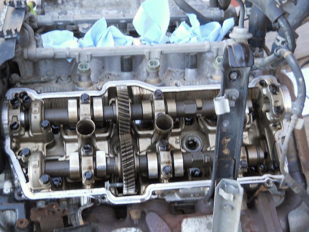

Well, I took the time today to tear into my 500 lb. paper weight as I was told it had a tick. Figured it was in need of a valve adjustment, I wanted to change the valve gaskets while it was out anyway, change the timing belt, H20 pump, bla. bla, bla...so..., off came some parts.
Was really happy to see how clean it was under the valve covers for 97,000 miles.

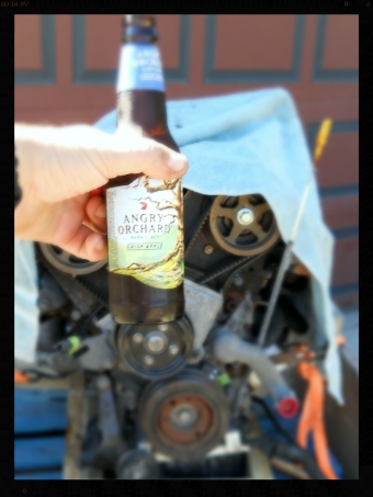

Happy Labor Day
Well to kick off this post, I would like to wish you all a happy Labor Day in style! Yes, I was one apple cider short of a six pack as usual.
For this post, I would like to give credit to PismoJoe for his write up on doing a valve shim adjustment. https://www.yotatech.com/forums/f128...t-tech-226997/ It gave me a good understanding on what to do but I tweeked it as my engine is assembled. I will be sharing with everyone the worksheet I designed that kept things more organized in my head, or should I say, OUT of my head. See next post.
Yesterday I worked on getting the gaps checked and I am stoked to say, I think I found the ticking problem they mentioned at the wrecking yard. First off, I think there is a good lesson here on NOT torquing the spark plugs to 45 lbs like I found in the number one cylinder. This must have been a Monday repair as someone was pissed when they put that one in.
Anyway, it must have created more heat as the spark plug electrode was black in comparison to the other grey ones due to it being closer to the piston. My reading at these exhaust shims were .004in and .008in when the correct clearance should be .014 (.015). Safe to say I found the tick. I just hope I don't have a burnt valve as a result. I'll Sea Foam a couple times through the brake booster hose to clean off the valve stems as there might be a good amount of soot accumulation at this stem. I look forward to the white plum of smoke to fill my neighborhood.
All of the intakes were in middle of the tolerance range, but ALL of my exhaust valves were at or OUT of tolerance range from .004 to .017. (exhaust tolerance is .011-.014 (.015). I will be replacing the 3 shims with a gap of .011 to keep these from going out of spec in the near future since I am in there.
