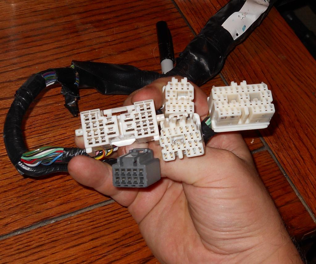

So I decided to take a closer look at the plugs on the alleged 97 4Runner. I am at a loss as it does NOT had an E12 plug. It has the E9 plug, but the other one that should look just like it, the E12 is not anywhere and nothing has been cut.
Since the engine only has 123,000 on the odometer, my only other logical explanation is this engine is in fact as 00 or so as I am looking at when they made the plugs the universal type. I don't know. The only other problem with that is I have another 97 harness from an auto that looks exactly the same.......no E12 plug on the harness or cut wires.
It has the E11, E10, E9, II3 and I think the II1 plug on the harness. If it is the 00 new style harness, am I screwed because I got a 97 MT ECU,.. Insert head bang Emot here!!!!
Any thoughts?

The two body plugs look like II1 (gray) and II3 that was on my 2000 harness.

So you didn't have an E12 plug either huh? wow, this really messes up the game plan if it is the newer style harness, as the wires will be different I am sure...hmmmmm I guess they gave me the wrong vin number which comes back as a 97.
Any thoughts?
That definitely looks like the engine harness off my 96/97 4Runner A/T donor, so at this point it looks like you have the right harness.
E12 (and E8 for that matter) are NOT included in the engine harness, they're in the DASH harness. If you look at the functions of the various connections in those connectors (E8 and E12) they pass signals between the engine/transmission/transfer case and the rest of the vehicle; such as +B (switched 12V), BATT (always on 12V), BK (brake signal), 4WD (to tell the ECU its in 4WD and light the dash light), STA (starter trigger wire...even though its actually on E9 for the A/T), W (check engine light), SP1 (speed sensor signal), and the OBD-II connections.
When you convert the A/T harness to M/T with the M/T plugs, there will be a number of wires left over and a couple that (if memory serves me correct) were connected strangely for the A/T. I was actually able to completely remove II1 from my conversion harness and I believe there was one ABS signal I wanted to keep, so I moved it to an unused pin on II3.
Yeah, I looked at the functions of the E12 plug and thought, "This is one of the most important ones, how could it NOT have this darn plug." Now it makes more sense. Oh man, you made my day! Good Karma to you my friend! I wish there was a sticky that addresses that, and the 3.0 to ecu harness, a bit more in detal. Or did I miss a thread that this is addressed? Elvolta's thread touched on it, but I guess I missed that I needed the E-12 from a 97 donor dash harness. I have the E-8 and other plugs for the 97 mt ecu in hand, labeled, and ready for pinning. Off to the yard I go.

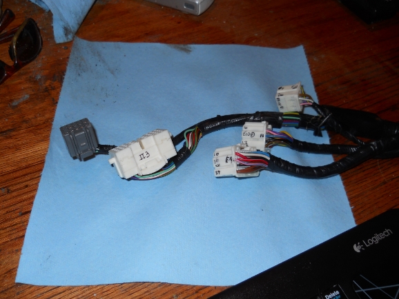

Well, what do you know, I got the engine harness part wired up to the MT 97 ecu plugs. Just two wires go to the E8 plug and the other wires from the dash will go into this plug I guess. I guess the wire 29 from the E9 will get soldered to a wire in the dash part of the harness. 60% done, the 40% I will have to research further. I recall reading about the 2nd gen dash harness and the plugs needed I just have to find it again.......I think it is buried on a thread somewhere. Does 6 wires left over sound about right?

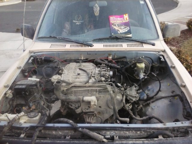

Well, as you all can see I have put this project off as my engine ran and I wanted to just drive it until she was dead. I managed to get 21 more year out of her for a total of 225,000 miles and 12 years of problem free driving. I sure hope that luck continues.
Her demise came out in the woods on a coyote hunt and a shooting trip after a hard rain and a little snow. I could have sworn that puddle was only a foot deep that I rushed trough. Yup, it hydrolocked up and bent the connecting rod due to heavy compression. I pulled the plugs and cranked it to blow the water and a clanking she went.
NOTE:::: If you have done that Air Box mod for more air flow, stay away from water that is more than 2 feet deep and don't SPLASH through it. GRRR
I sure hope people are around still.........all of the posts look very old..... Back to reading as a heat stroke in the Marines cooked my brain and I have a serious case of CRS! lol

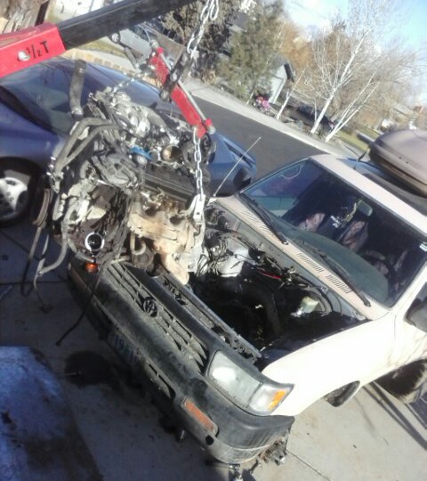

Thanks for the vote of confidence guys. Well, I pulled the engine today as we finally had a clear in the cold and wet weather. Yup, lowering the transmission is the way to go to get the damn top transmission bolt out on the drivers side. Other than that it came out without a hitch.
Tomorrow I clean the engine bay and paint it, move the engine mounts, the oil pan and swap the clutch out as I will just be using all the parts from the 3.0. If the flywheel is ok then cool......if not, I'll take it down to have it turned. I'm thinking maybe I should replace the clutch while I am in there.........hmmmm. Sure will be a pain to get to it again. I'll know more when I tear into it and check for wear.
Baby steps.......
