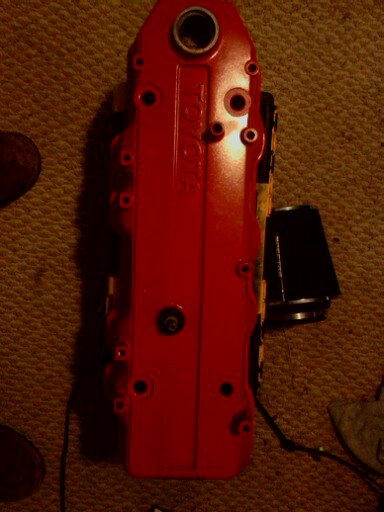

I figured out the issue with the sparks and sloved it.. it was a naked wire for the starter... im a dipward. yes I know.
My next problem is that I have no key for the blasted thing!
any suggestions on how I should handle this small problem?
In other news Ive been giving the engine bay some TLC. Hope you guys havnt forgot about me! cheers!
Gillis
