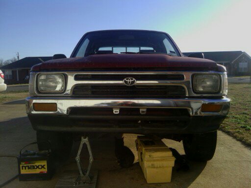

Here are some photos gentlemen.
I looked and found one wire that was connected to the inner fender, next to the fuse box that was just there. Could this be my problem? Also, I double checked the fuses today. My question right now is there anyway to check the larger fuses? like the head fuse and the EFI fuse?
