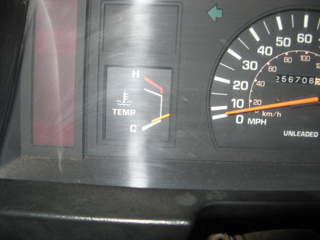

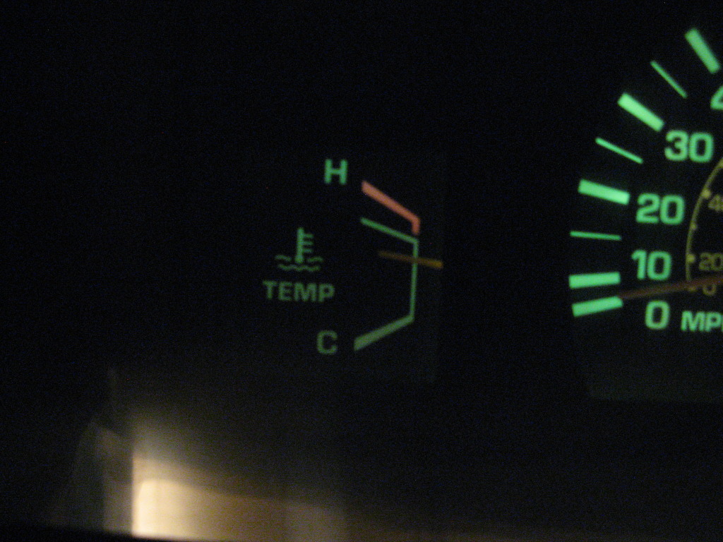

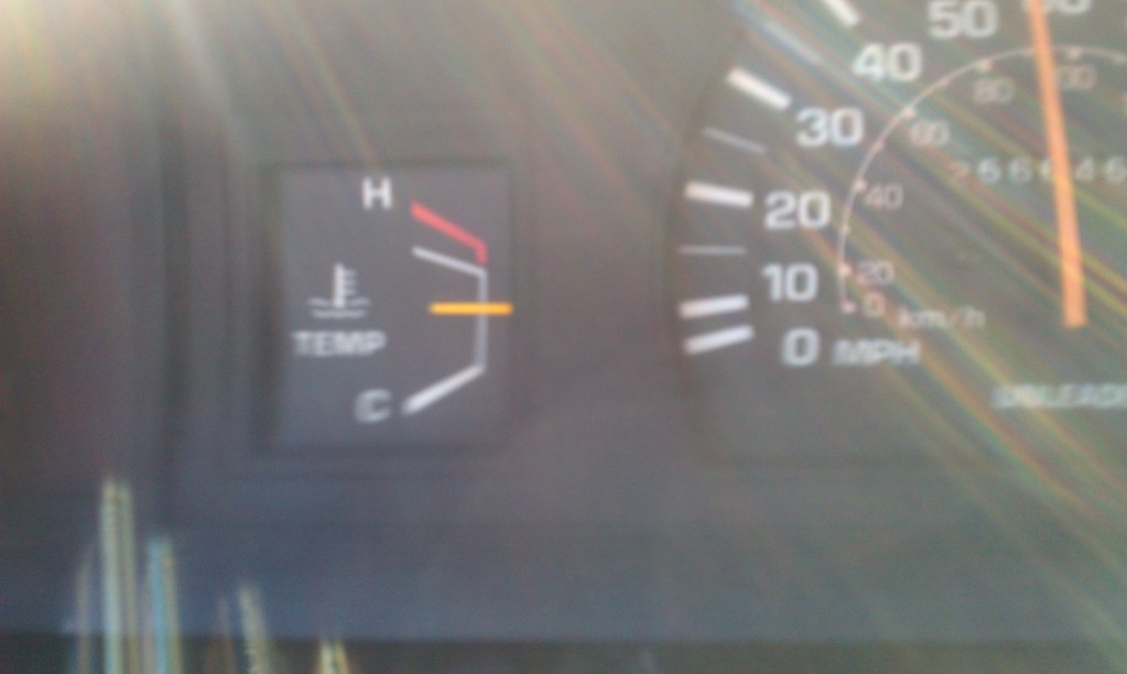

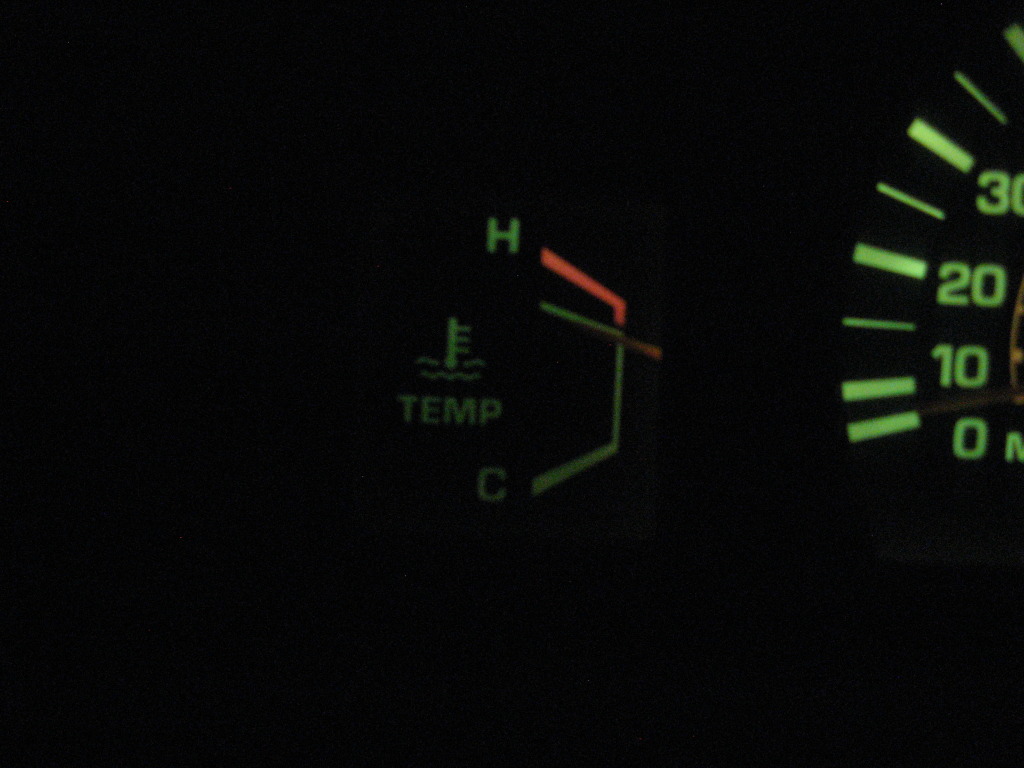

I was having an overheating problem in my 1986 22r, it would be running good temps on the freeway but then if I was doing stop and go with traffic and signals it would get hot. Or if I just let it idle in the garage it would also overheat.
I rebuilt my fan clutch with some 5000 weight silicone oil from the hobby shop ($10). I am thinking I may have just gone with too heavy an oil.
Now that I rebuilt it, it barely registers on the guage. Is this going to cause me any issues running cool? It is running pretty good now but doesnt quite feel like it has the power it did. Is it because of the fan spinning harder? Or due to cool temp?
Here is where it would run on the freeway(pre-rebuild):
Here is where it would climb to if I just let it idle:
Then
It would cool down ok when I got driving again.
Post rebuild here is where it runs now. Even after running down the freeway for 20 miles, it barely gets above this.
Tomorrow I am driving up the mountains with a load in the back and I am going to see how it does. Any input?

Searching around it seems 3,000-5,000 Cst are popular weights to use. You did not overfill it by chance? Overfilling may possibly force the clutch to run full-time and somehow overcool the system...guessing here.
It only takes 1 to 2 ounces (depending on how much you drained out) to refill the clutch.

That thermostat temp. range are you running? It is the t-stat that controls the normal operating temperature. Could be the fan is cooling the rad. off enough that it is getting closer to the t-stat rating and was running too hot before.
yea. . . . ummm you need to look into a thermostat. from toyota. the fan should not have that big of an influence on your temp readings.
edit: and in my experience, the one associated with my vin# worked great. if you live in a very cold climate (i rarely see below 30deg) the dual stage is reported to work even better.
also, if, as i suspect, you are not running a thermostat, you need to look into a major flushing of your cooling system. over-heating period without a t-stat is not an easy thing to accomplish

I checked the T-stat yesterday too. When I bought the truck it had a t-stat in the glove box, so I thought it might not even have one in it. But it did have one, and it looks like it is a dual stage having 2 different size springs. However I didnt throw it in a pot and heat it. Maybe I will just buy a new one anyhow since they are cheap. And I am pretty sure I didnt overfill the oil in the clutch fan.
If I were to take a reading with a temp guage, where should I measure from?

You don't oil the fan clutch, we talking about the silicone fluid inside the clutch that makes it spin when hot and "idle" when cold. Everyone is saying "oil", due to lack of a better term. I, myself don't mess with changing out the silicone fulid. To messy and it takes a few days to drain. I just get a new one and call it good.
I'd get a meat thermoter that has a probe and put it in the guns of the Rad where the upper hose connects. Duct tape display to hood and see what your actual temps are and not what a 27 year old gauge reads.

Irrespective of which thermostat is the right or wrong one, that the engine is running cold is most likely due to the thermostat. If you have one of the Stant or others that have a "fail safe" feature, when they get too hot, they lock open so that coolant flows all the time.
If it takes a long time to warm up, more than 2-5 miles, it's likely the thermostat is locked or stuck open.
