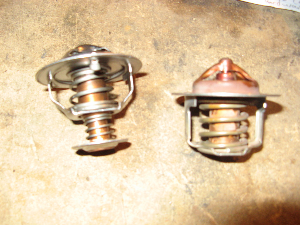

I checked the T-stat yesterday too. When I bought the truck it had a t-stat in the glove box, so I thought it might not even have one in it. But it did have one, and it looks like it is a dual stage having 2 different size springs. However I didnt throw it in a pot and heat it. Maybe I will just buy a new one anyhow since they are cheap. And I am pretty sure I didnt overfill the oil in the clutch fan.
If I were to take a reading with a temp guage, where should I measure from?
Here is a pic of the t-stat that was in it and the one that was in the glove box.

left side looks like the right thermostat. right side is definitley the wrong one...
if ya wana test them... fill a pot and put something in the bottom of it that wont melt. )i use an apple coring thing thats slices up apples. put the thermostats in on top of that so they aren't touching the bottom/ hold the thrmometer probe in the middle of the pot of water between the thermostats. slowly raise the temp with a temp probe in the water. yopu should watch them do their magic and it will tell where each one is working if it is... I would just put it the good one and leave the junker out... but it is always fun and useful to test them.

Irrespective of which thermostat is the right or wrong one, that the engine is running cold is most likely due to the thermostat. If you have one of the Stant or others that have a "fail safe" feature, when they get too hot, they lock open so that coolant flows all the time.
If it takes a long time to warm up, more than 2-5 miles, it's likely the thermostat is locked or stuck open.
If it's locked open, coolant flows (I think I just said that ) through the radiator and gets cooled off.
