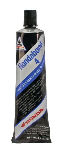

Hondabond 4 and Hondabond HT are gasoline resistant gasket makers/sealants.
Hondabond 4
* Semi-drying liquid gasket.
* Seals irregular surfaces with a tough, elastic film.
* Solvent-based for easy removal; resists gasoline.
Hondabond HT (Hi-Temp) Gasket Sealant. For use in areas not requiring solid gaskets. Unique non-acidic formula. Dries quickly, remains flexible, resist vibration. Resist gasoline, oil, water, and most chemicals. Effective from 75F to 600F.
If it's an answer, then yes. Hondabond HT would do. But at $10-$15 per tube, it's a little spendy.
