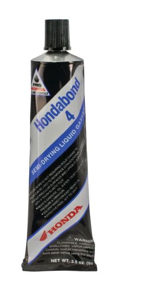

hondabond?

Is that a question? Or an answer?
If it's a question:
Hondabond 4 and Hondabond HT are gasoline resistant gasket makers/sealants.
Hondabond 4
* Semi-drying liquid gasket.
* Seals irregular surfaces with a tough, elastic film.
* Solvent-based for easy removal; resists gasoline.
Hondabond HT (Hi-Temp) Gasket Sealant. For use in areas not requiring solid gaskets. Unique non-acidic formula. Dries quickly, remains flexible, resist vibration. Resist gasoline, oil, water, and most chemicals. Effective from 75F to 600F.
  • Seals surfaces with a tough elastic film
  • Resistant to most fluids and chemicals
  • Withstands heat, pressure, and vibration
  • Makes part separation easier!
If it's an answer, then yes. Hondabond HT would do. But at $10-$15 per tube, it's a little spendy.
