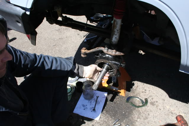

As for the lack of pictures here is the tear down. Basically put the truck on jack stands, take off the wheels and tires, brake calipers, hubs, rings, bla bla ... follow the FSM. It is pretty straight forward. Just muster up some confidence and start wrenching things off!

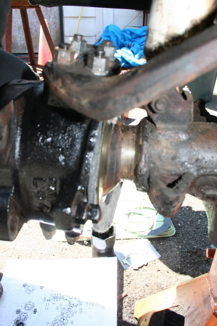

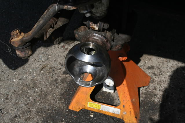

Knuckle ball with everything off and awaiting a new life.
and below are the parts being reassembled after I got all of them off.

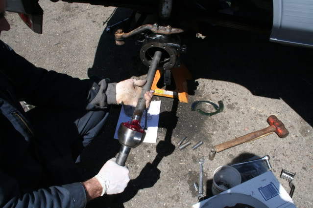

Spindles cleaned, birfs locked and loaded.

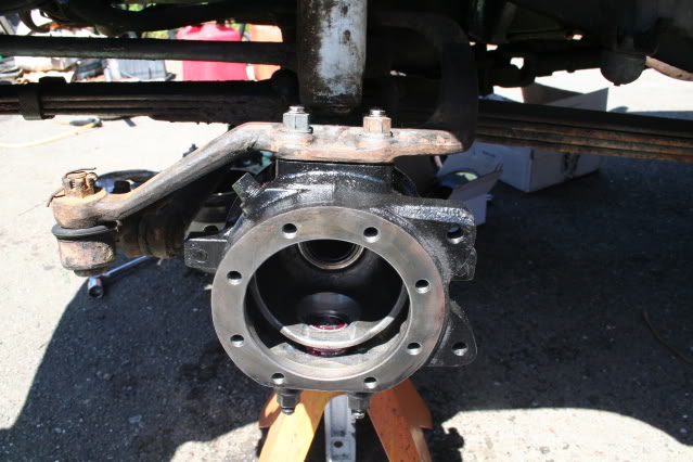

knuckle ball exposed and blowin in the wind.

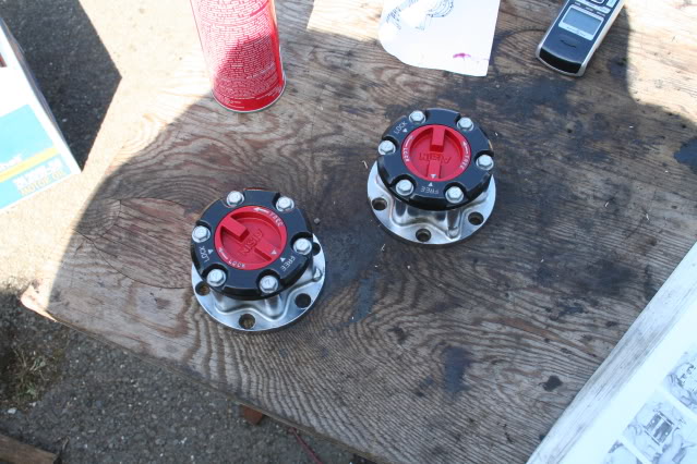

Now its time for the hub body to go on. Gasket on and hub rebuilt with NEW cone washers and ready to go in and torqued to spec. I also put the snap ring back in on the axle with a pair of snap ring pliers. Its hard to see but its in there.
I rebuilt the hubs as well as a fresh paint job and clear coat
Now the free wheeling hub shiny and new!!

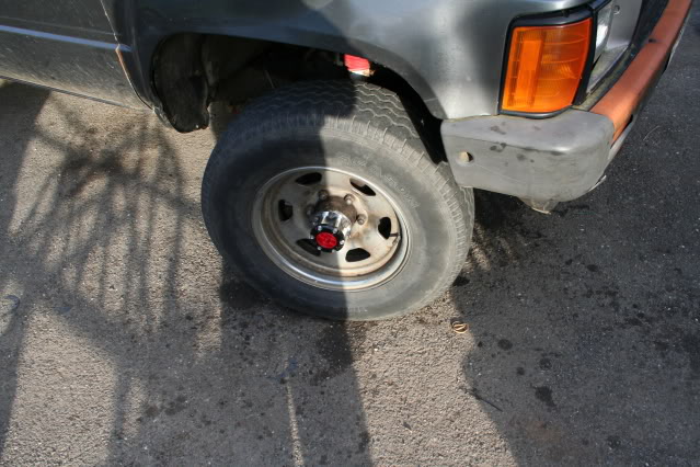

Wheel and tire on looking purdy!

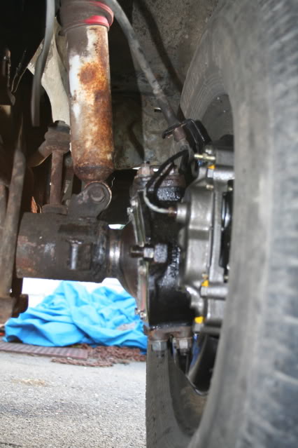

A shot of the underneath after a 30 mile round trip test drive up the coast...
Only a tear drop leaked on to the tire due to the clean beauty of it all

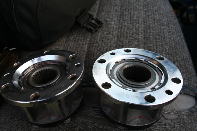

and for trivia sake..

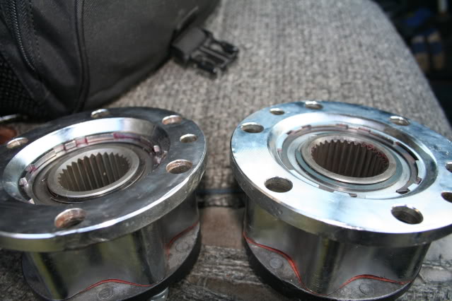

What is the deal here? These are a pair of 83 SA hubs. If you look closely one is slightly bigger on the inside than the other. I tried to put these on this 84 SA but I couldn't get the snap ring on on the outer edge of the axle. Are these the right hubs for an 83 or is there something strange going on here??

If you look at the rest of the truck and you met the owner you would understand why I didn't take it out. BELIEVE me, I did all I could. Take a look at the leafs, stabalizer bar, steering, knuckle arms etc.
One with the deeper backspacing (distance from flange face to the hub gear face) is an IFS hub body(86-95) with 30 spline hub gear...not an SFA hub(79-85).
Thus it is taller and doesn't allow the room needed to put on the snap ring.
where do i get the complete rebuild kit for the knuckle arm (seals, bearings, races, gaskets and rings) i have a busted bif and i went the easy way and ordered a new axle........ i mind as well just freshen up the whole knuckle assem if i have to tear that much down to swap axles out. a web address would be great..................
Thats funny Wabbit because those two hubs came off my 83 SA.
I distinctly remember the snap ring having no issue on either side when I pulled them off.
Do you have a SA hub laying around? I will trade you one IFS hub for a SA hub..
I distinctly remember the snap ring having no issue on either side when I pulled them off.Do you have a SA hub laying around? I will trade you one IFS hub for a SA hub..
