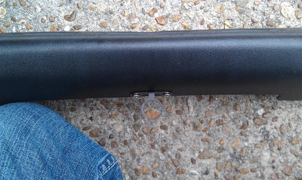

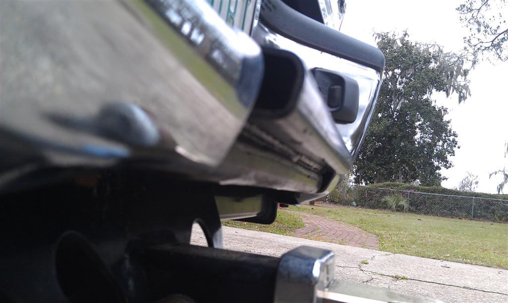

The most ideal place I could think of to mount it was on the bottom of the bumper just above the trailer hitch

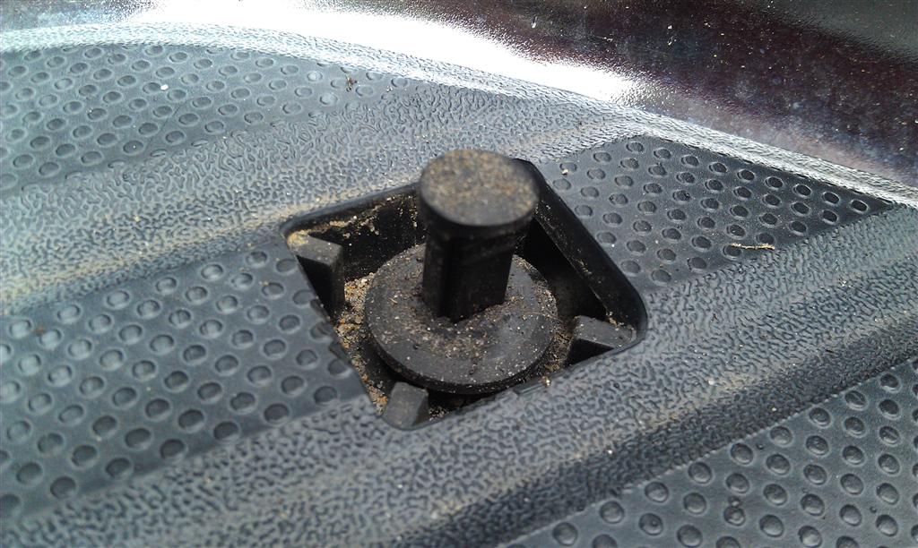

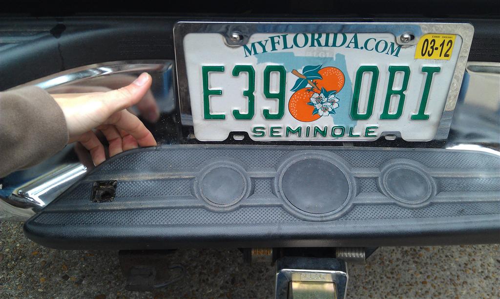

And in order to do that, the plastic cover has to come off. A small flat head screw driver pops off the top covers and the plastic push-clips, and underneath are 2 10mm bolts. After those are removed, the cover just pops off.

There's a convenient indent in the support behind that plastic cover; that's where our screw is going to end up
