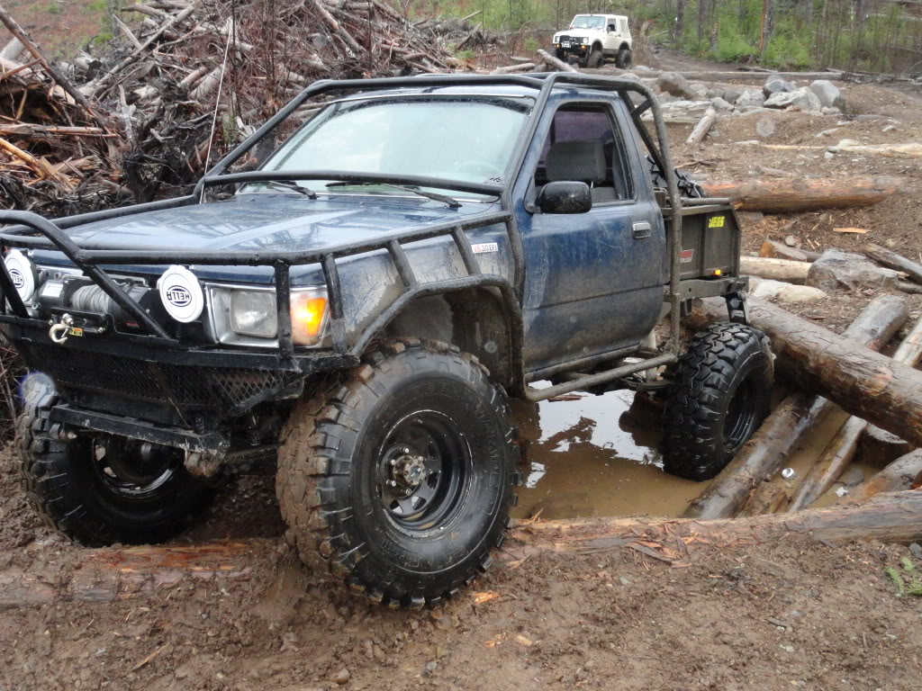

Harbor frieght bender did this. Coarse it takes a man who doesnt ride a moped and wear skinny jeans.
Obviously, you have skills with harbor freight tools that far surpass the average hooman.
Edit: Nice wheelin rig btw.
Thanx.
And no I wouldnt recommend using one if you dont have to. But it can be done.
