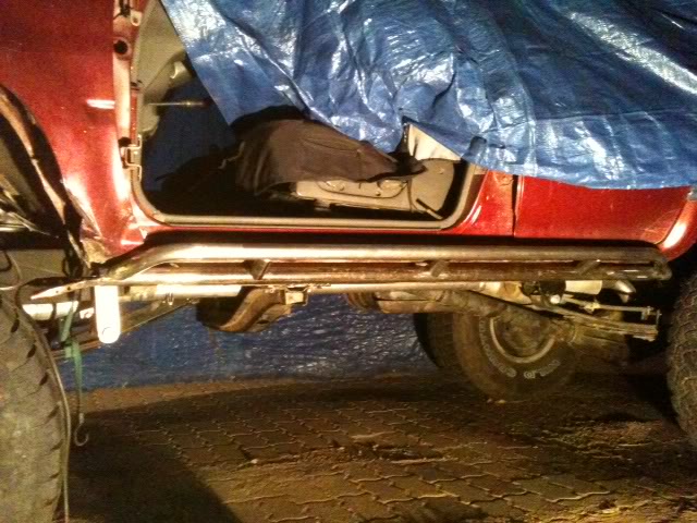

For my sliders I used 1 1/4 schedule 80 pipe (almost .250 wall) and 1 1/2 .120 wall hrew tube. I have a few buddies that have built their entire rig with hrew and not dom. they dont have any problems. If you place the seam of the hrew away from a vulnerable hit then it should be just fine. For example If building sliders, place the seam on the inside facing the truck.
