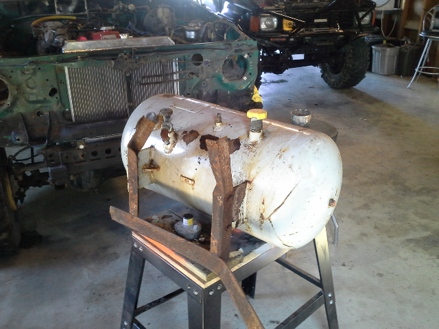

I've searched before and pretty sure I have never found a thread on this being done. I may be wrong and if so I guess I note it to my amateur status here. Hopefully I can get some good advice and maybe give some people some ideas.
#1 cheap and durable fuel cell that looks good
#2 I want to do the work myself
#3 search the scrap yards
I found a $20 propane tank with all the fitting insets I should need to make this work (fuel line out/on bottomish, larger hole for fill spot, small hole for breather). My only presumed issue will be the fuel line outlet a quarter of the way up on the tank.
Questions comments and concerns would be greatly appreciated. Also I have somehow overlooked all rules and regulations please let me know.

Pretty new at posting and on a tablet so not Uptodate on quoting people . But here it is by order of entry.
Wyo9 (i lived in Laramie for 4 years)
Q1. Its a buggy so im aquiring scrap materials for the bed. Expanded steel with braces and hinges so i can see and access the under parts. Building braces to mount the tank against cab frame. Pic1
Q2. No pump on the current tank so i figure im good?

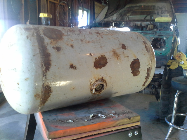

Q3. Vents. P.O. has a 5 gallon jerry can with no vent and it works just fine. picture to is all the fittings on top. I will be venting it. Biggest issue will be the size of fill hole. 1" vent will help?
Q4. Fitting were a beast pic 2 & 3. Soaked in PB and used a BFW with a BFH and just torked those puppies. Chris Ledux was my keep um goin music.

http://i1093.photobucket.com/albums/...o/DSCN3716.jpg
Tank one 1" port(fuel inlet), two 3/4" ports(vent and gauge), one 1/4" port(plugged) mounts for bracket.

Cleaned the tank out last night with some rust annihilater product. Not bad in there AT ALL!!
Going to do it again tomorow then coat the tank. Havent decided on product yet.
