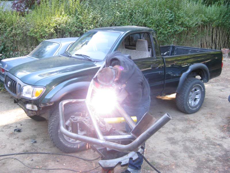

in the last 2 weeks i've had some time to burn and some d.o.m. laying around.... time to get started on some fab work. so I borrowed a friends tubing bender and went to town.
My good buddy Noah was in town for the week so he lent me a hand. took about a days worth of work, spread over 2 days to get all the major work done. all that is left is detail and powdercoating....

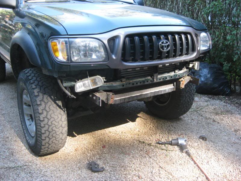

mount, rad. guard done, main piece bent
and mocked for welding

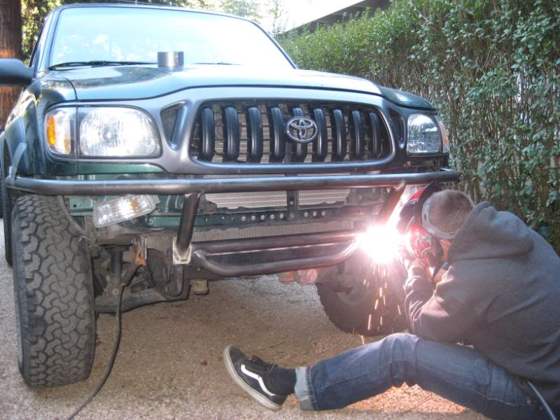

here comes the fun part
end of work on day one

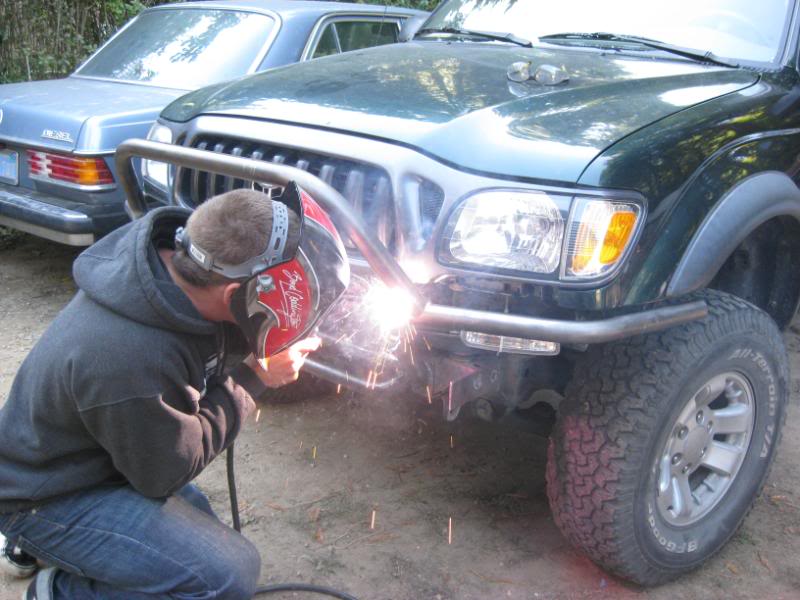

and day two

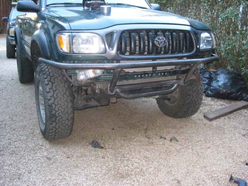

not bad for a first timer

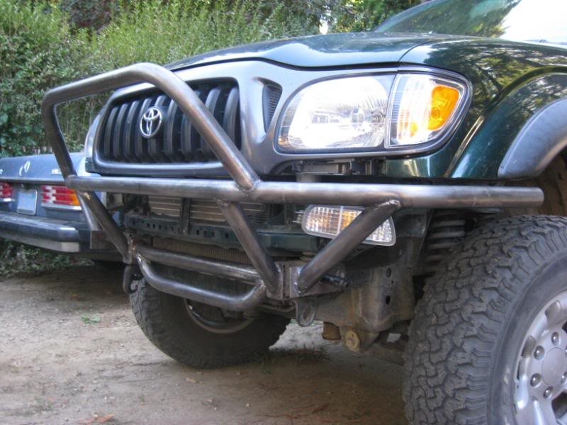

tabs need to be welded on for the hella 500's to be mounted below the main bar
rear bumber and sliders in the near future.....

nice bumper, i think you should add a third support tube in the middle to protect your radiator better.

I would shield the tires
my friend blew a tire from welding amber....use an old carpet, sheet metal or something

Bumper looks great man! Only comments are maybe throw in a spot for those turn signals (unless your planning on relocating them in the side markers) and the most important comment when are you building one for me!?

Looks really good. Have you thought about putting some lower tabs or a bar to mount up the front stock skid plates? Again looks good, but I always think my taco looks funny when I remove the skid plates to do an oil change.

thanks for your comments and ideas!
I didn't think to cover the tires from the welding splatter, I'll have to remember when i do the rear and the sliders.
turn signals are going to be relocated to the side markers, and a custom aluminium skid plate will be made to replace the original

looks good nice welds some dimond plate or sheet metal would look good between the bottom braces protect the radiator from sticks and

I just love to see pictures of people welding without gloves!!
