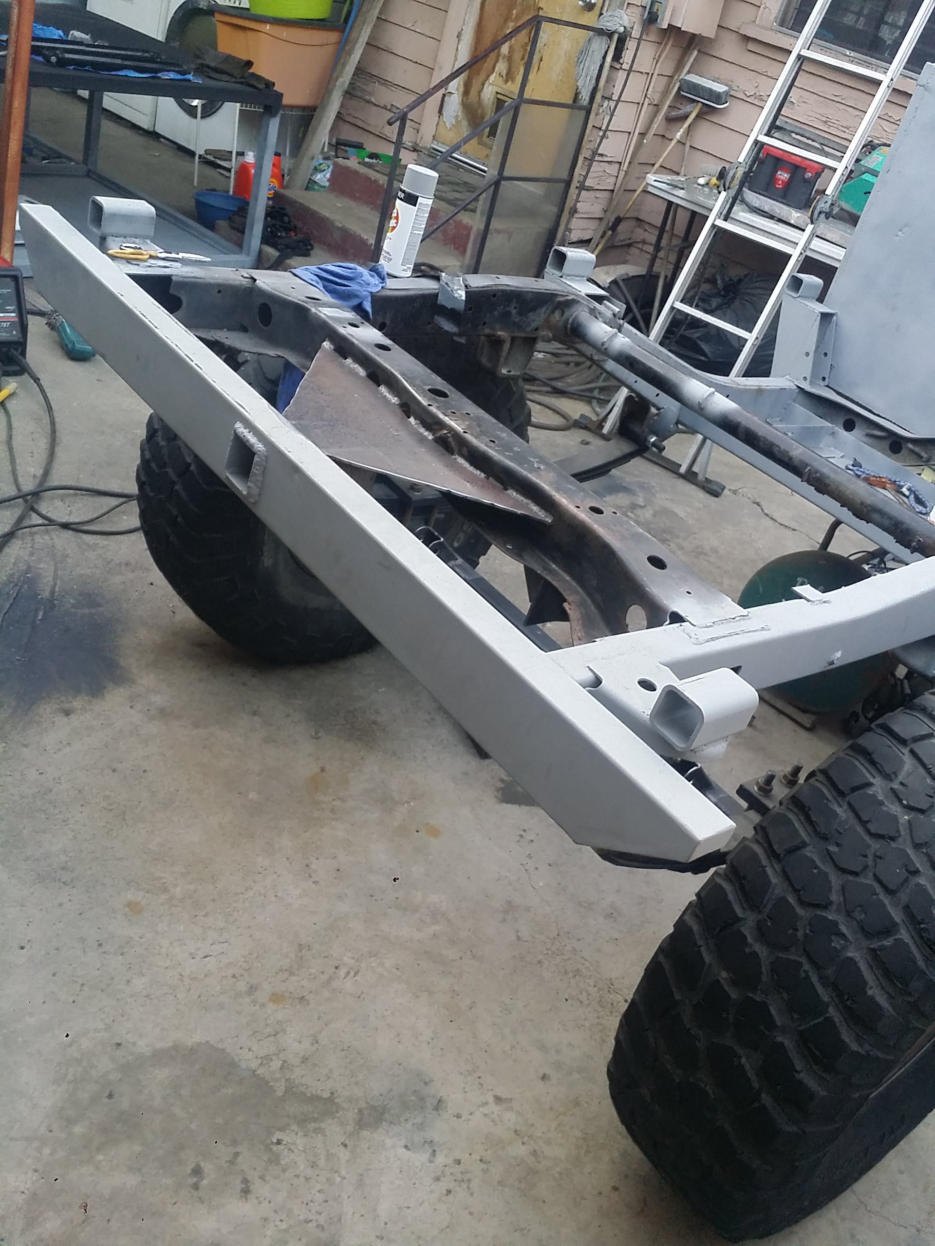

Man its been a while since I've worked on the trailer.. but if you follow my instagram page you will see what I've done before it's posted on here. Yesterday I spent the entire morning thinking up of ways to make custom shock mounts for the trailer project and I finally figured it out. I cut off the stock rear 4Runner shock mounts that were already welded to the chassis and i fabricated some basic gussets that would hold the stock ones in the new location. Then I made the mounts which will mount to the axle housing using 2"×2" square tube 1/8" thick.These mounts will work perfectly with the 8.5" Monroe shocks that @chefyota4x4 donated to me for the project. Once welded in place the shocks will have 4" of up travel and 4.5" of down travel. which I think is plenty for a trailer. Not like I'm building a rock crawler out of this lol.

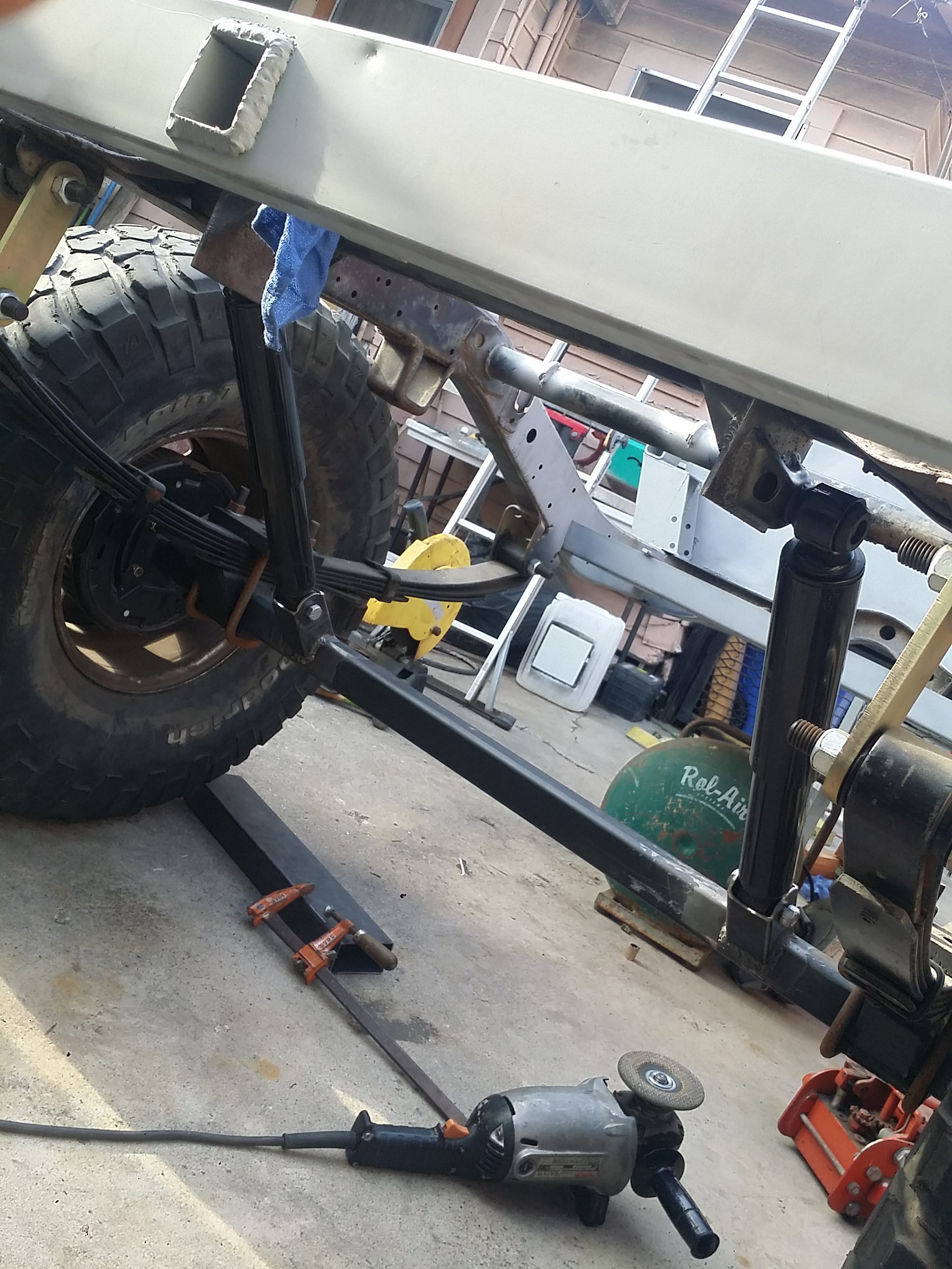

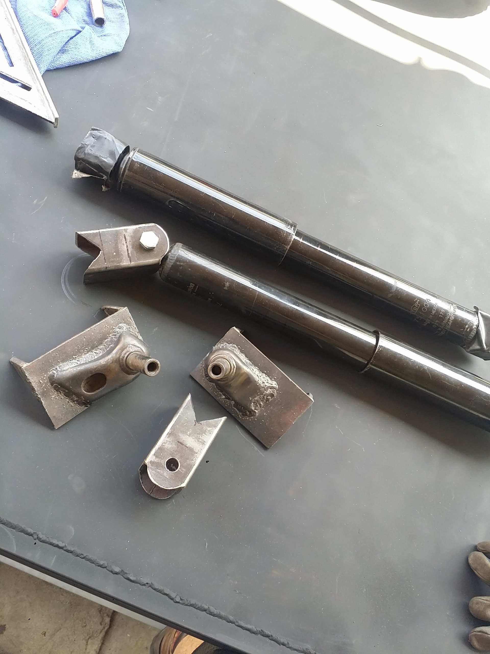

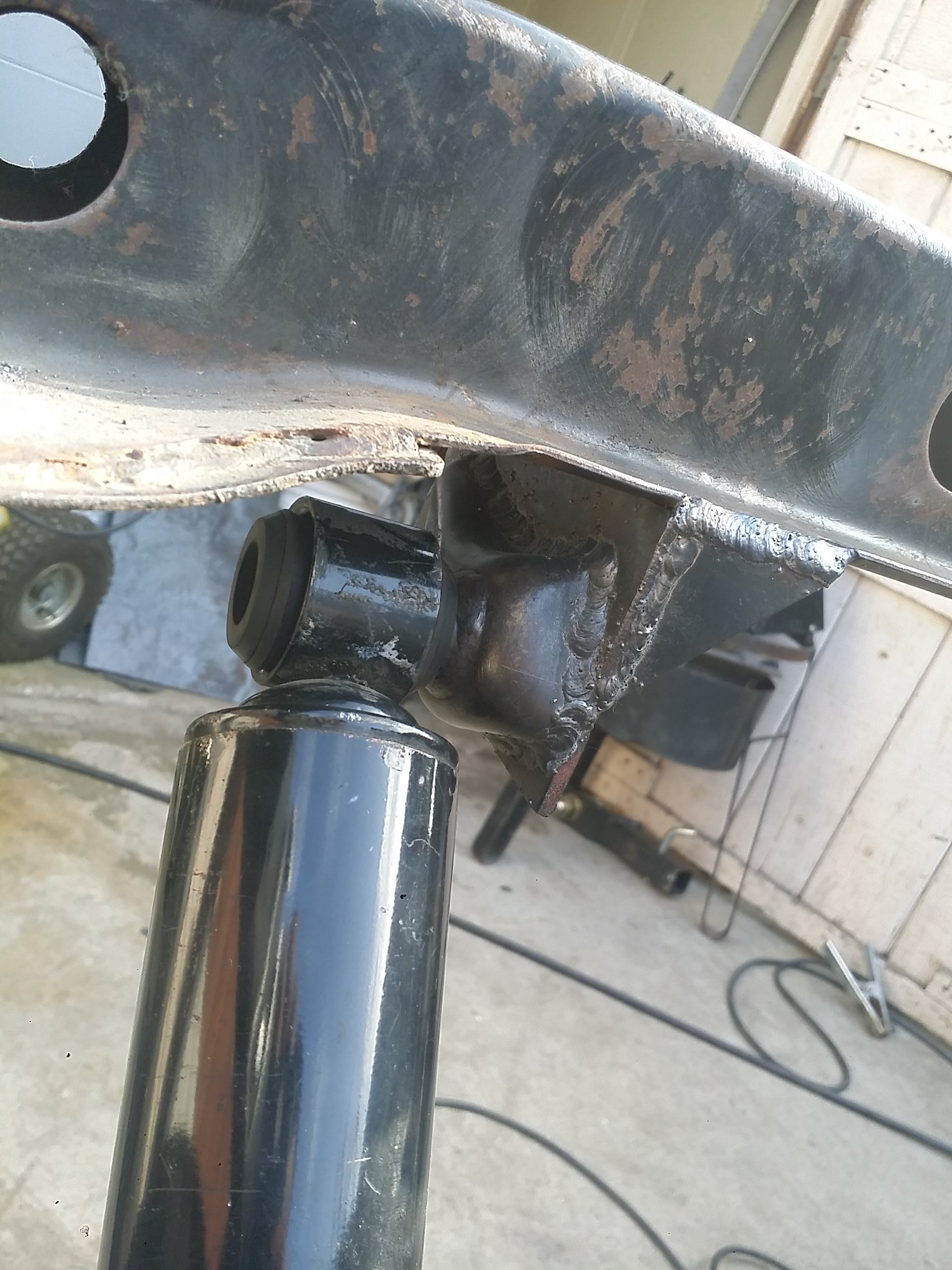

Here they are all mounted in to place! The trailer finally has shocks! I just need to find stock upper shock bolts to fit these. But I'm set on suspension now! In the end they had about 4.25" up travel and 4.25" down travel. It's all good. It will still work good.

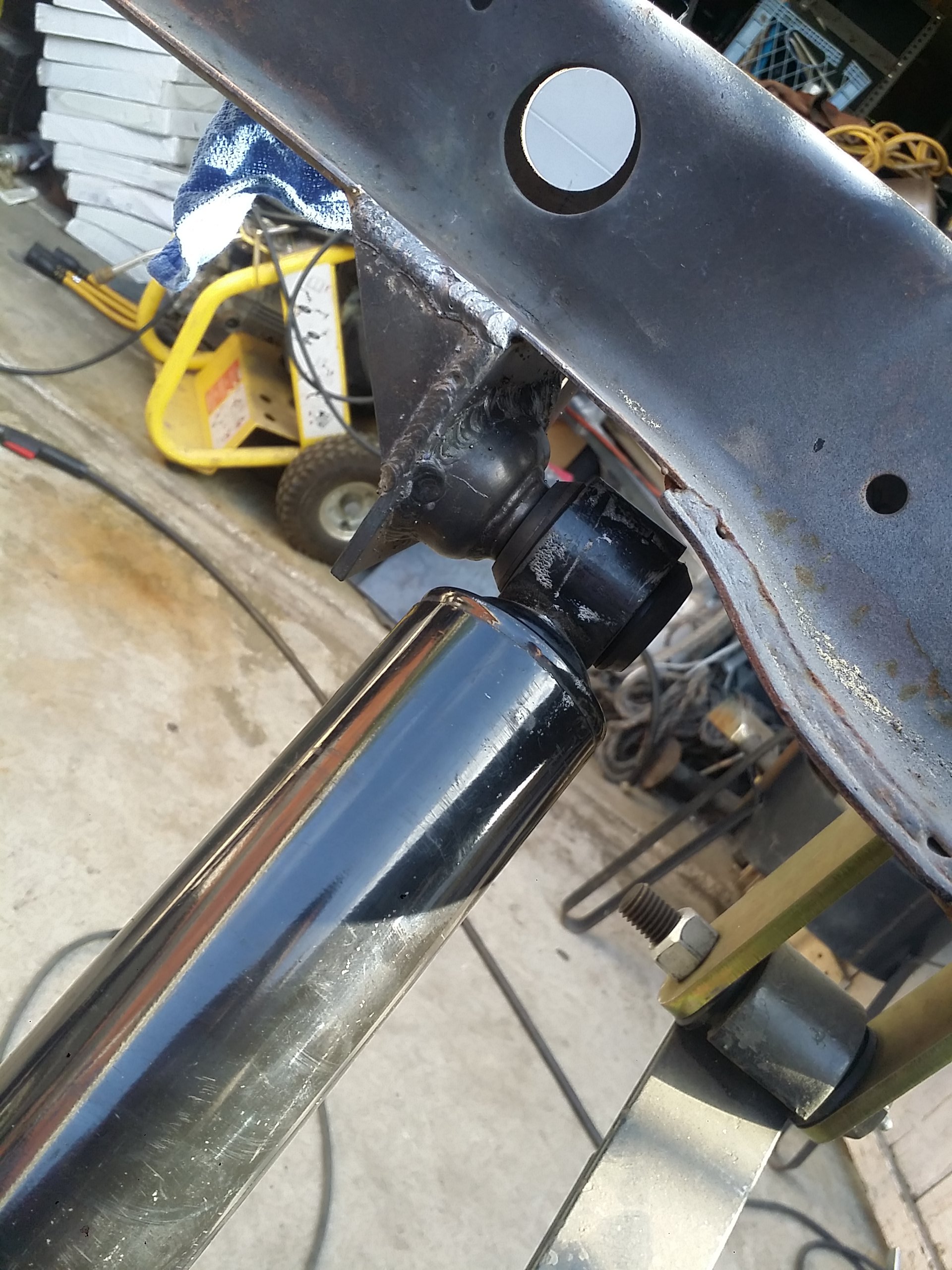

Here's a close up if the mounts I made that I welded to the rear most crossmember which is normally used for the stock spare tire carrier on these 4runners.
Passenger side
Driver side
A few forum members both on Expeditionportal and YotaTech.com suggested I should add a gusset from my trailer hitch to the first cross member for support in case I ever need to have a vehicle pull the trailer from the rear bumper if I was ever to get stuck. I think they had a valid point. Without this gusset the load would be entirely on the thin bumper and it would be ruined for sure. This definitely beefs up the hitch for emergencies if needed.
Passenger side
Driver side

Nice work on the shock mounts. I think the stock lower shock mount bolts are the same size as the upper ones, if so I have a couple bolts you can have, then I can say I contributed to your build, lol!

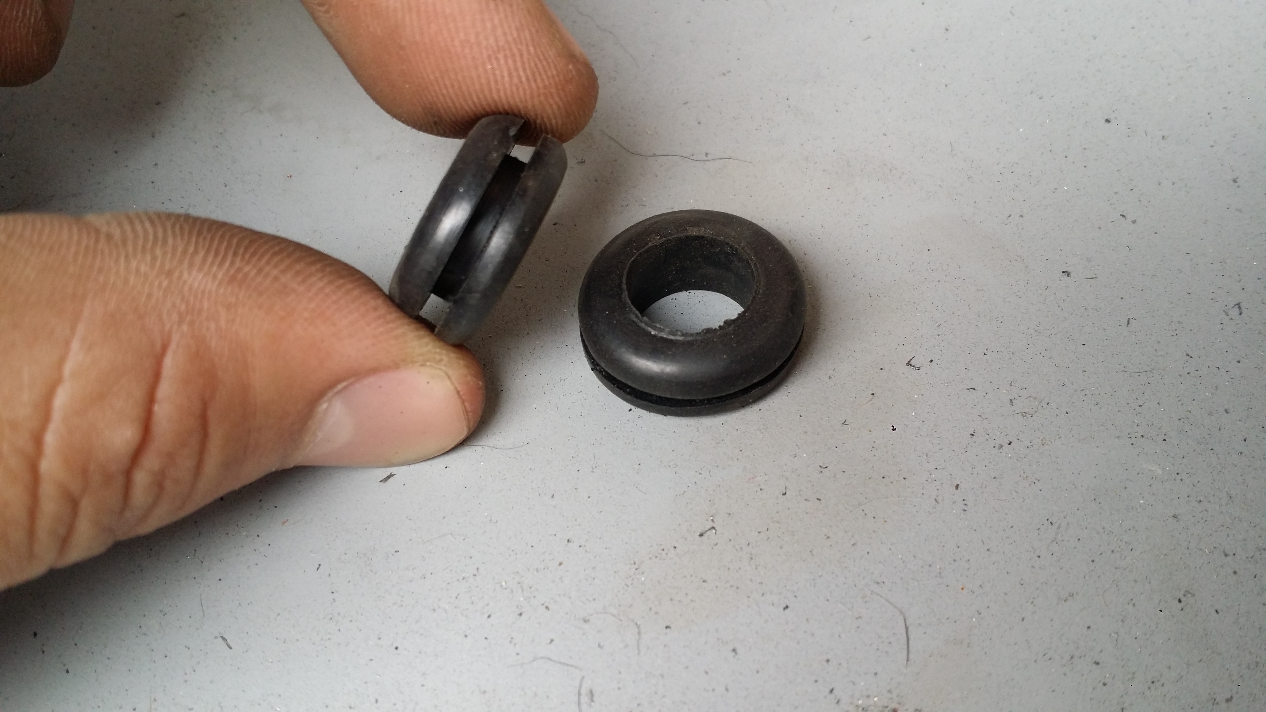

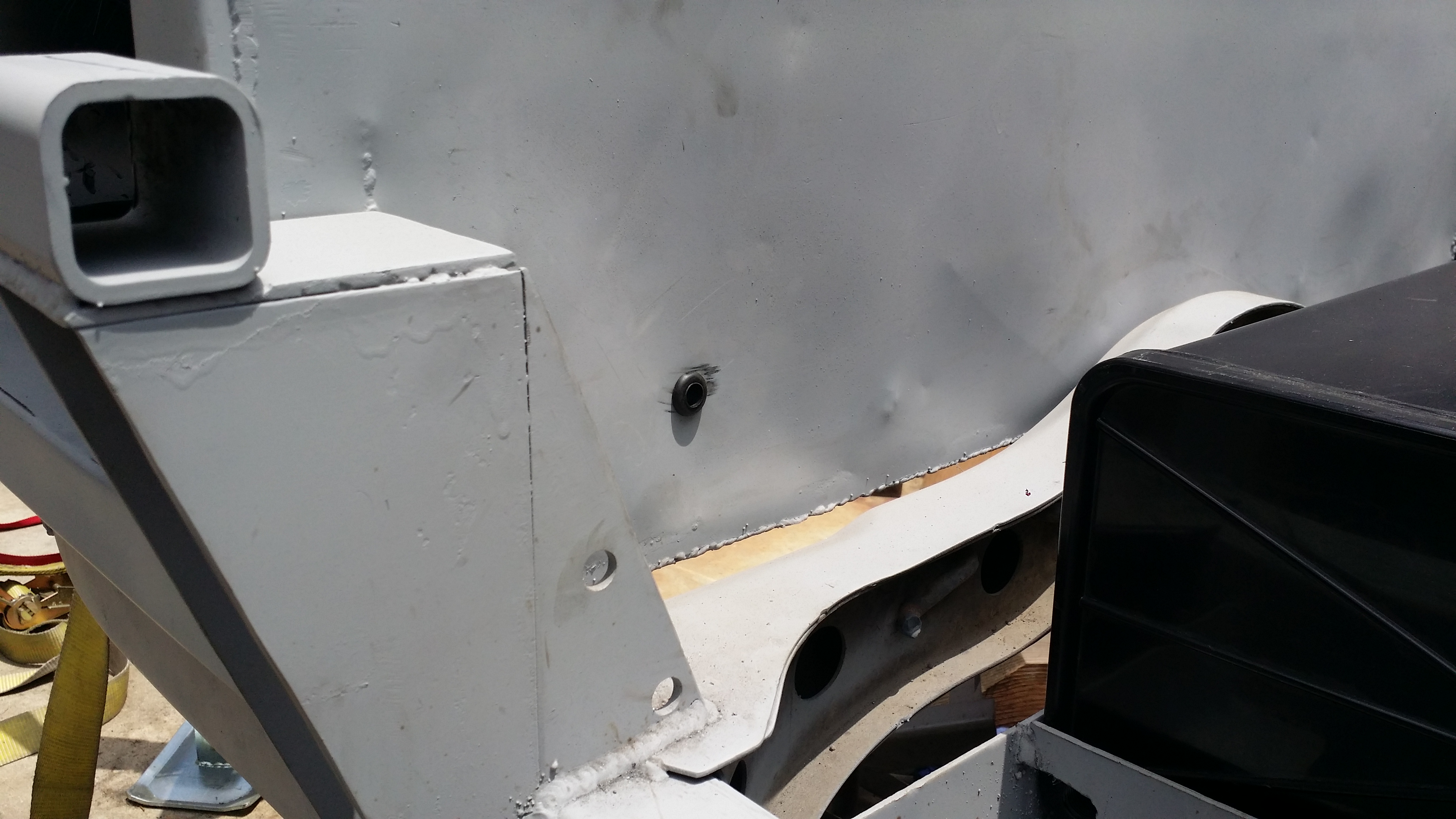

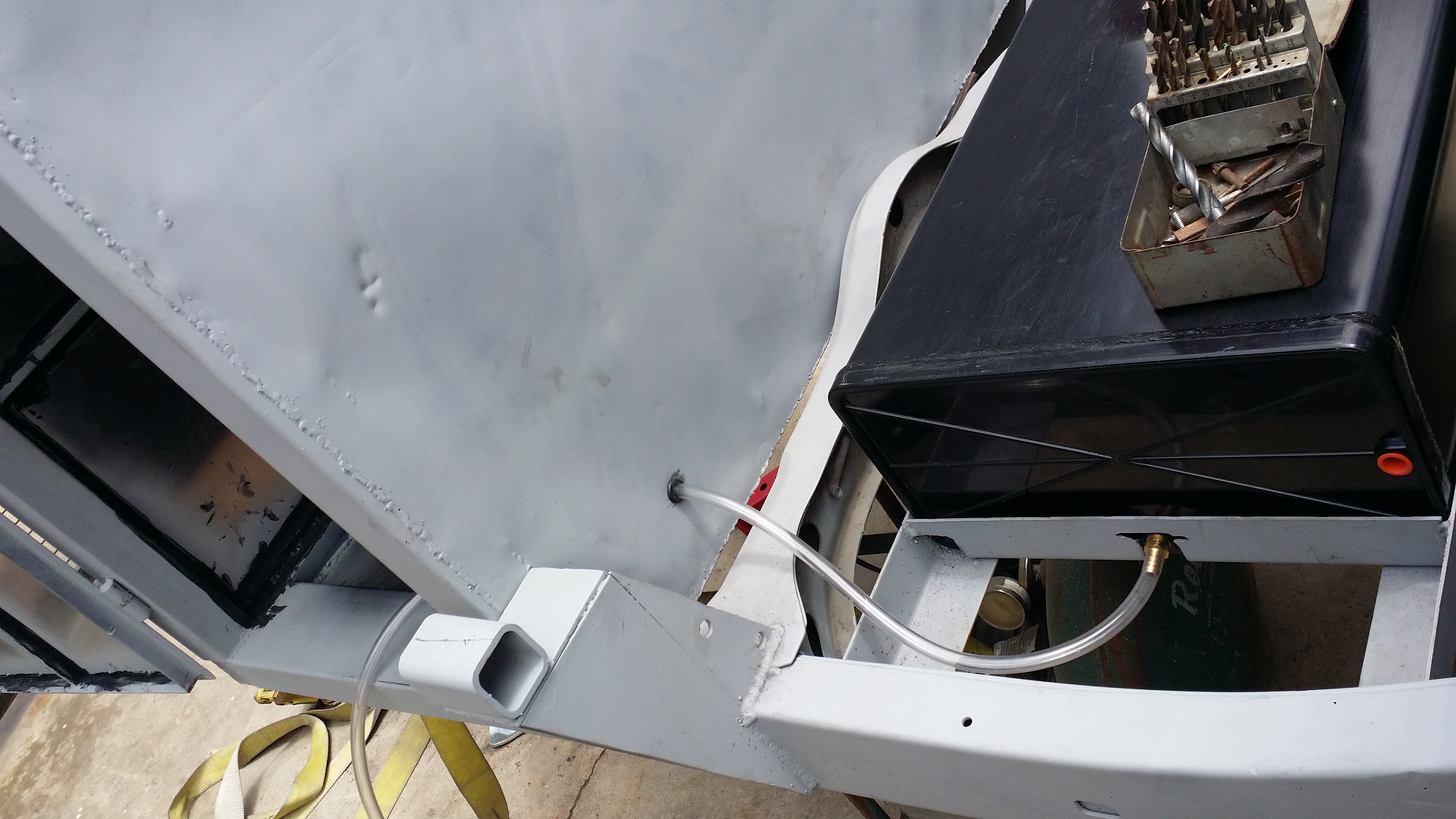

I found some wire grommets in my tool boxes from when i installed power windows into my truck and they just so happened to be the perfect size for the the vinyl tubing to pass through into the front compartment.

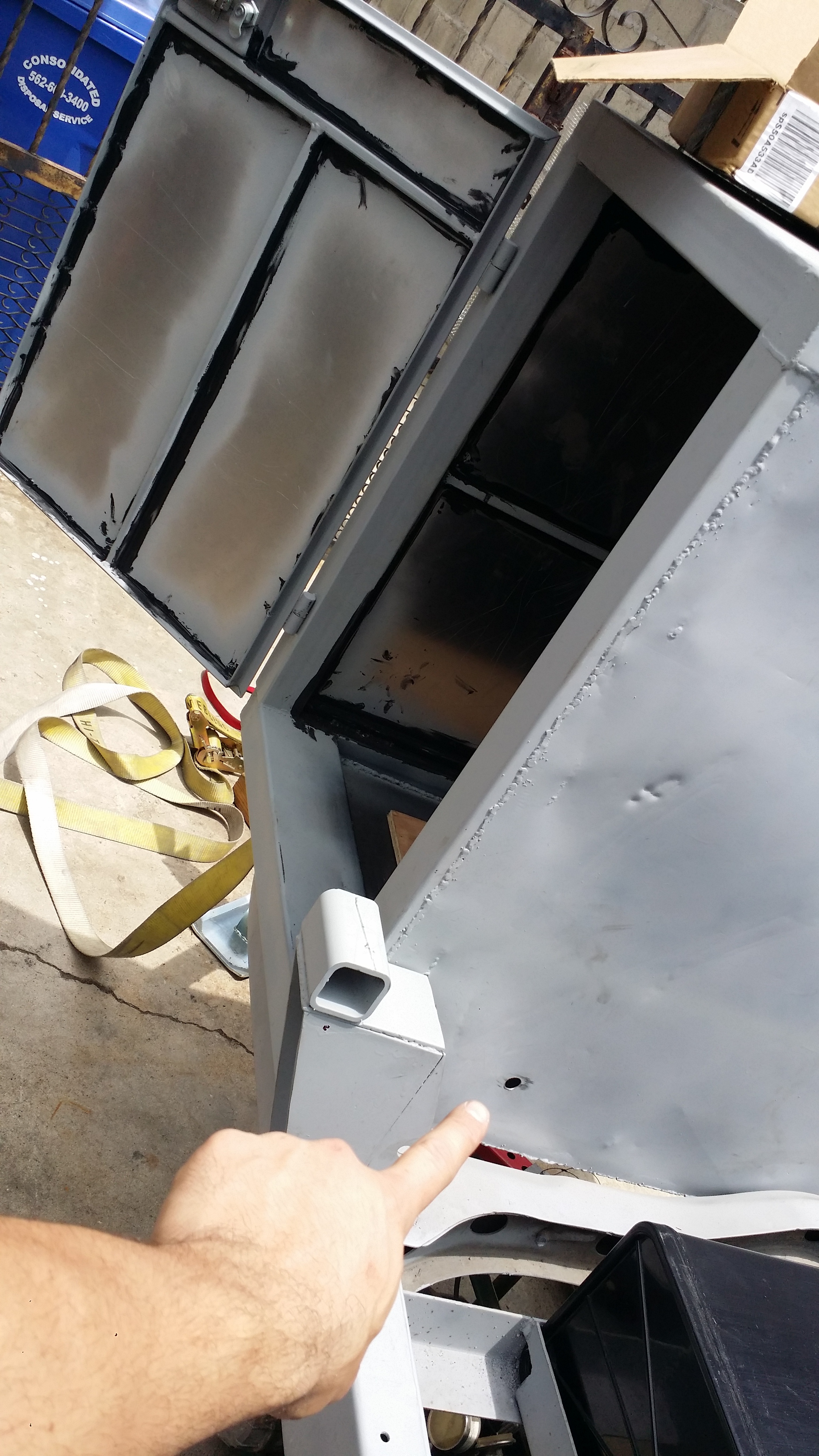

Hole made in the rear lower left corner of the front compartment
This will work perfect to keep the tubing from getting damaged from constant rubbing
It was tough to get the tubing in but it fits!
By this time i had already painted the inside and all around the exterior of that front compartment I figured it was a good time to do it now that the hole was made. I also mounted the EccoTemp heated shower to the door but not before adding some tubes on the rear side of the water heater welded to the actual door to stabilize the unit from shaking like crazy when i drive. I only added them to the bottom of the door so i may still have to add 2 more to the top side but for now it works and doesn't shake at all.

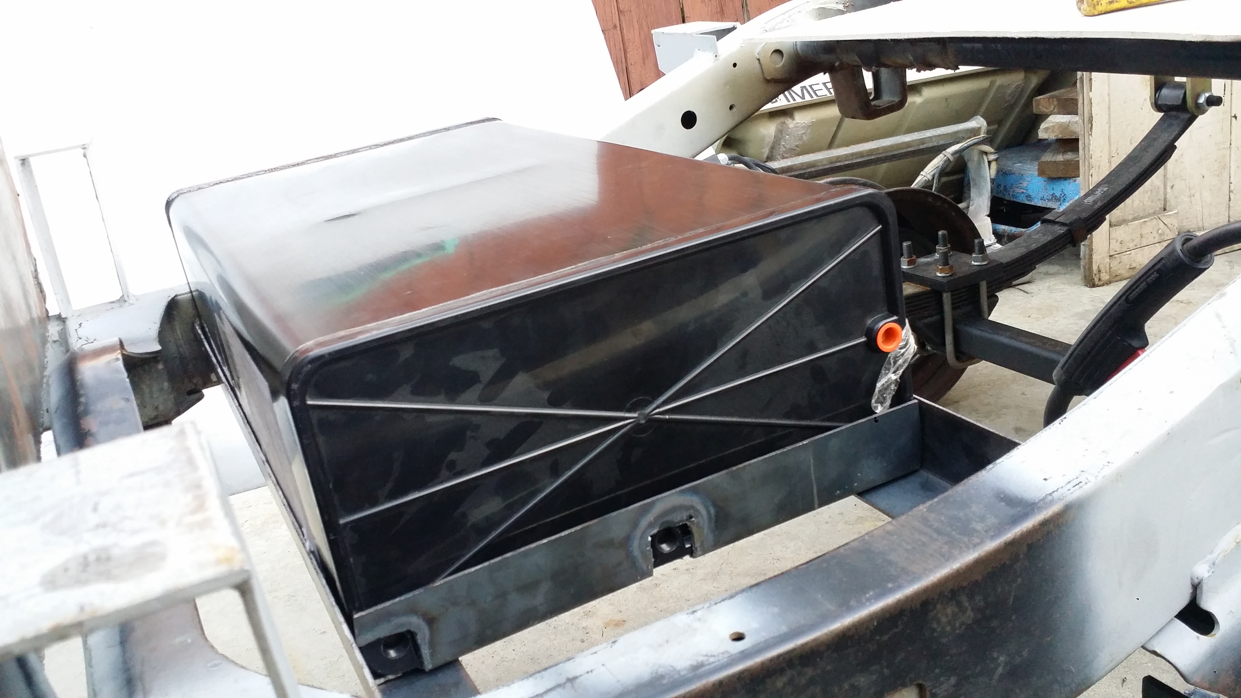

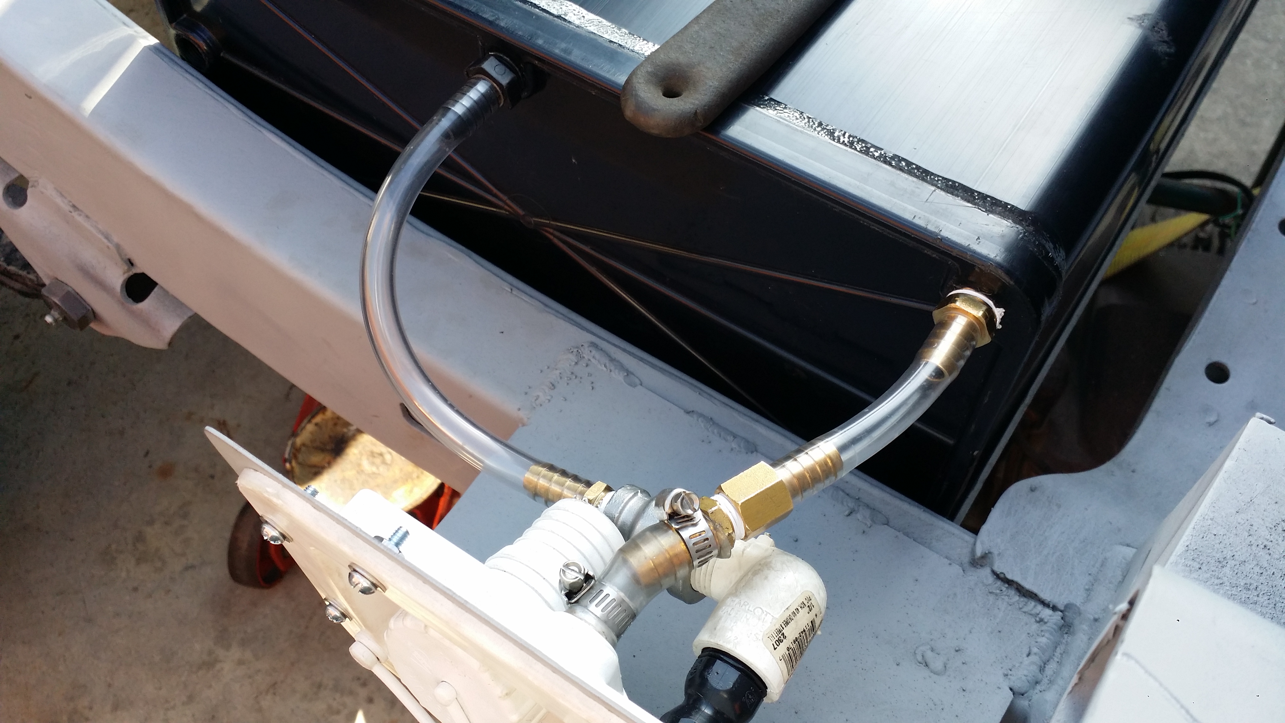

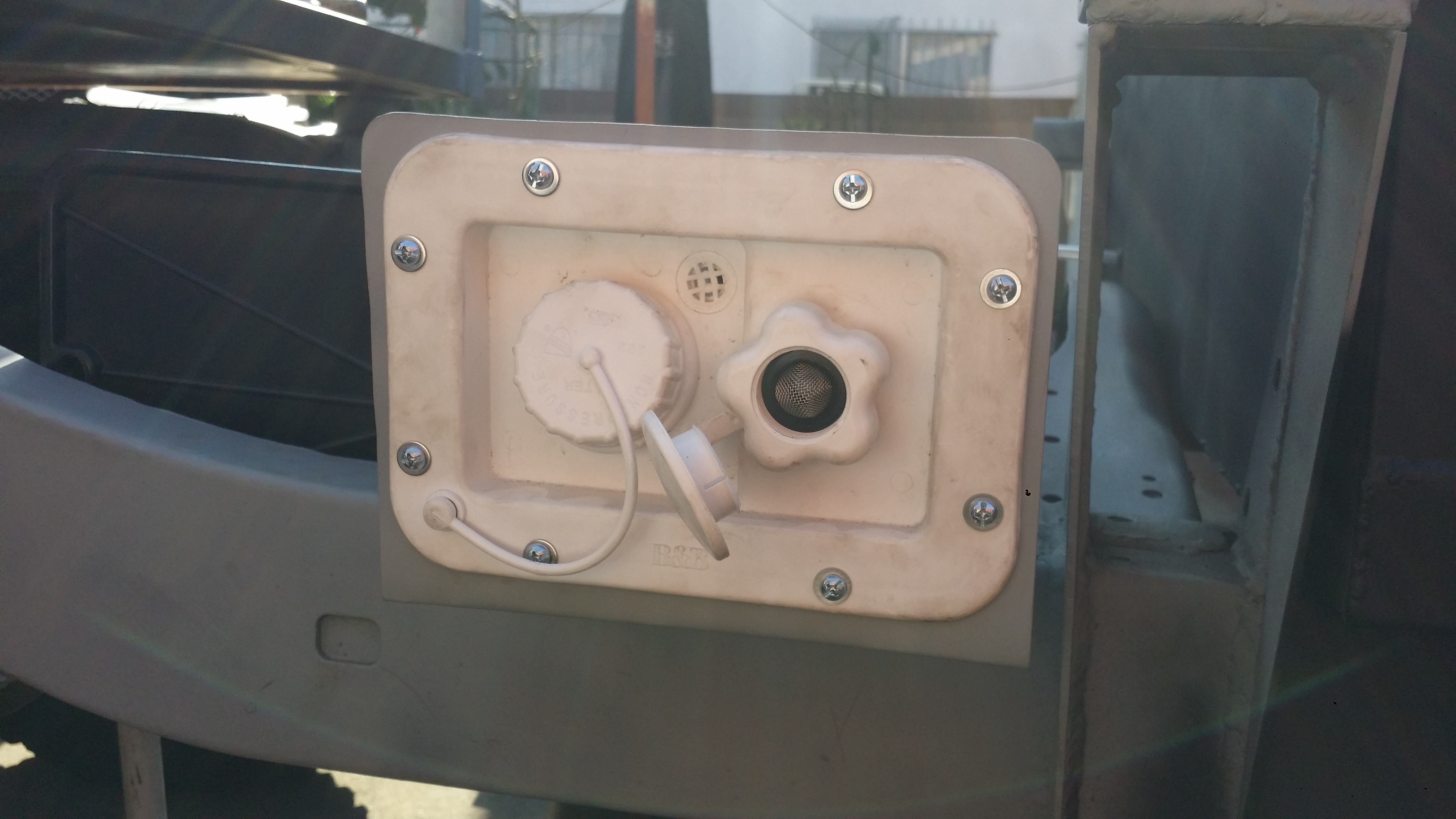

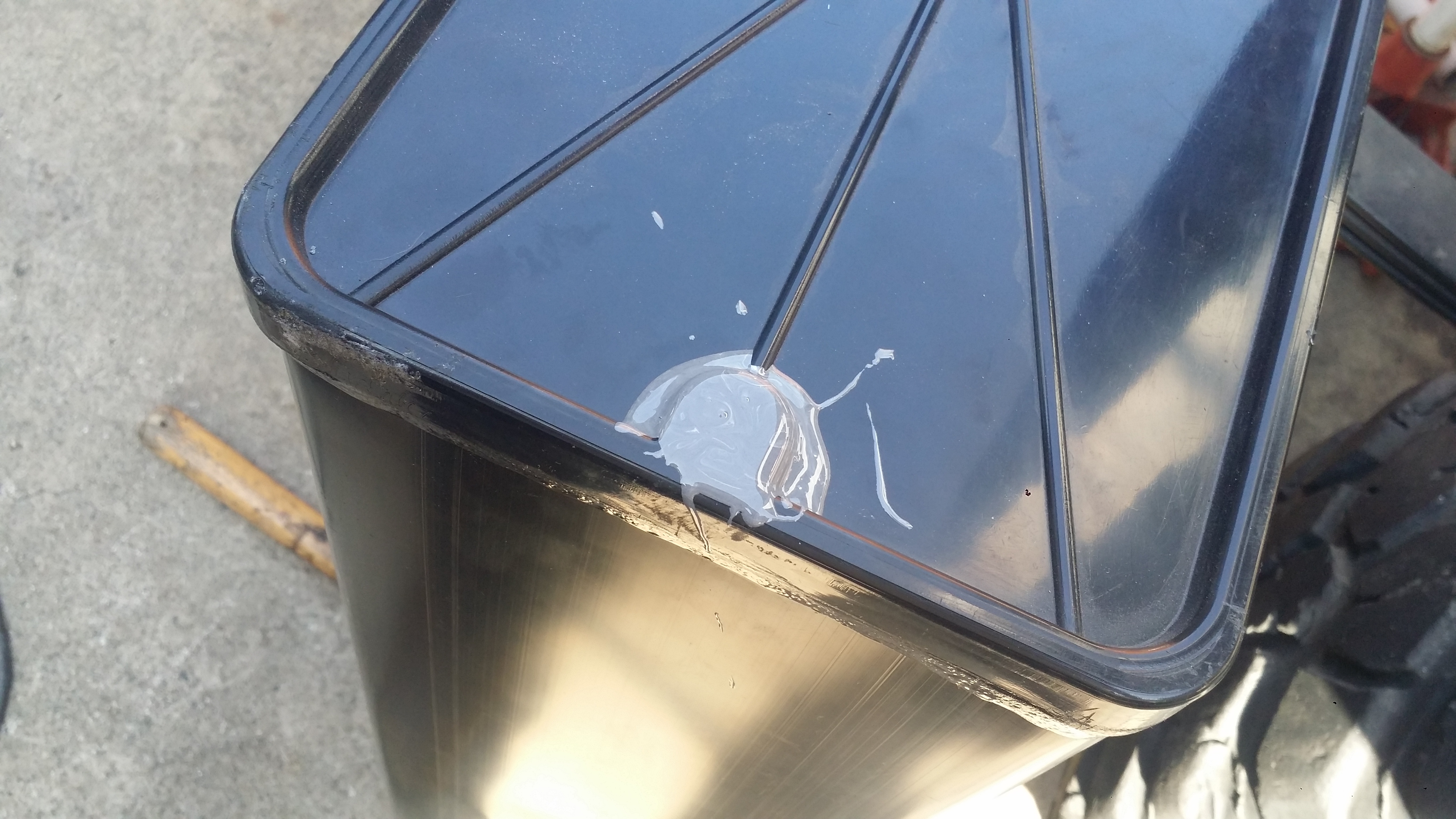

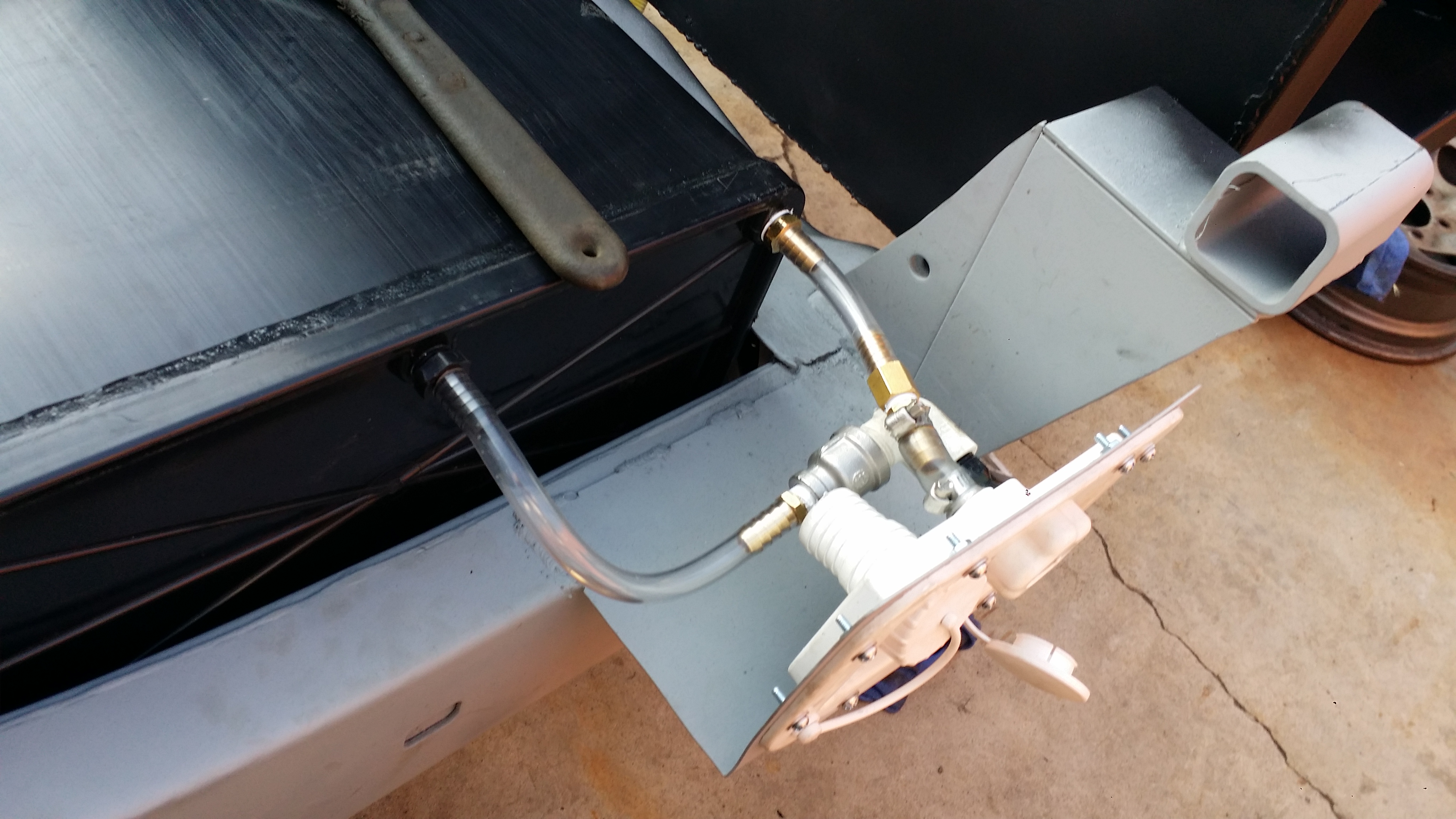

So one of the things i wish the vendor of my water tank hadn't done was make their own hole into the tank because it just so happens that every hole i needed to use was everything except the one they made into the tank lol.
Fortunately the vendor included this temporaty orange plug shown in this picture below to keep dust out.
So I just plugged up that hole by cutting half of it off and and pushing the entire plug into the hole as far as it could go. Then i finalized the plug with some JB Weld to make sure it would hold. I'm sure this will work just fine in keeping water from spilling out.
Also made a trip to Home Depot and bought some Bolts, washers and nuts with nylon threads. It was only about 5 bucks. But it will definitely keep this baby in place!
Top View.
The hose that curves provides the water to the tank via water hose.
The other hose that goes straight is meant for air to exit the tank as it is being filled.
Top View.

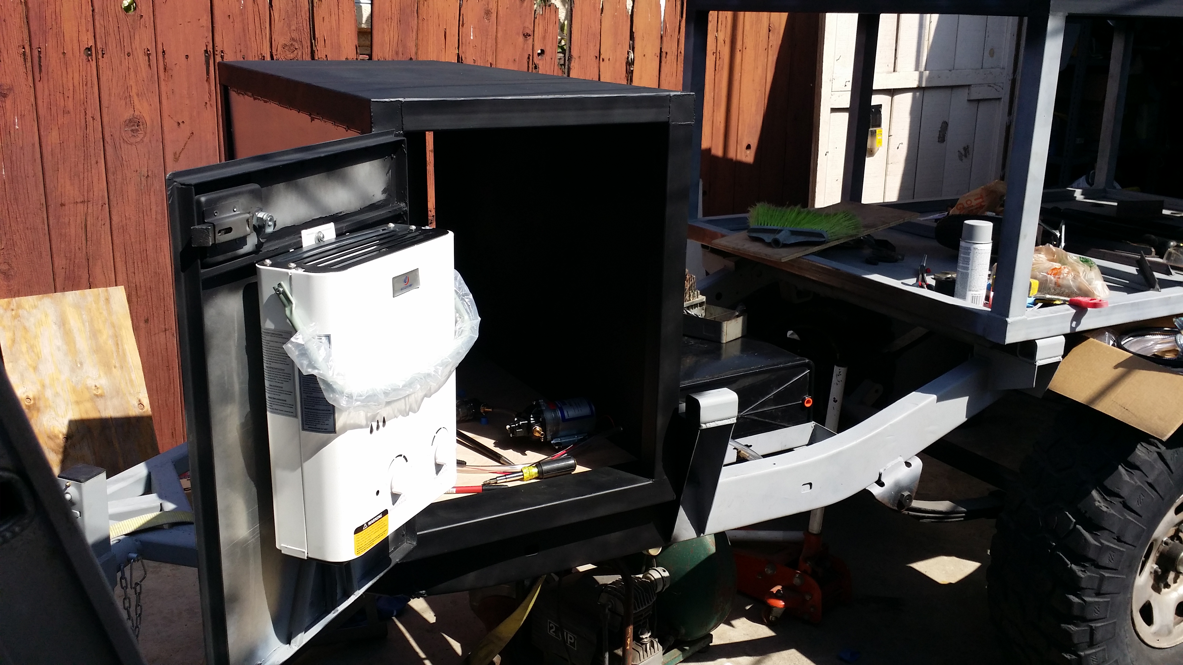

I finally go my "Propex Heatsource HS2000" heater working. Here is a video I uploaded to YouTube. It is a full review/explanation of how this thing is set up, how it works, how many operating hours it is estimated to get, amp usage, Pretty much all the questions I had when I was looking into buying this were answered in my review because other online videos and websites don't go into depth with the details I wanted to know.
Well here ya go everyone. You have any questions just ask and ill do my best to answer.

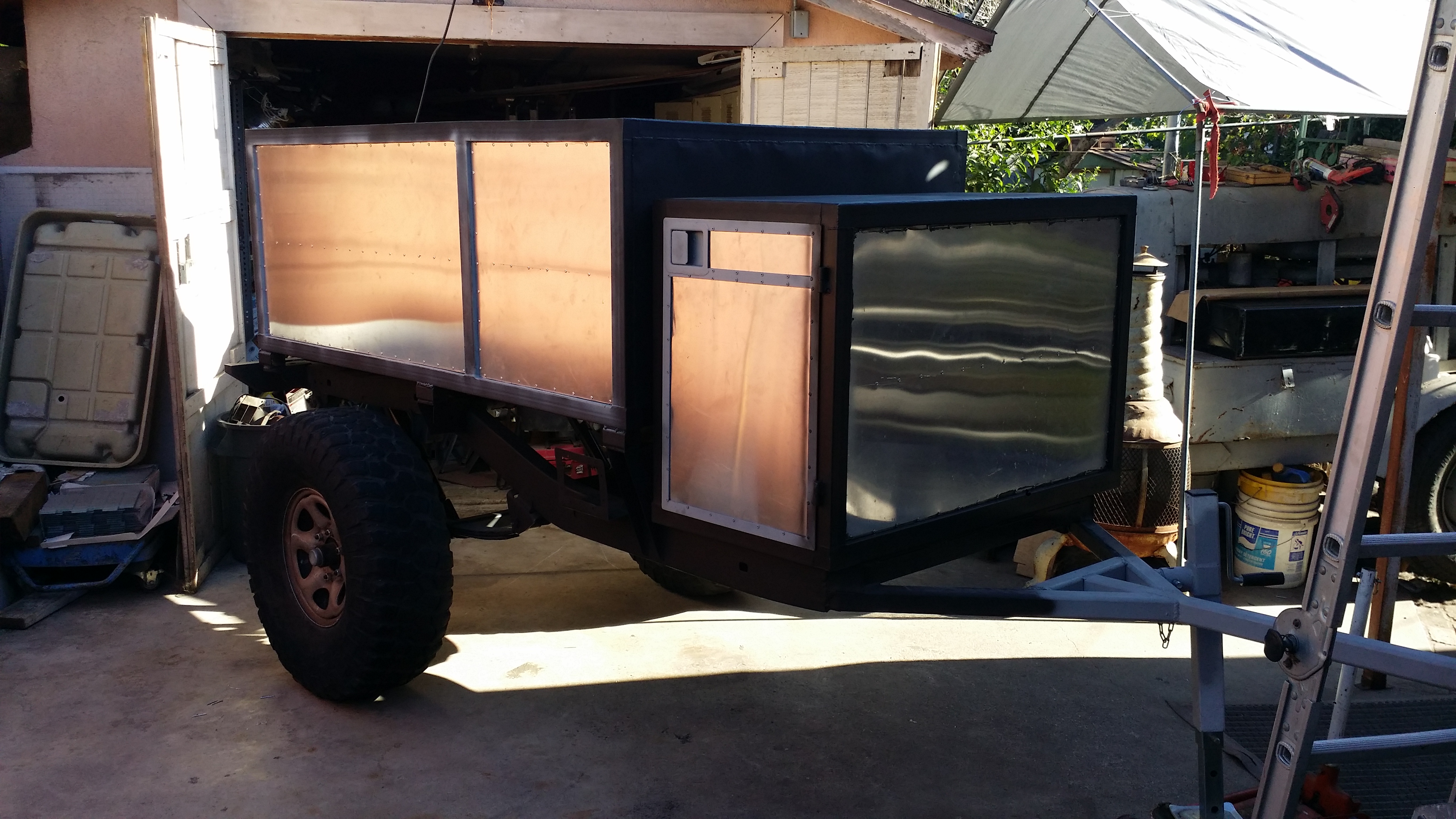

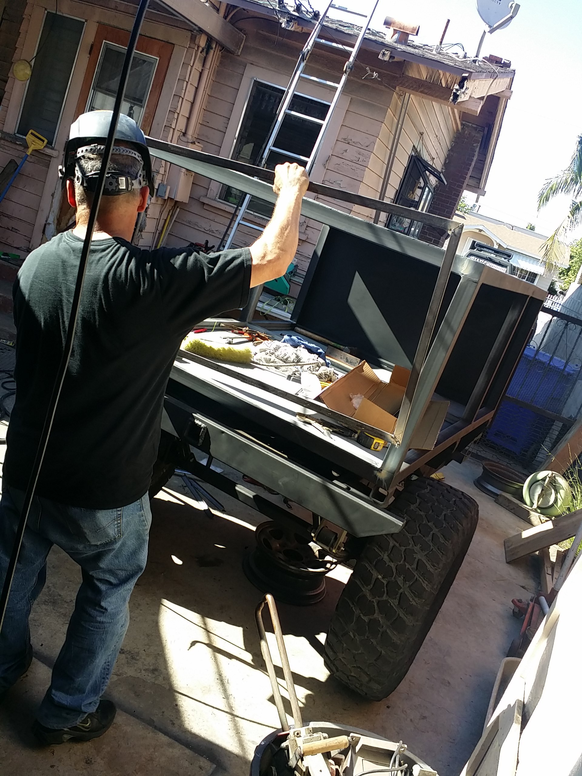

Finally got some work done to the trailer. I took off the rear compartment so I could weld on the front wall for it followed by primering the wall and undercarriage. While the conpartment was off I took the liberty of painting the entire frame matte black since it was already primed a few weeks back. Once the primer on the rear compartment dried on the wall I painted front wall and full undercarriage matte black to make the paint job final. Then I put it back on the trailer frame and welded it into place permanently. Now we're all set for some major progress. Painting and welding has by far been the most time consuming tasks to do on this project. Especially when welding with crappy Flux core wire. Soon it will be fully enclosed!
I'd like to give a shout out to my boy Renato from @all4offroad on Instagram for hooking me up with 9 pairs of flex rock lights for both my 4runner and my trailer build! He worked out a good deal for my girlfriend, Fabiola, who bought these for me for our 8 year anniversary together and he was nice enough to throw in his super bright Tactical LED light into the deal. Gotta tell ya I'm so appreciative of all of this right now.

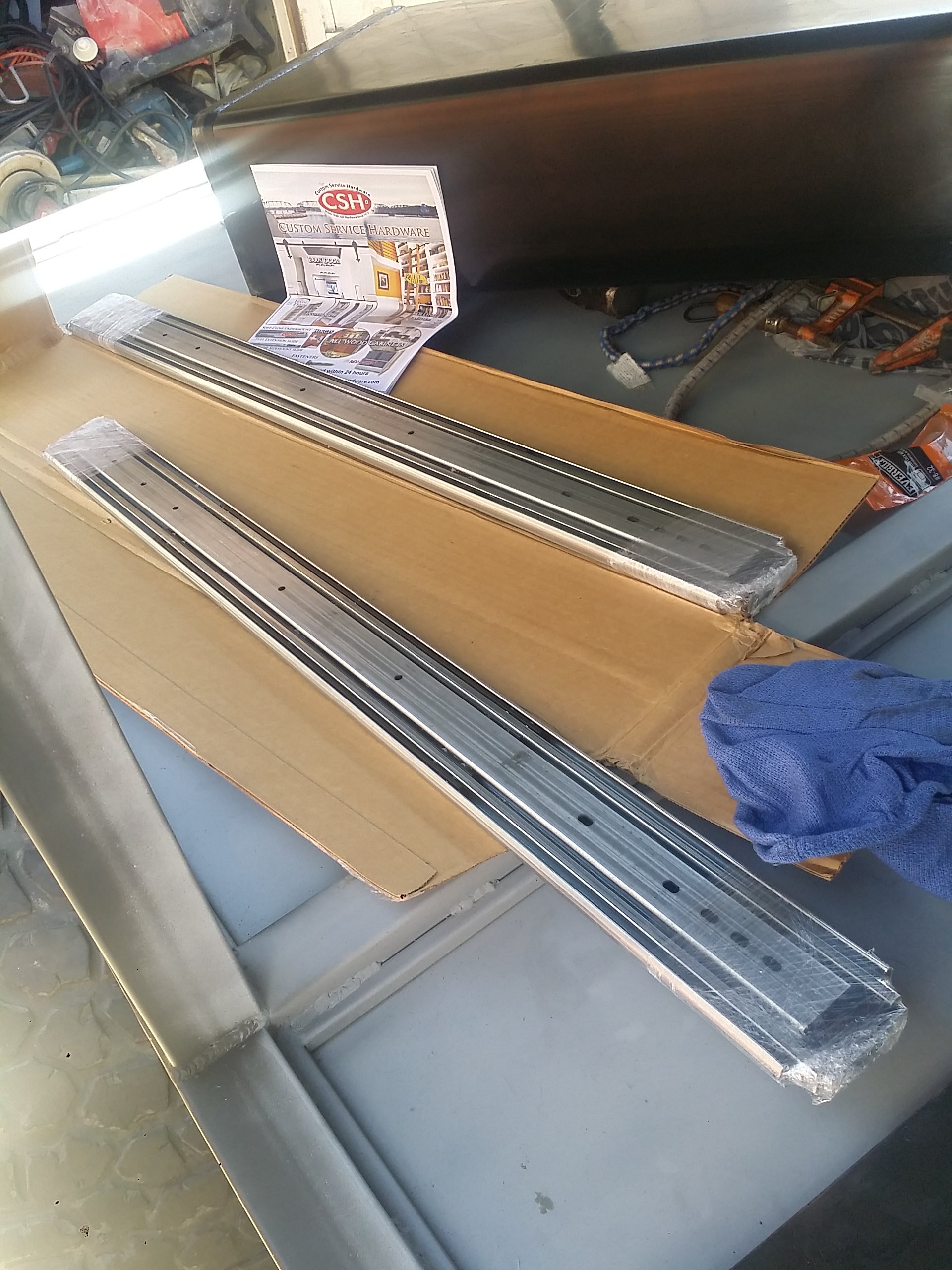

Here are the super heavy duty drawer slide for the 12v Engel Combi 60 Liter fridge/freezer that will be housed in the front of the rear compartment. These are rated to hold up to 500 pounds. Seems a bit overkill for a 75lb electric fridge. Even while all loaded up I'm sure it won't weigh any more than 125lbs. So I know these drawer slides will be more than sufficient to handle the weight of a loaded up fridge. They measure 36" long while closed, 3" tall, and 3/4" thick for each slide.

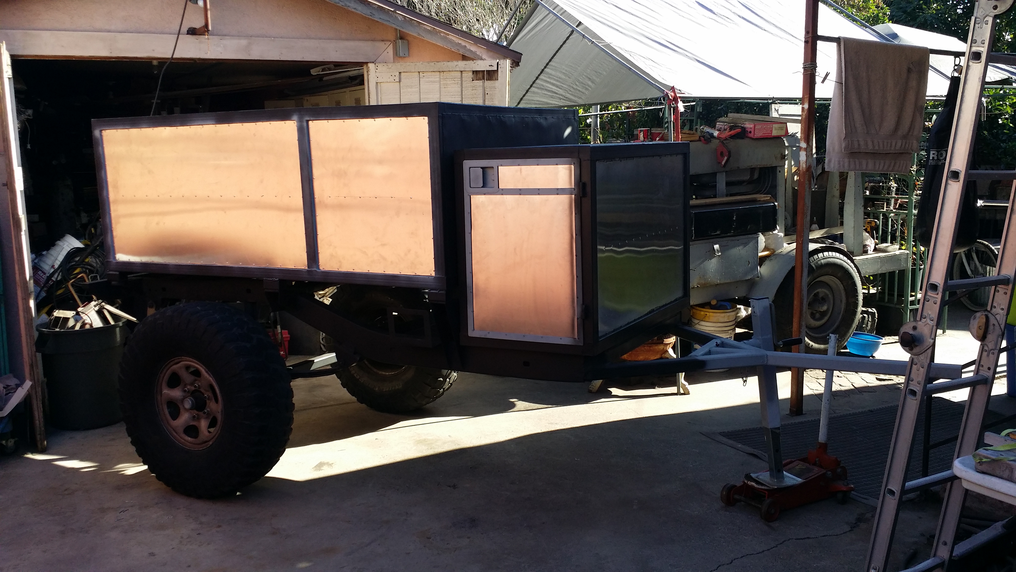

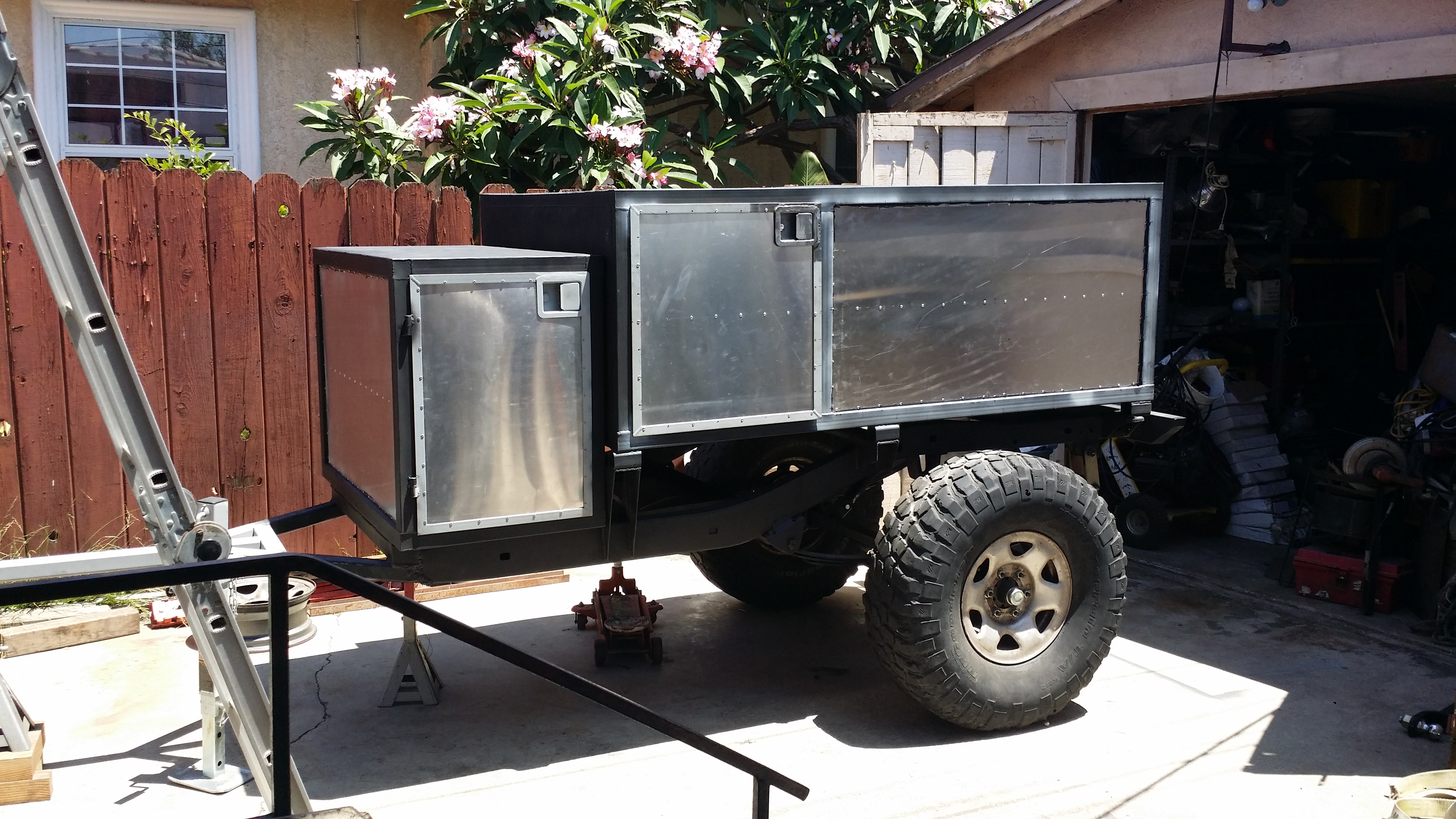

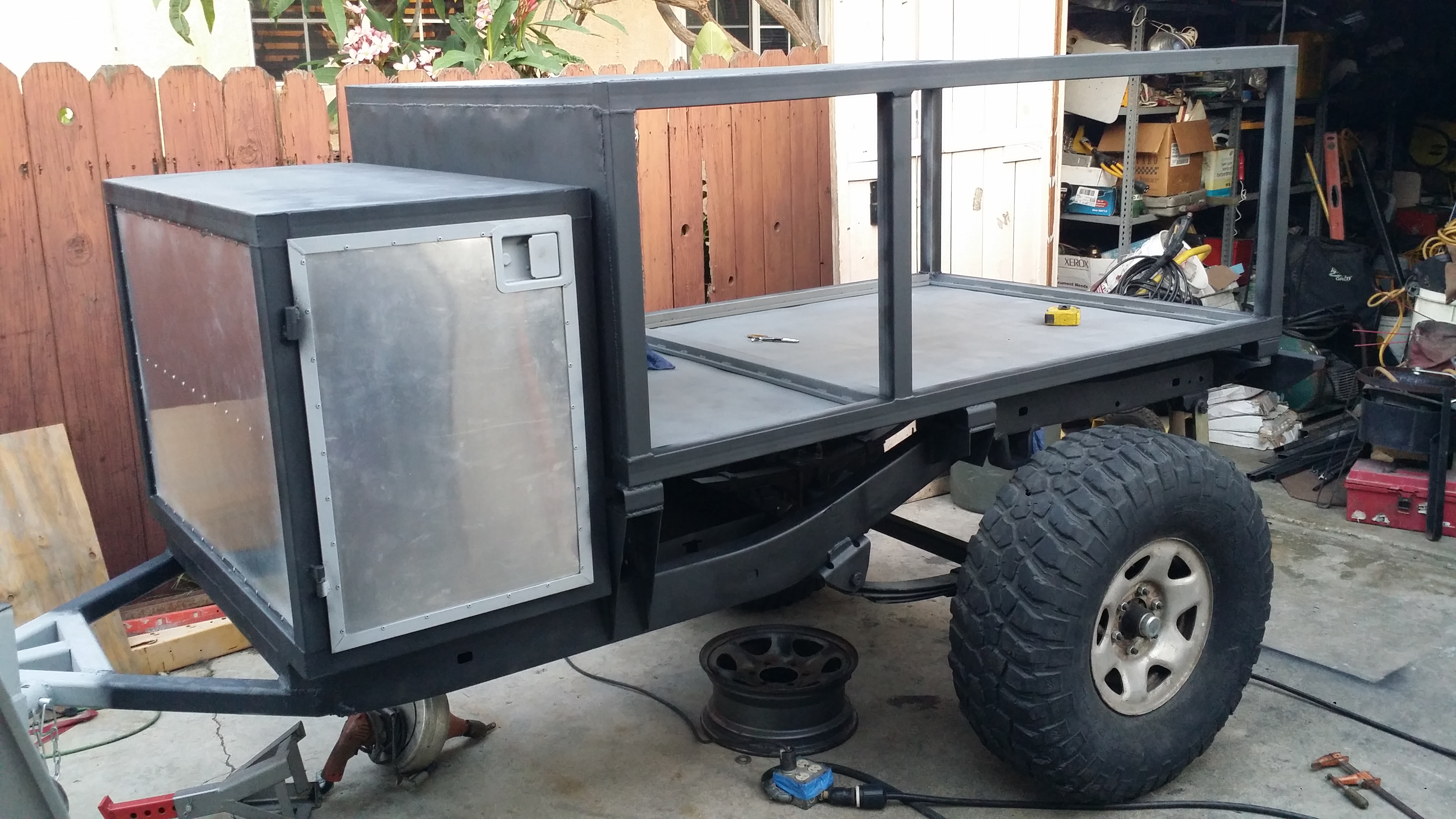

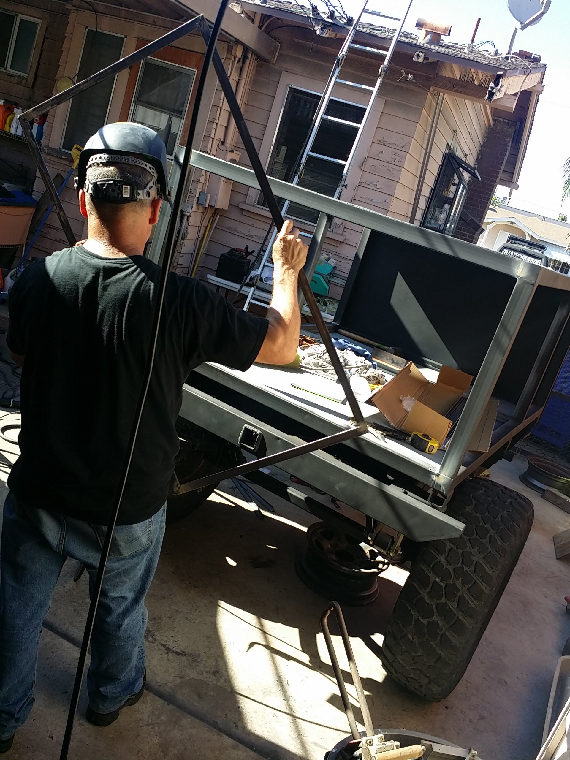

Dad and I working on the remaining 2 doors to the trailer. This one is gonna be the large rear 46"×24" door that will open upward toward the roof and be held open when small camper shell shocks.

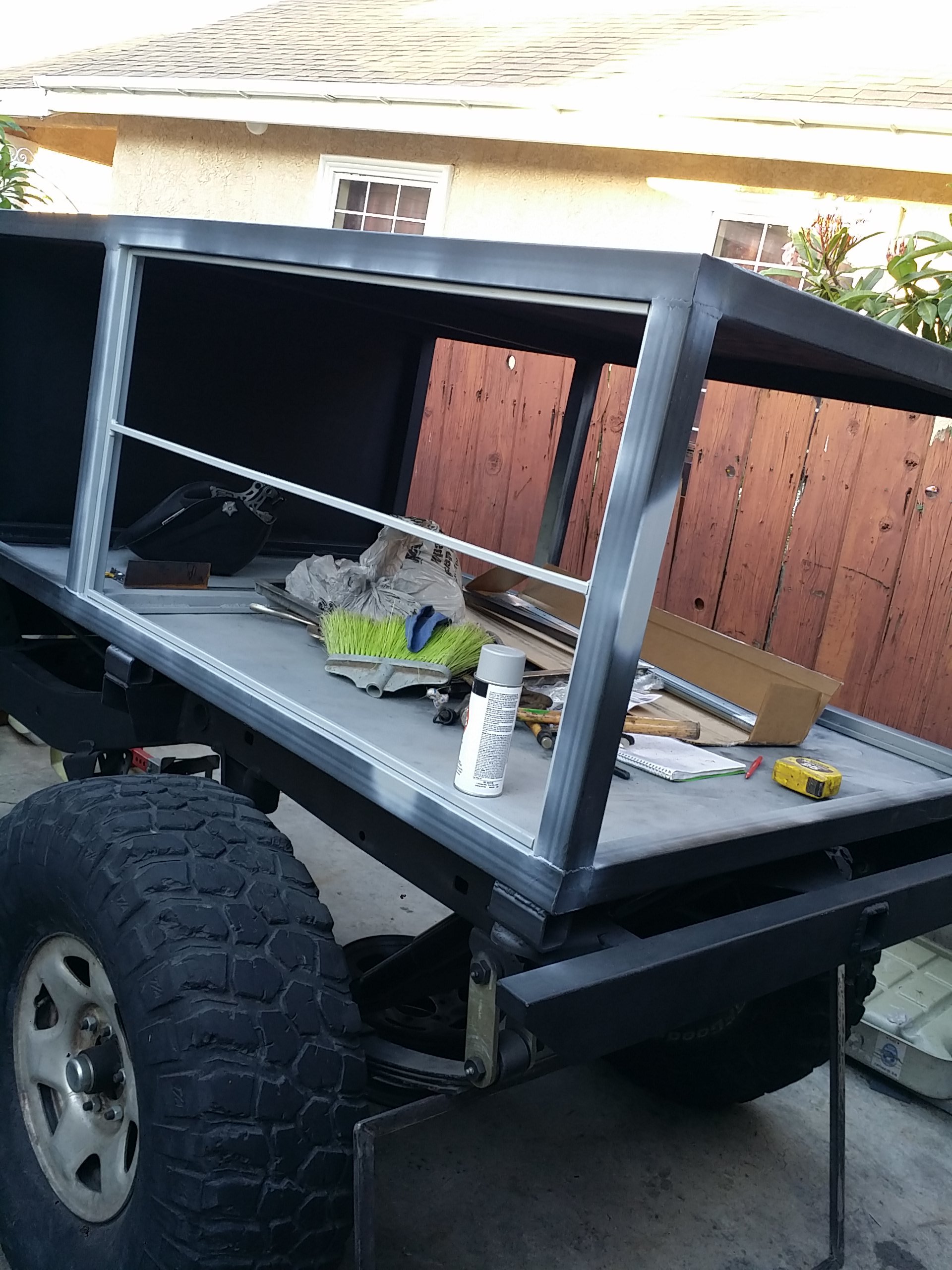

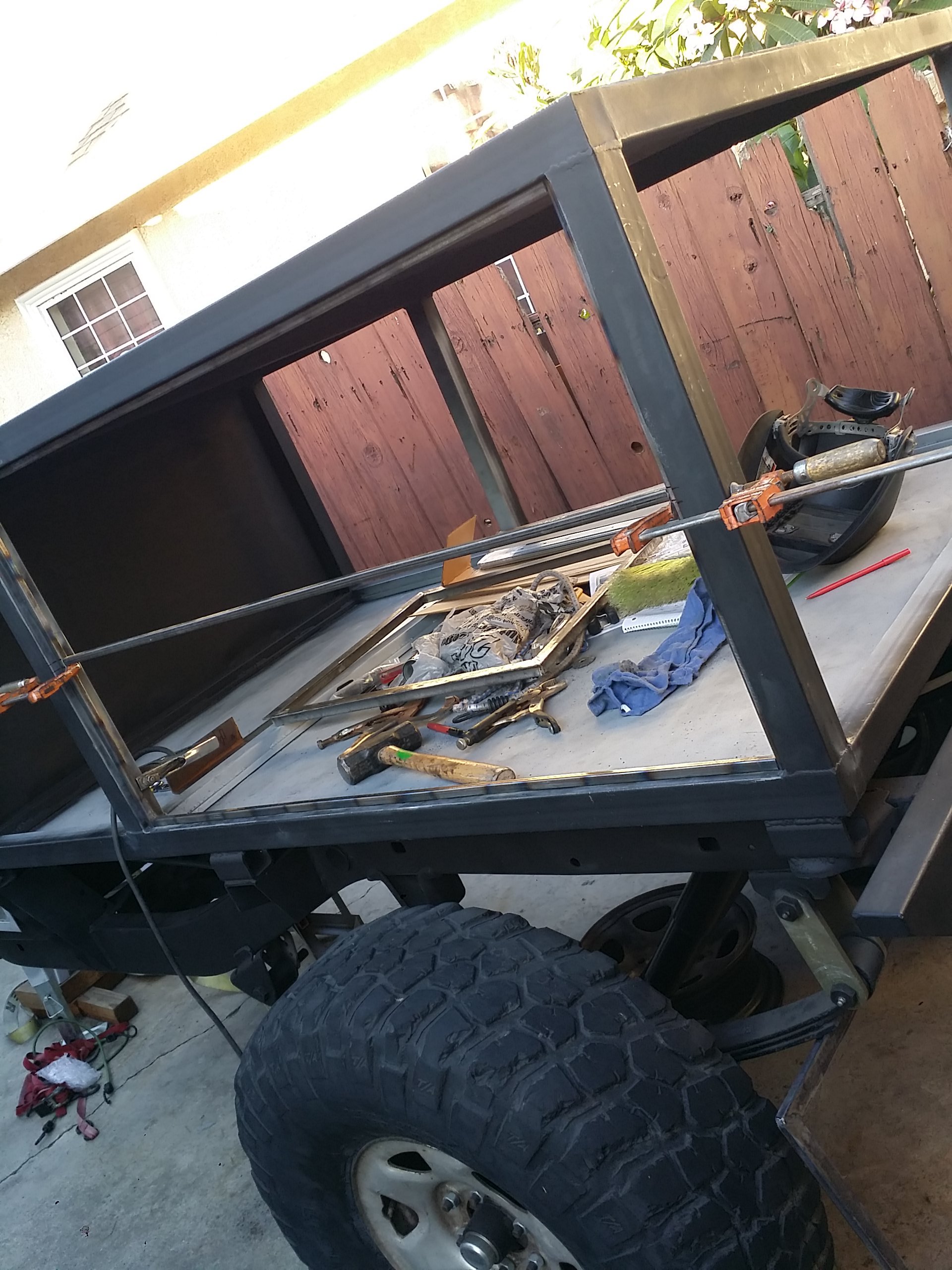

Took a break from the doors to weld on the skeleton or framing along the inner portion of the box that will hold up the rear driver side aluminum wall along with a center support to make it more sturdy but also keep the noise down when on the trail. The aluminium walls be held in place with 5/32" thick aluminum pop rivets just like the entire front compartment was made.
Here's the finished view of that driver side wall

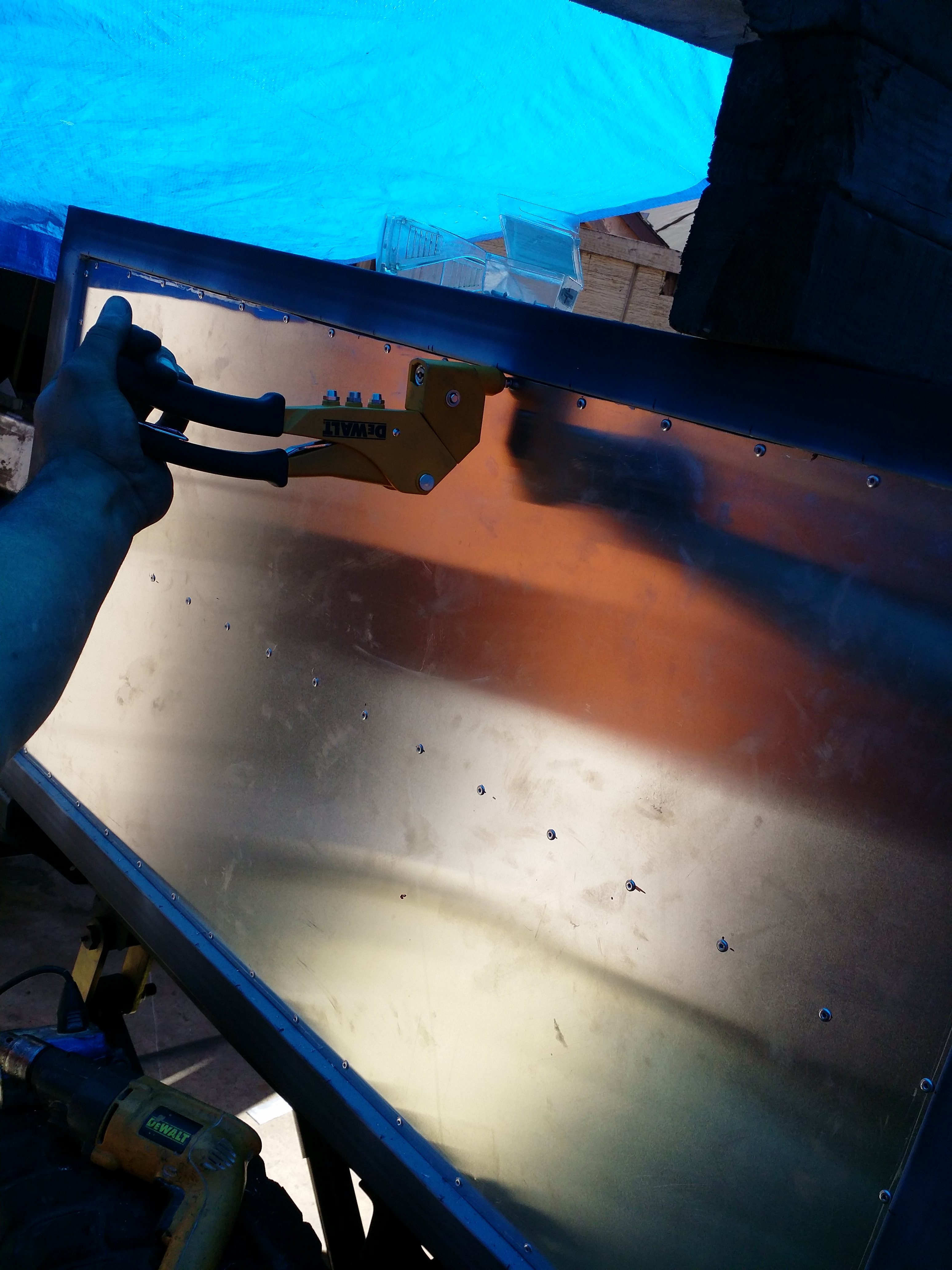

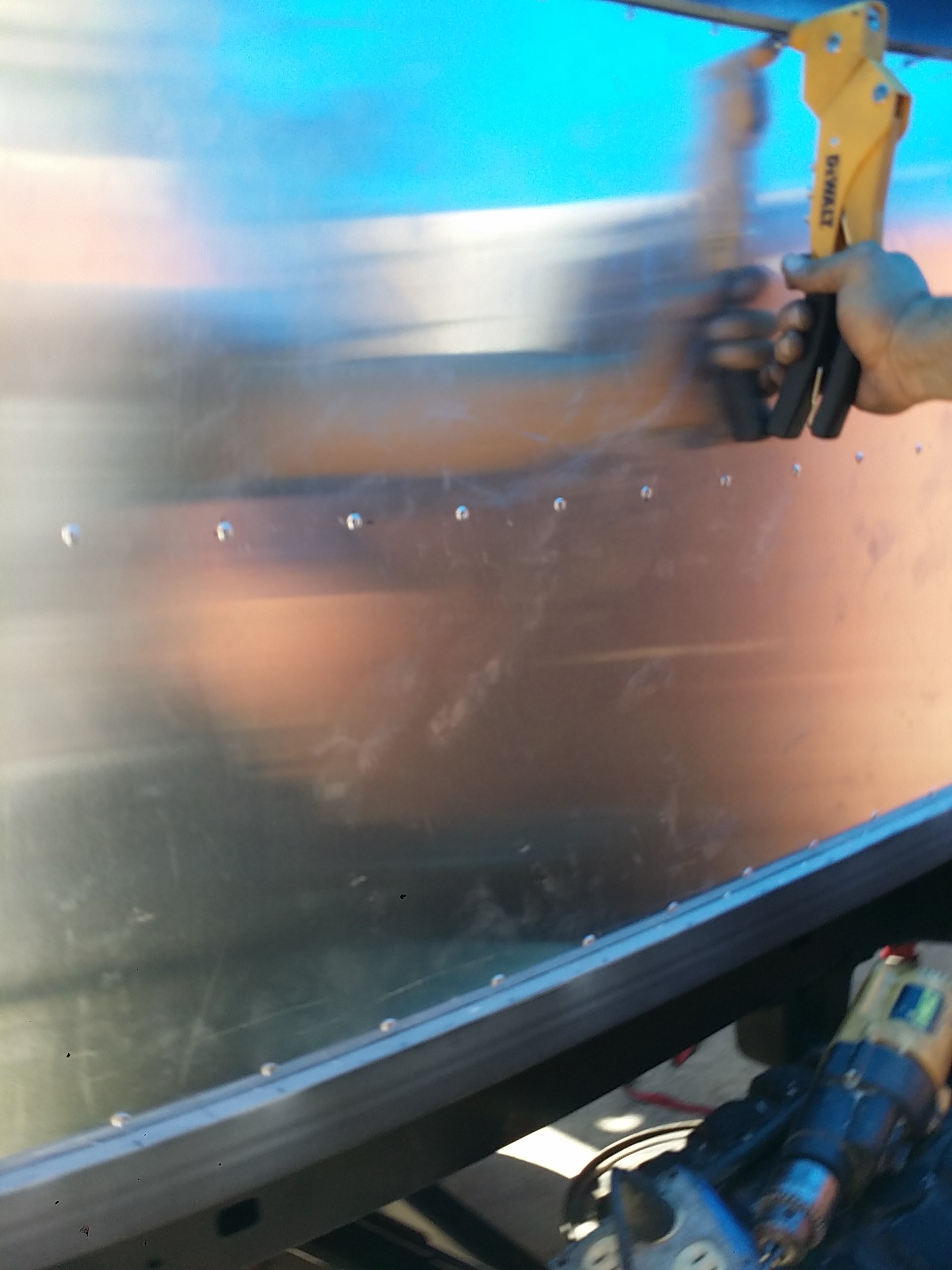

Pop Rivets every 3 inches seem to be the perfect distance to look nice but also to hold the walls up well. and this articulating Dewalt pop rivet gun makes every angle a breeze to get to.

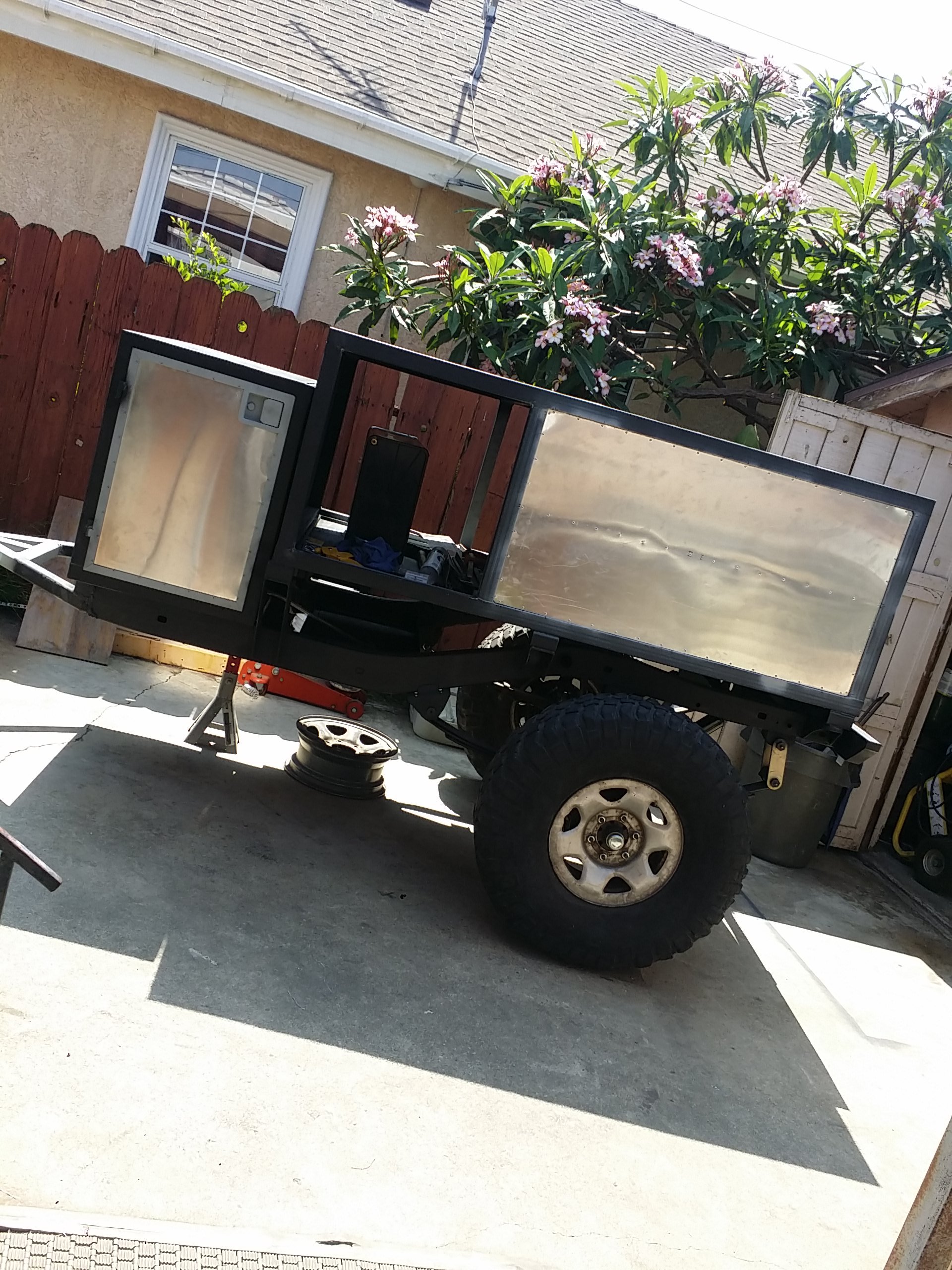

6 hours later the entire passenger side of the trailer is completely framed and aluminum walls are permanently riveted into place and looking really sweet. This trailer is really starting to look more awesome every time I add more stuff on to it! Ohhh the anticipation! Can't wait!
Here is where got around to making the side compartment door that will open up to my future Engel Combi 64 liter Fridge/Freezer. But before I could completely finish it I ran out of pop rivets and paint so I gotta head back to home Depot and buy more supplies. Hoping to have this door and the rear compartment door finished by next weekend so I can start on the fenders, rock sliders and begin on some of the electrical trailer lights.

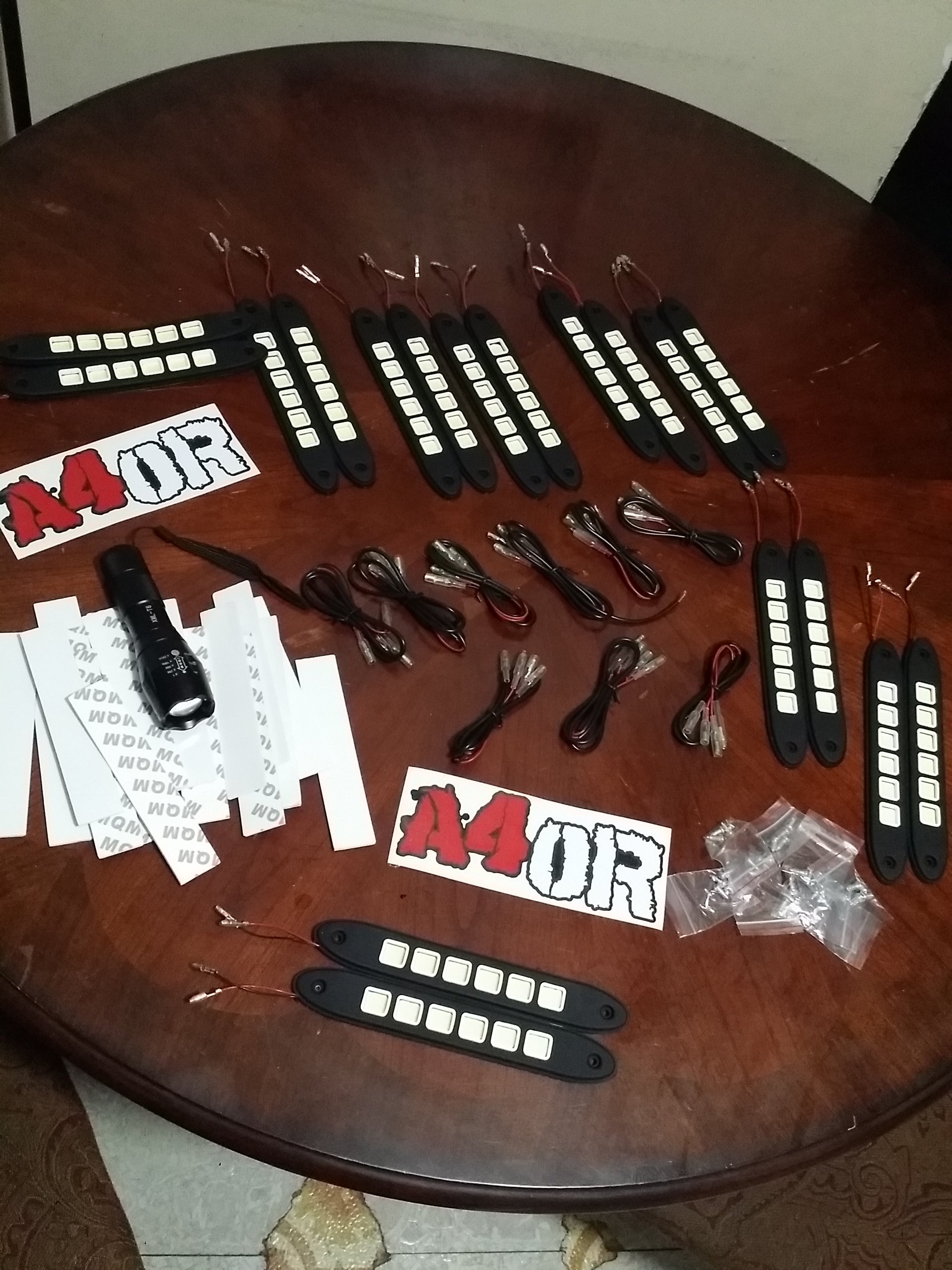

Also here is a hand held remote controller/relay assembly that i bought from SuperBrightLEDs. My buddy Mark (aka: Chefyota4x4 on Instagram & Yotatech.com) runs this set up and i works amazing. and for only $23 bucks why not right? It come with 2 controllers.
https://www.superbrightleds.com/more...key-fobs/1532/
Here is a quick video of how it works:
I went with a 2 channel relay because i plan to use 2 sets oif lights on he trailer. 1) Rocklights for the floor directly under the trailer, and 2) exterior lighting to light up he immediate camp ground surrounding my trailer with the low power consumption LEDS that i posted up above made by All4Offroad.

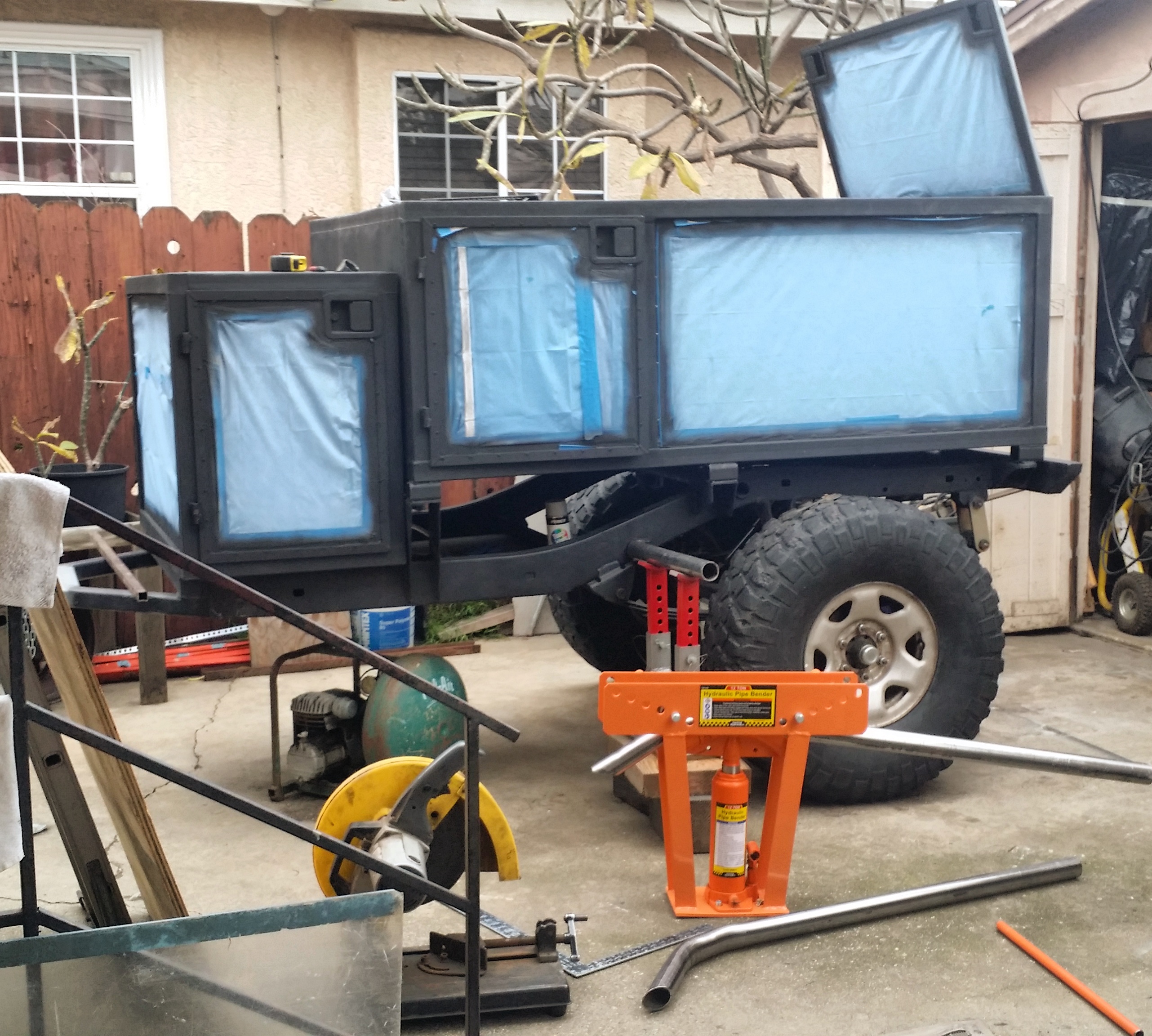

With the holidays an much rain we have had over the past few months I've received so much call and overtime at the hospital that i work for that my trailer project has just been on the back burner for quite a while.
Maybe now that the weather has been starting to clear and work has finally slowed i'll finally manage to get some sort of work done on the trailer. This past weekend was the first day i was able to get a few hours in for nearly 5 months!
I worked on bending some tube for some light duty sliders/steps. which will also double up as a surface to mount the fenders on to along with he tail lights, license plate holder, and 12"x18" mudflaps. I did not finish fabricating them but i did manage to get the bends perfectly made with the cheapie harbor freight tube bender. I wanted a reasonable thickness to be able to handle a bit of banging but the trailer wont see too much of a difficult time on the trail so i didn't want to go too thick like 3/16". But i also didn't want to use 16 or 18 gauge wither because that's still really thin so i went with a 1/8" thick. round tube.
I did not finish making the sliders because i began getting late. We are expecting a clear sunny weekend this week so I'm really hoping to get the sliders and fenders made. and installed finally and if time allows me to i'll make the mounts for mud flaps and mount those too.

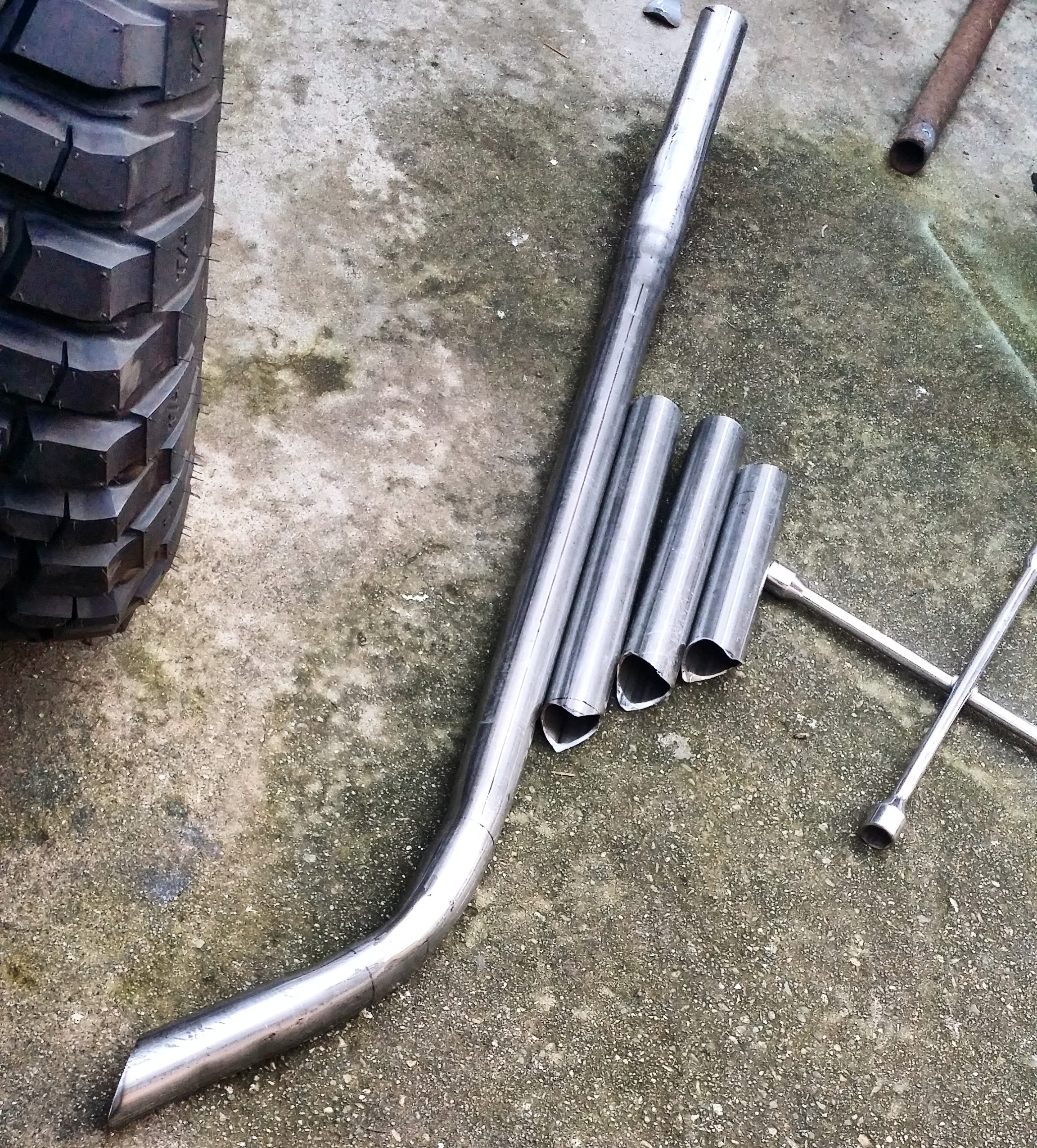

Hey buddy, the bender works. It's just a real pain in the butt to get the bend you want and its especially hard to make 100% matching sides. lol mine are gonna be slightly off. but for the most part they are the same.
I definitely would never encourage using this bender for an exo cage though. I would be so hard to make.

Well in making these sliders i have learned i hate notching tube lol especially if the attachment points are not exactly at 90° angles but instead meeting on a tube going at an angle like these sliders are. by the 2nd set of attachment points i was already good at making them. but they're still a huge pain in the a*s to make. we had to stop making the sliders for today because my hole saw accidentally jumped the tube and got caught into my girls right arm getting caught on her sweater. we're lucky she had a sweater because that's what the hole saw grabbed onto instead of her actual skin. her arm is a bit bruised from where it hit but she's gonna be okay. i feel so guilty though.
Tomorrow's another day. We're expecting it to be nice and sunny outside. I should have both sliders welded together and actually mounted on the trailer. If i get lucky enough to have spare time maybe i'll start working on the fenders and the mudflap mounts.

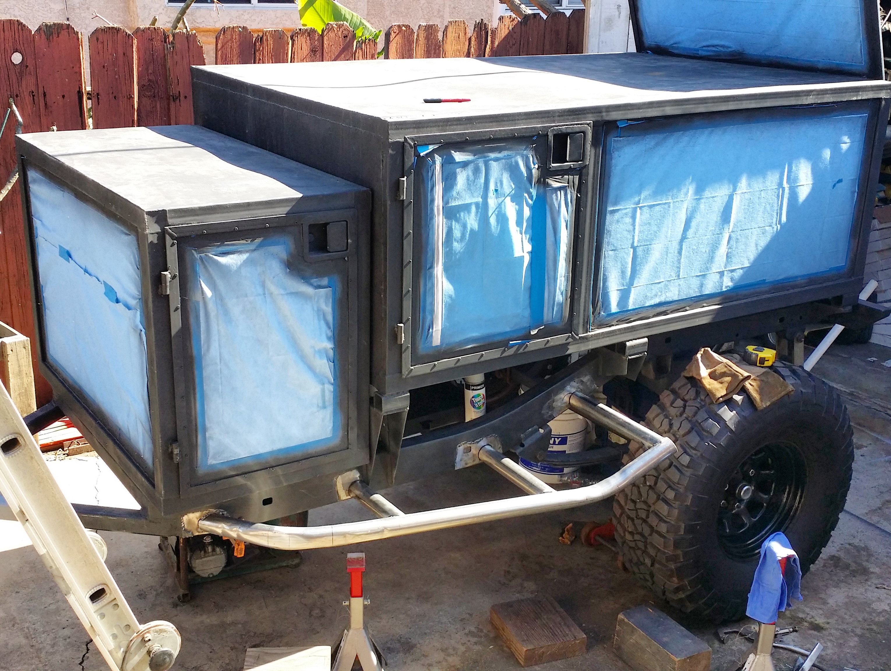

Here i had just tacked together the first set of sliders. Managed to weld everything together and permanently mount them to the chassis. I primed them for the mean time to prevent surface rust. Next weekend I'll start on the fenders.
It is coming along nicely. These sliders were pretty difficult for me to make. I applaud fabricators; bending tube and notching has definitely proven to be a challenge for me.
