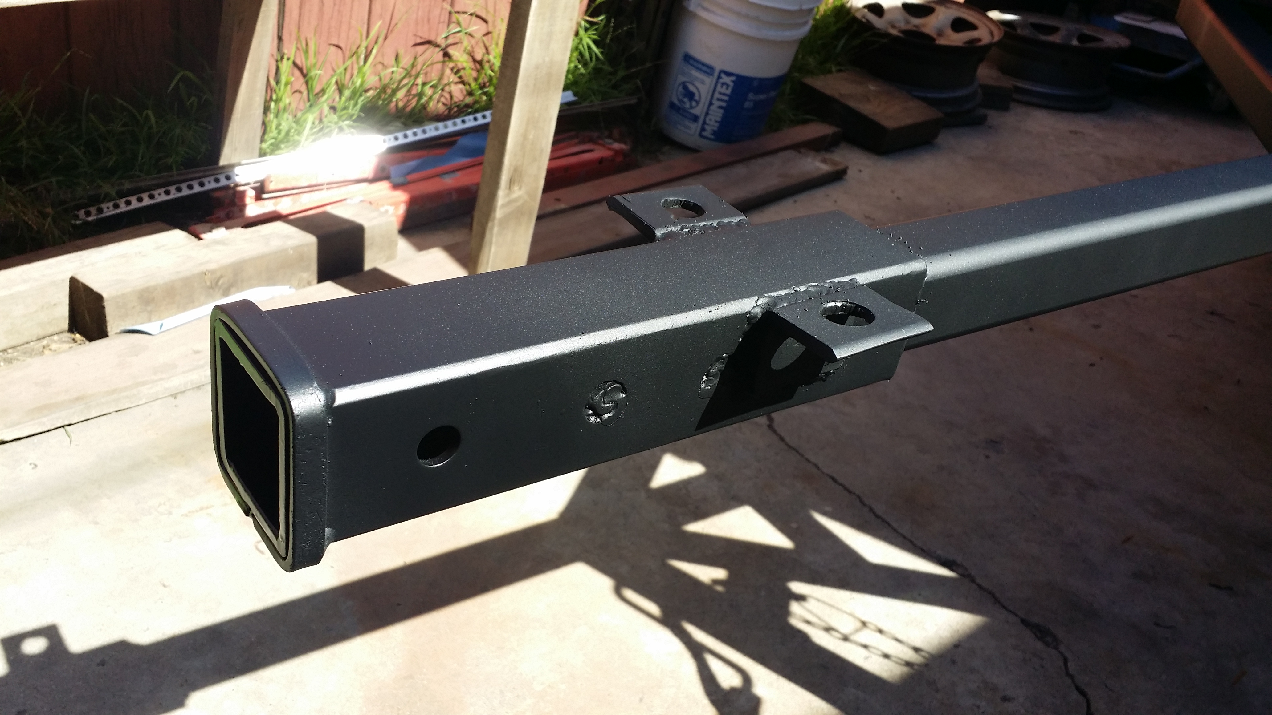

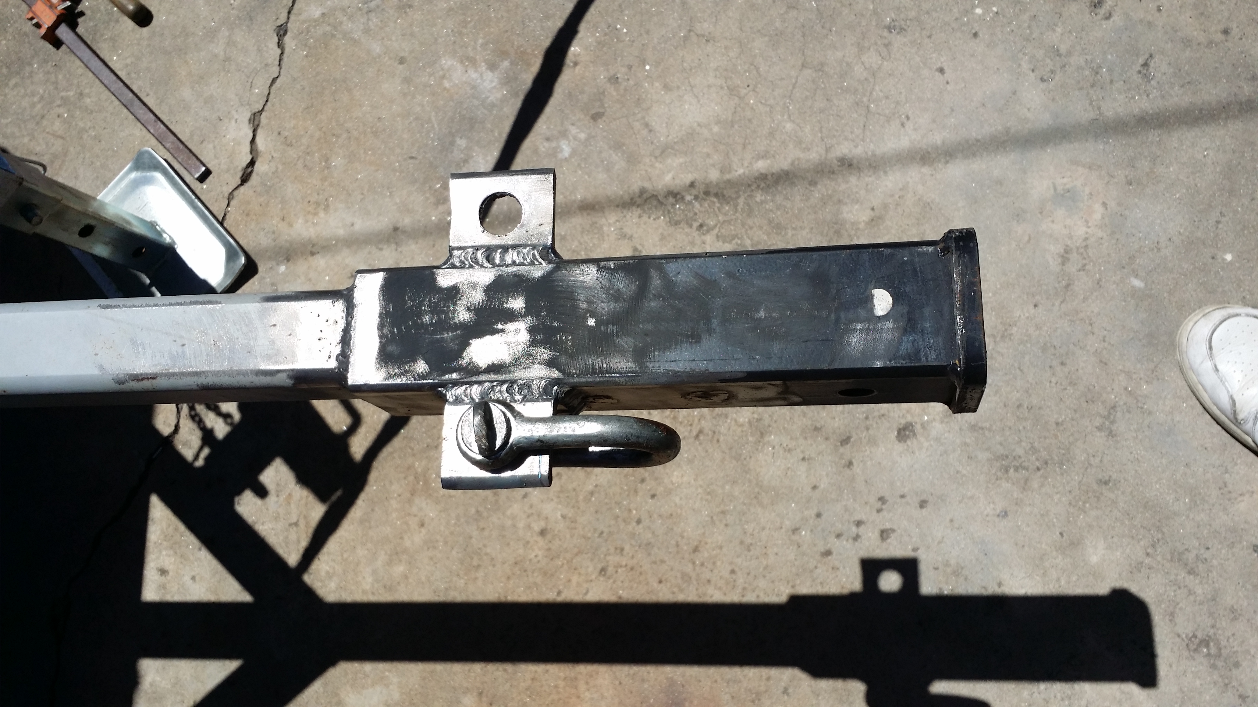

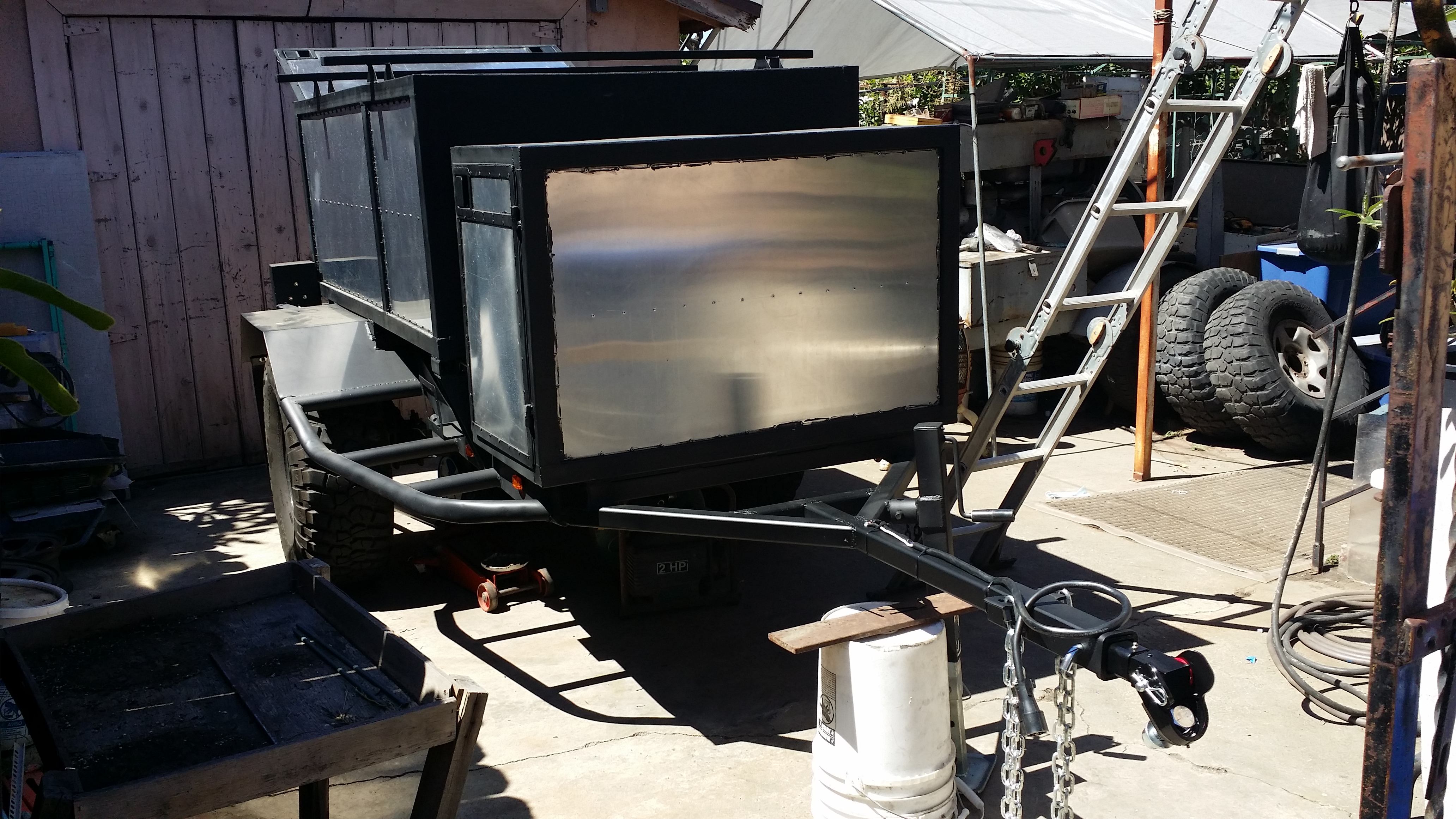

Went to the DMV and got 2 one day permits to take it in to get checked out. So far DMV charges have only been $40. After that I went home and welded on the tow hitch receiver and hoops for the trailer safely chains. I will be using D-Rings on those chains. Also primed and painted up everything. Painting is such a breeze when you have a paint gun! I only have this weekend to prep the trailer to look its best because come monday at 8:20am i have to take he trailer to the DMV to get inspected and complete the paper work to finally make it legal.

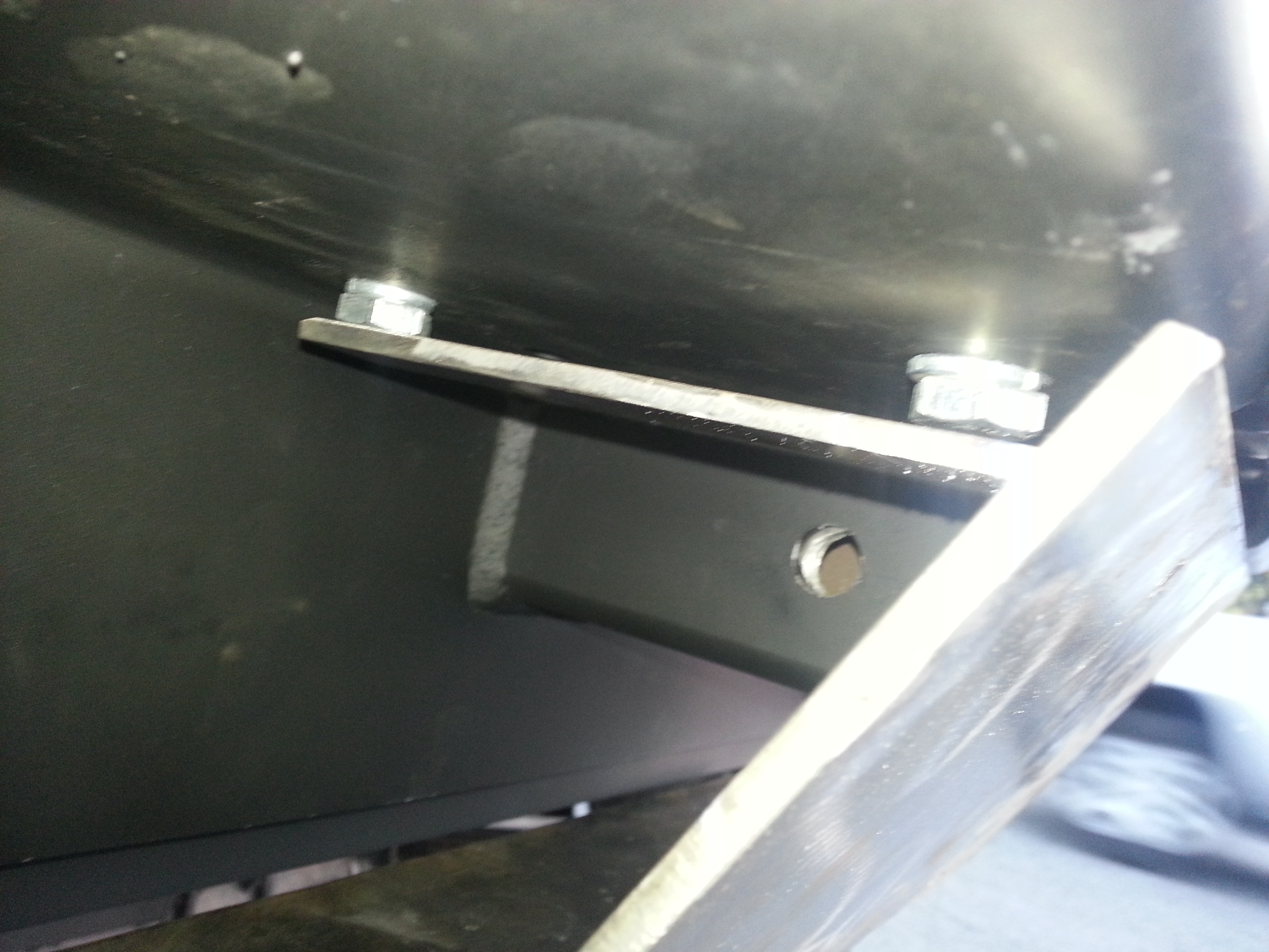

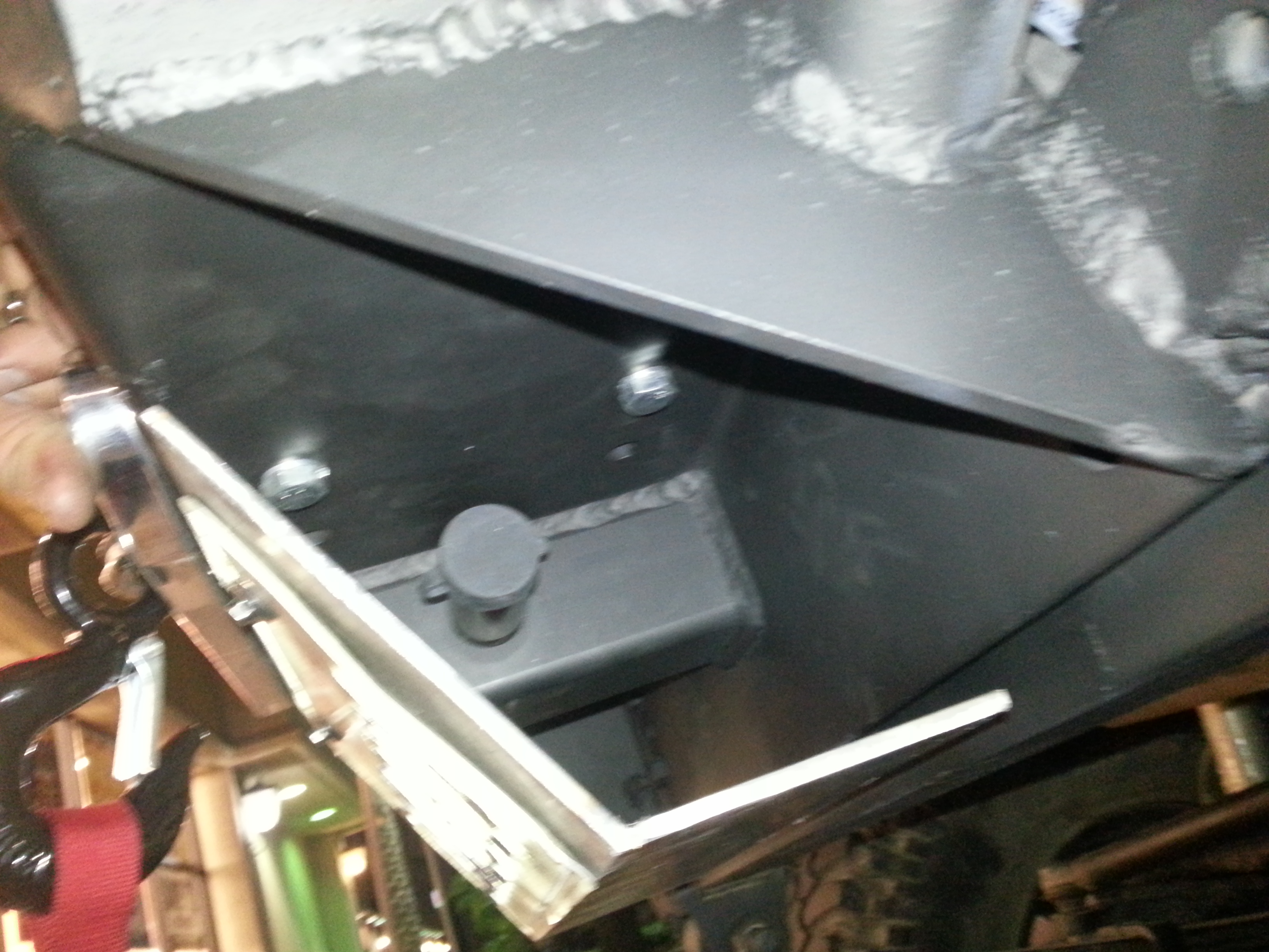

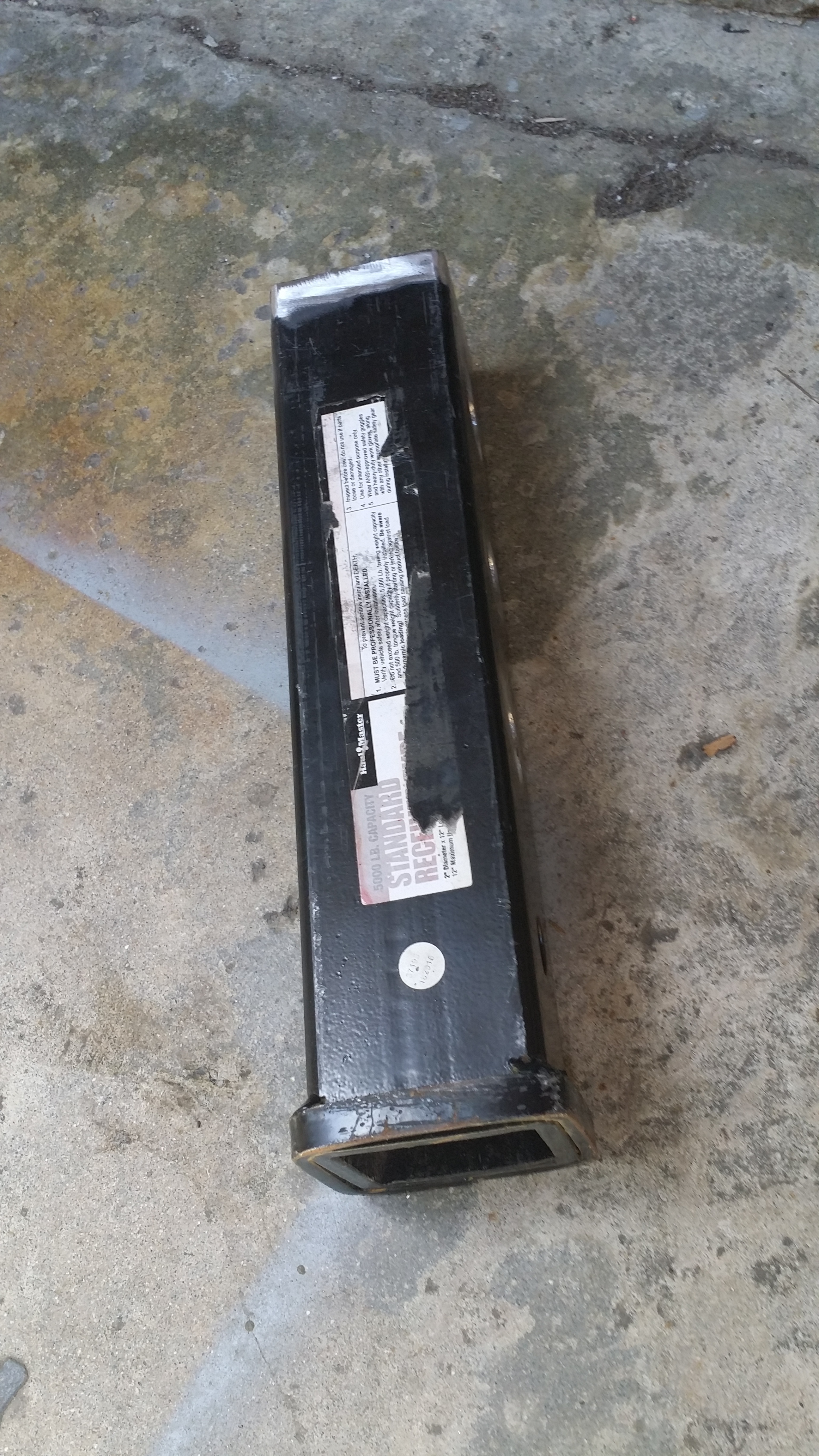

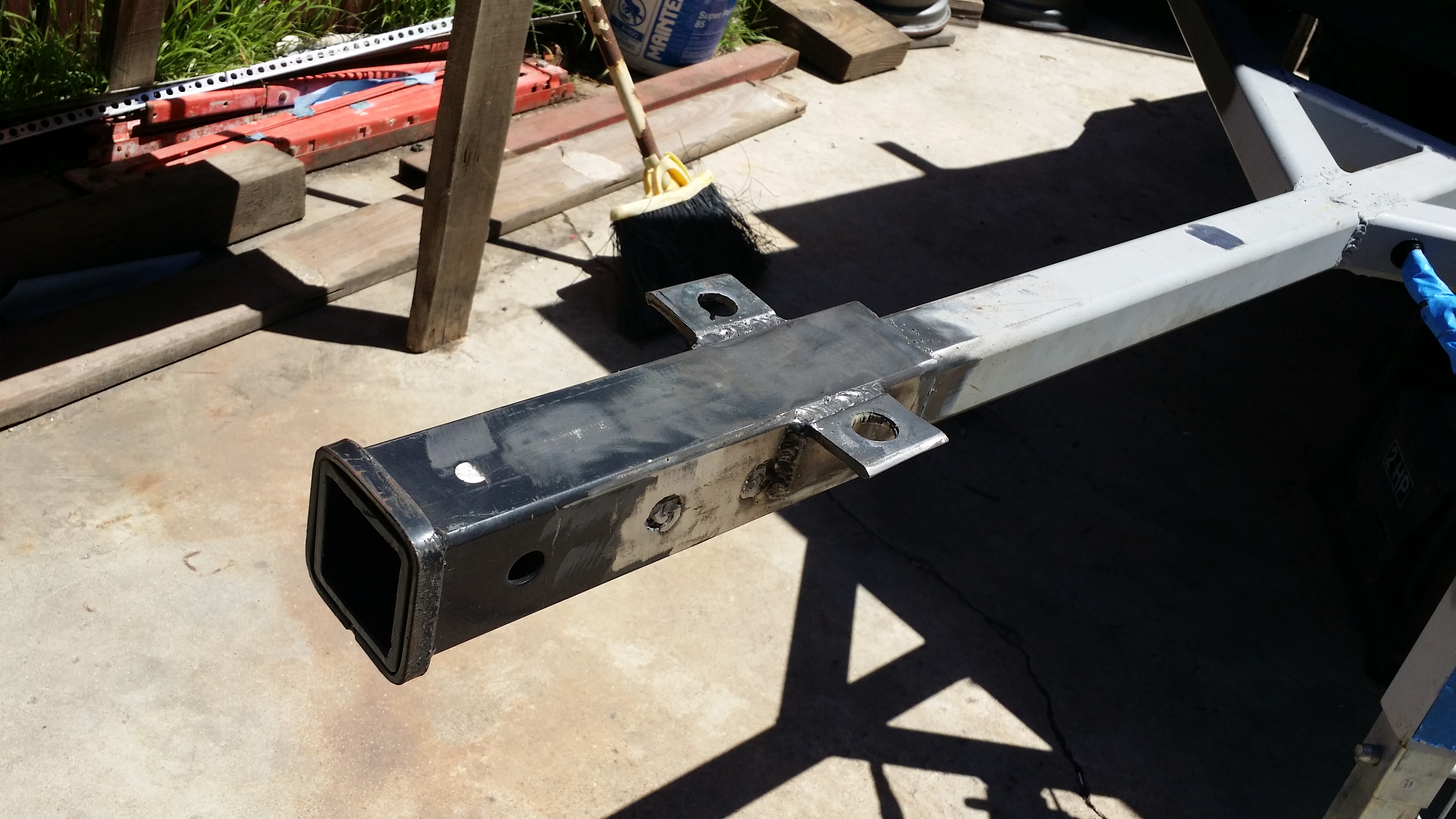

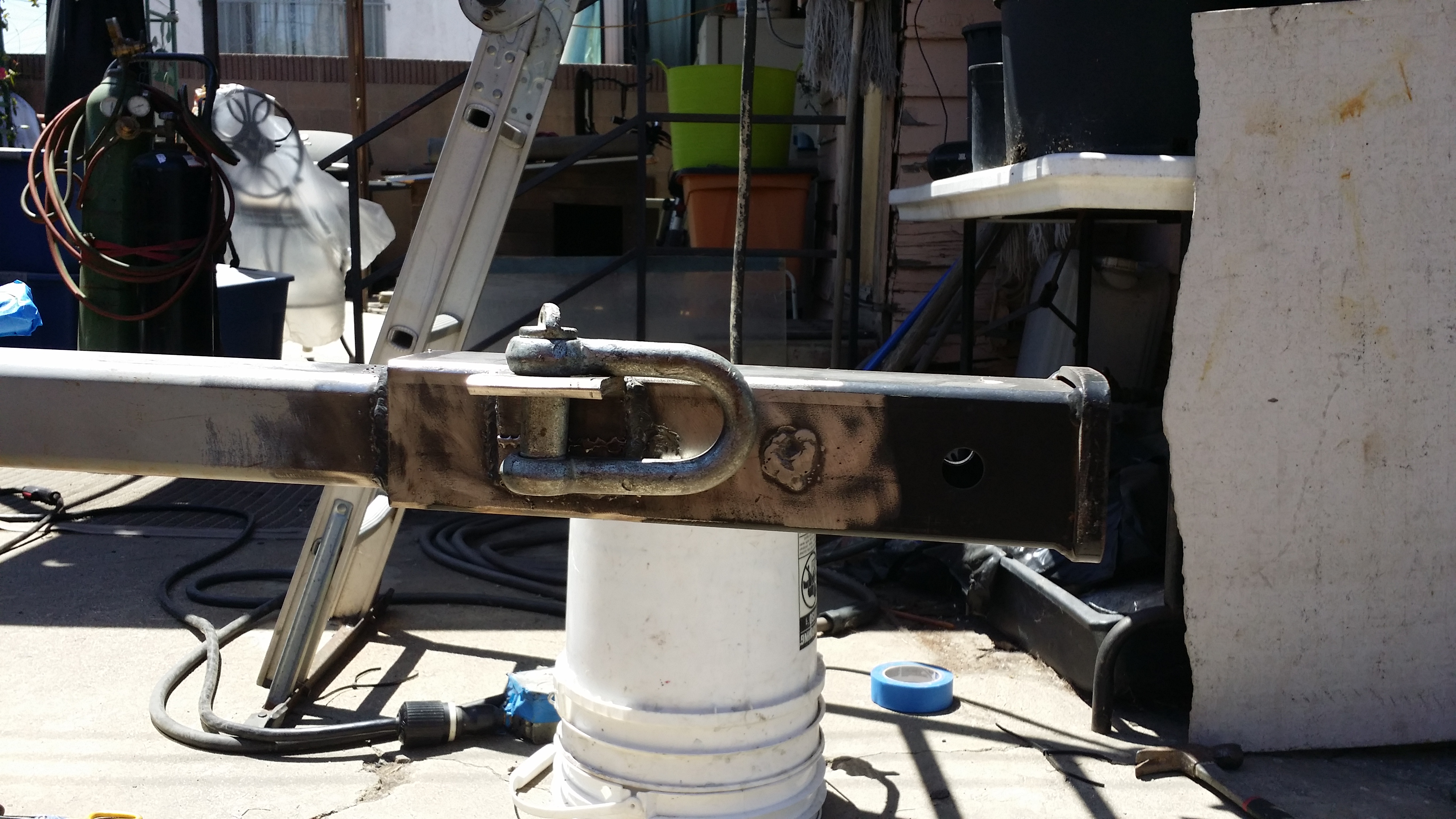

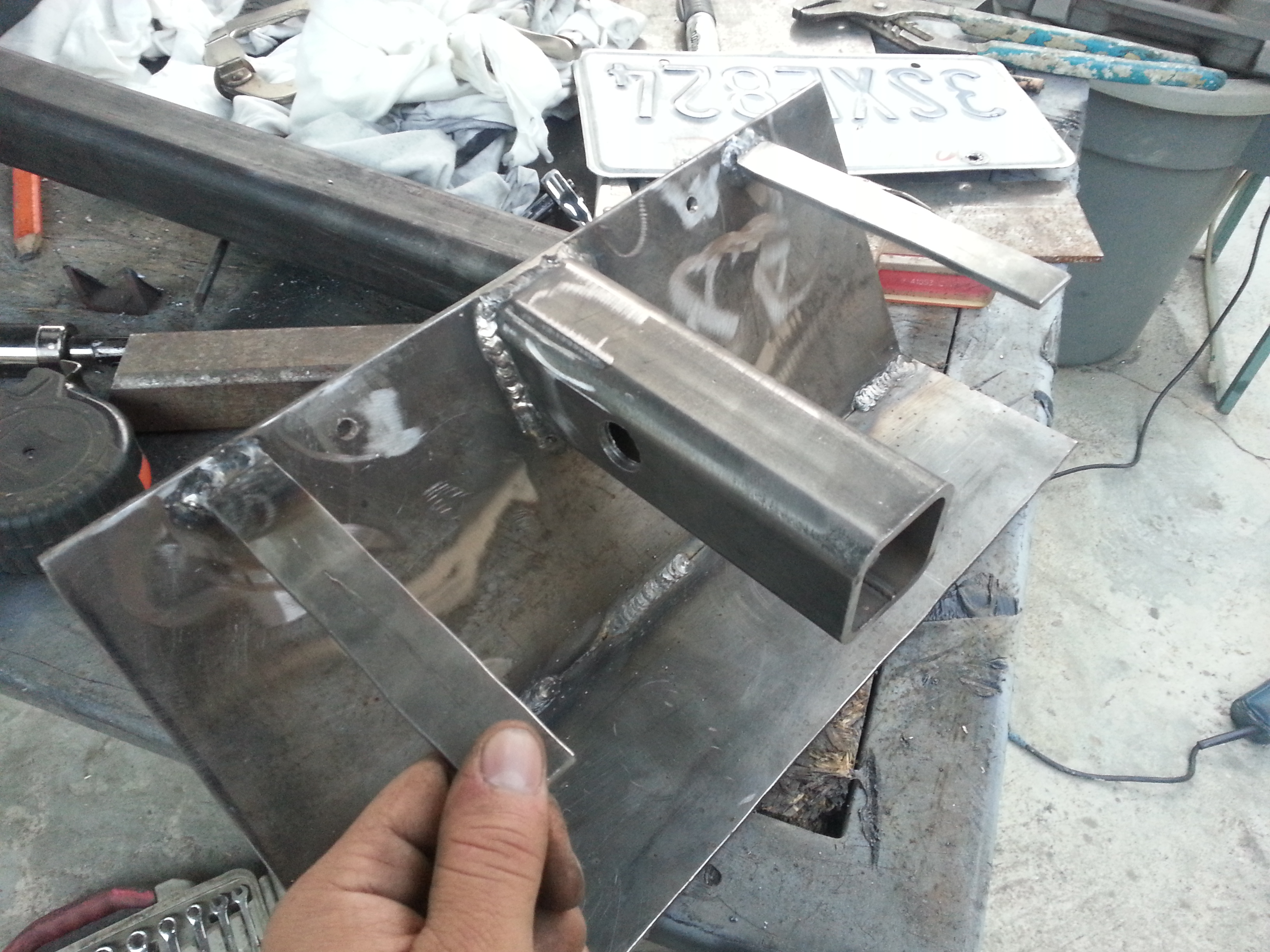

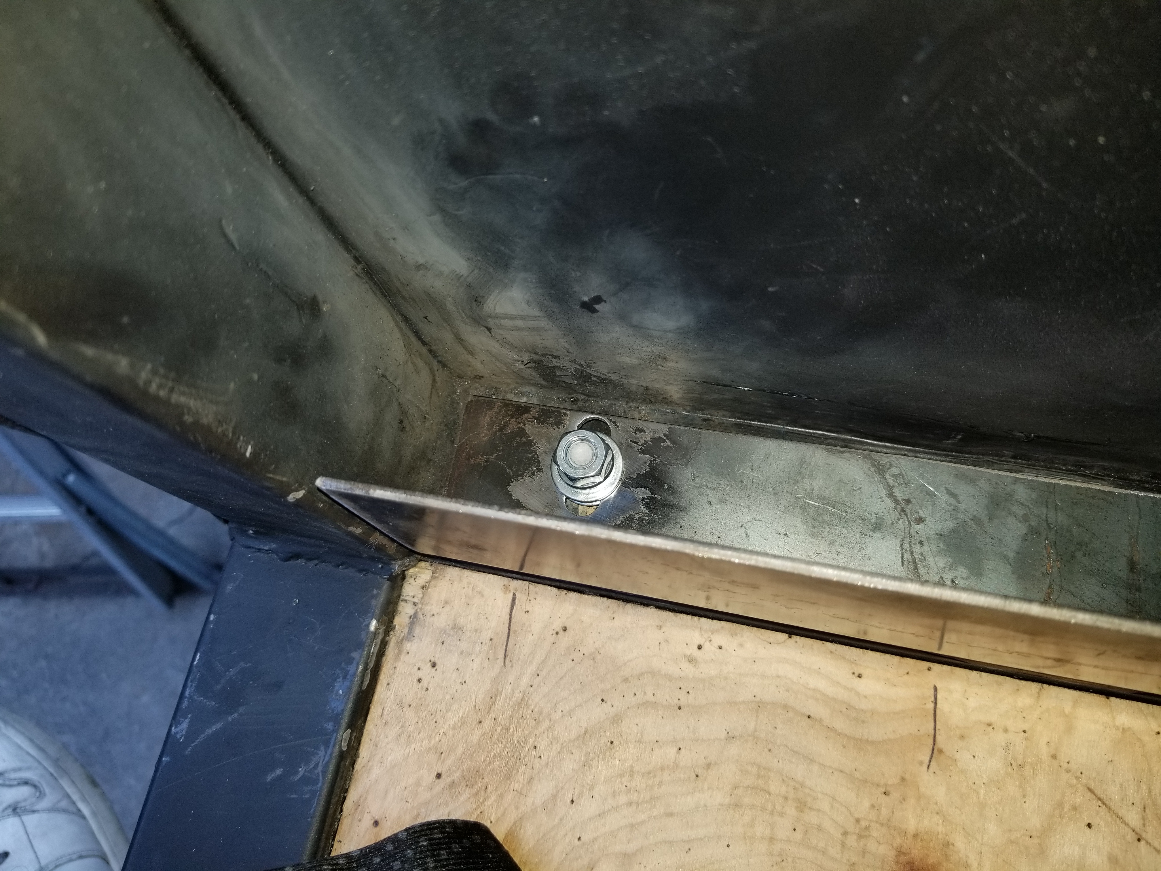

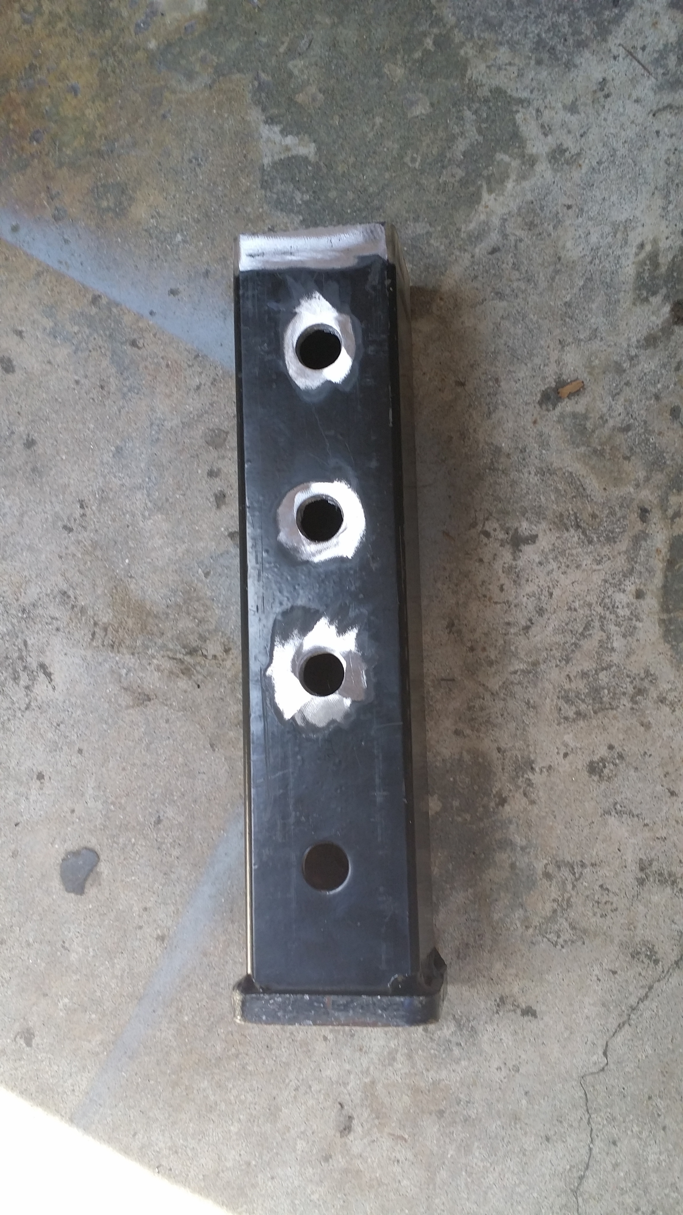

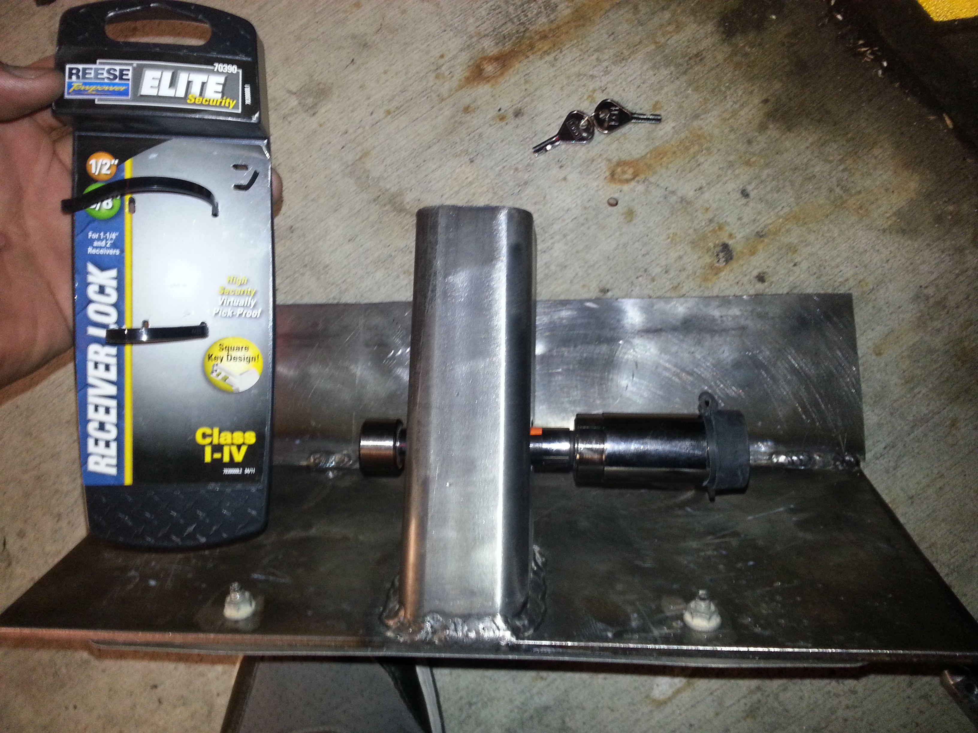

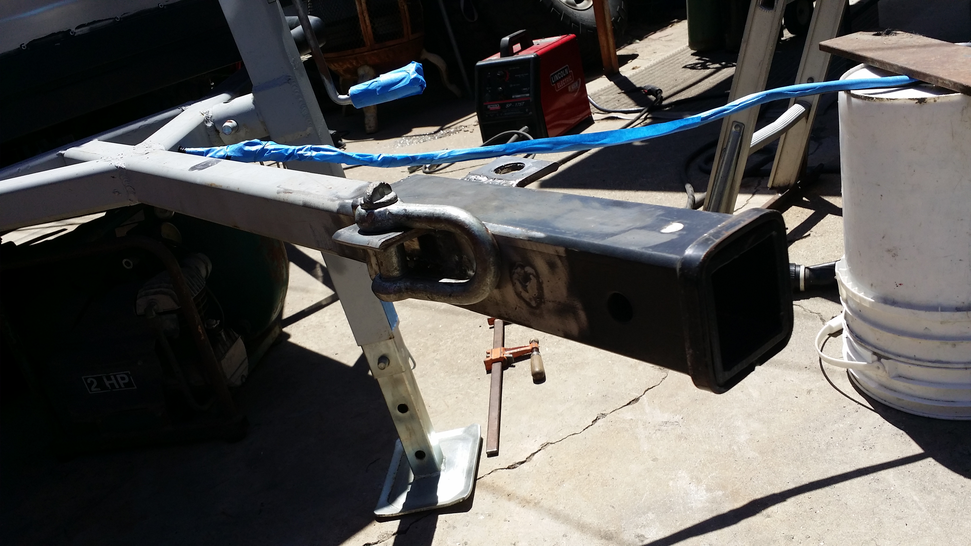

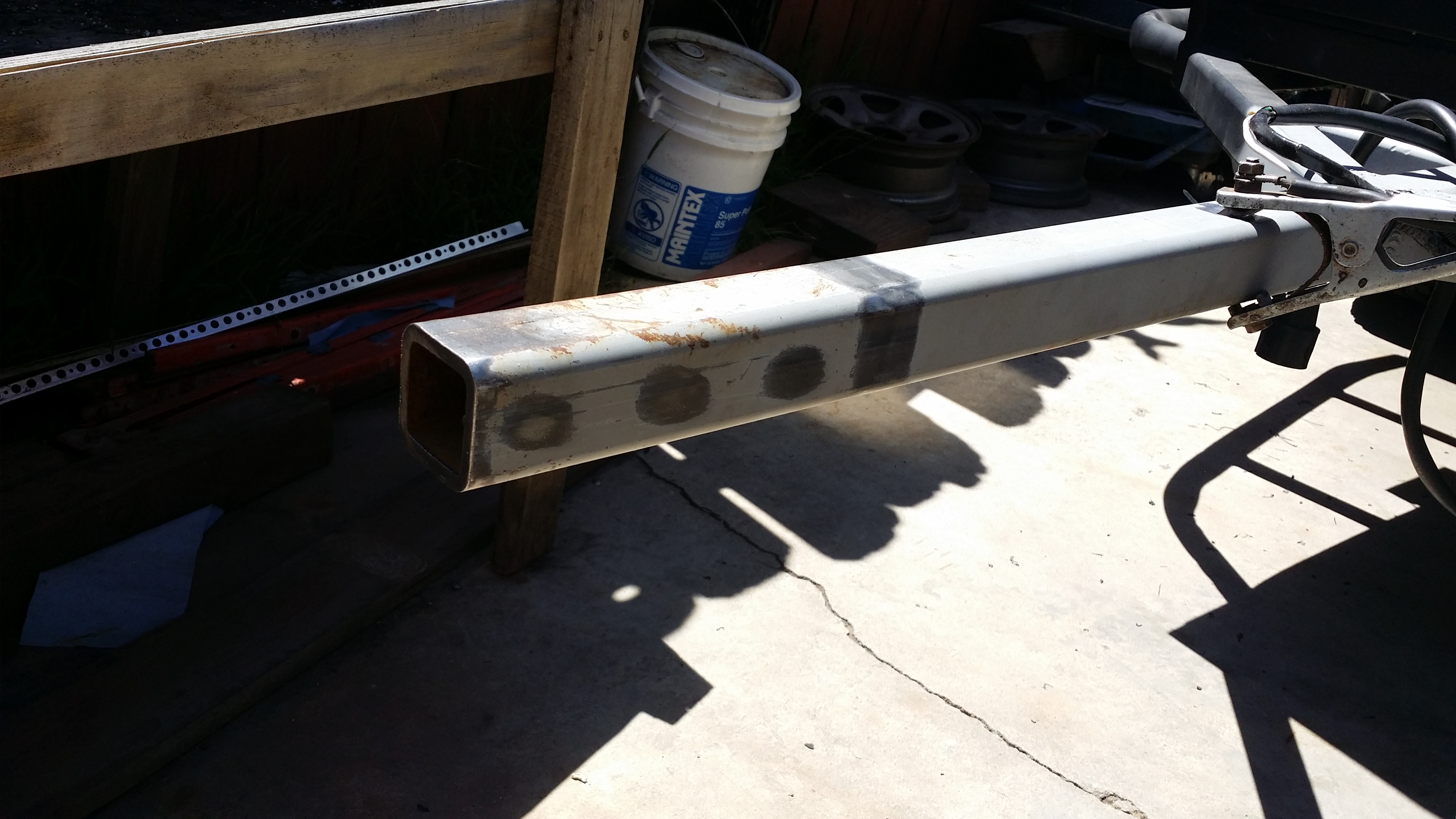

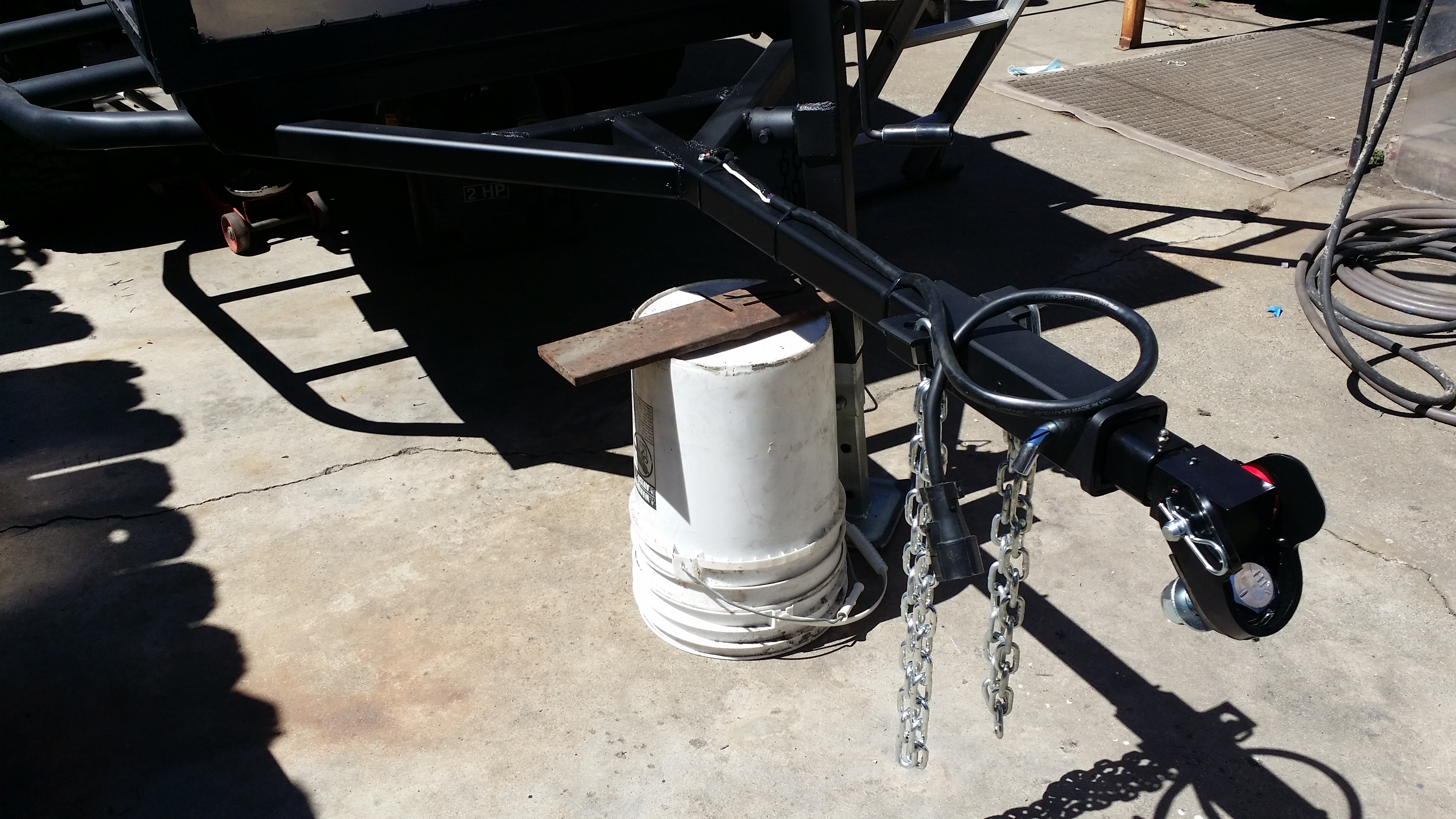

This is an 18" receiver that i bought toward the beginning of my build from harbor freight.

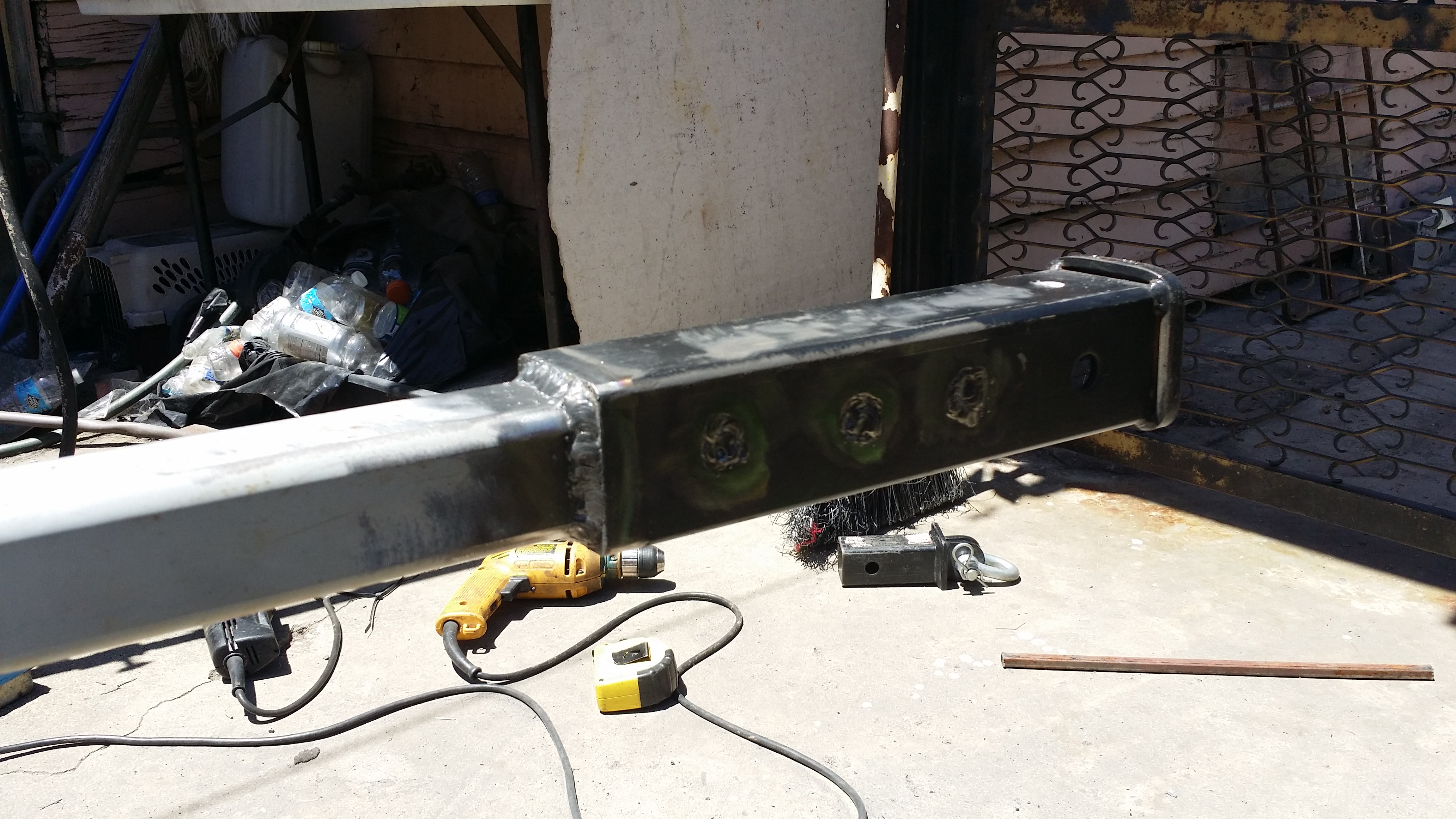

In order for his receiver to really be secure i did drilled 6 holes; 3 on each side, this way i can weld on the shaft of the receiver too not just at the end of it. I think it is much more secure like this. Especially if i ever plan to do some crazy trails with this thing.
Here you can see what i meant
I feel like it is much more secure like this.

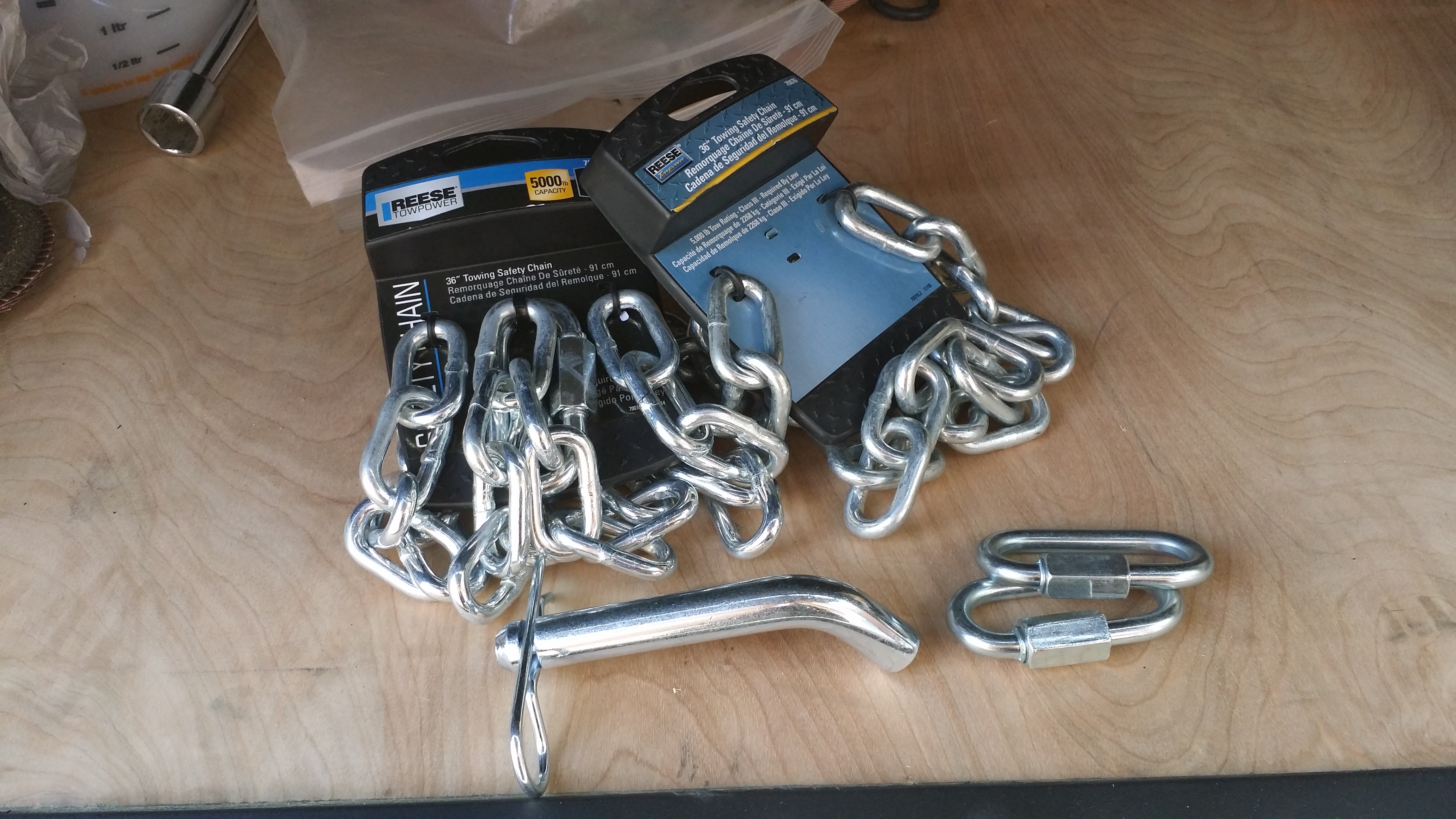

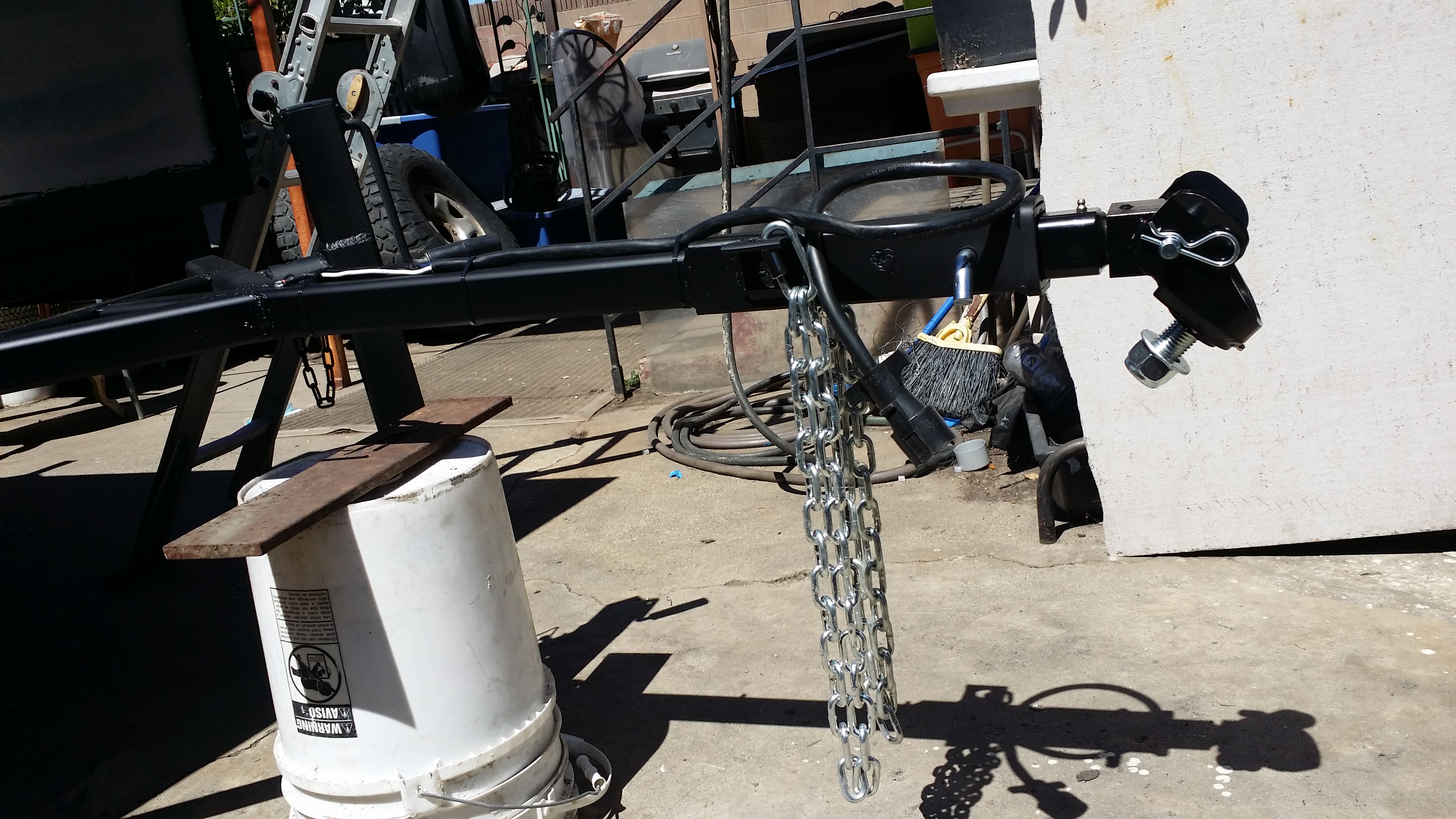

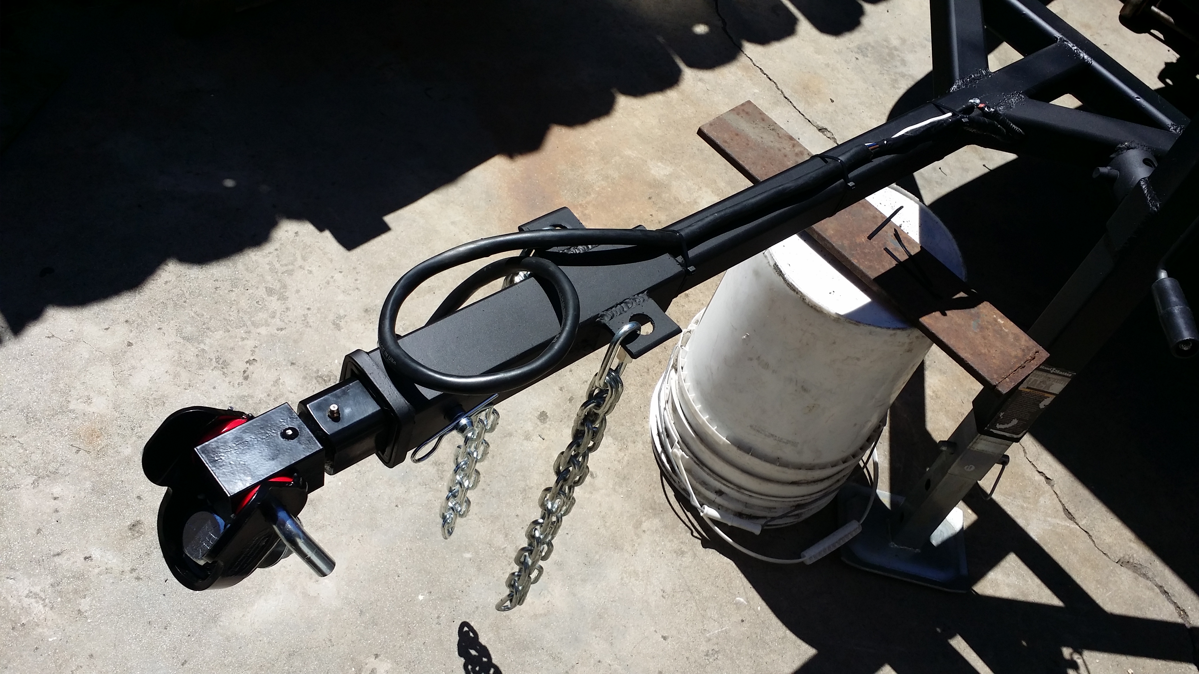

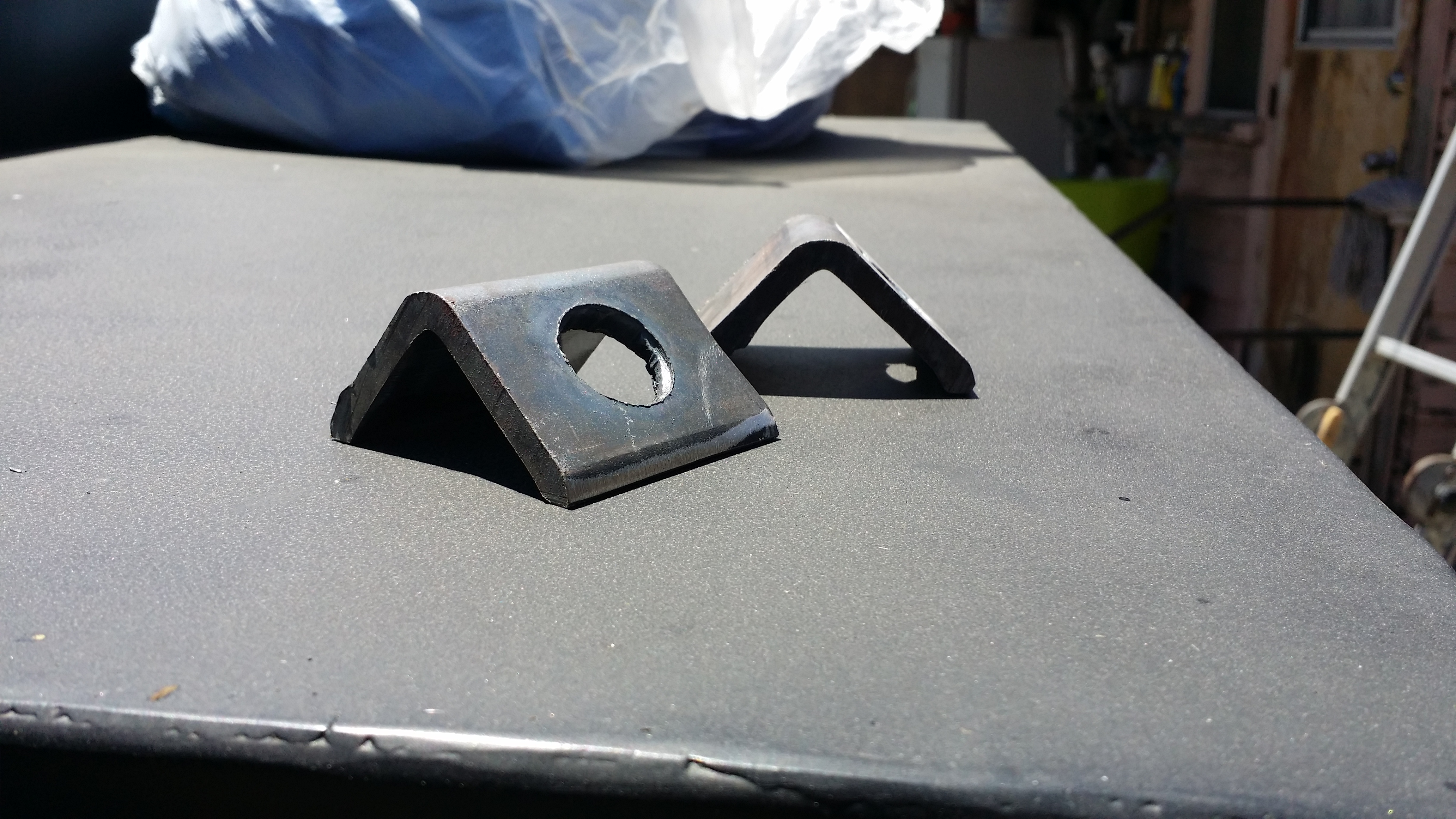

Then i made some Hoops to use with the safety towing chains. These are made of some spare some 1/4" thick 2"x2" square tube that i had left over from when i created my trailer axle and trailer tongue.
I Made the holes big enough to be able to fit the D-Ring bolt. I plan to use 1 one each side

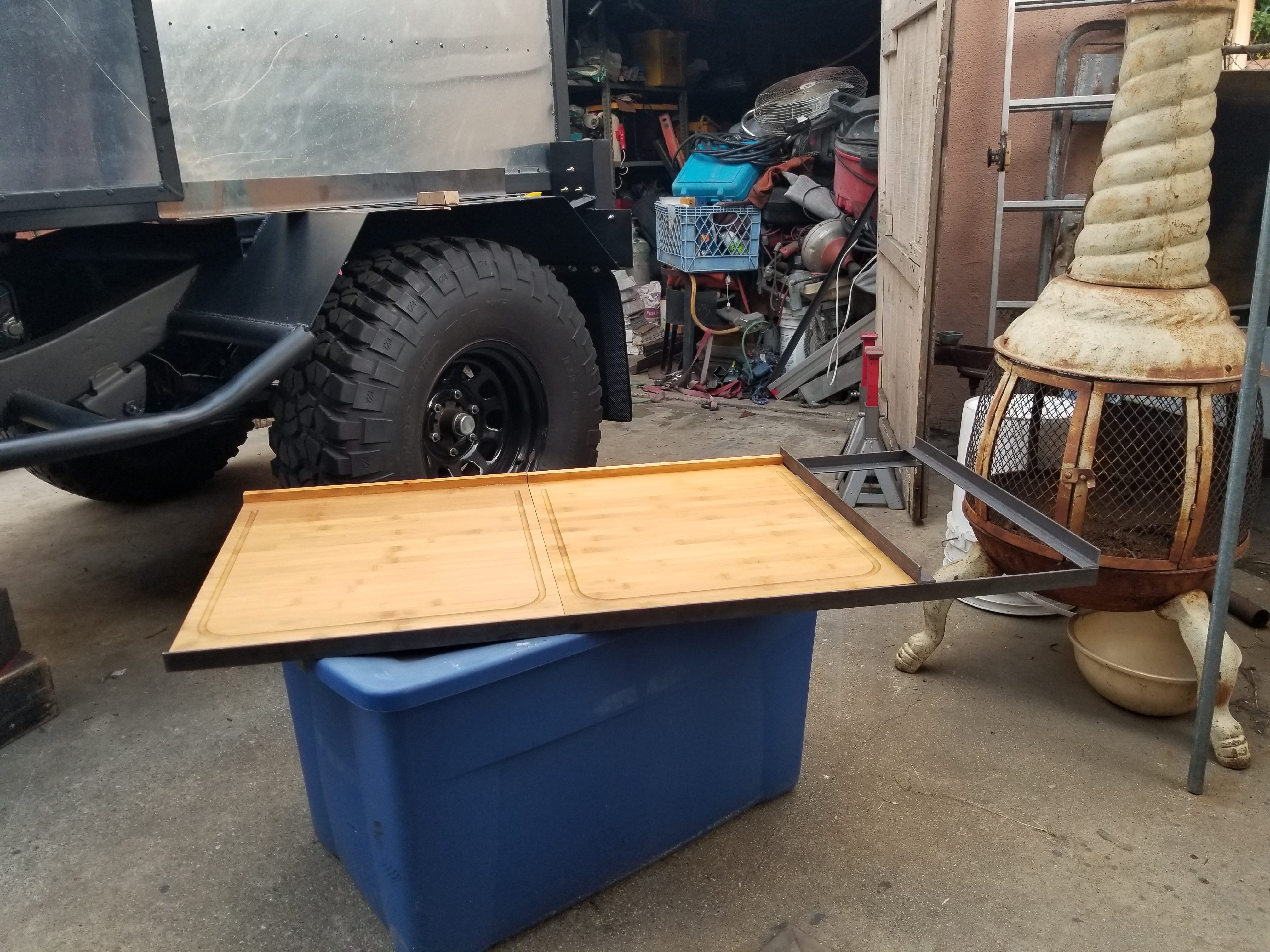

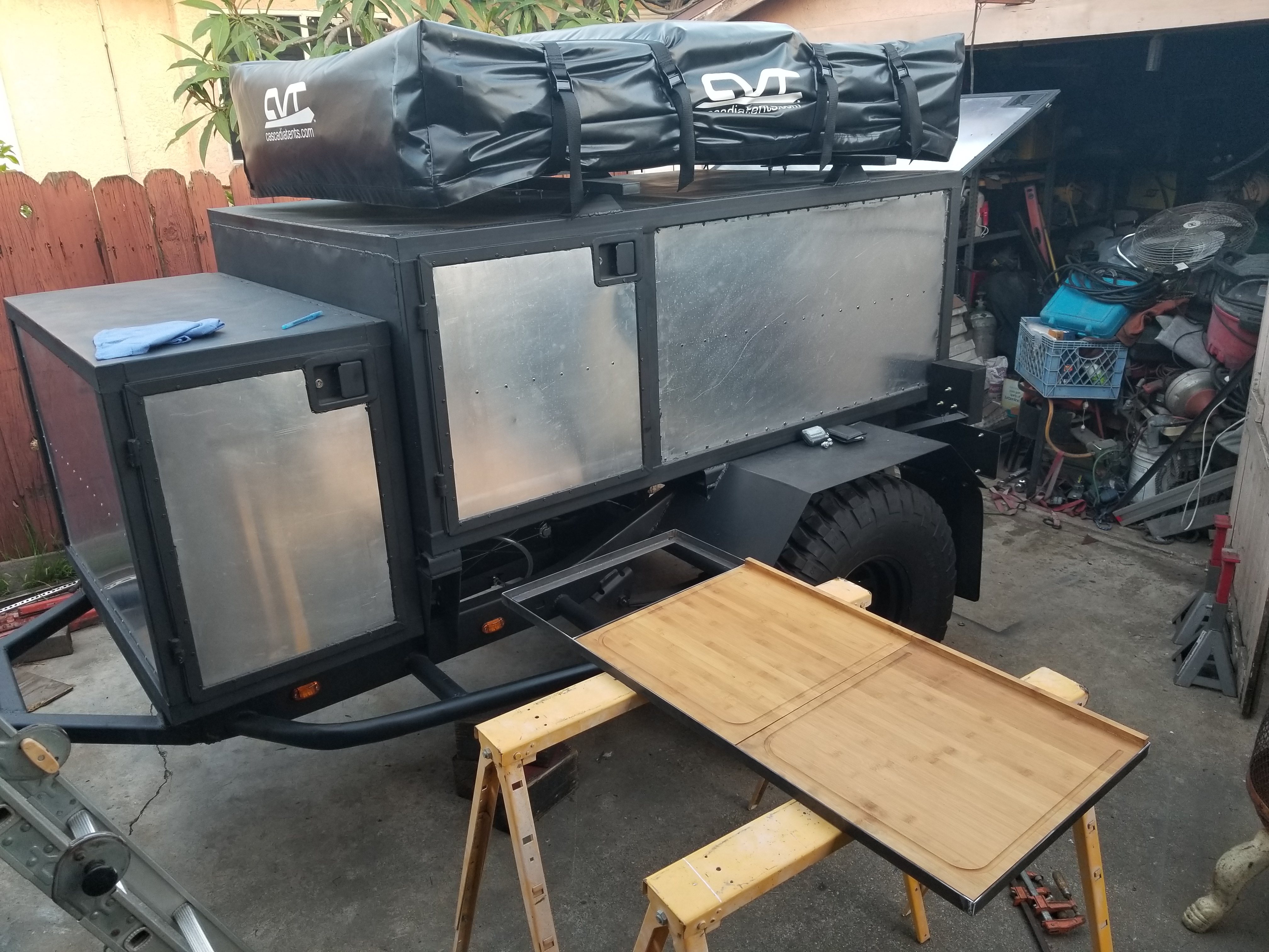

Give myself a pat on the back. It turned out looking great. I really love how fast i can paint with that paint gun. Its so freeking convenient. I just hate the clean up process though. So i can definitely see myself not using it for touch ups. But i will definitely use it for painting large surfaces or redoing my trucks bumpers and sliders. Still it's great to have

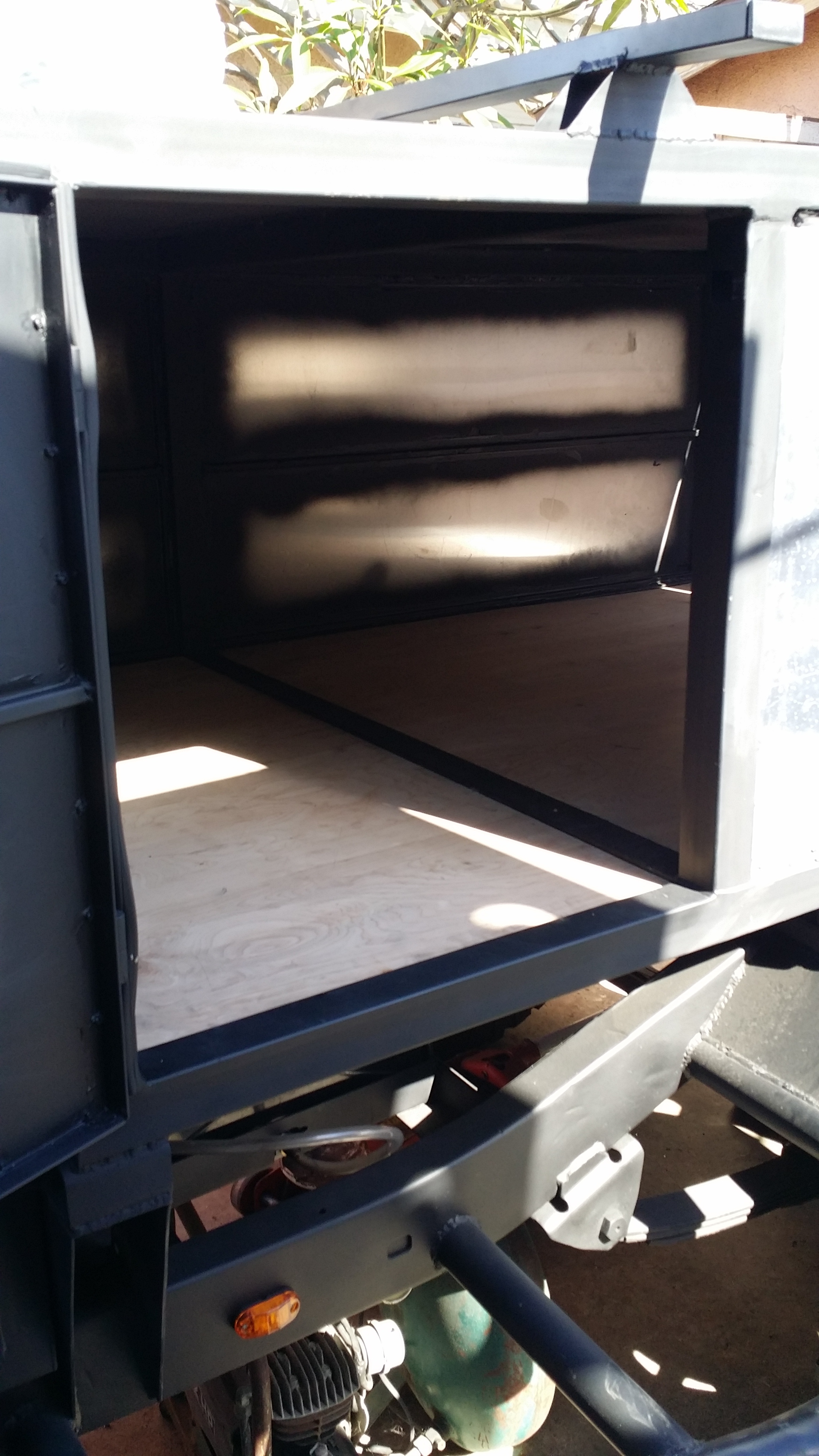

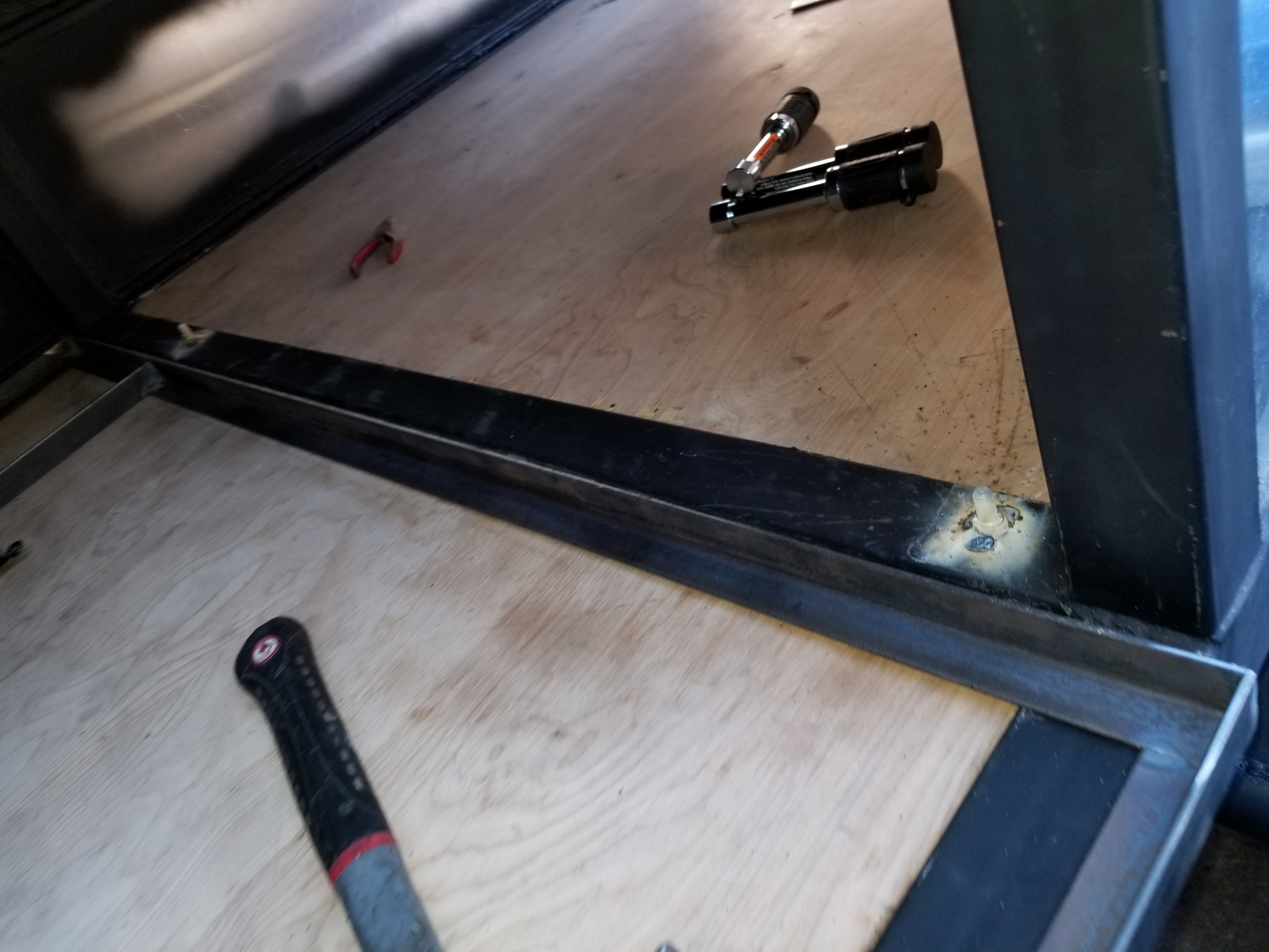

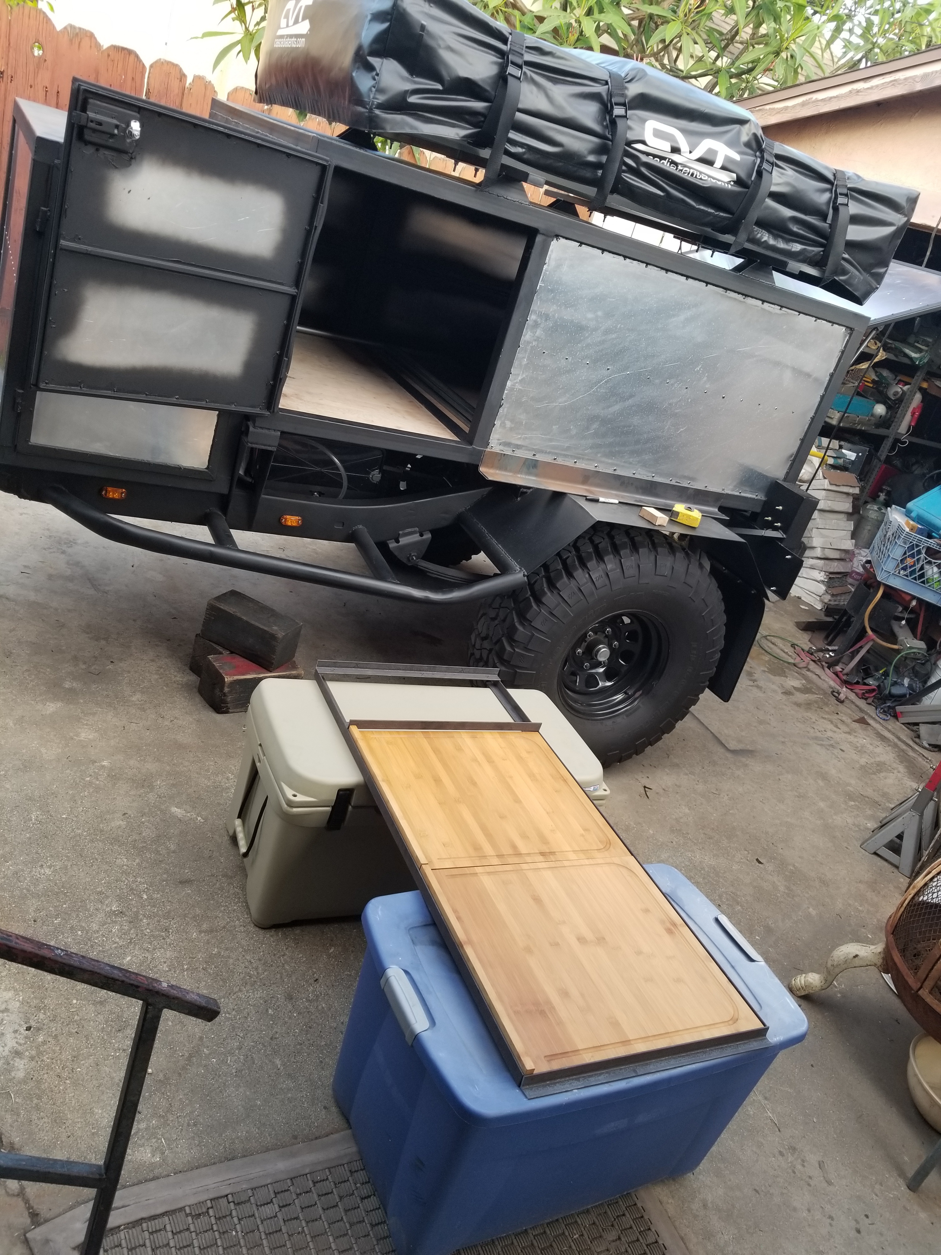

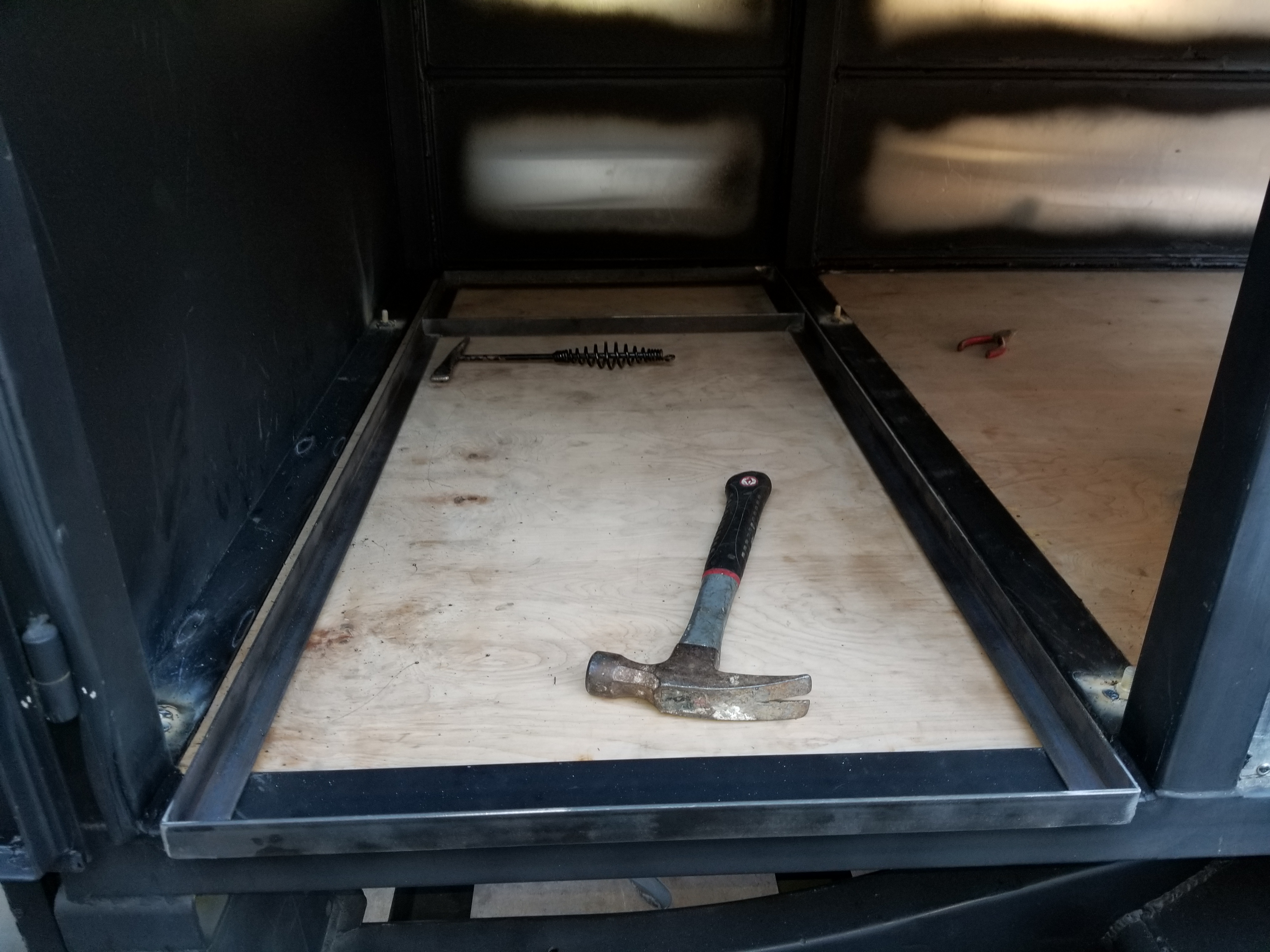

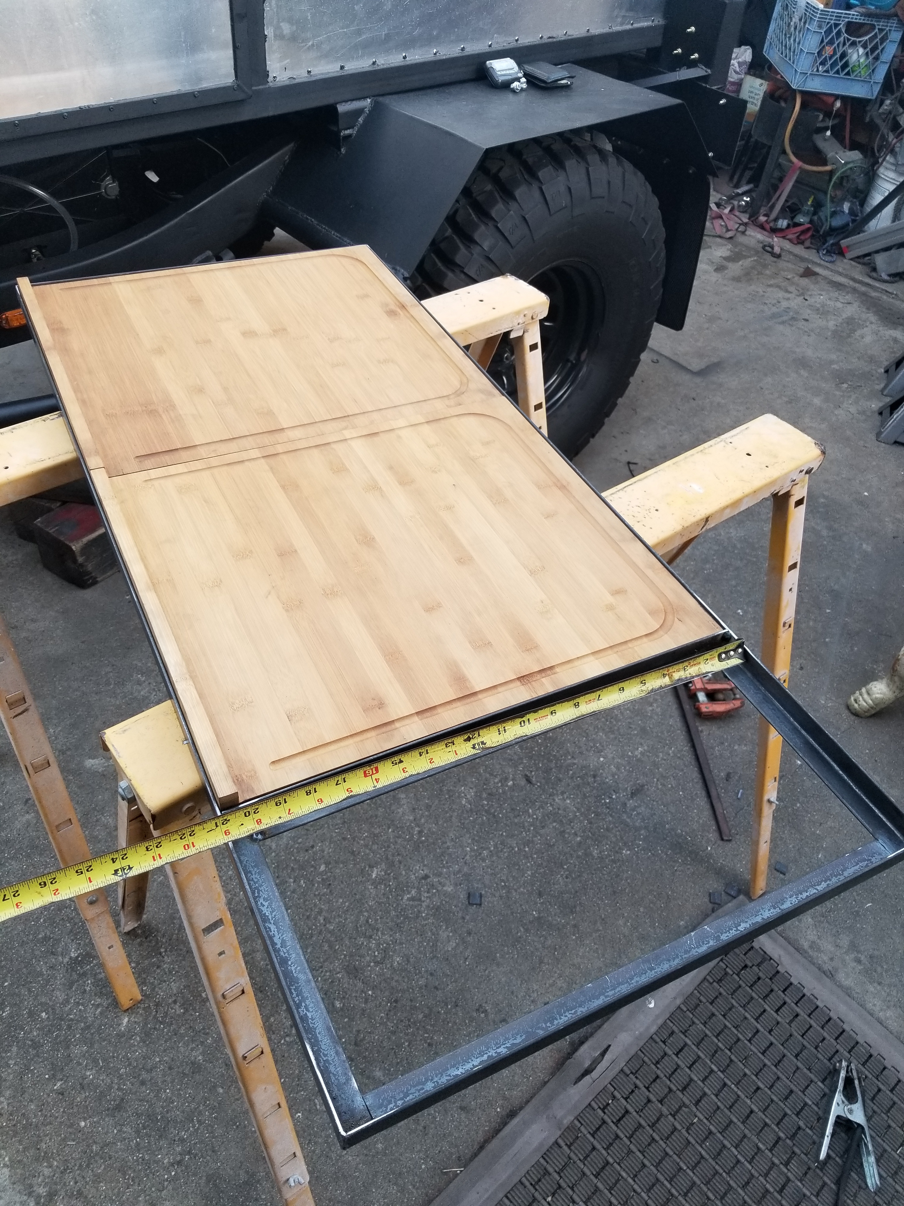

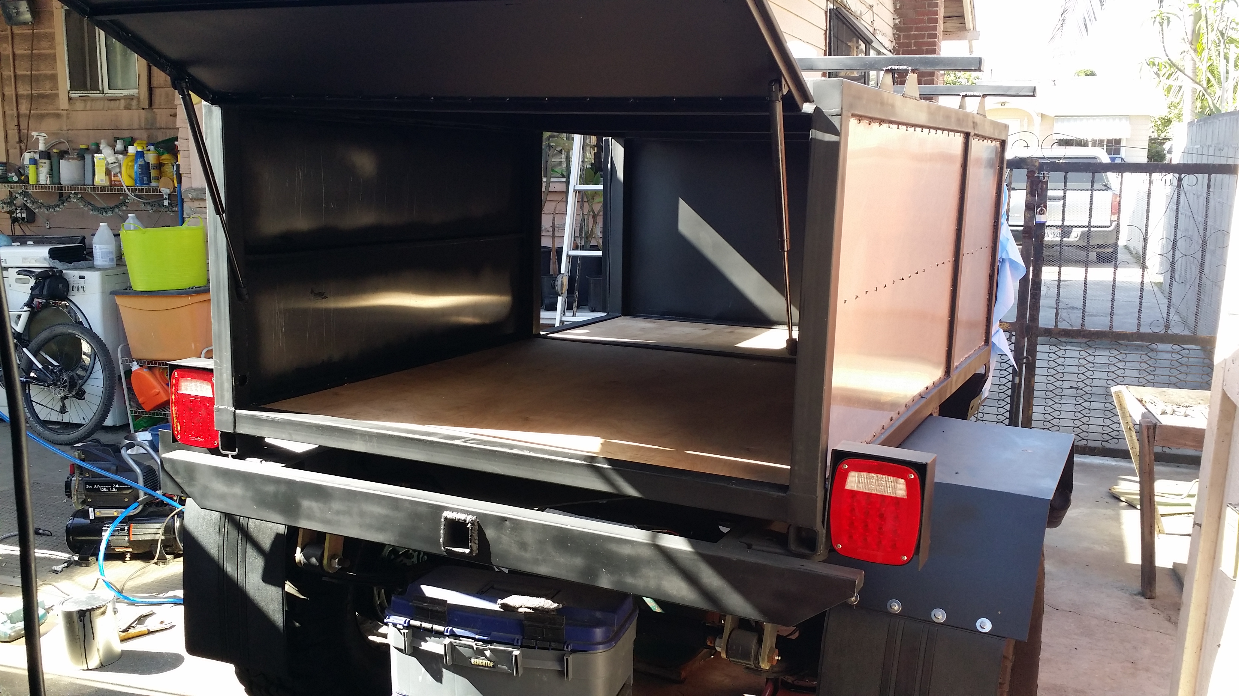

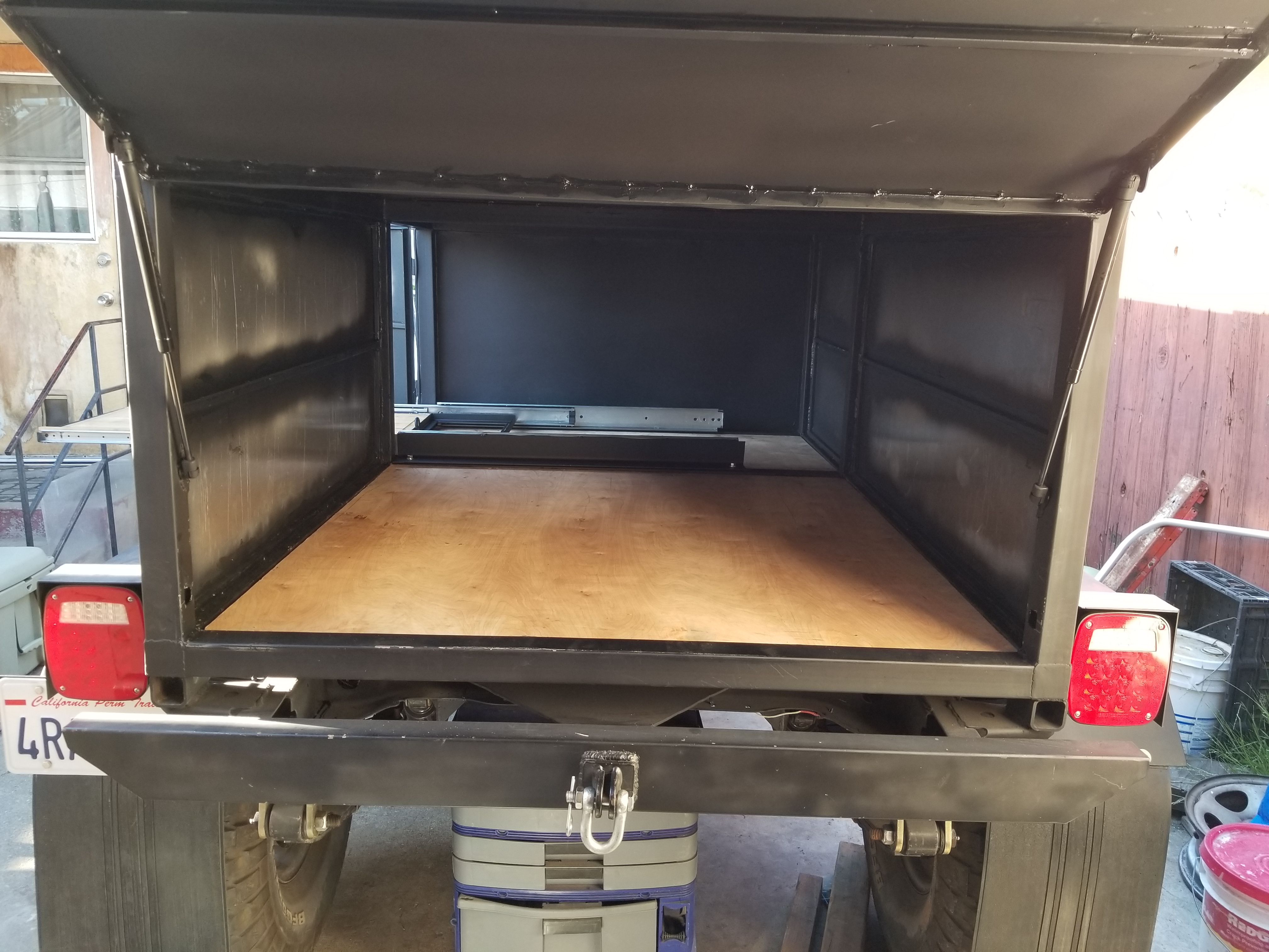

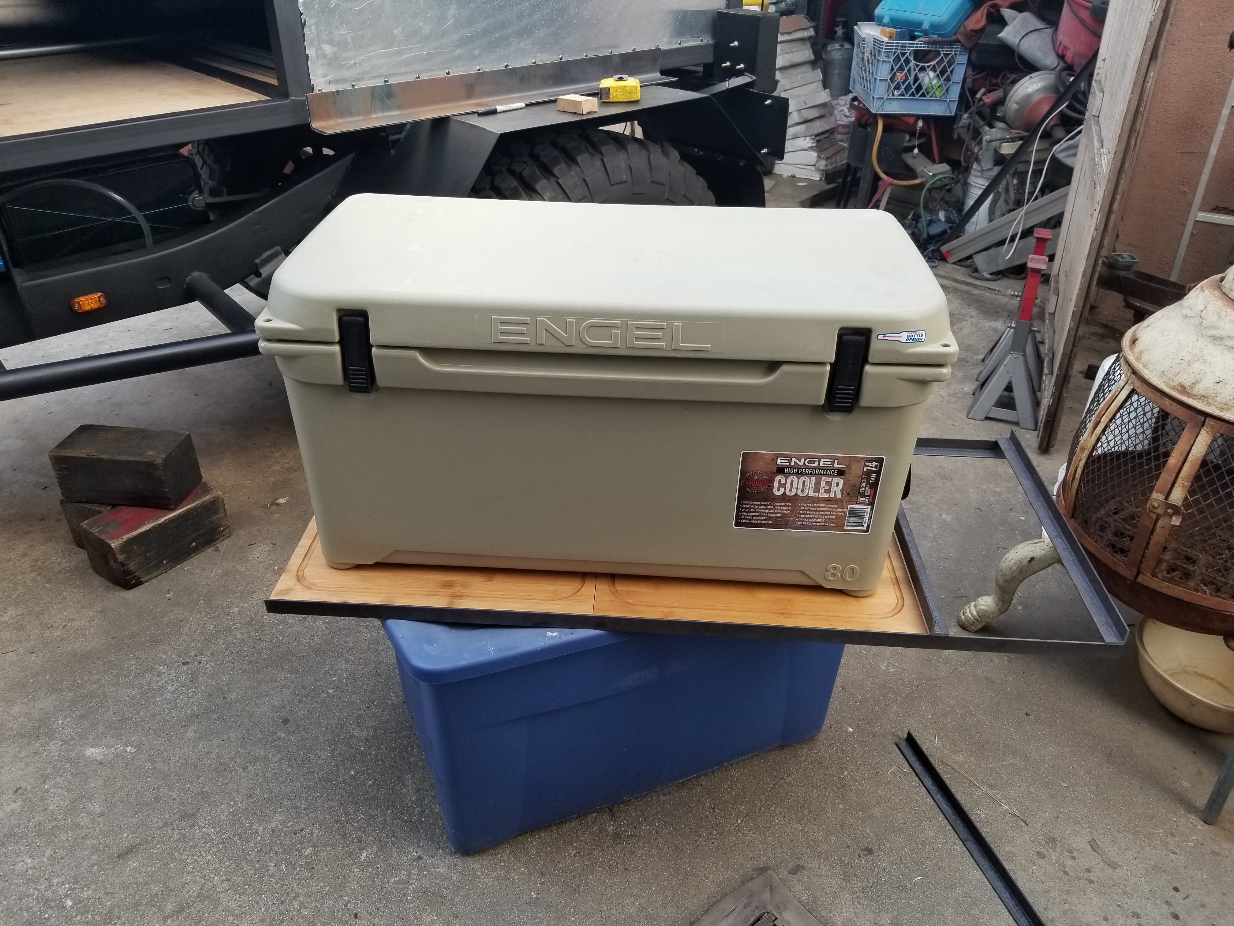

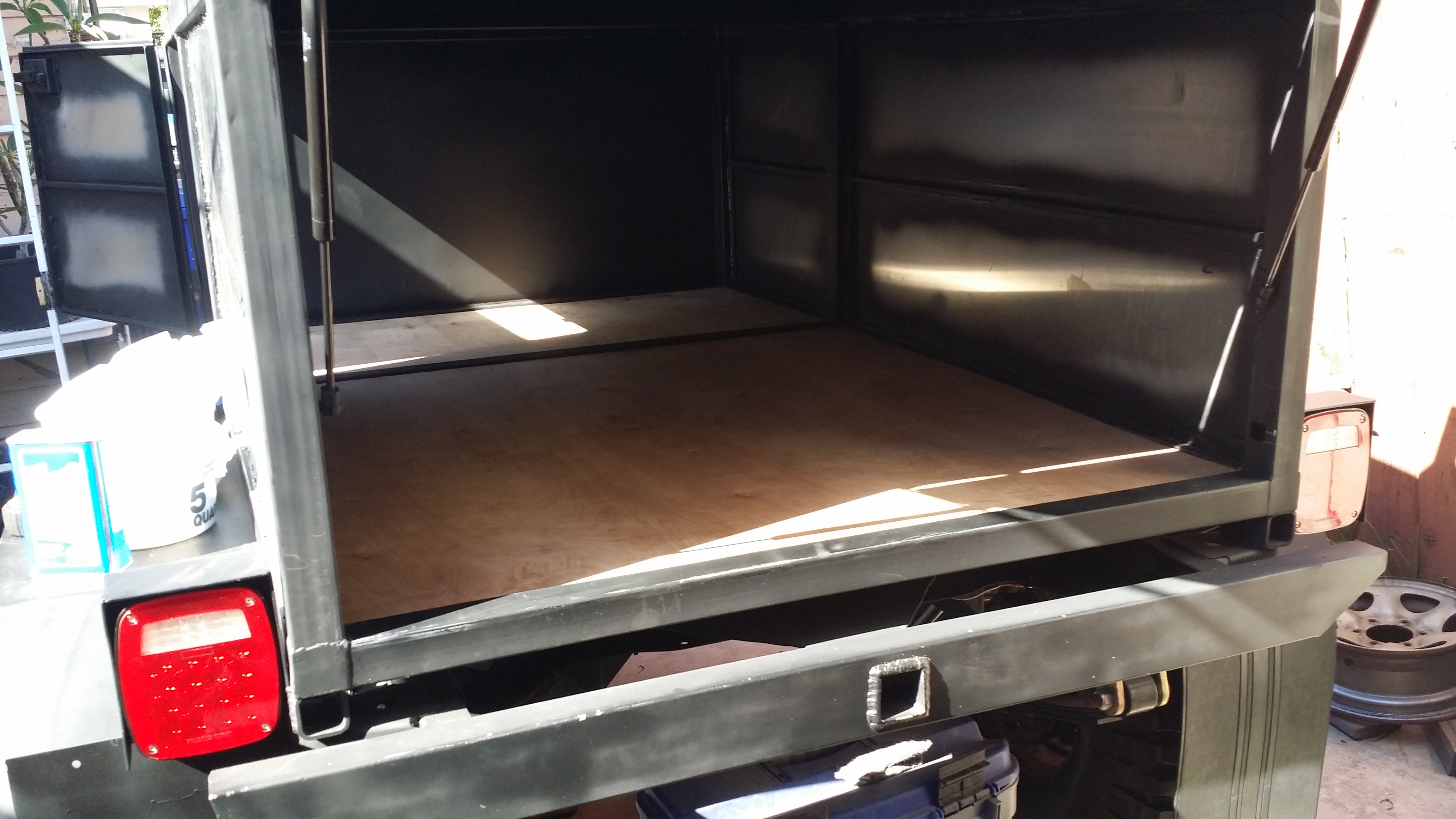

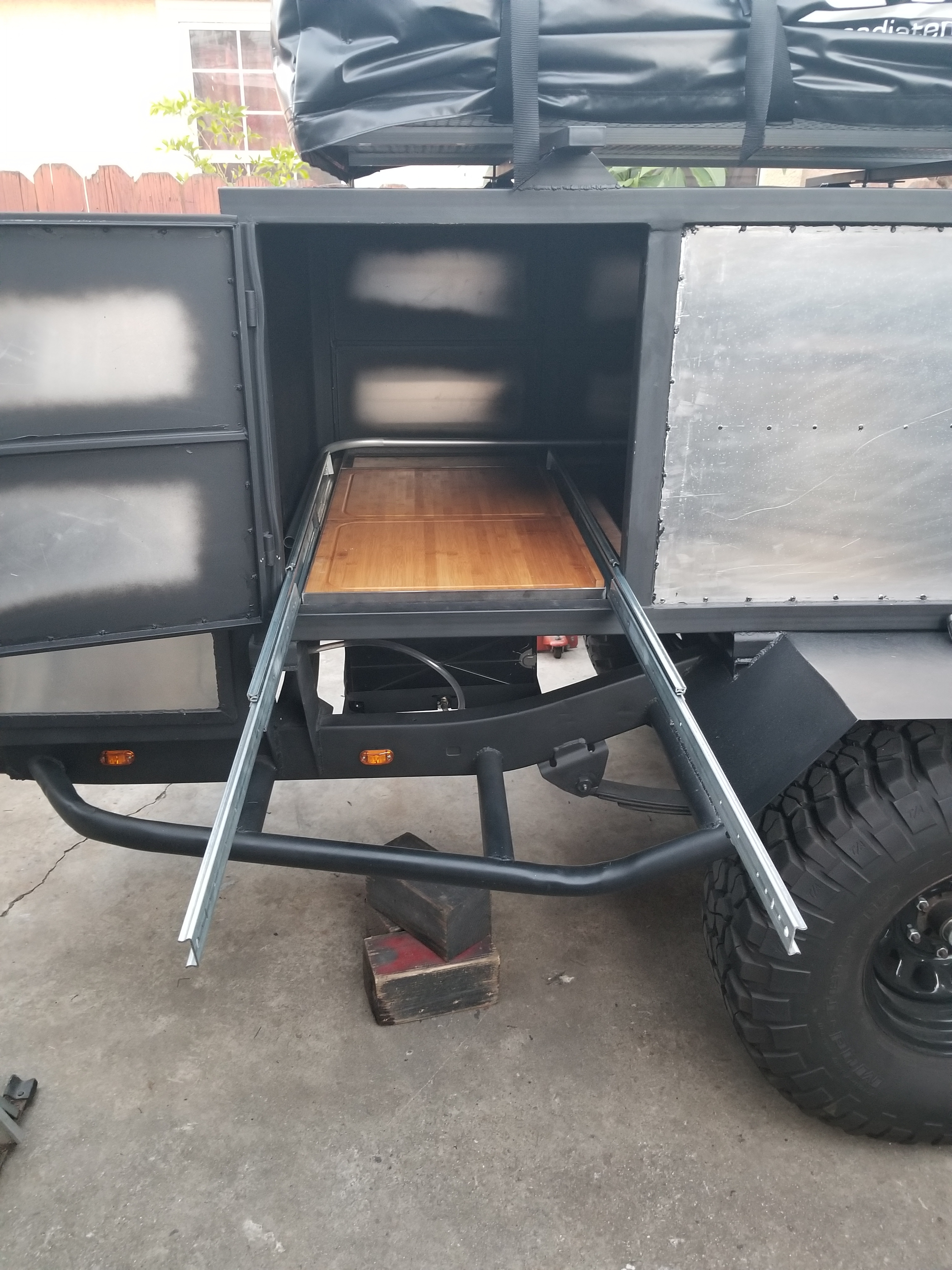

I figured since i have the DMV appointment on Monday i may as well put in the birch-wood floor to make it look cleaner. I don't know what exactly the inspector plans to look at but at least the trailer will look great!
That is all i have to share for now. Hopefully today i can get the High security locks installed onto the doors of the trailer. Then give both my truck and trailer a nice car wash to have both looking immaculate for Monday's inspection.

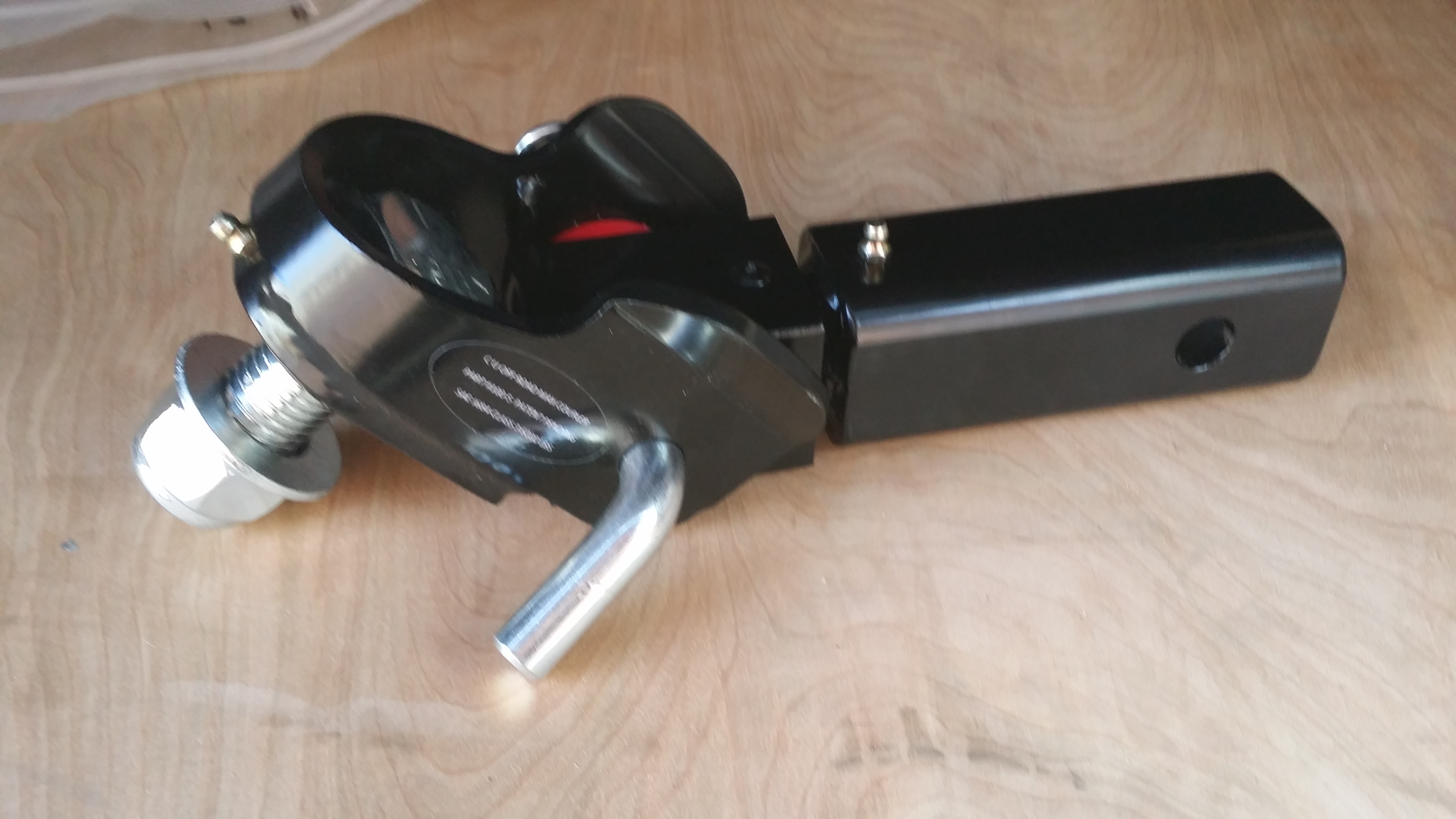

I Ordered a Max-Coupler and it should arrive today in the afternoon so i'll make sure to post some pix of that when i get it. I just need to buy some towing chains and I'm set. I followed the DMV requirements as best I could. So I hope they don't have anything negative to say about my trailer. The only bad thing i can imagine hem saying about it is maybe the 3" lift or maybe the 35" tires. But i've seen trailers this big in California before so i'm hoping all is good.

My Max- Coupler came in on Saturday morning I bought it off of Knight offroad for about 225 and free shipping. Saved me about 25-35 bucks by getting it through them.
http://shop.knightoffroadtrailers.co...OUPLER_c12.htm
Once that came in i figured i would get the rest of the items needed for the DMV inspection and of course safety. I went to Autozone and bought all this stuff.
Boom she was ready.
I greased all the zerk fittings on the max coupler and on my leaf springs to make sure it was all lubed up!

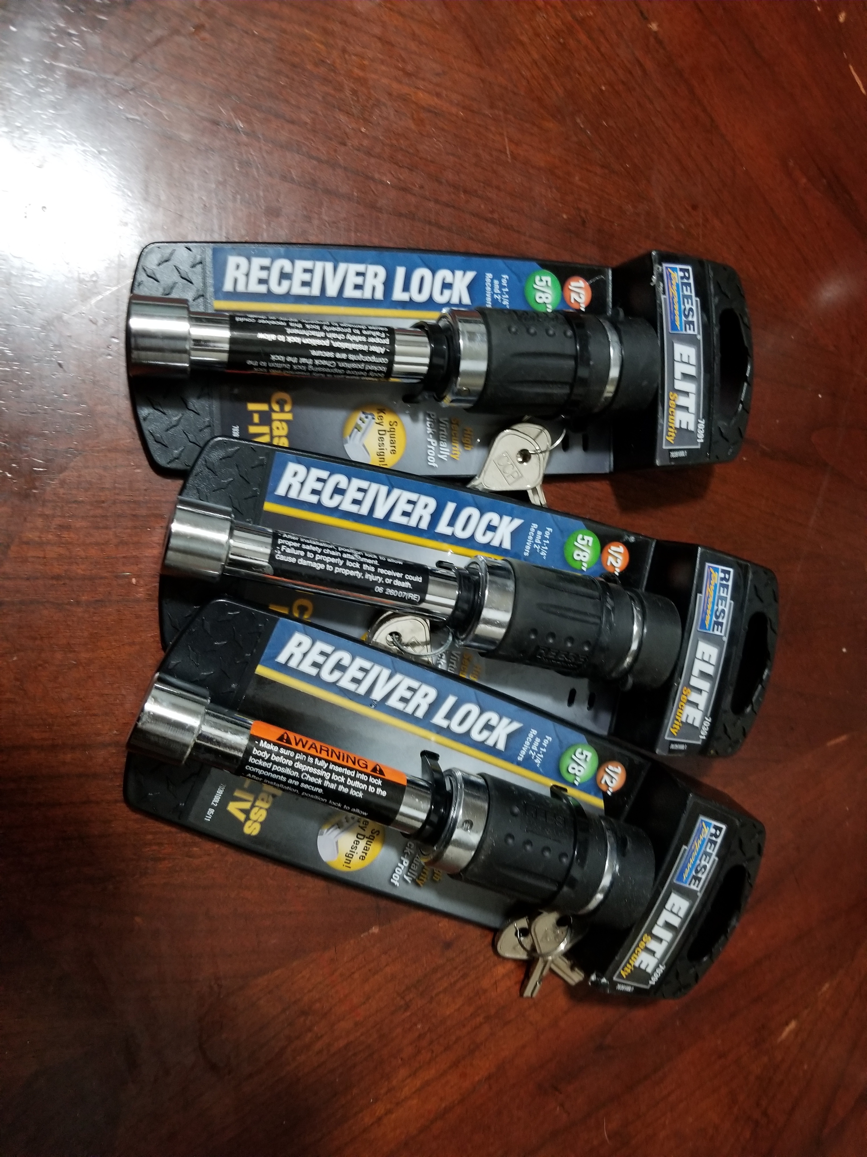

Then spent the rest of the night installing my high security locks. Finally i then finished up the night by taking it out for a test drive around the block a few times o get a feel of how it would feel owing the trailer on inspection day plus i wanted to make sure the trailer was stable since i had never driven the trailer before this point.

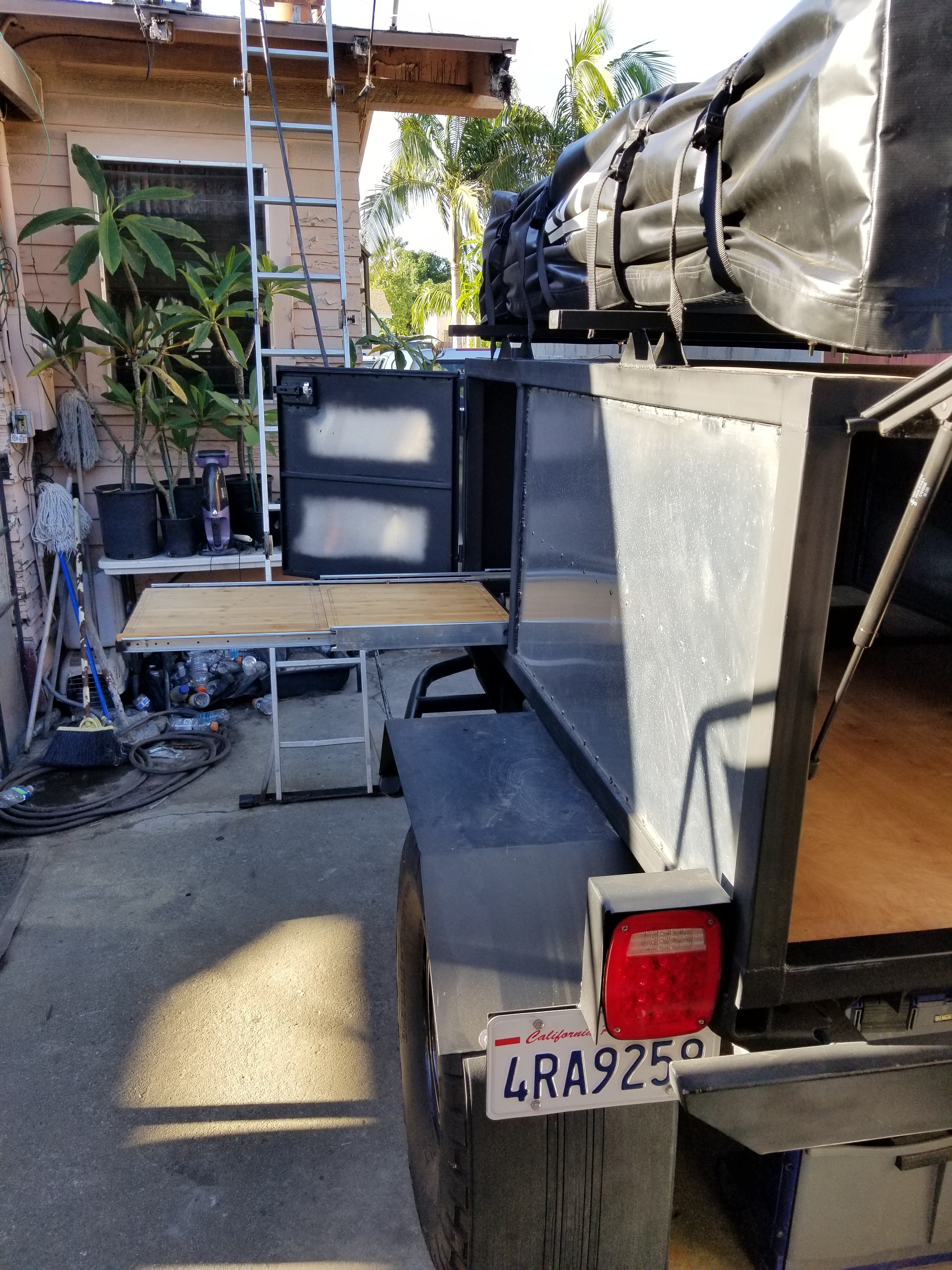

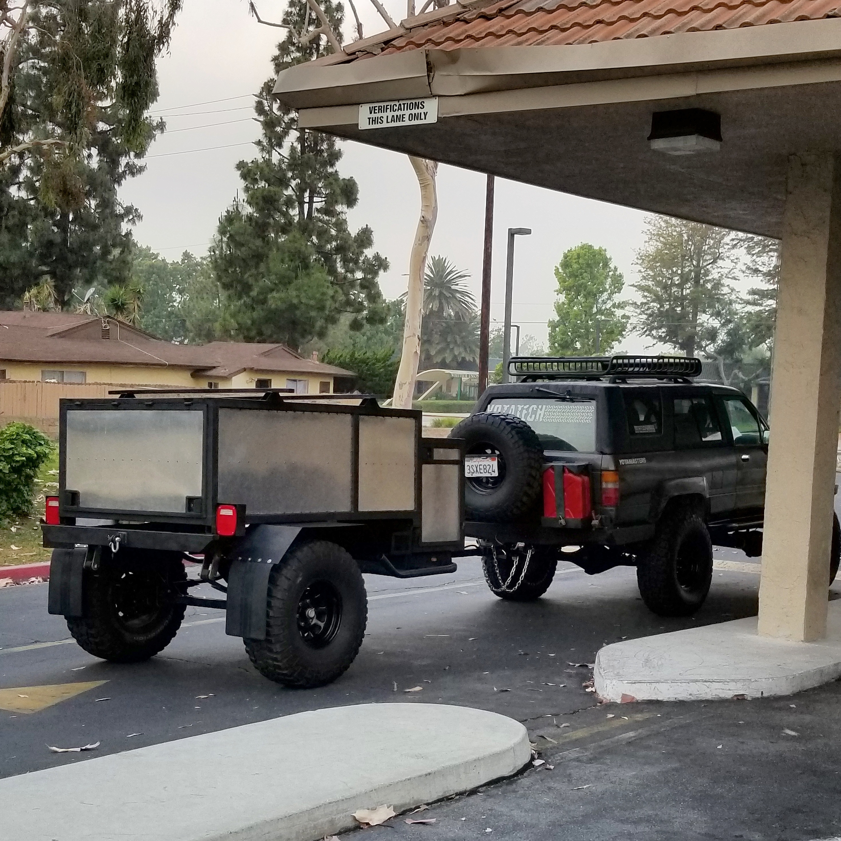

Went to the DMV this morning. I'll have to say the trailer drove really great and i love the Tekonsha Prodigy p3 brake controller. The different levels of boost were so convenient.
I lost so much sleep thinking if this trailer would pass. I was so nervous hat i only got 2 hours of sleep! i was just nervous hey would ding me for the lift, tires or not having reflective tape on the back side. Luckily for me the guy i got to do the inspection was an awesome down to earth dude.
Needless to say i passed inspection. He was also pretty impressed with how well built it was. We didn't chat too much because he had other appointments to tend to but i was super quick and it made me so happy.
I'm so thrilled that is all over with. They gave me a new VIN and told me registration would be every 5 years because it is a "Light Weight Utility Trailer" In the end I ended up paying $40 for all the paperwork and new license plate plus VIN tag. I can't wait to start adding all the cool gadgets.

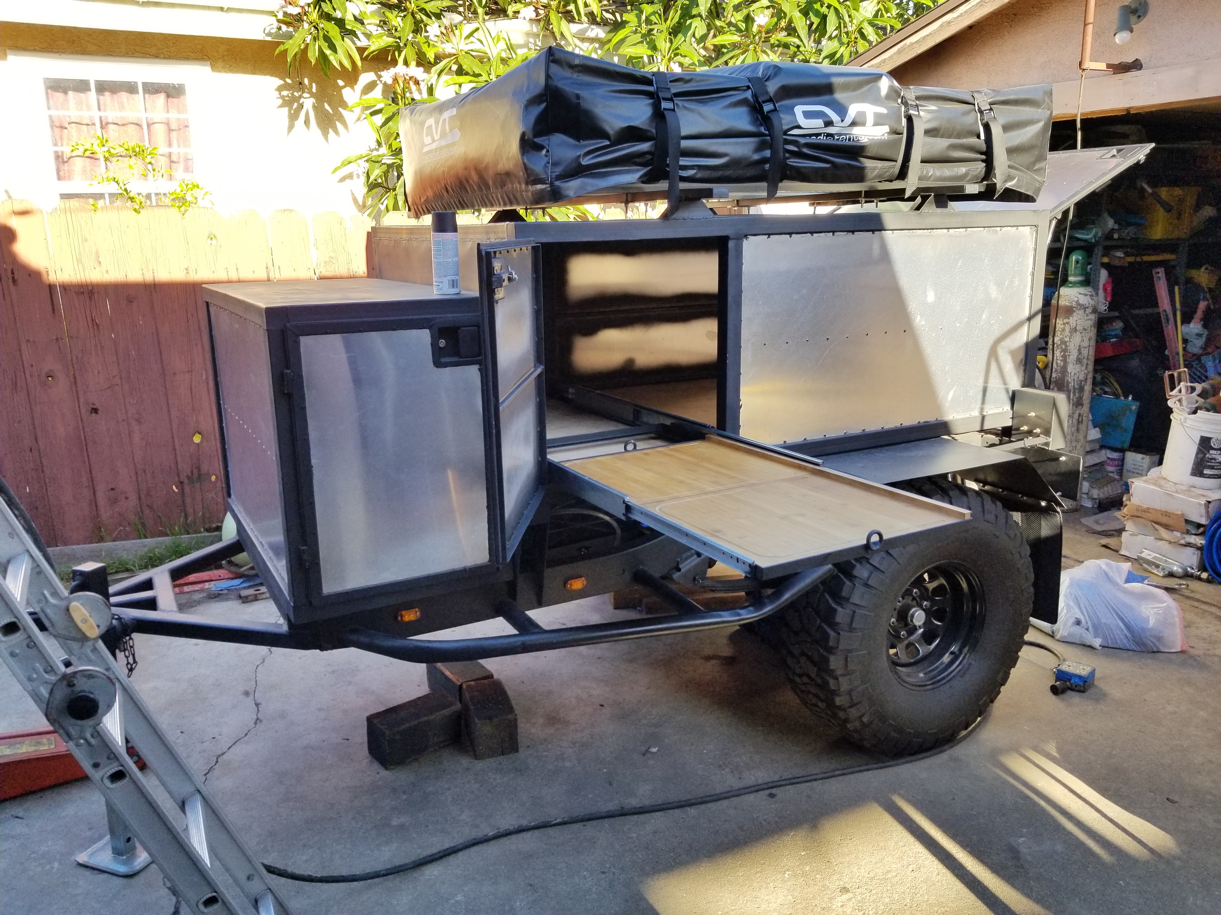

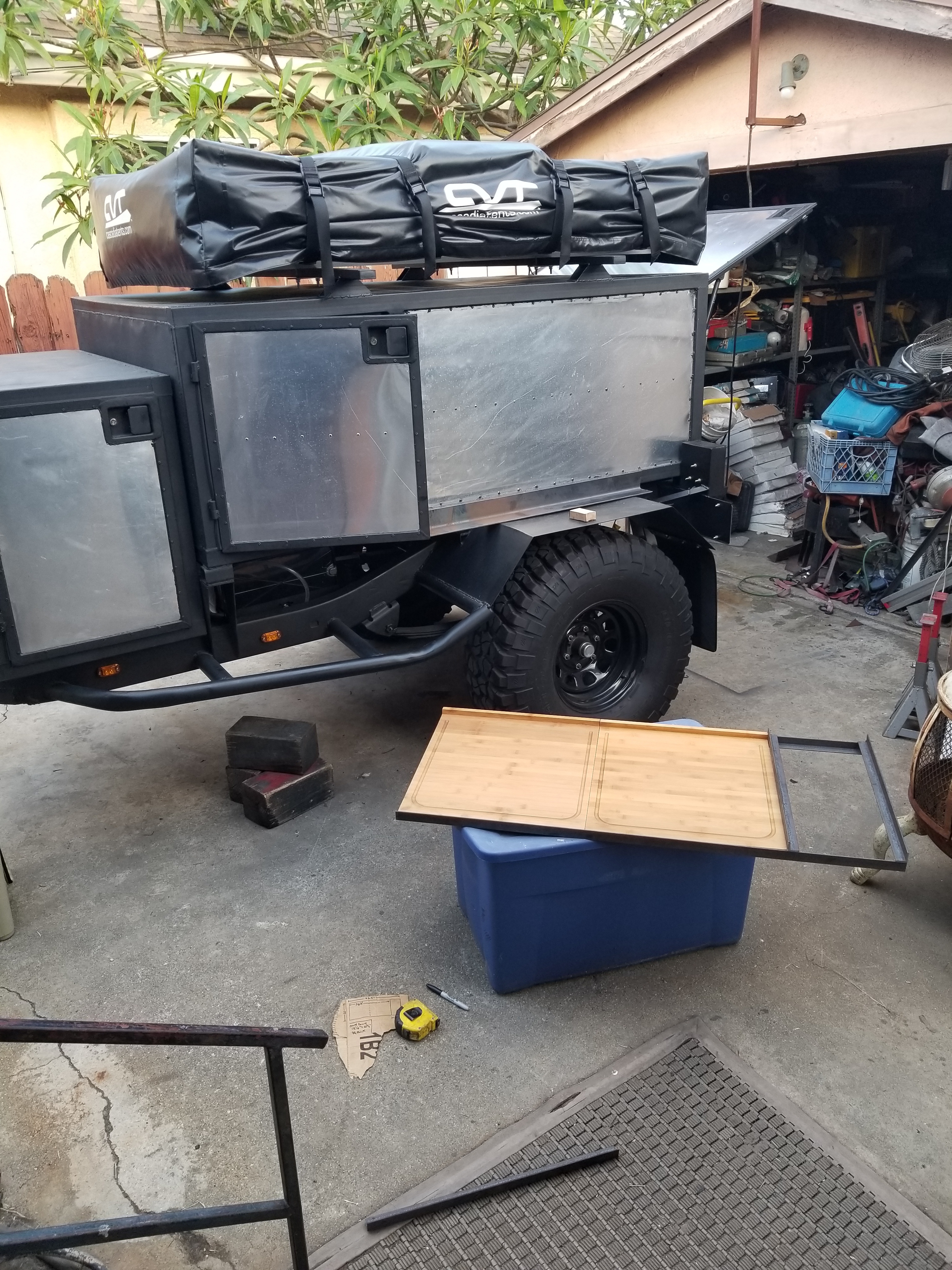

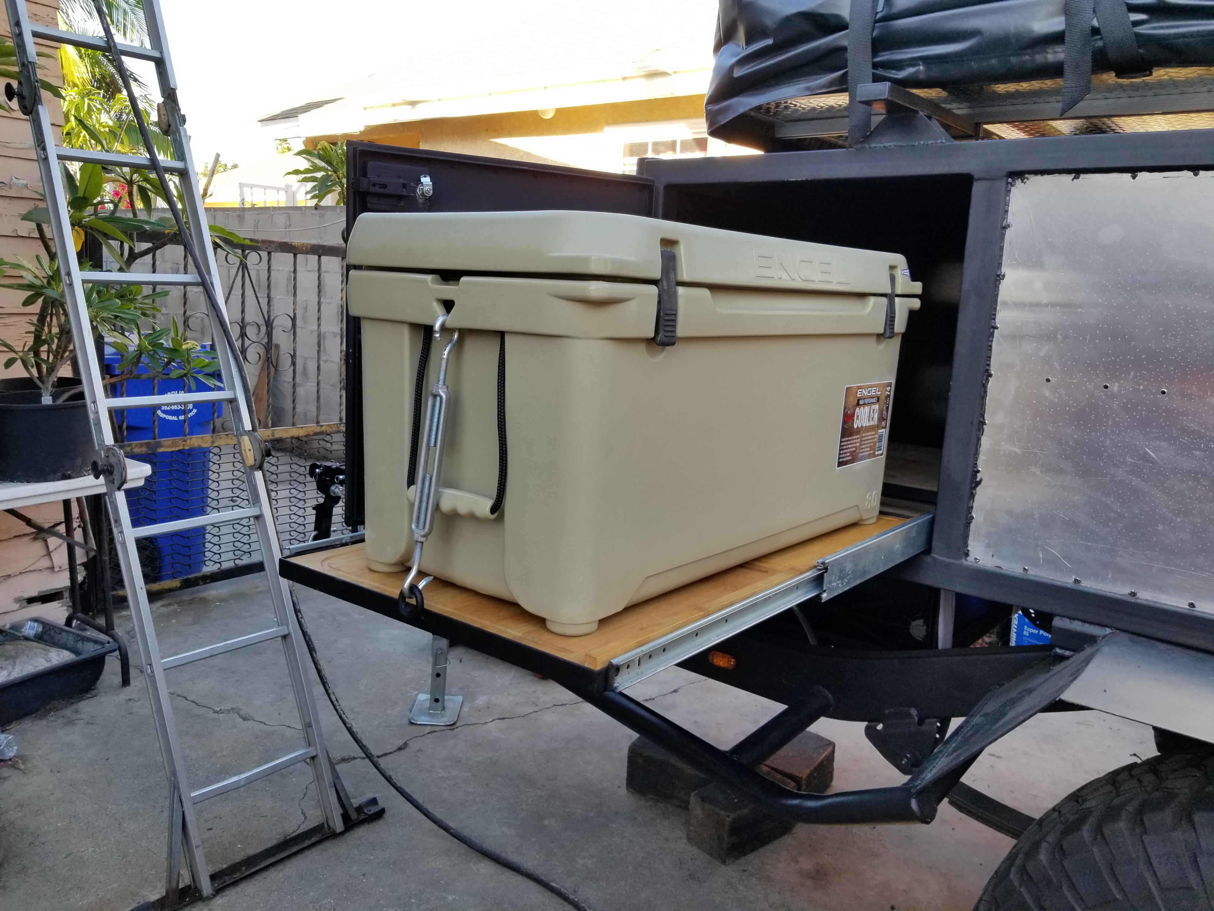

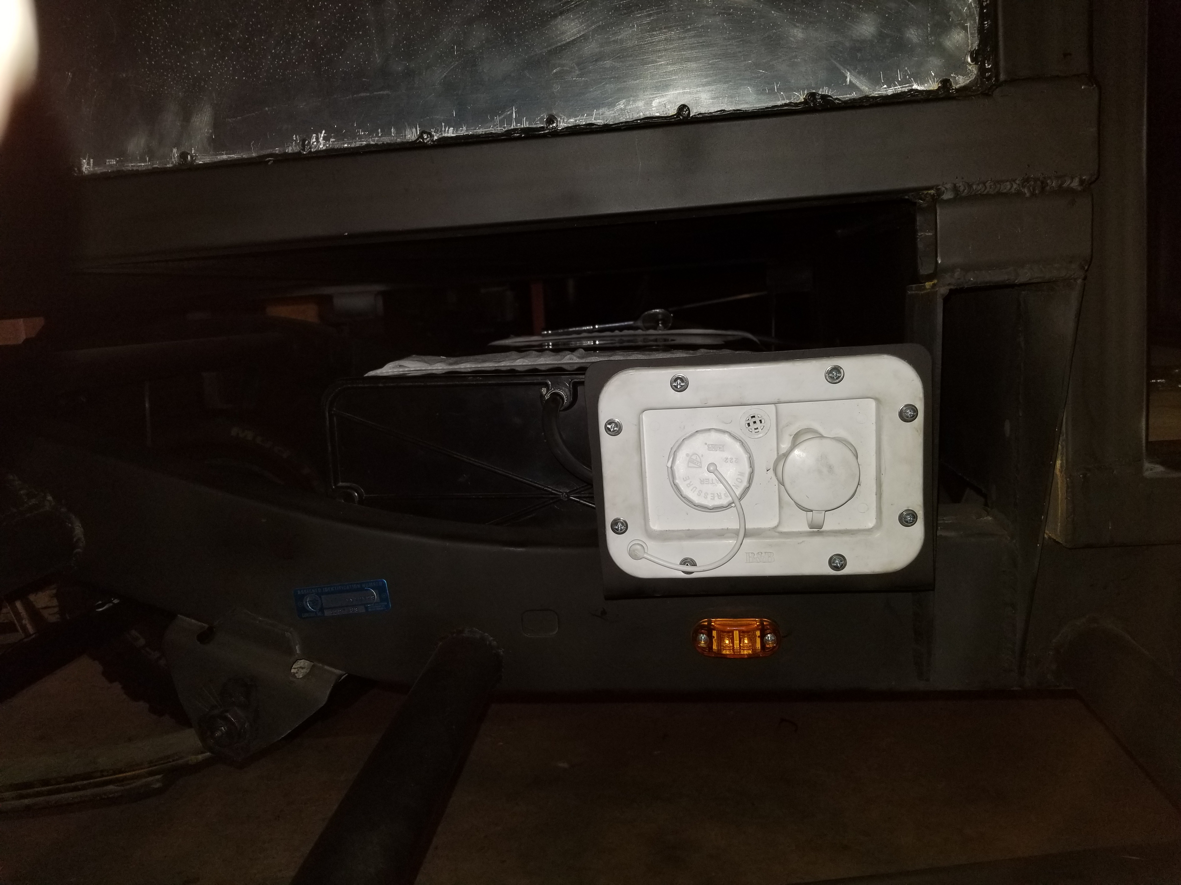

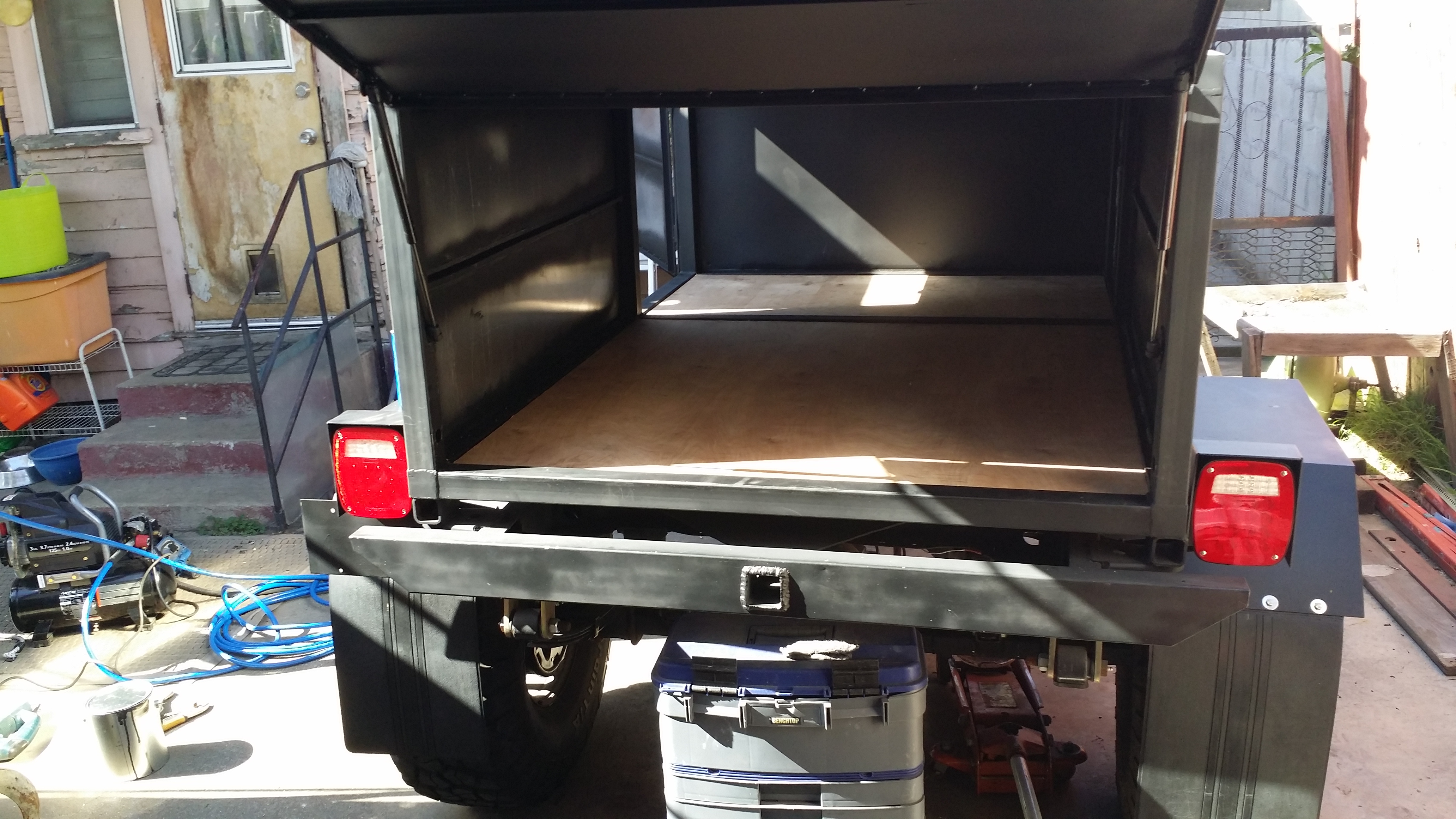

There's not much i can do on a week night but I did mount my 15 gallon water tank and water fill.

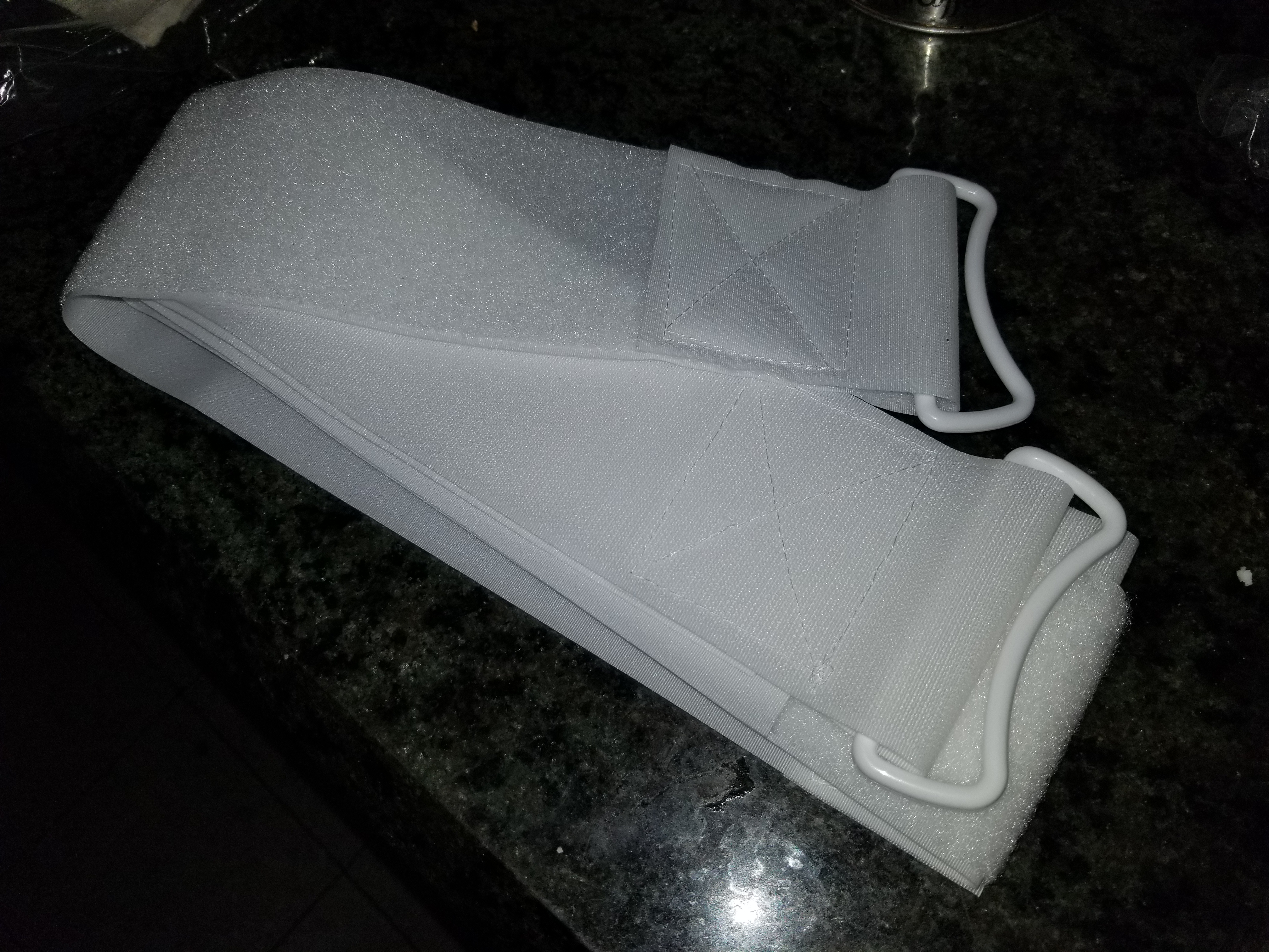

I used two extremely heavy duty grade velcro straps to hold the tank in place. I don't care about sun wear & tear or the quality degrading because i have an unlimited supply of them at my hospital. We use these straps to secure our patient's to the operating tables once they are out. It's a about 3" or 3.5" thick. And if they can hold a 300-500lb patient in place I'm sure it will do well in holding the water tank in place with all the bumps on the road; Especially since i used 2 of them lol
The on-board heated shower is gonna be great nice when i permanently install the rest of the shower components.

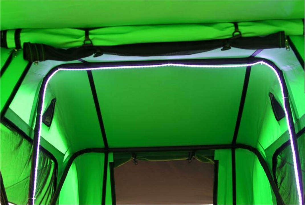

This is the color i originally wanted to get. But with a deal this good i just couldn't pass up my chance. I don't care if it's bright green. At least finding my home base campground will be easy for me and others meeting up after we arrive to camp sites.

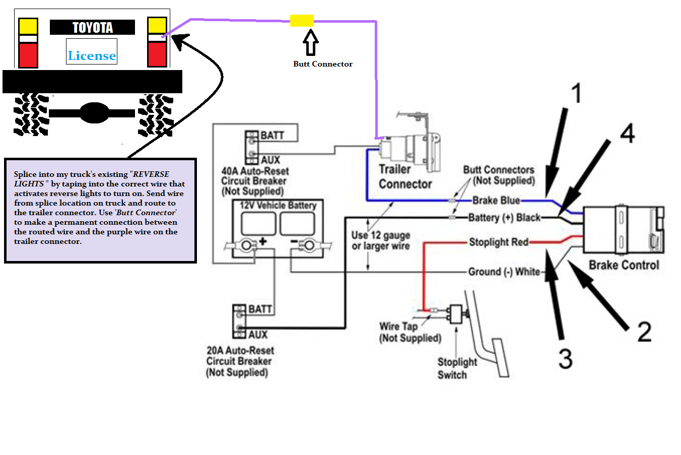

I Thought i would share this really quick. It is basically the wire diagram that i made when i asked the "E-Trailer.com" guys my questions to confirm i had all the wiring correct for my Tekonsha Prodigy p3 Brake controller. They told me i was good to proceed based off this diagram.
I wasn't planning to share it. But i know many people are going to have issues wiring their vehicles and so i thought i would help another person out since i had to figure out how to do it on my own.
I hope this helps somebody looking to go from a 4 pole to 7 pole connector tow wire harness.

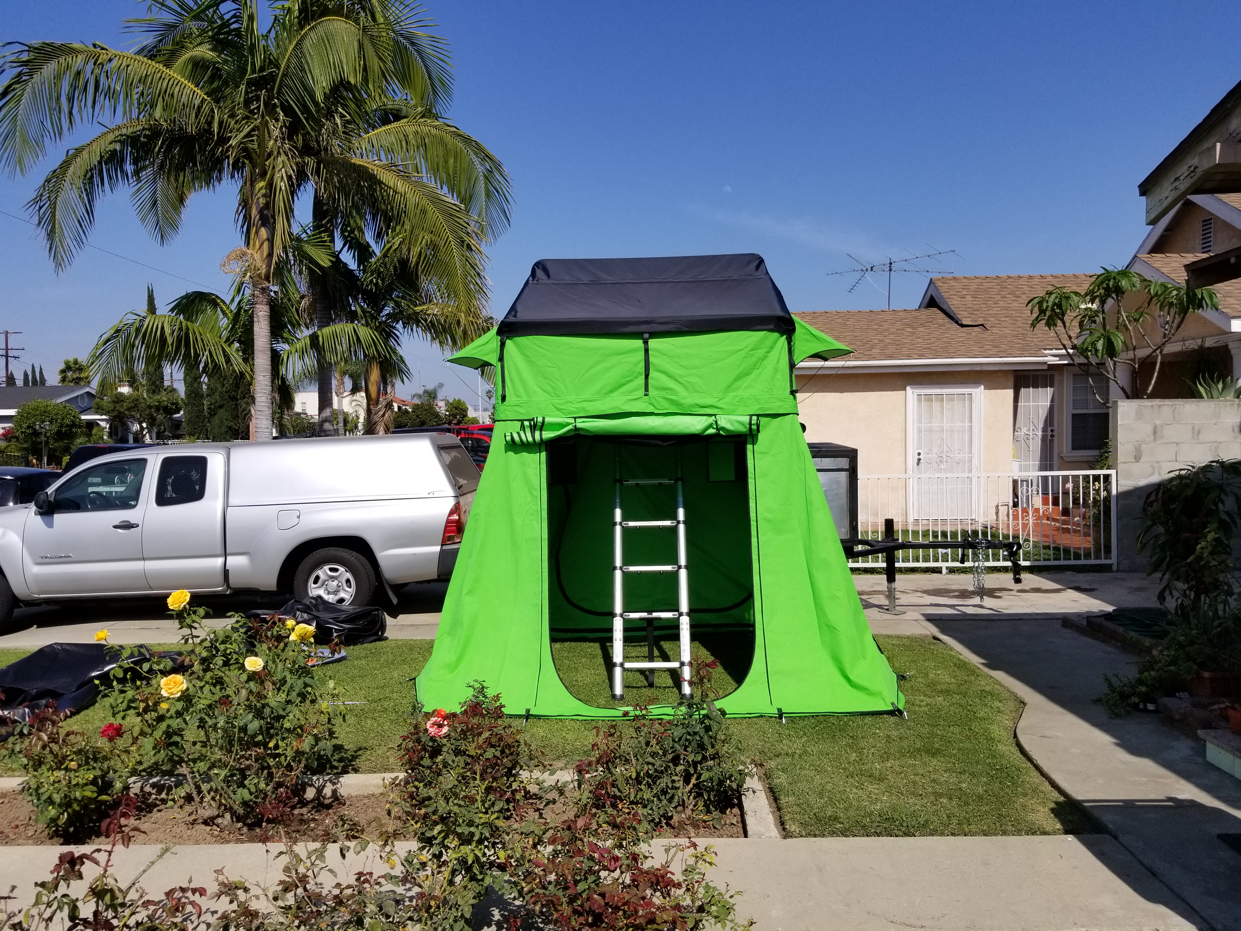

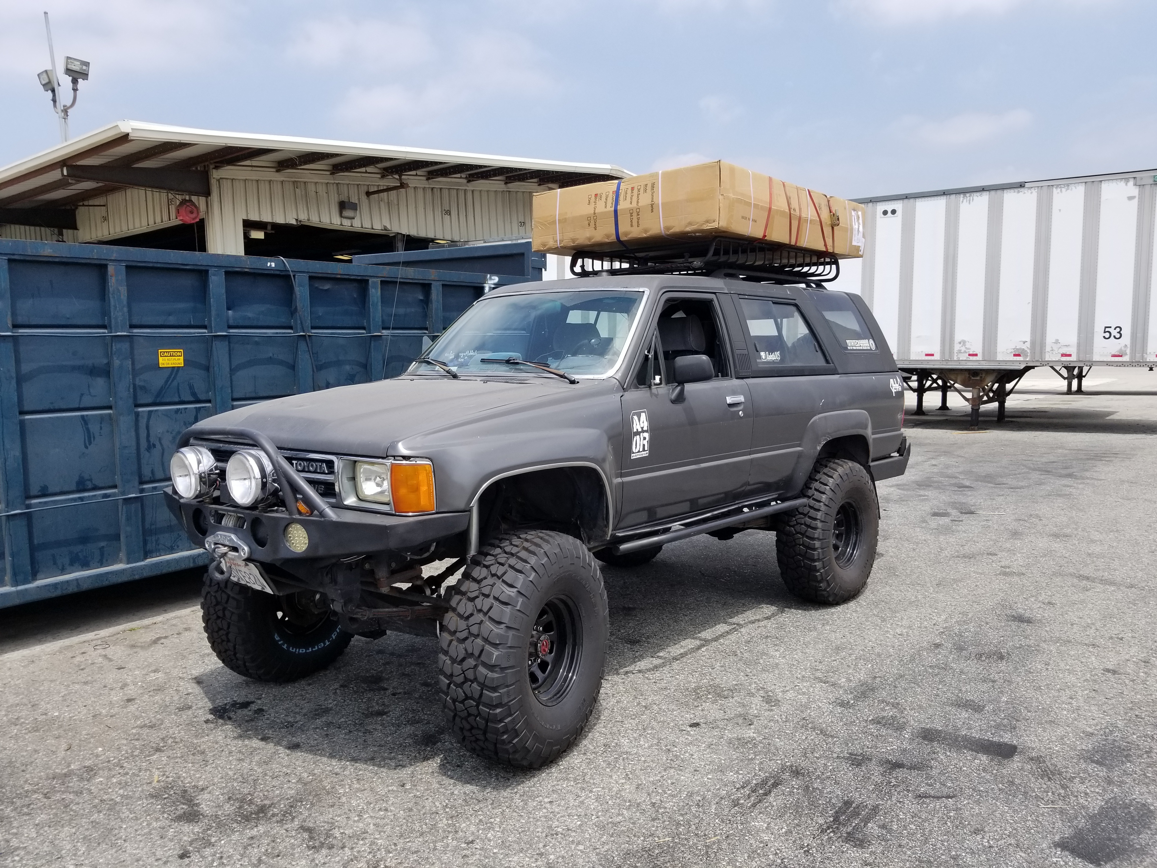

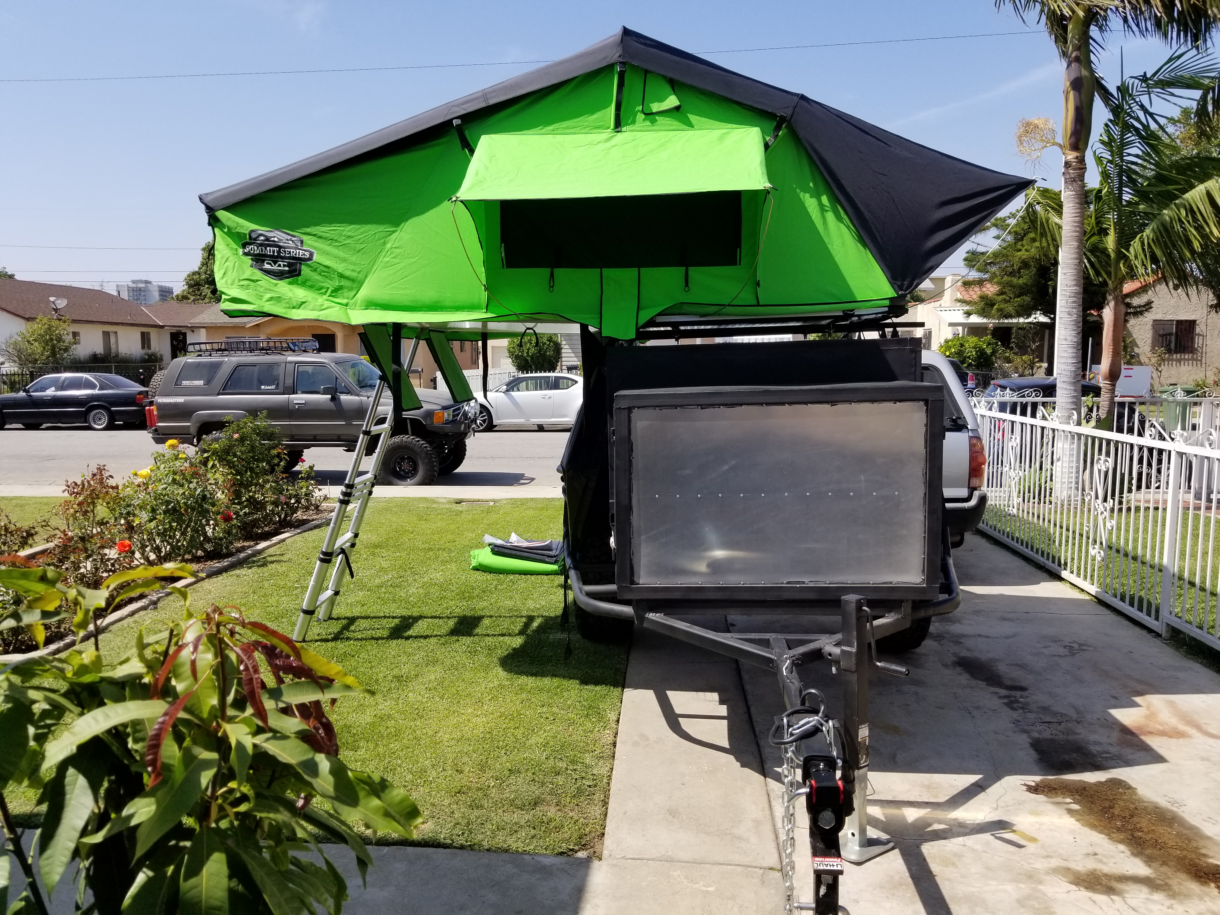

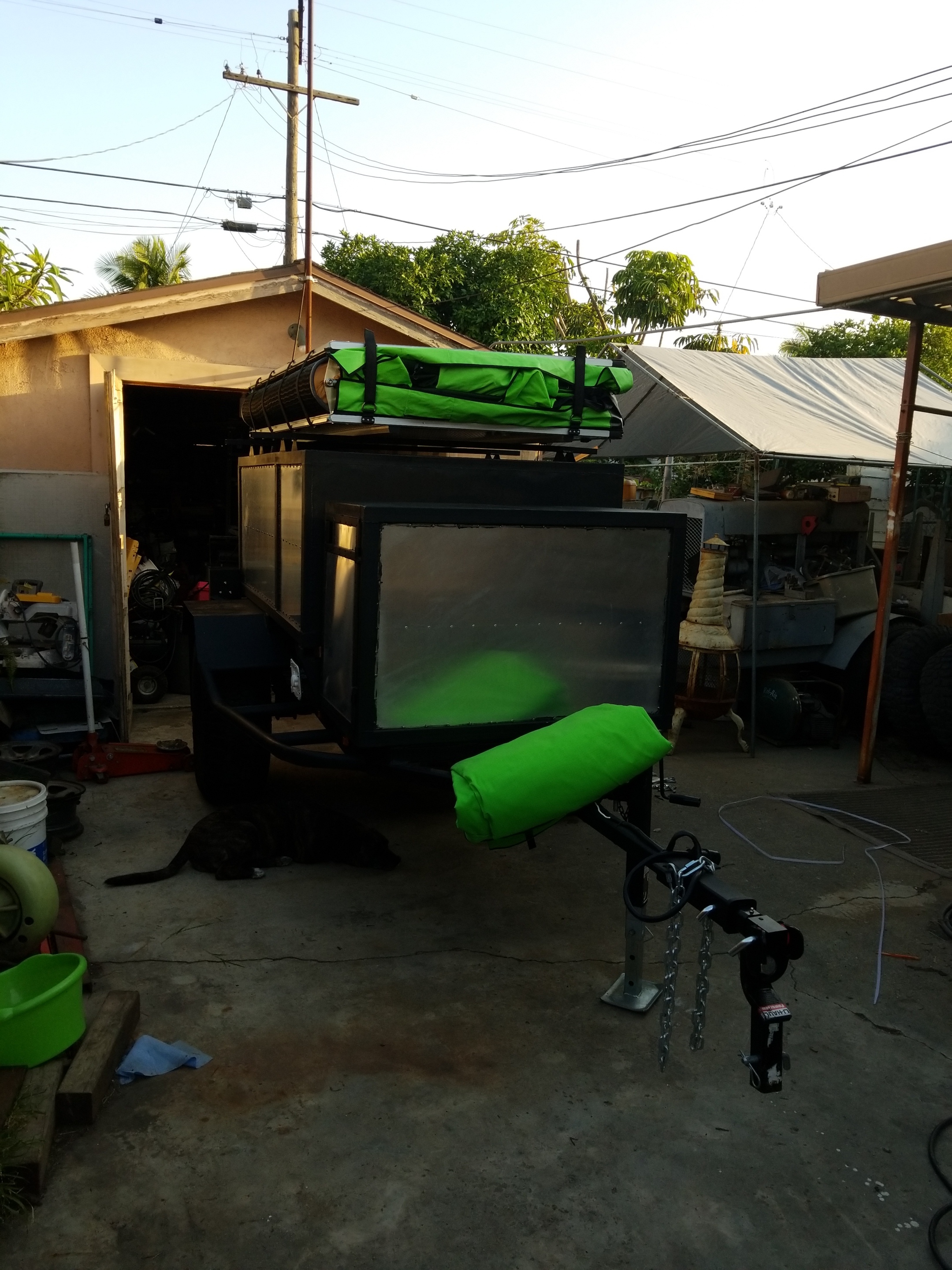

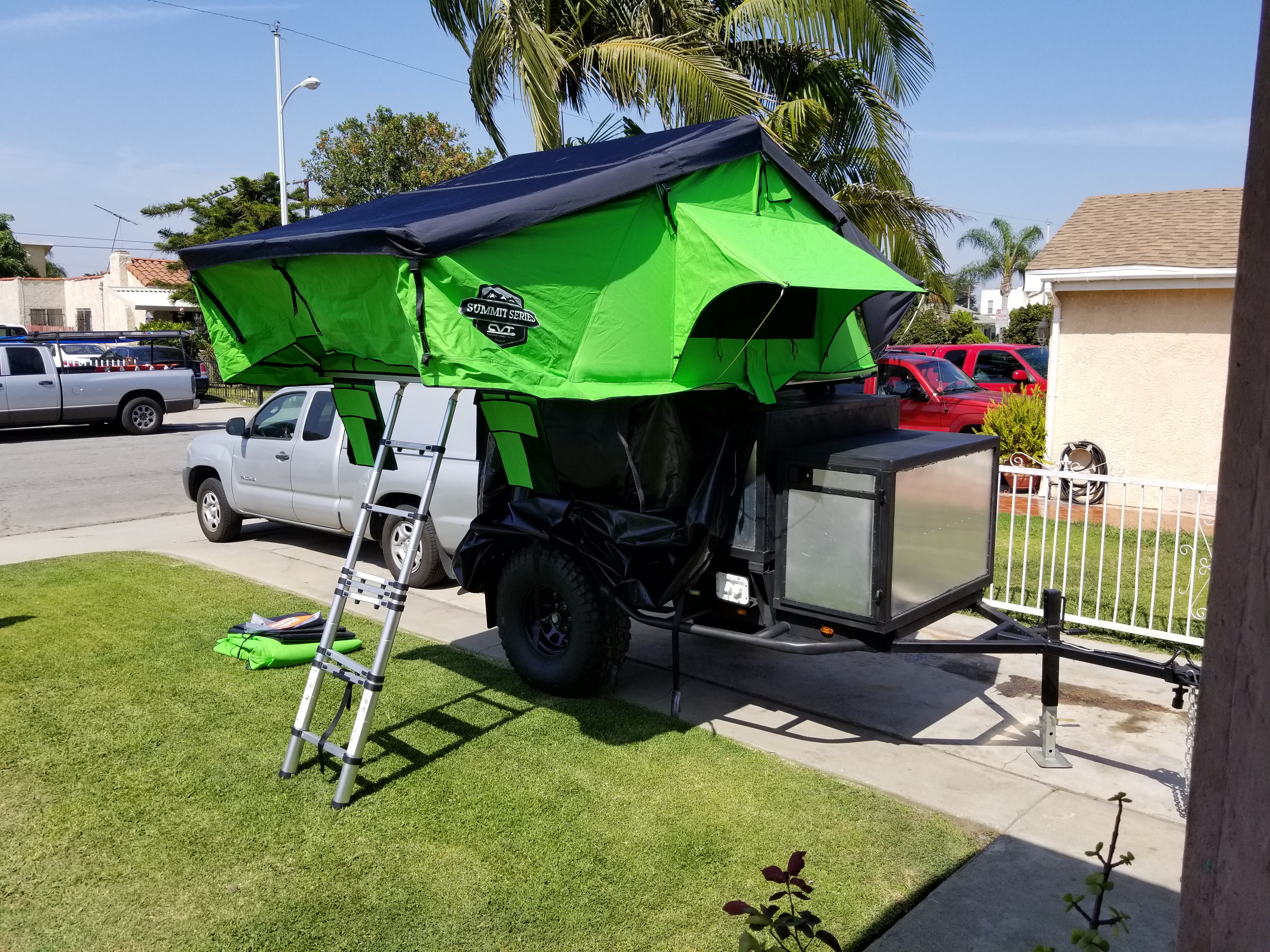

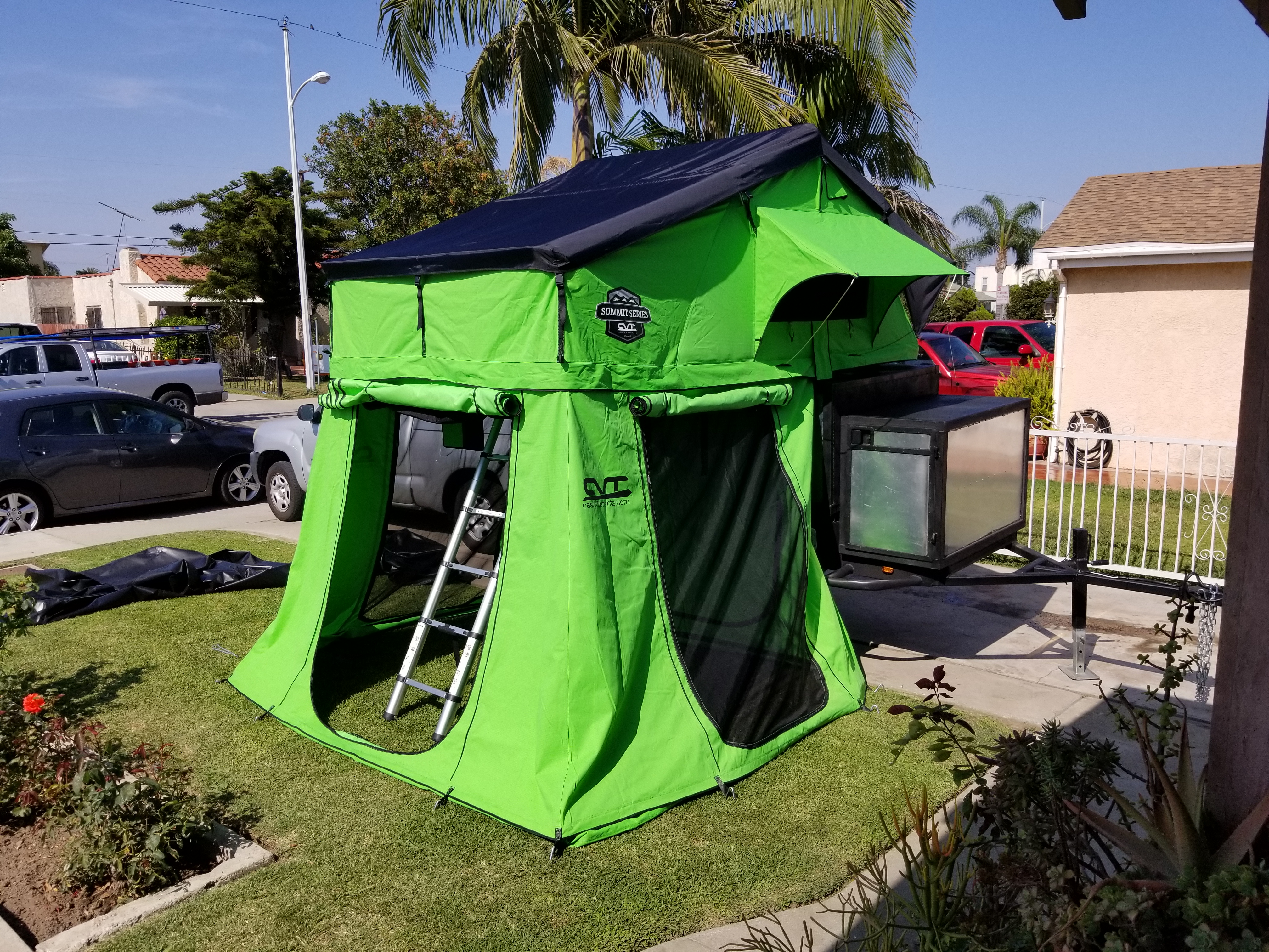

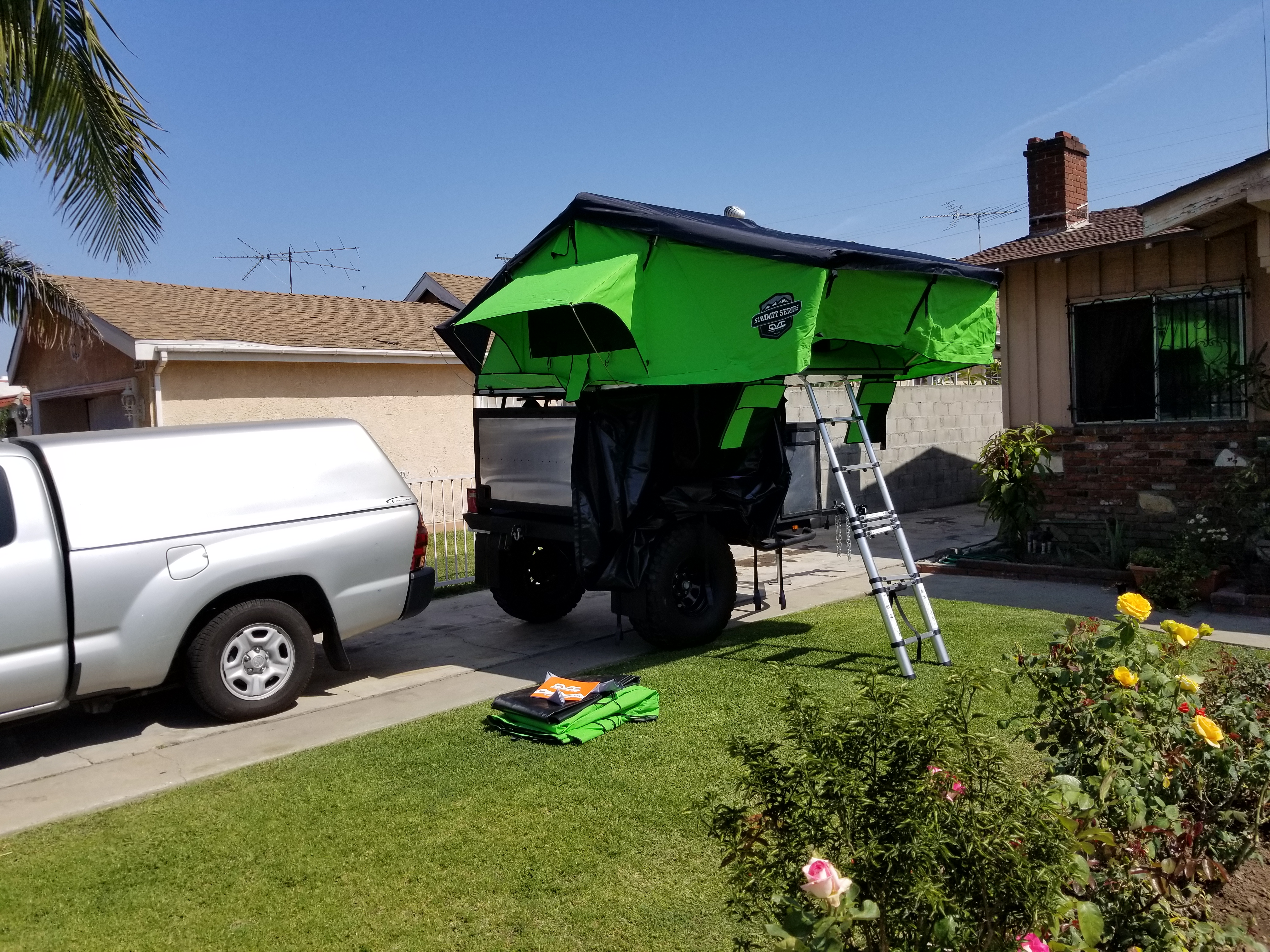

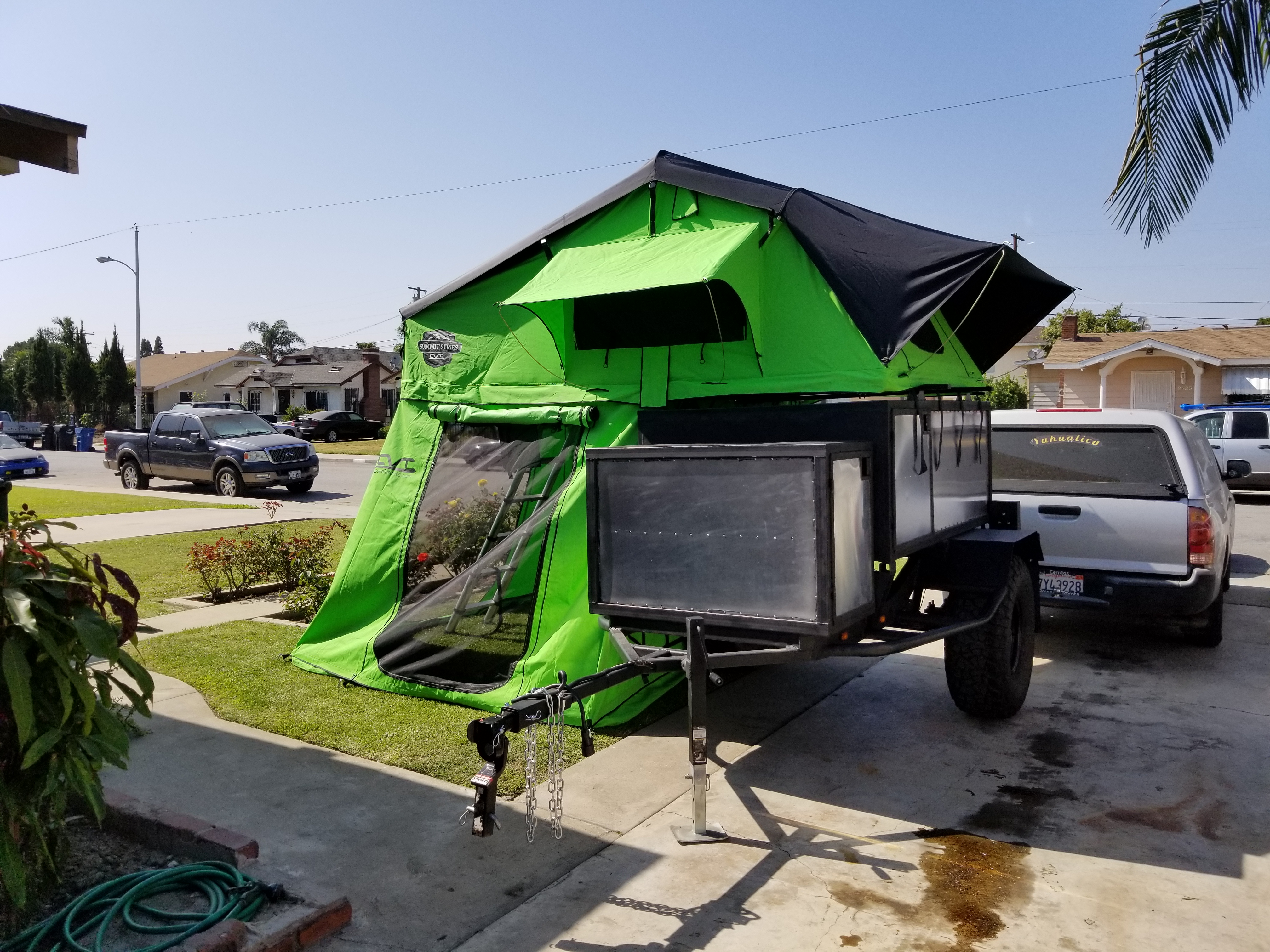

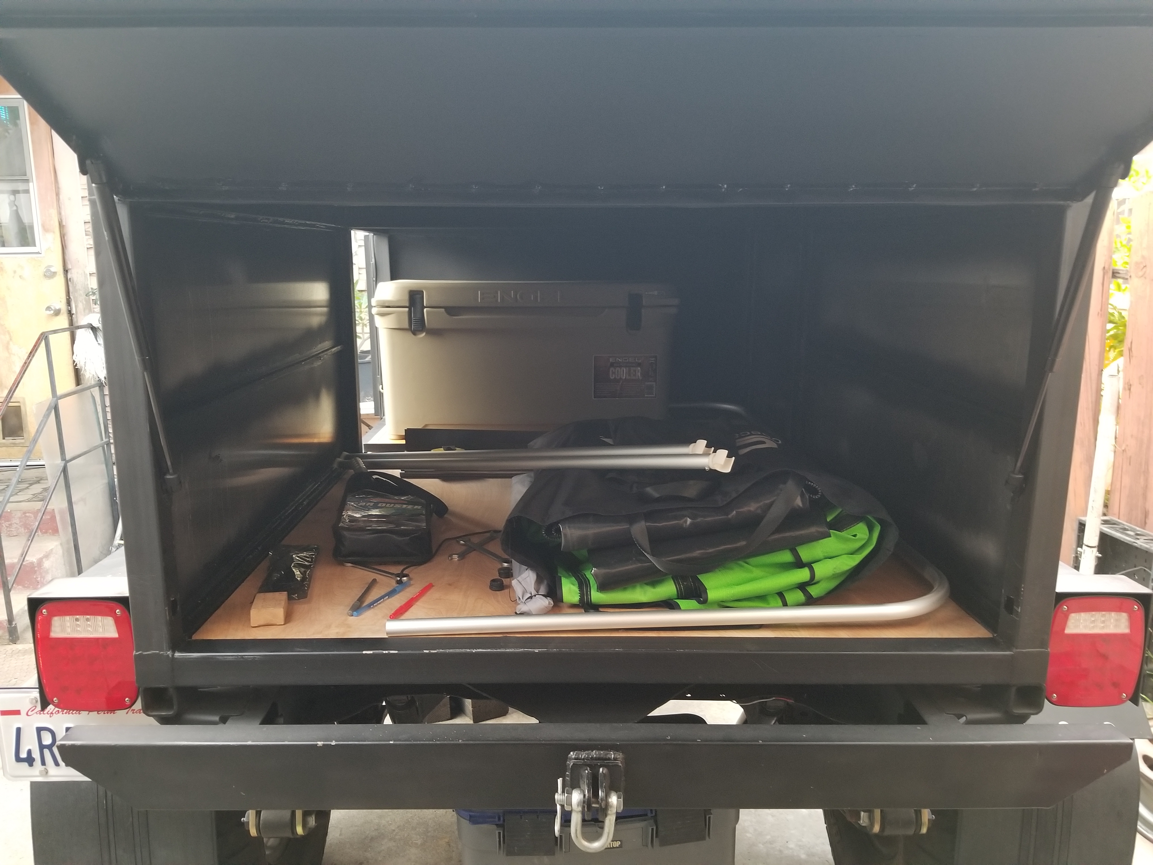

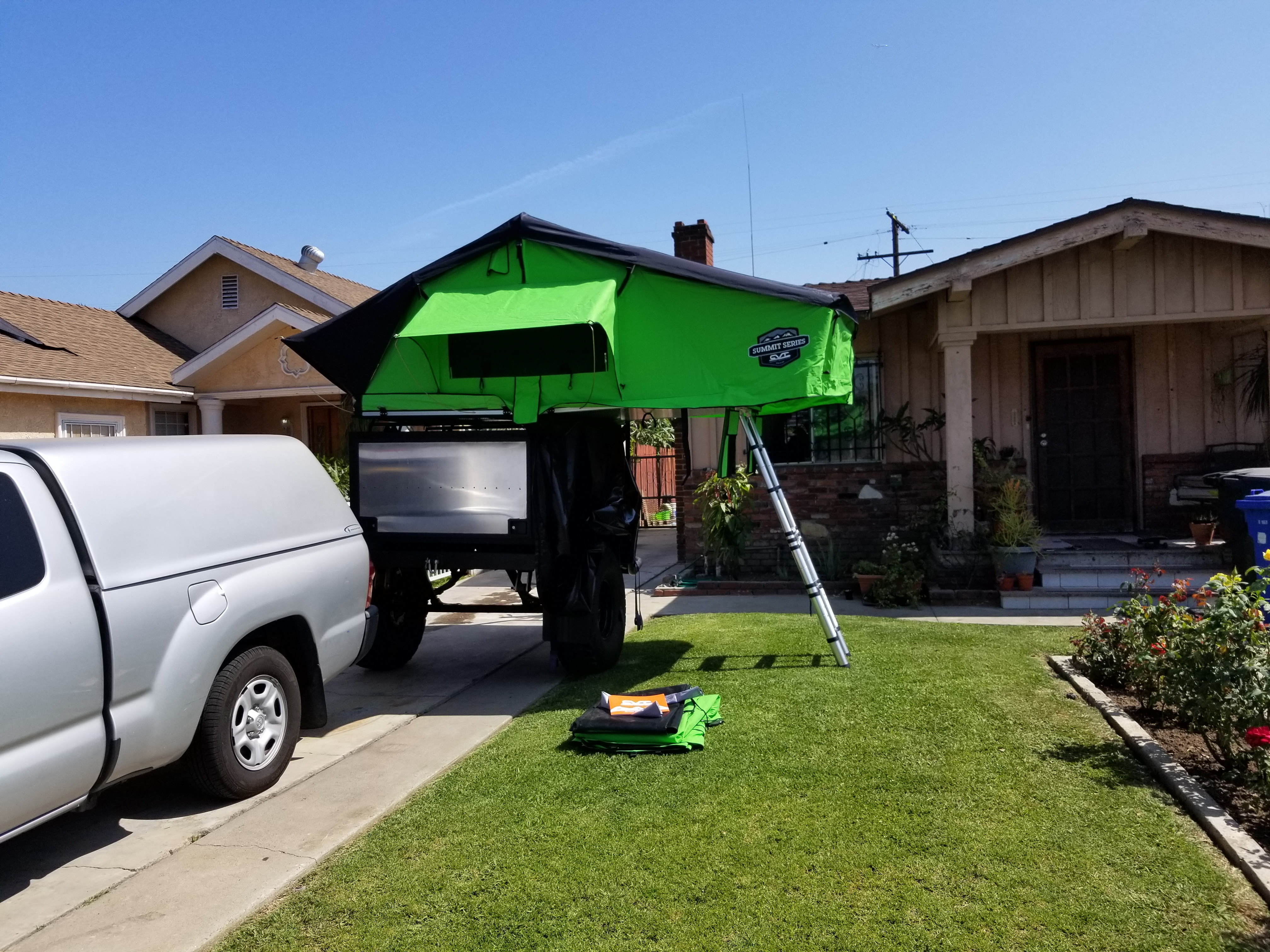

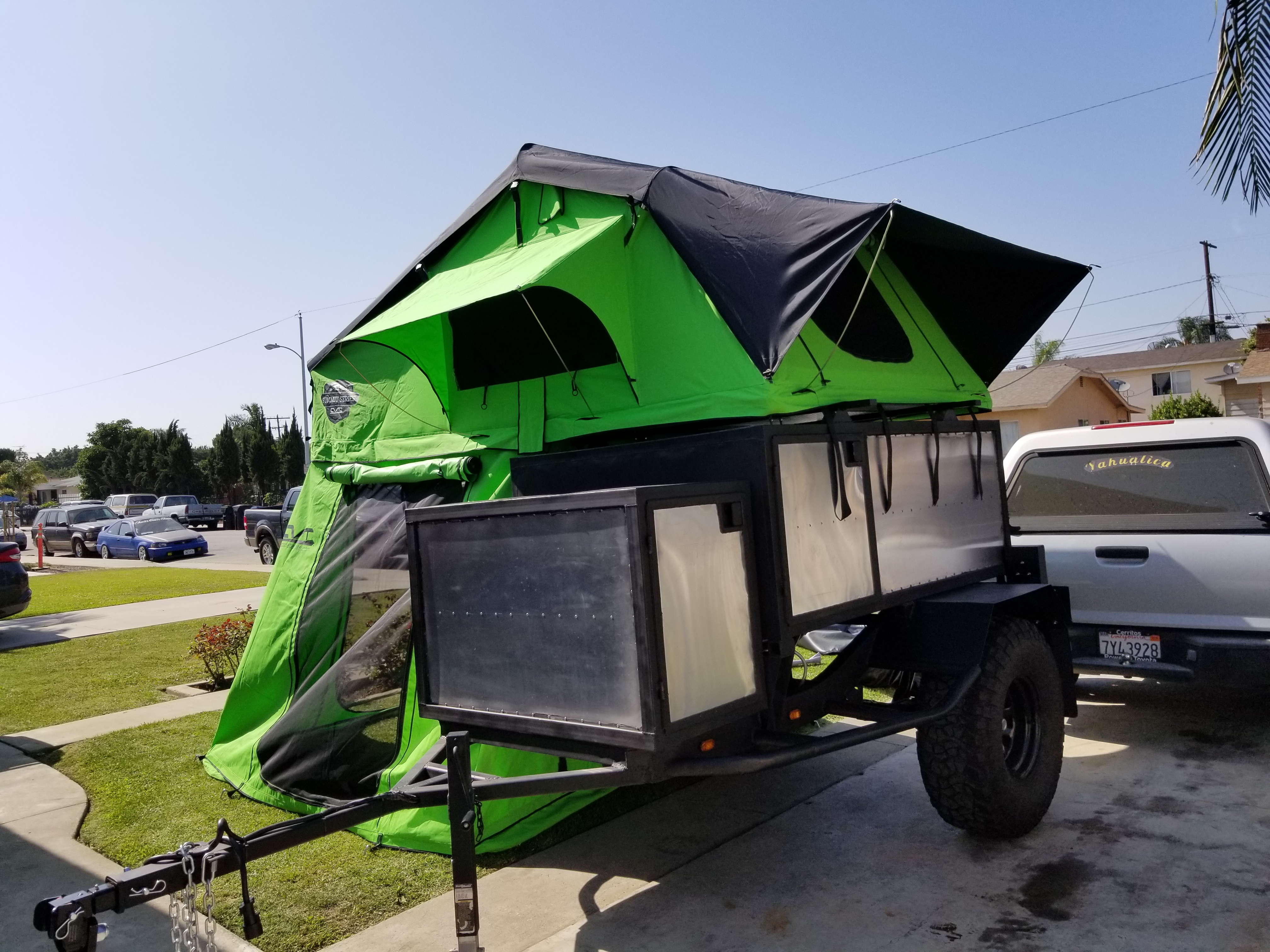

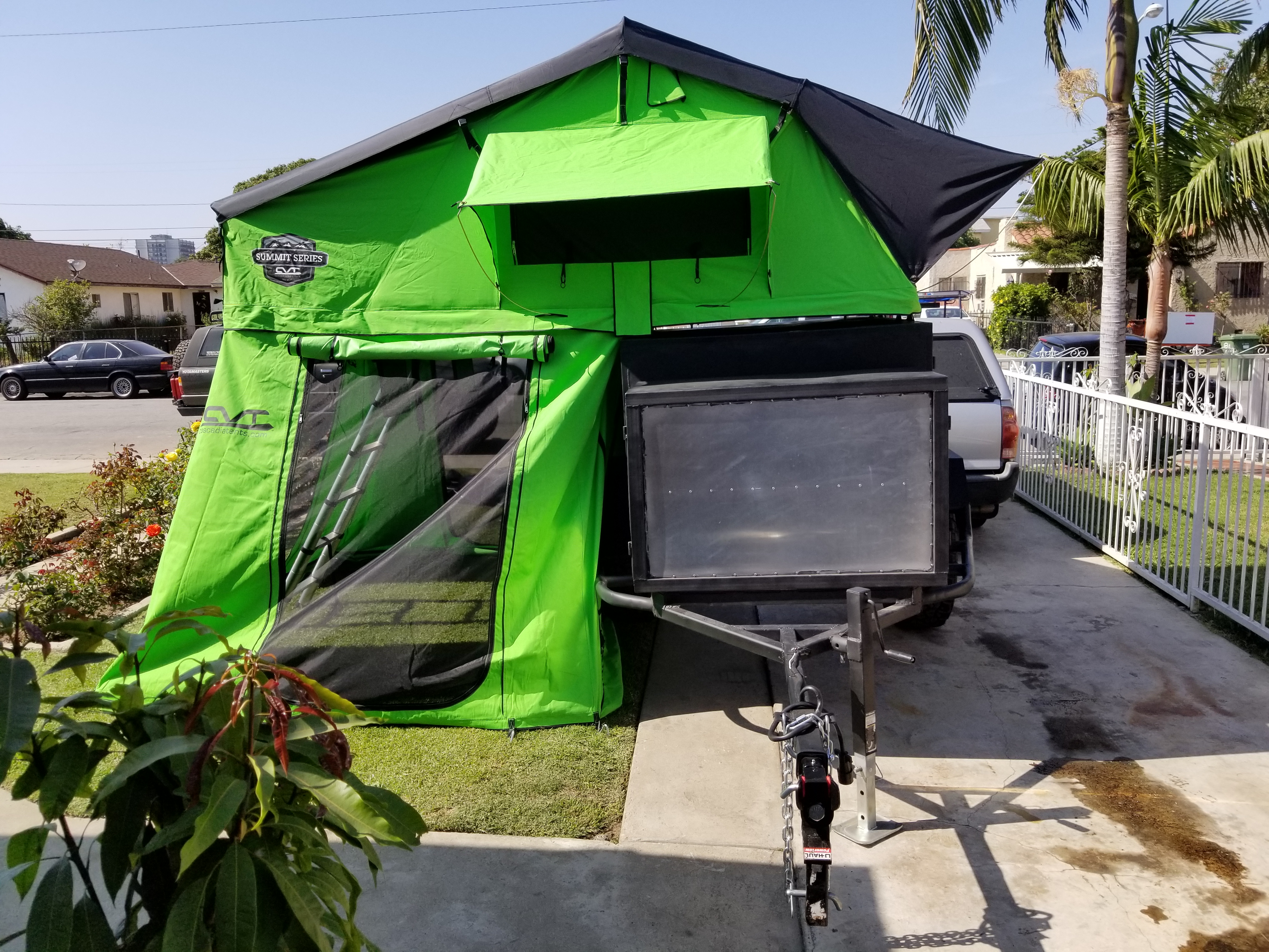

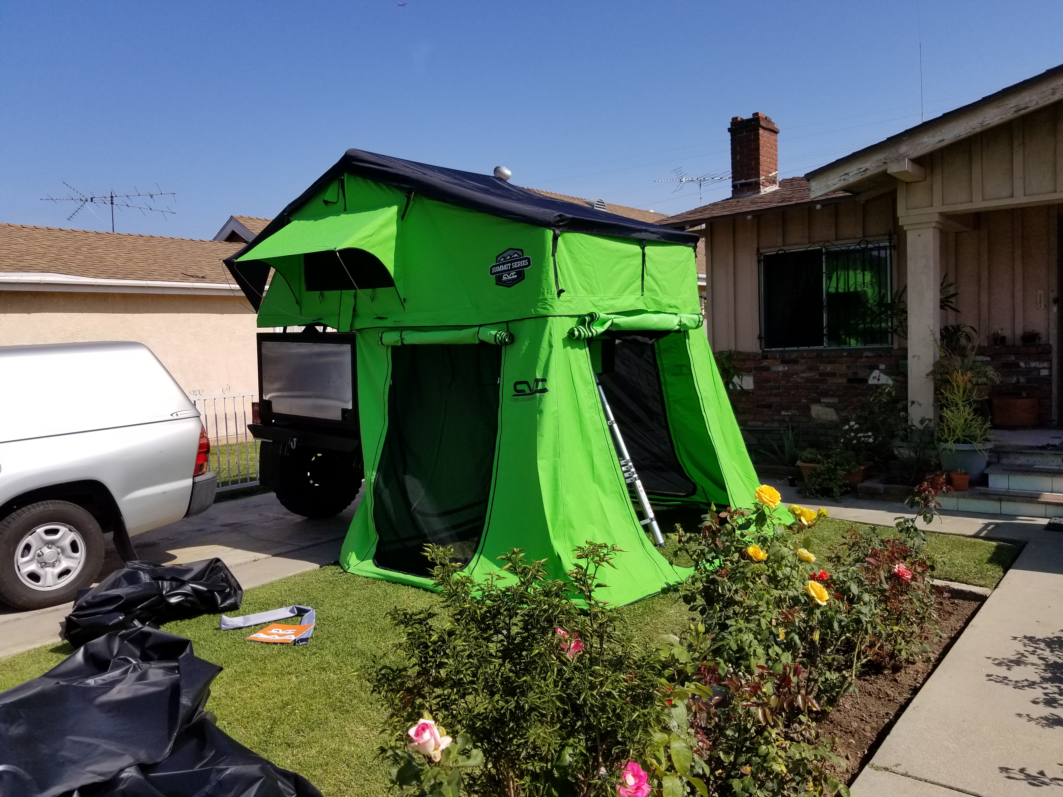

So i asked for the wrong day off. CVT ships with old dominion freight lines. And online it said my package would arrive today. But with this company you need to make an appointment for them to drop it off at your residence. Since i was a bit late with making the appointment i wouldn't be getting my package till Friday or Saturday but i had already asked for the day off from work to receive my package. So unfortunately i had to pick it up myself. But its cool at least my day didn't go to waste.

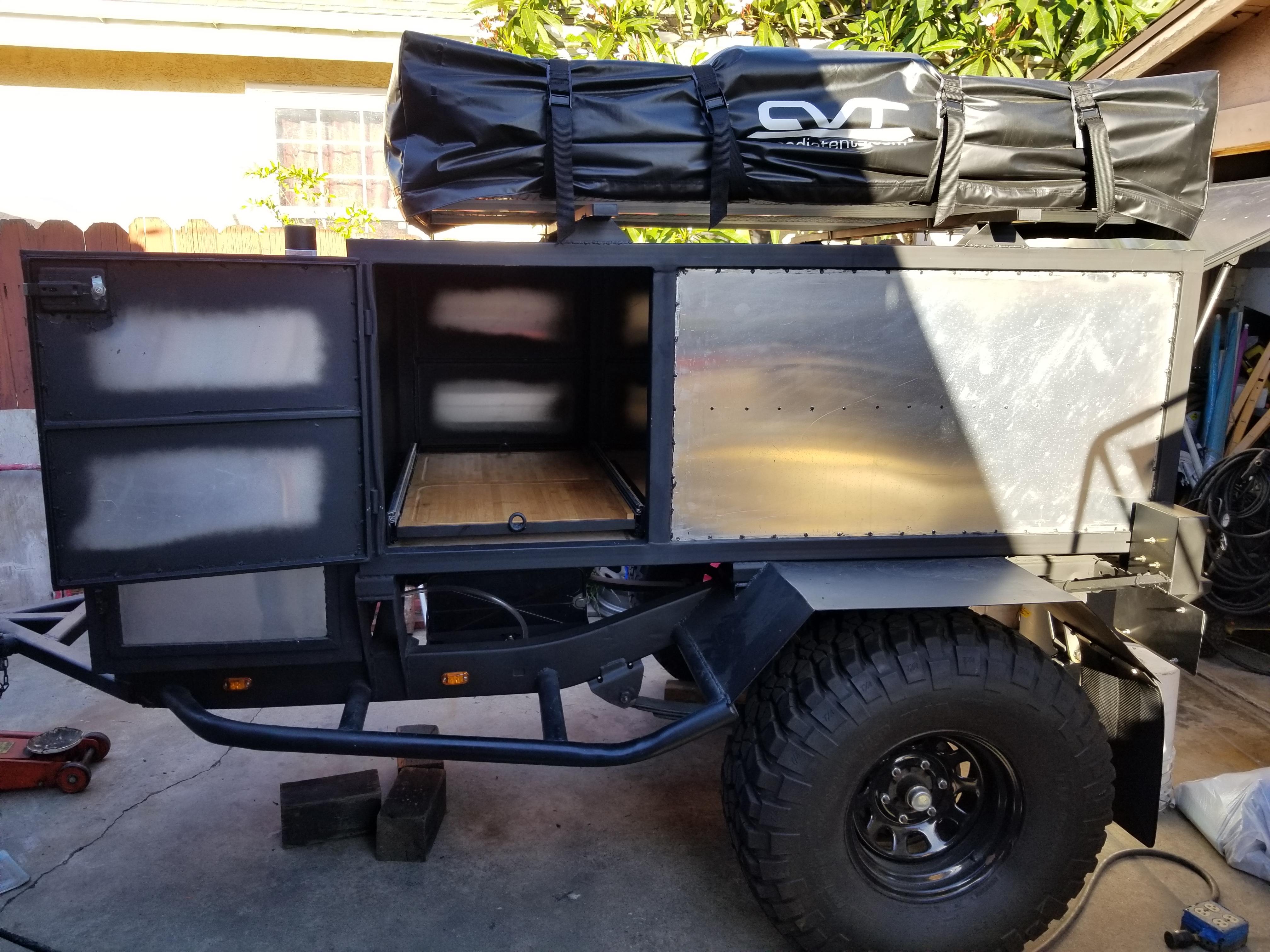

Here i had just loaded up the 278lb box. Me and one of their workers pushed it off the fork lift onto the truck's roof rack. Getting it off was kinda hard but at least i had help once i got home.

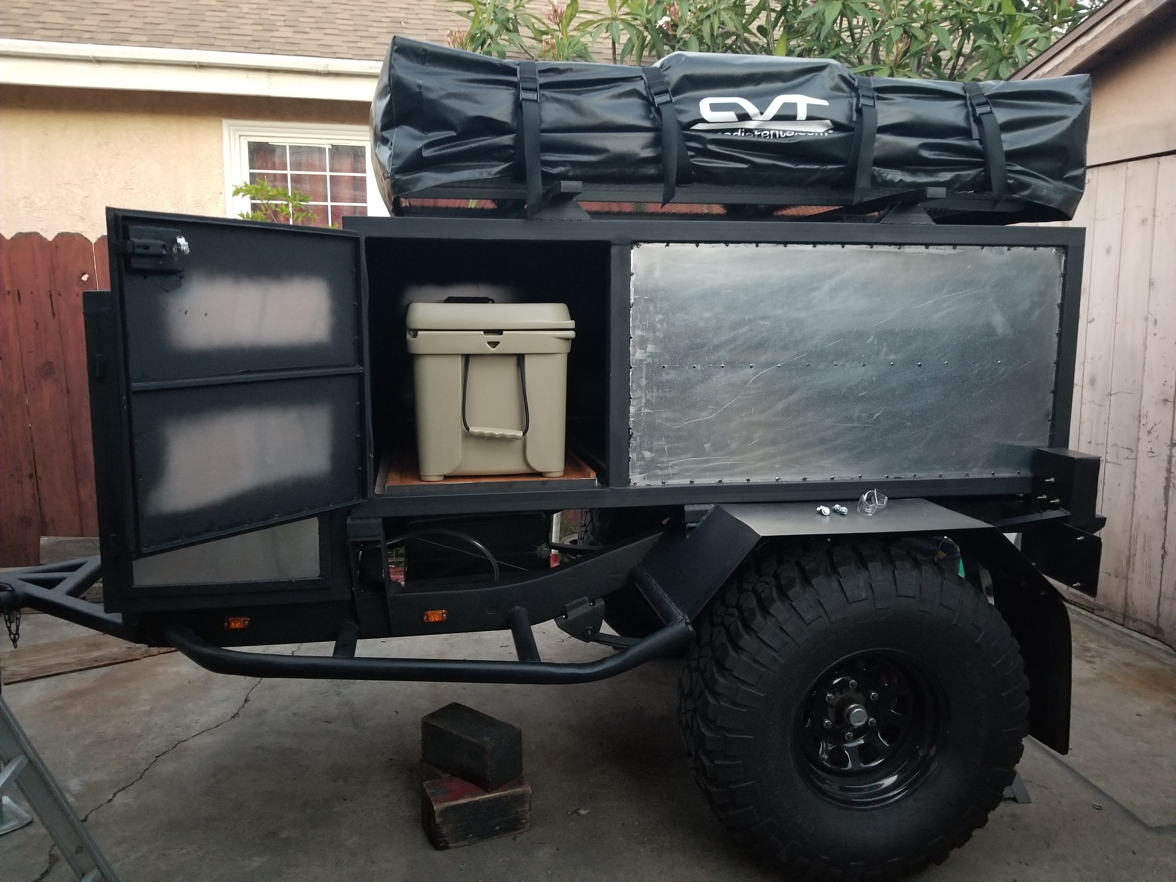

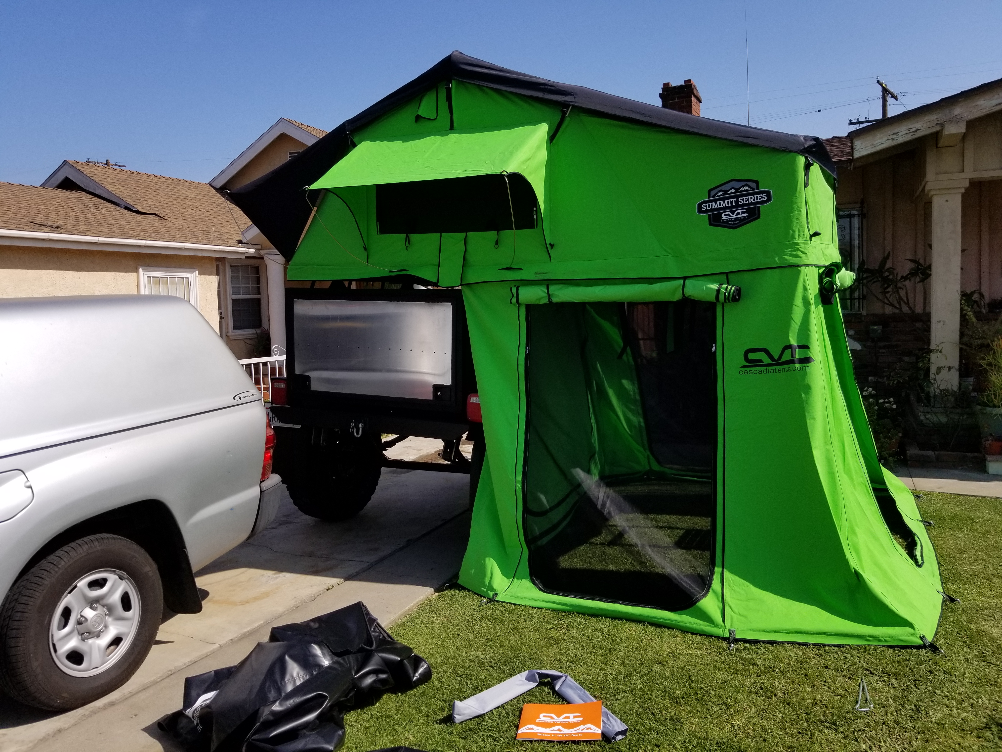

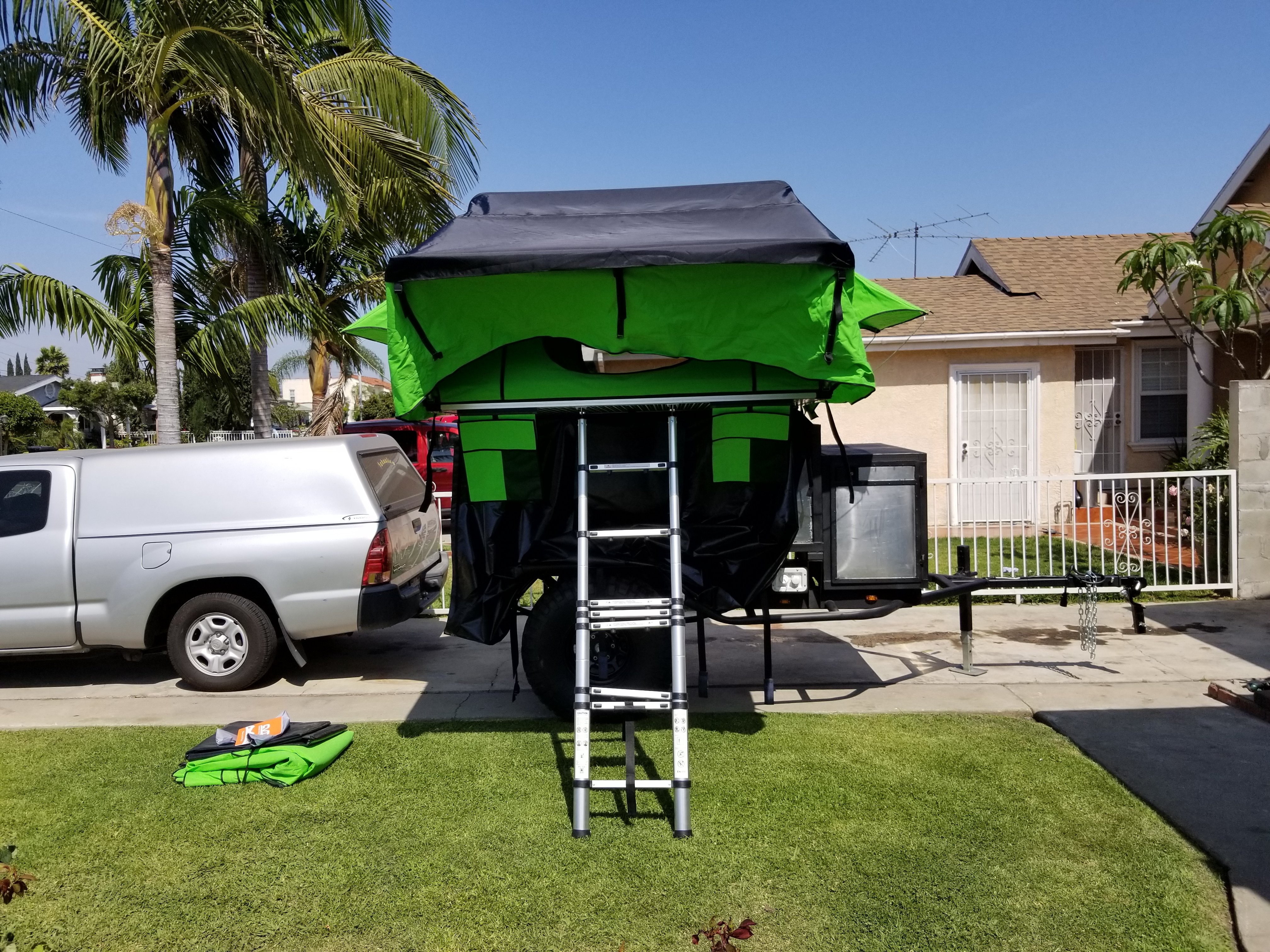

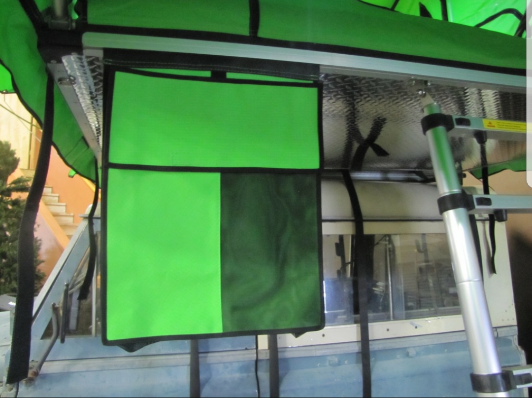

Putting the tent together is pretty straight forward. The package comes with an instruction book so it wasn't so hard.
This was right before i began to mount the tent onto the trailer.
Unfortunately i don't have any more pictures so this is just gonna have to be a little teaser for the mean time until i get around to taking more pix this weekend.
I will however give you my honest opinion about this awesome tent.

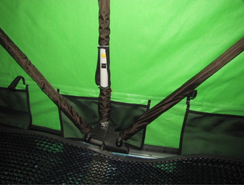

I love how thick the canvas material is. Yes the over all tent is heavy as hell but the quality of the material they used is very nice and so long as i don't accidentally get anything caught on the trailer while it is closed I'm sure it will be just fine. Not only is the canvas super thick but the black waterproof cover is extra chunky. You can definitely feel the quality in this one.
I love that they give you an anti condensation matt for under the mattress. It also includes 2 USB charging ports and an internal LED light.
Of course there has to be some minor flaw yes? In my opinion i thought the mounting hardware should have been stainless. I believe they provide zinc coated bolts and nuts but my biggest disappointment were in the plates that slide within the rails which hold the bolts in place; They are made of aluminum! Yes the instructions say do not over tighten but when i only have the nut on about 1/4" of he way in and i still have almost 1 more inch to go on the bolt length i don't think the mounting hardware should snap!!! My bolt seized. and snapped the tip of the bolt off. In addition, the aluminum plate was stripped so the new bolt that i eventually bought from home depot continued to turn and turn when trying to tighten because there was nothing to hold traction on the bolt when tightening the nut. Luckily hat entire piece is removable and i just tightened the replacement bolt and nut as much as i needed so it was snug on my trailer's crossbars then i tightened the rest of the way on the opposite side which the bolt and aluminum piece were in still good working order. So pretty much i put all the tension on the good bolt. I Highly suggest greasing the bolts they provide in the kit. It will ensure that the lock washers go in smoothly. CVT should definitely upgrade those plates to STEEL! because when a steel bolt is vs an aluminum bracket the bolt will always win.
Aside from this minor hickup in the installation I am very pleased with the entire tent quality. If i didnt have this slight set back i would have been able to take a ton of pictures with the tent set up and opened up with annex. Now i gotta keep you guys waiting till saturday lol

As promised here are the pix!
There she is in all her glory! I can't wait to try her out on a camping trip. This CVT roof top tent extremely easy to set up. It takes approximately 5 minutes to set up without the annex. And approximately 10 more minutes or so to do the annex (only because I'm not used to setting it up yet). The annex floor has enough space to fit at least a full size may be even a queen sized blow up bed.
This is the set up without the annex.

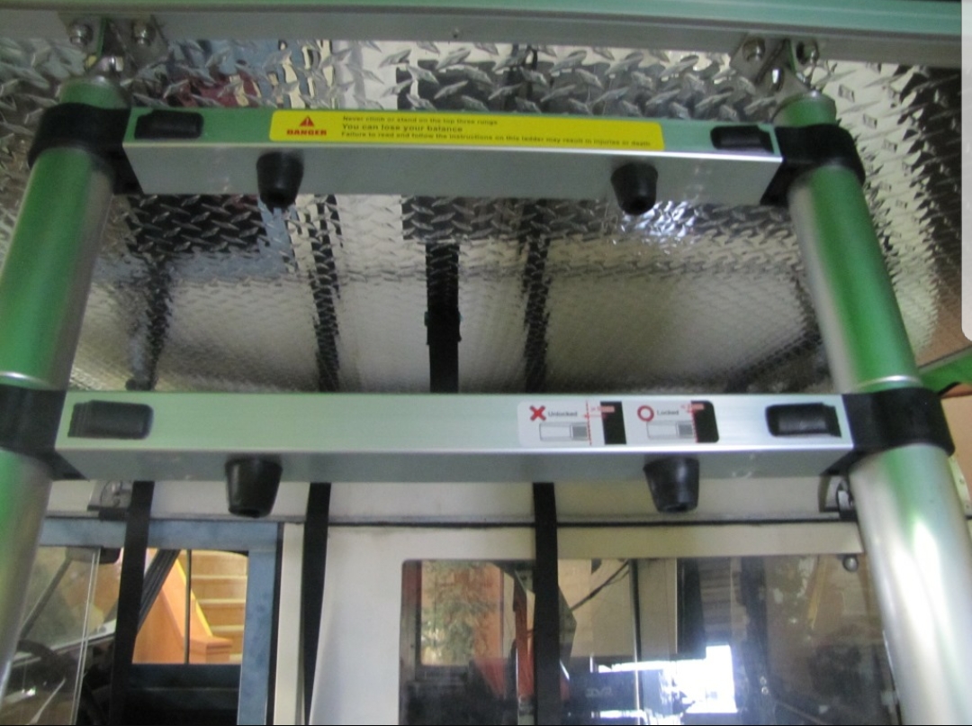

Don't worry about that telescoping ladder, i just hadnt figured out how to properly adjust it in these pix. It looks crooked in the pix. After i had figured it out i adjusted the unused steps and moved them all to the top.

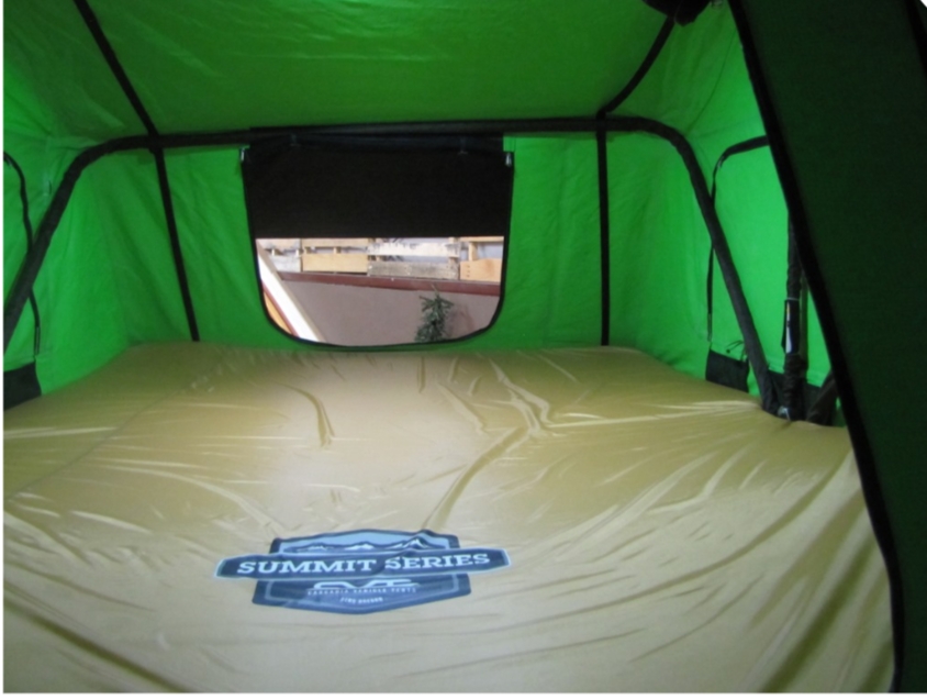

It's huge. And as you can see on the inside picture you can see how much space is still inside. I am 5'8" 260lbs. And there's enough space to fit 3 of me up there. There will definitely be plenty of space for my girl and I and with her son Isaac.
I later learned while trying to set up the annex that getting it ready would be a hell of a lot easier if i had put the annex floor in front of the side of the trailer (where the tent opens up to). Another thing is setting up the annex would be 100% easier to remove the CVT tent cover completely because the annex slides into the same channel across the side of the fold that holds the cover on. and trying to get it inside is much harder to do once it is popped open and already set up. So next time i would definitely place the annex floor. Route the annex through the channel on the side of the tent. Then open up the tent and place the ladder on the center of the annex then pull up the annex and zip it up followed by the rest of the set up. Also considering it may be windy on some days the annex stakes would be handy to place right after it is zipped to the actual roof top tent.
Here you can see where i had already fixed the ladder issue. Now it looks good!
The trailer looks tiny with this tent/annex set up lol
Today was a pretty hot day. It reached almost 90 degrees. So when when my girl, Veronica, and i were setting up the tent we quickly learned that the aluminum metal floors and telescoping ladder get extremely hot; EVEN WITH THE TENT COVER! Opening up the tent at first was pretty hard because it burned to the first touch so i cant imagine how the heck we are gonna set up camp in desert areas lol At first with the crazy heat wave that we had i realized it was pretty hot inside that tent. BUT with all the windows open the inside of the tent we saw a huge temperature drop within the first minute. Especially since the tent sit's up high we got a really nice breeze. I had all the doors(minus screens) open and it wasn't too bad. I'm sure if we added a couple 12v fans in there it would be even better!
Also like i said earlier, I am 5'8" and i was able to stand under the annex just fine. The bottom floor barely touched my head so i approve. The height i built this thing at was perfect. Going with a 3" lift on the trailer was an excellent choice.

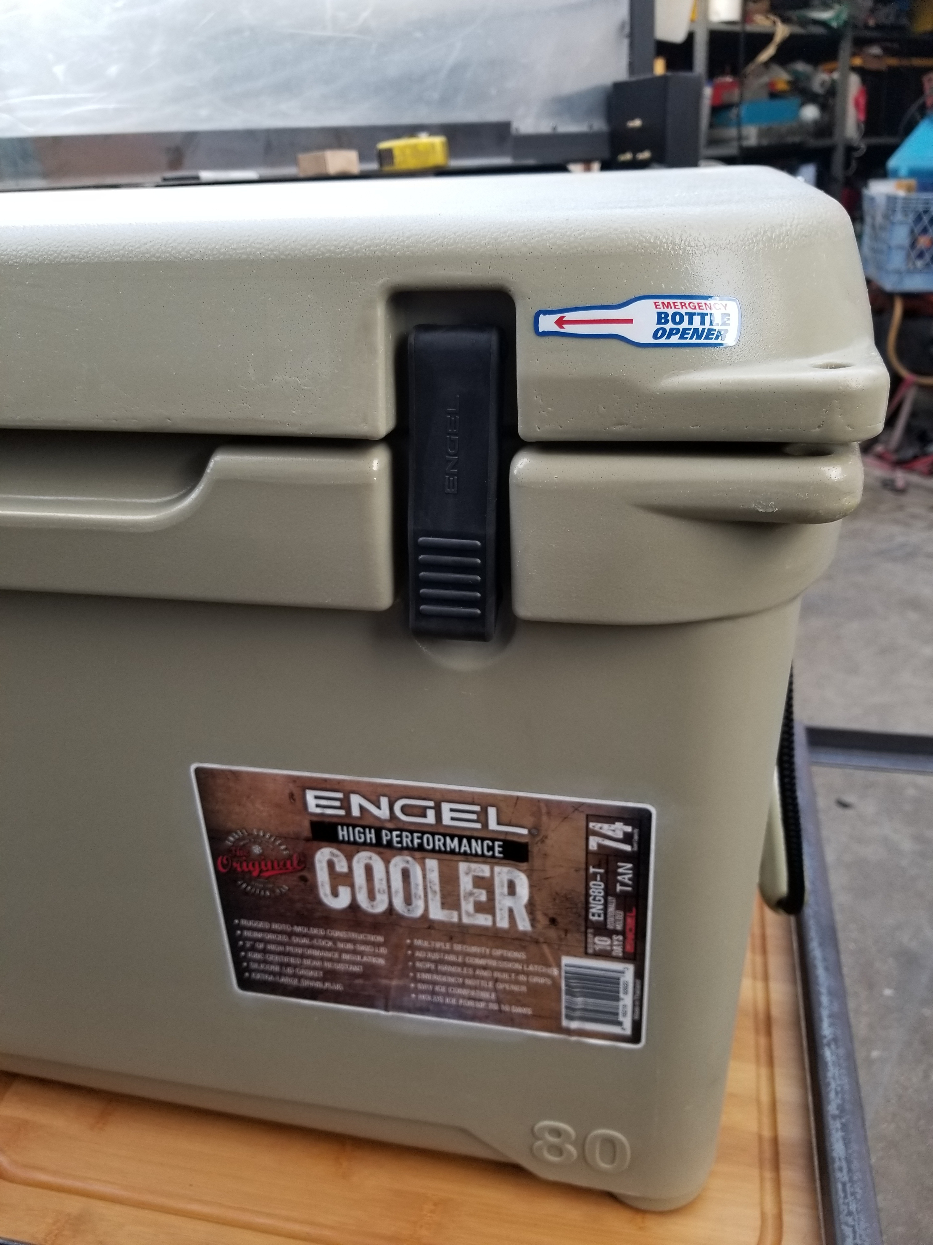

My amazing girlfriend was kind enough to offer to buy us the high performance cooler that i wanted.
Since we have 1 kid and eventually will have 1 more on the way, plus we plan on going camping with larger groups of friends/family we decided to go with the Engel 80 Roto-molded Cooler. We watched countless of youtube comparison videos online and made up our minds that tne ENGEL coolers were the best coolers on the market and the one for us. So Here is the link to what we bought:
https://www.engelcoolers.com/engel-eng80-cooler.html
It is an 80 quart cooler so we have more than enough space inside for a long weekend (or week) worth of food. I chose this large size because ice always takes up space on coolers and usually takes up valuable space where we can be sticking drinks and food. So at least with 80 quarts we can add a decent amount of ice to keep stuff inside cold and not have to compromise bringing more food, drinks and snacks.
Here it is:
We also decided it would be wise to buy a center divider and a hanging basket for the cooler to keep the more wanted separate and easy to reach rather than having to dig around in the cooler. this will have save time grabbing things and help keep the cooler closed longer to maintain the cold temperature from so much opening and closing.
All in all we spent $330.97 for all 3 items with free shipping

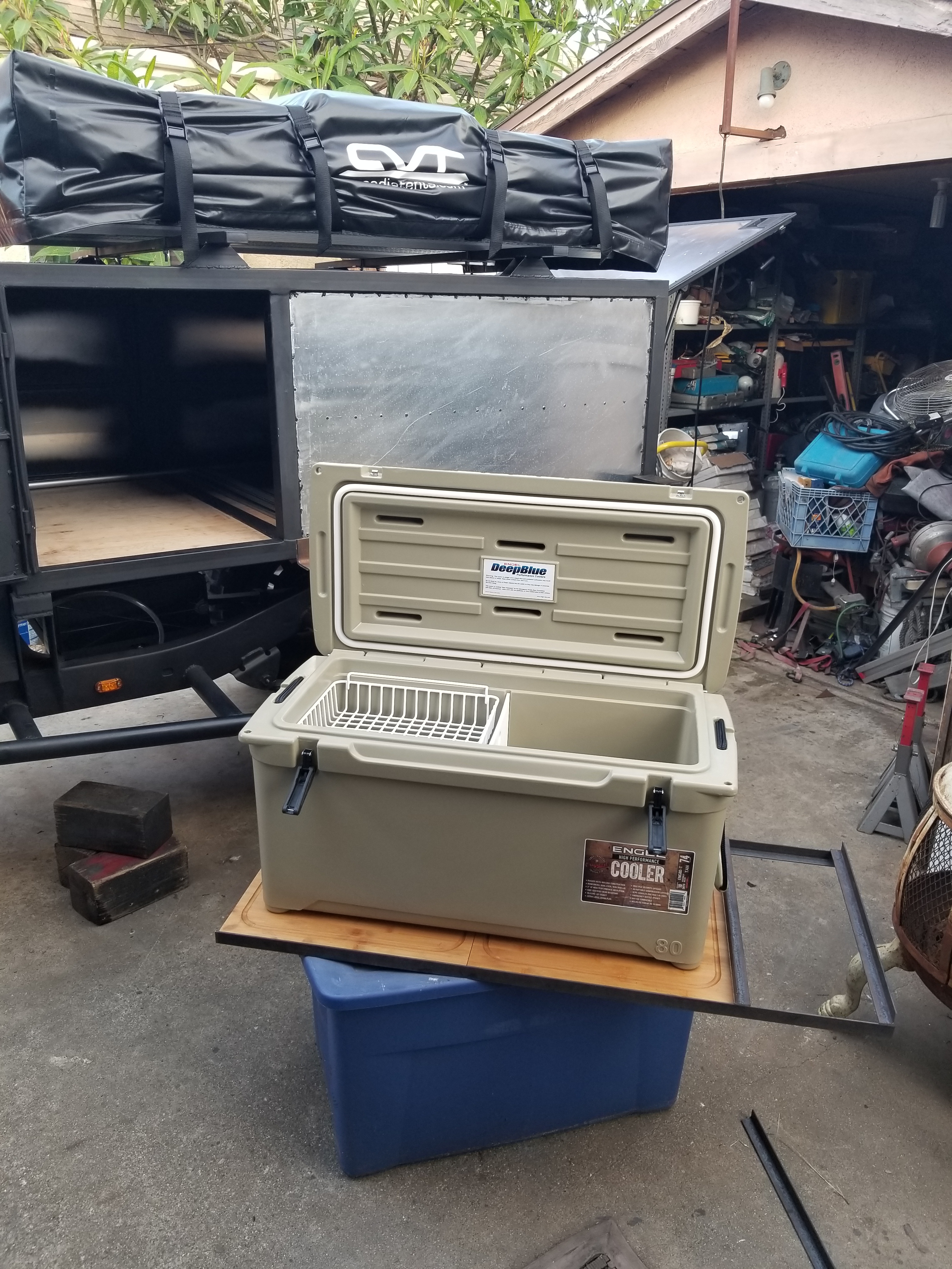

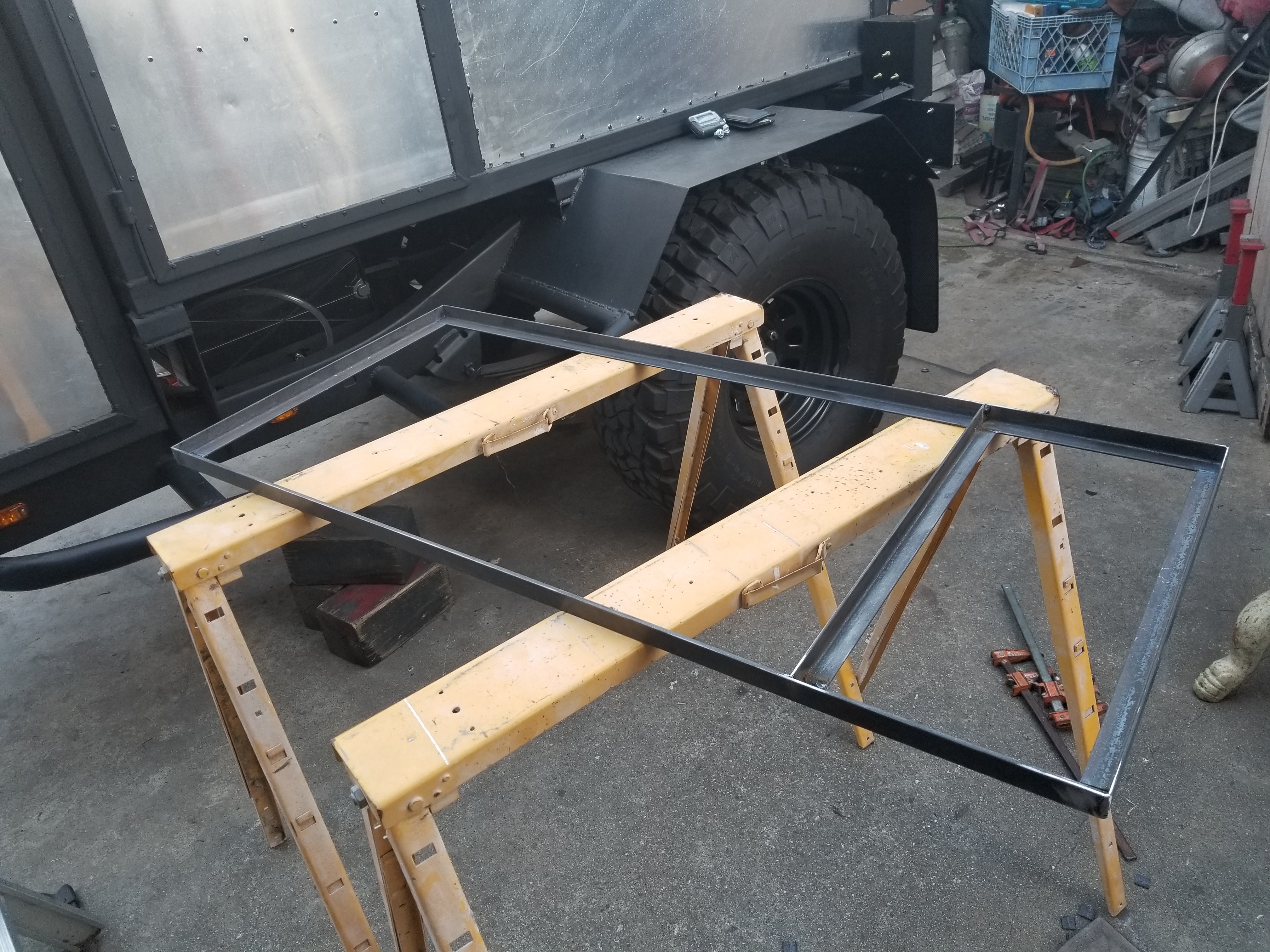

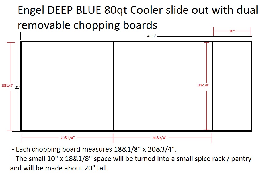

Working on. The cooler slide out. I bought 2 full size 'home kitchen style' bamboo chopping boards at IKEA for about 30 bucks and the 2 of them side by side ended up being the exact dimensions that I needed for the footprint of the Engel Deep Blue 80 cooler. Both chopping boards together measure out to be 18&1/8" × 36&1/4".
Each chopping board will be able to be removed individually if needed. And I'm contemplating adding brackets underneath to be able to have 2 removable basins which I can utilize as space to wash utensils and such. On the space past the chopping boards I have a 10"×21" space which I plan to use as a spot for a small spice rack, and pantry. I can possibly add a storage for disposable cups and plates because I am able to build this cabinet space up to 20-22" high. We'll see. A lot more to come for this portion of the build.

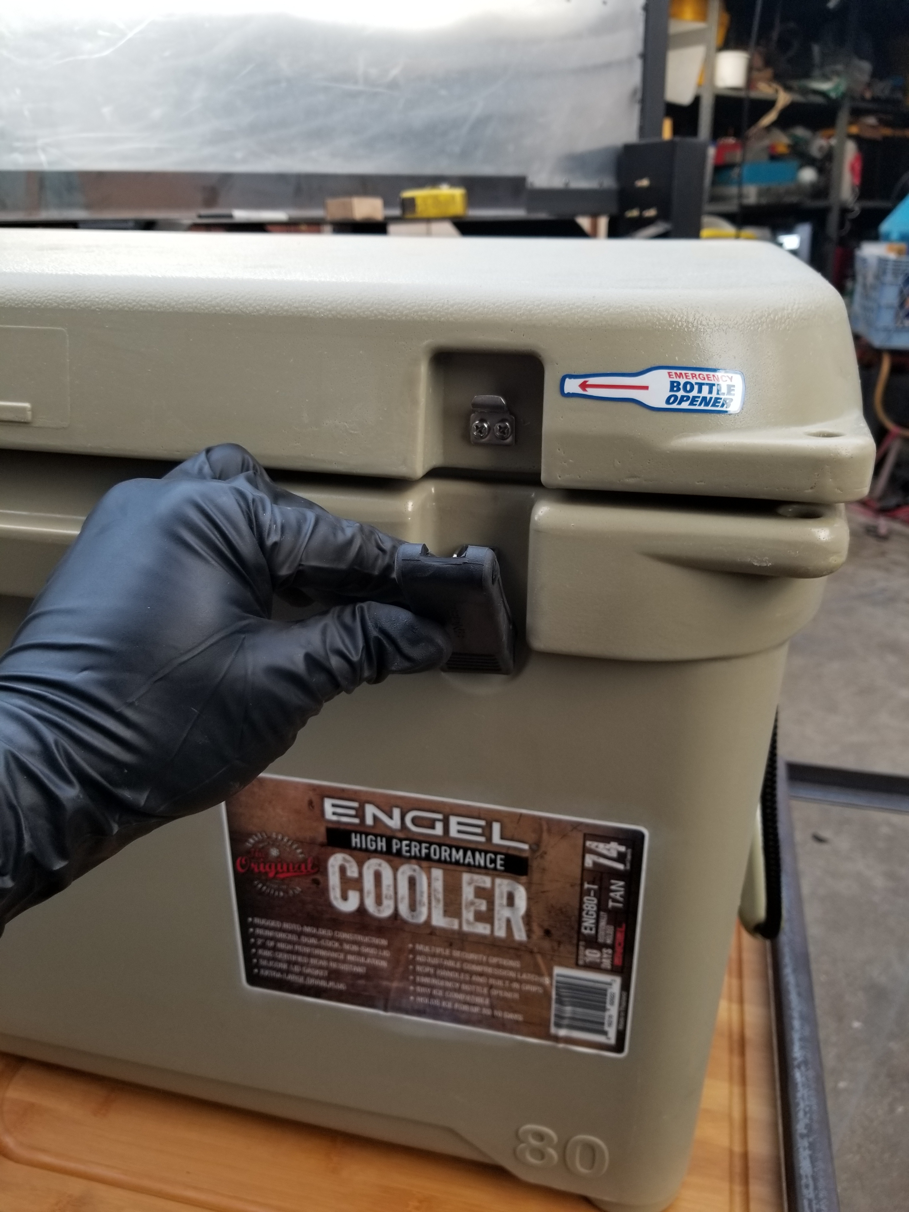

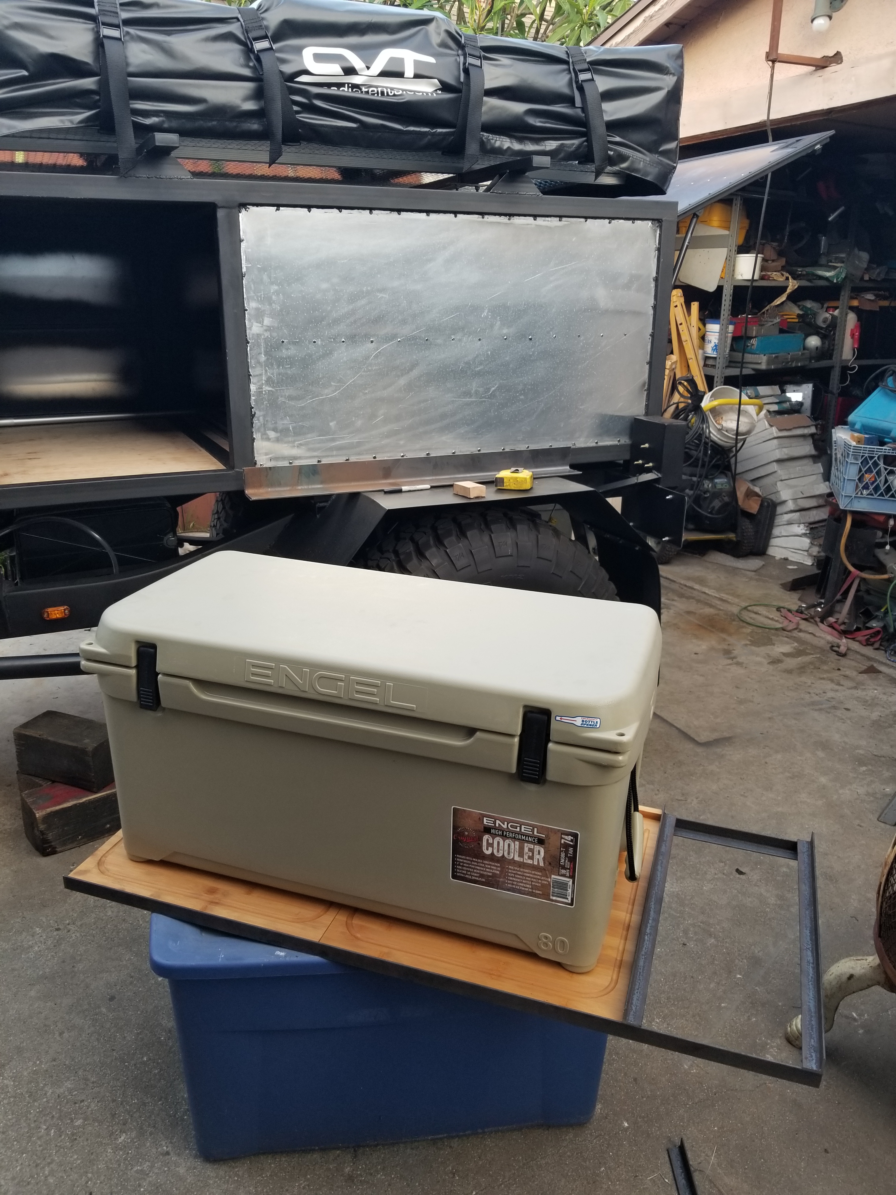

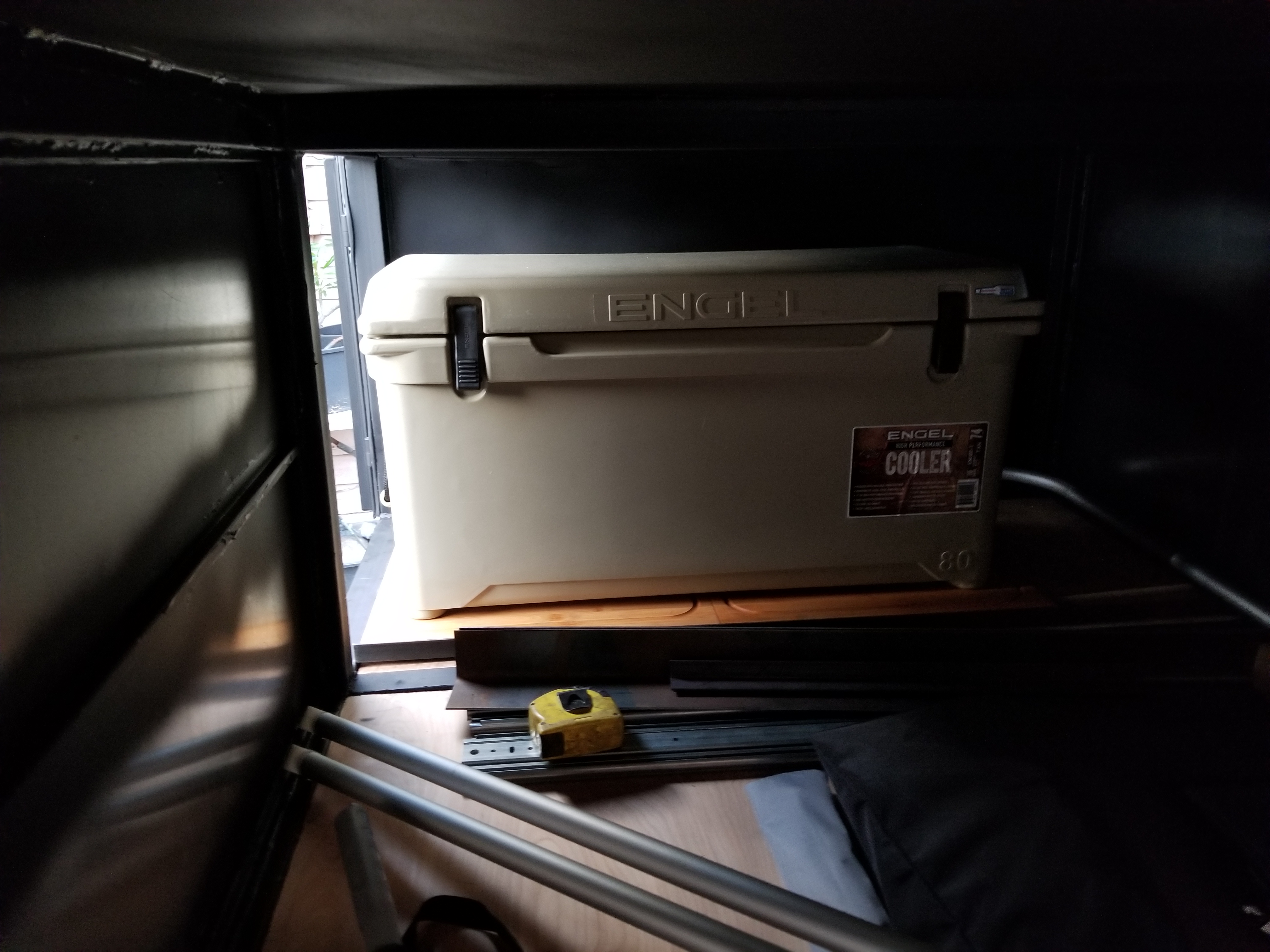

Aside from starting the slide out My Engel Deep Blue 80qt cooler came in this weekend Thanks to my lovely girlfriend who is just as anxious to see this trailer build complete as I am. I think she is just as anxious to try it out too It has so much space. I love the fact that it has a divider to keep items separate and the basket to keep items on top for easy access. Also has a built in emergency bottle opener!
More or less an idea of how it will be
...and how it will fit inside. I'll definitely have to add some hoops so i can strap the cooler into place
Here's the basic outline of how i want it

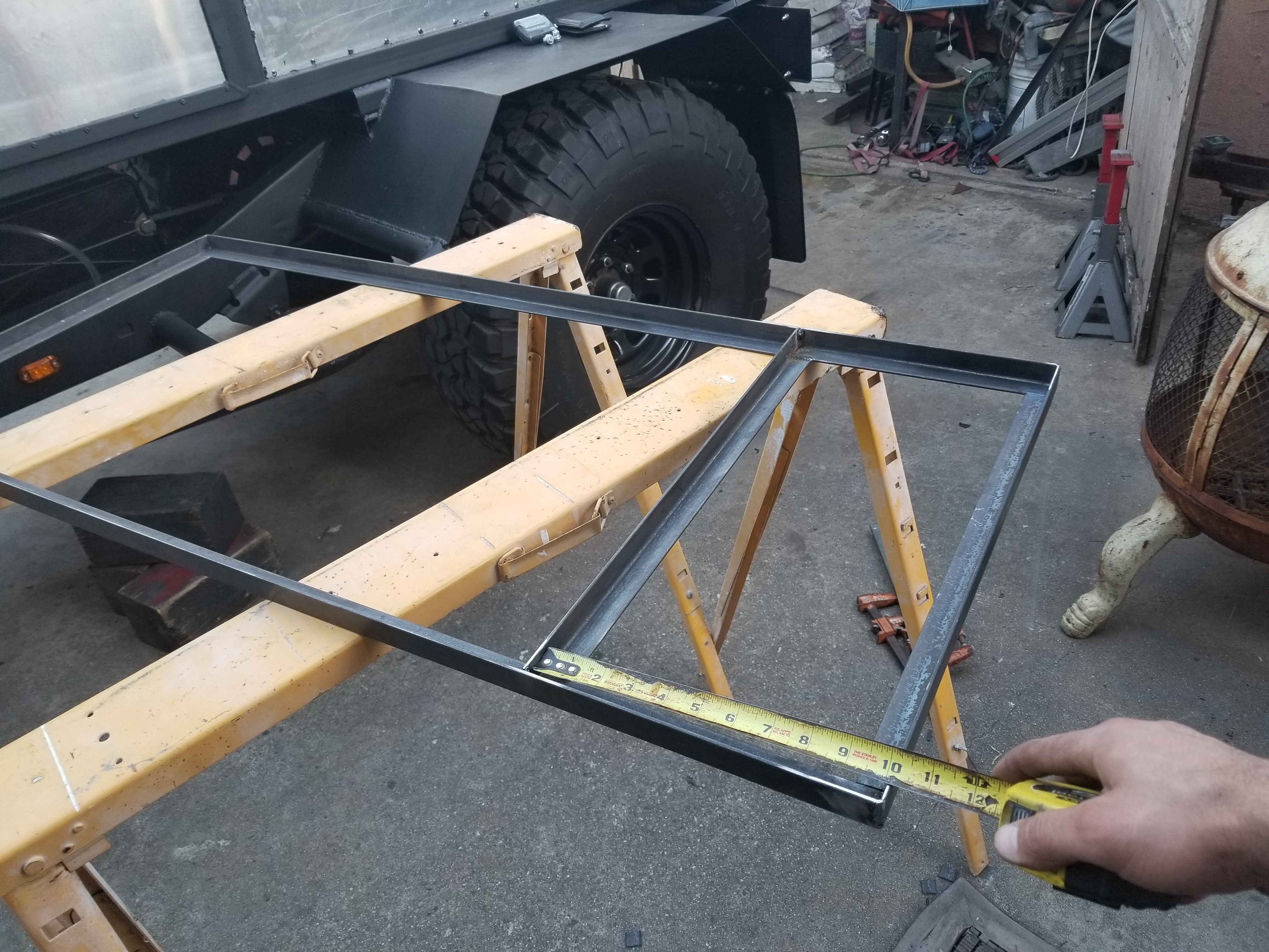

Got some more done. I'm kinda on a deadline with this particular portion of the build. I need this slide out finished by this weekend because next weekend (June 23, 24 & 25 we are heading to Lake Elsinore to camp with the family. i want the slide out to be complete so i can strap the cooler in place on the trailer. If not i will have to take it in my truck because i don't want it flopping around on the trailer floor
Anyway are the beginning stages of the cooler slide out. I have the frame of it made already I just need to weld some mounting nuts to the actual area on to the trailer so I can adjust it back and forth as needed to center the slide out where I need it to be. The smaller space next to the chopping boards is going to be where I mount the spice rack and pantry box. I still need to create that.
Those Slide out rails have a weight capacity of 500lbs. MORE THAN ENOUGH! and they extend out 36" which is basically he length of the Engel cooler.
There is how she will sit inside the rear compartment.
Something else that i ordered this past week were 3 matching hitch locks. They all use the same key, and all 3 match the hitch lock that i use for my front bumper license plate/winch anti-theft plate.
on my front bumper
Gotta keep theives away from stealing my winch.
on my front bumper

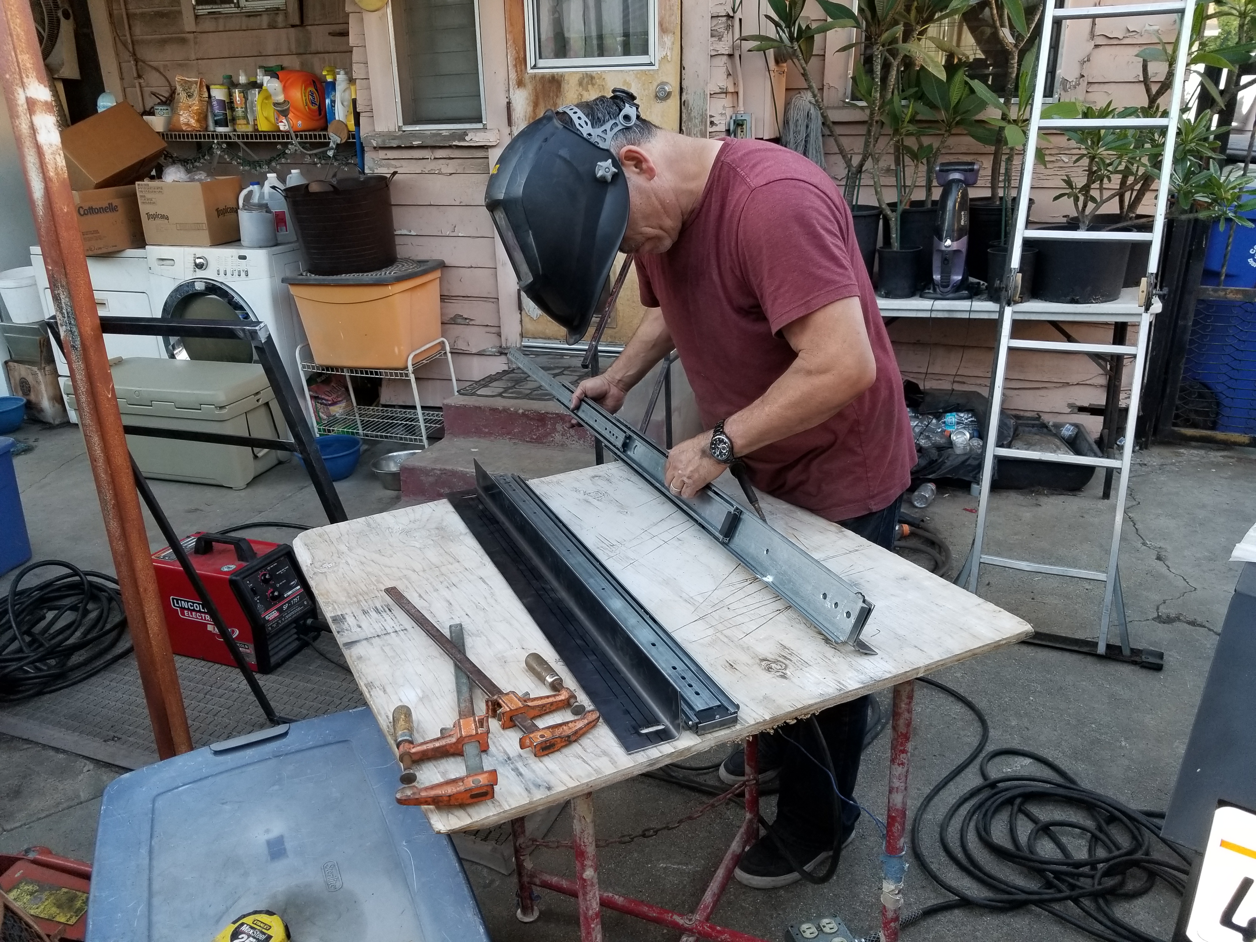

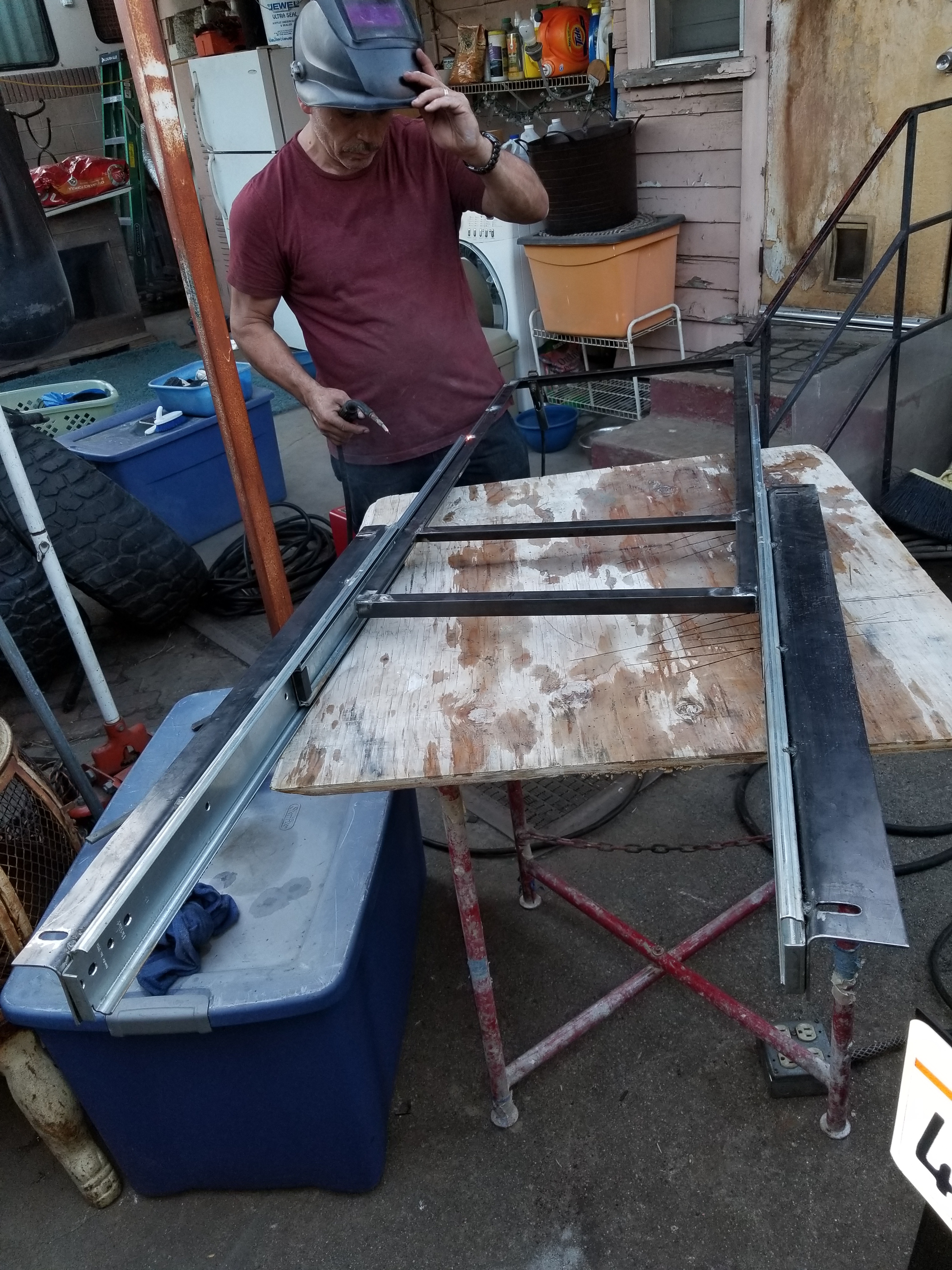

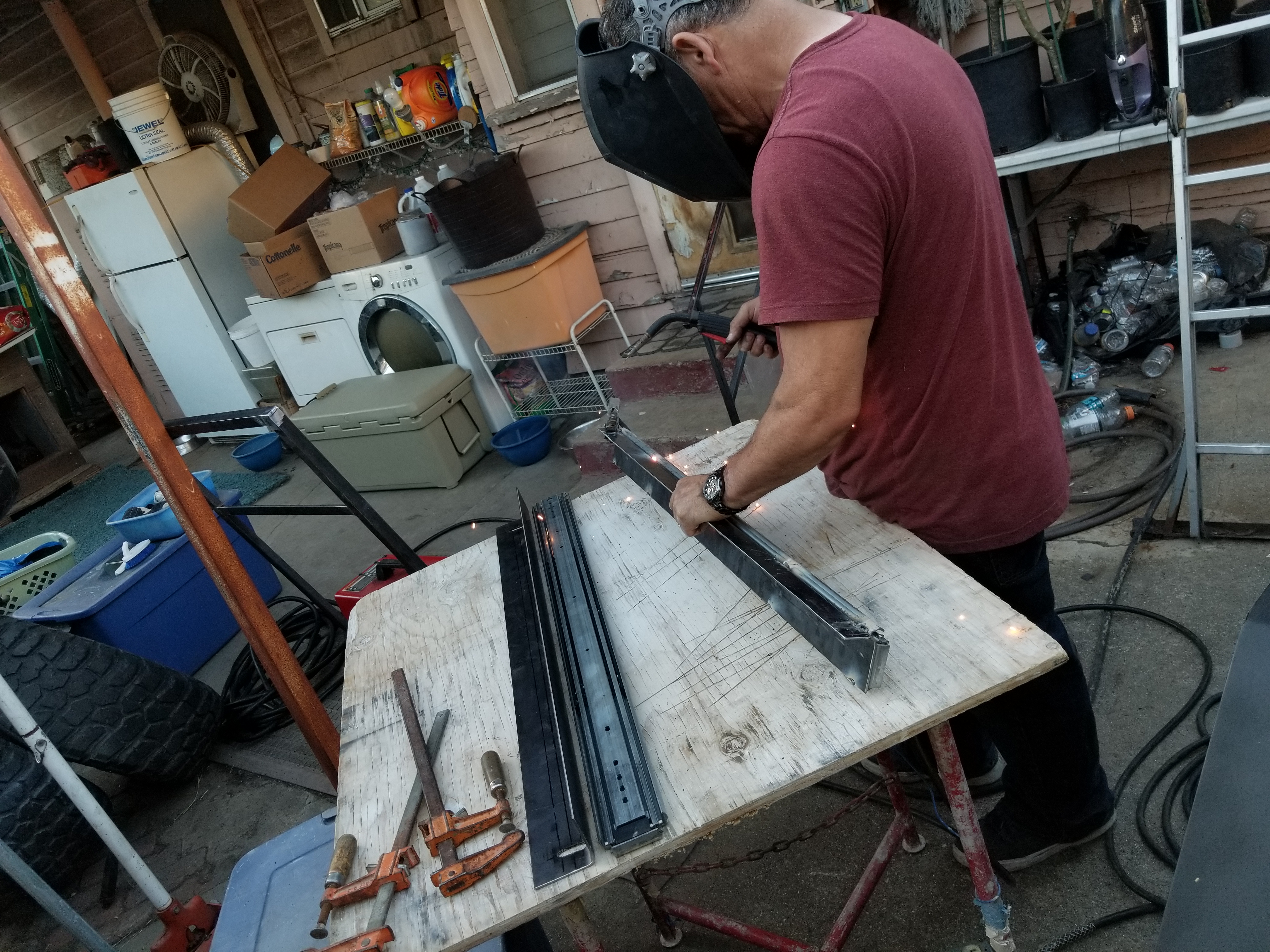

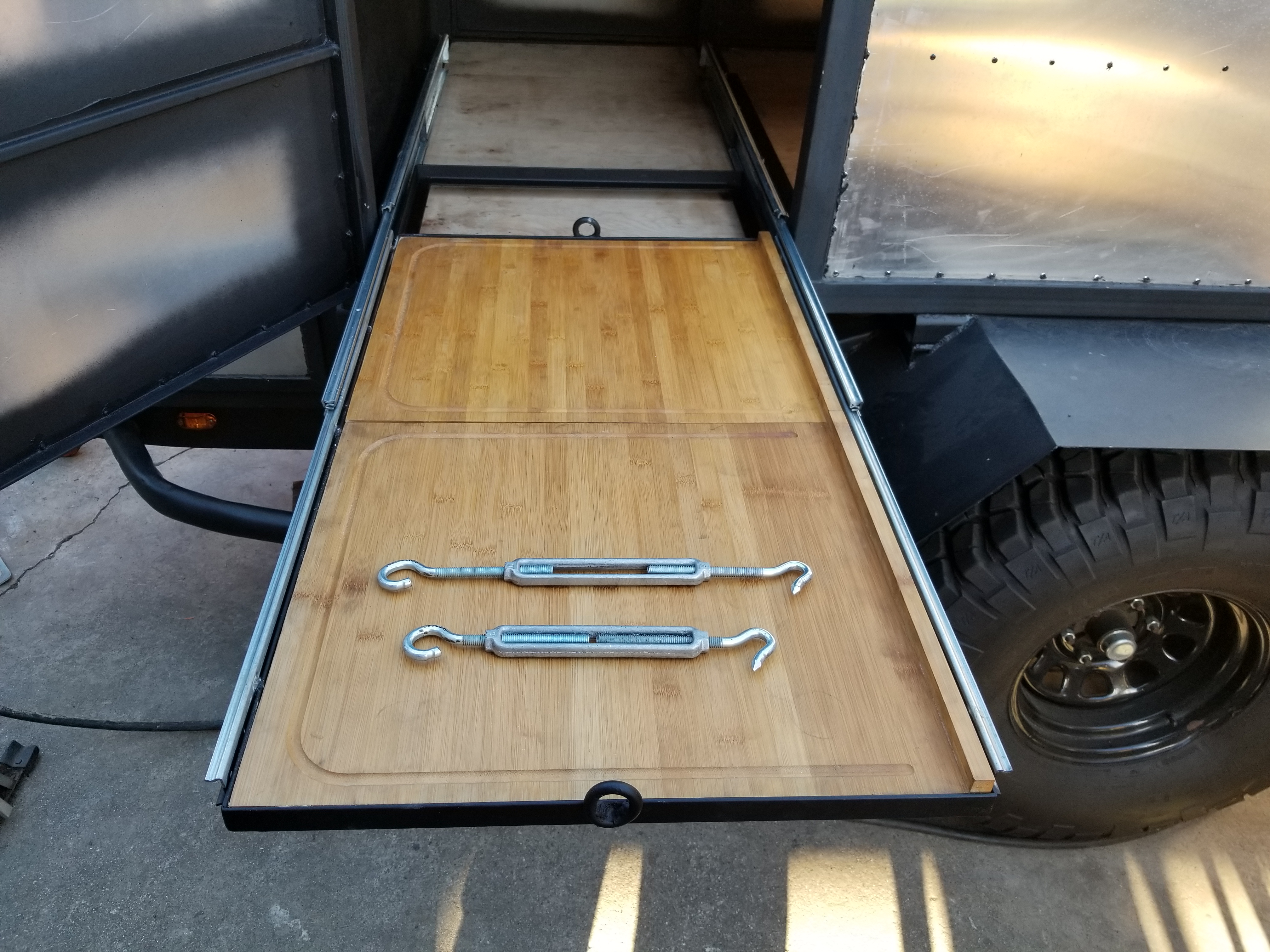

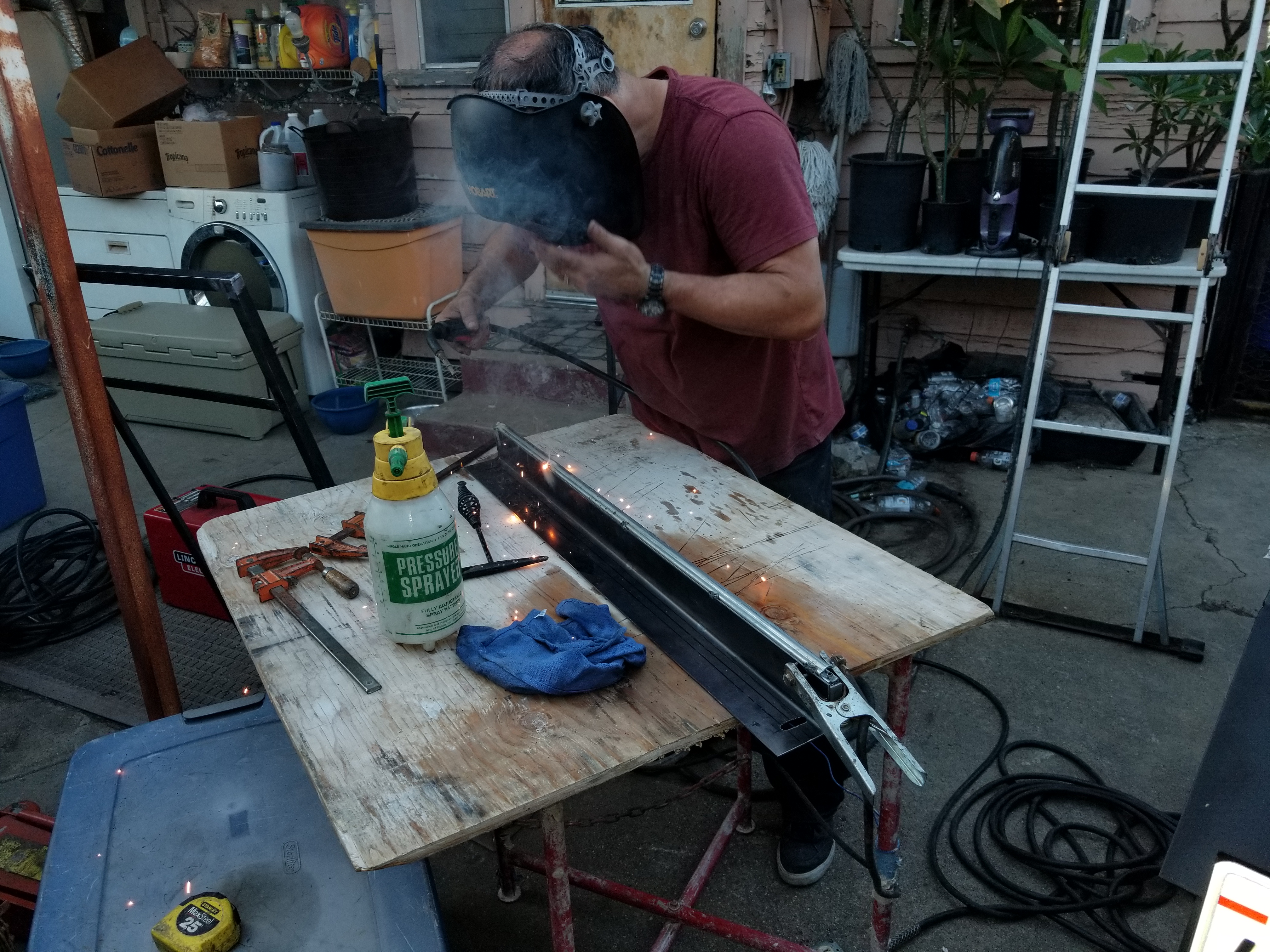

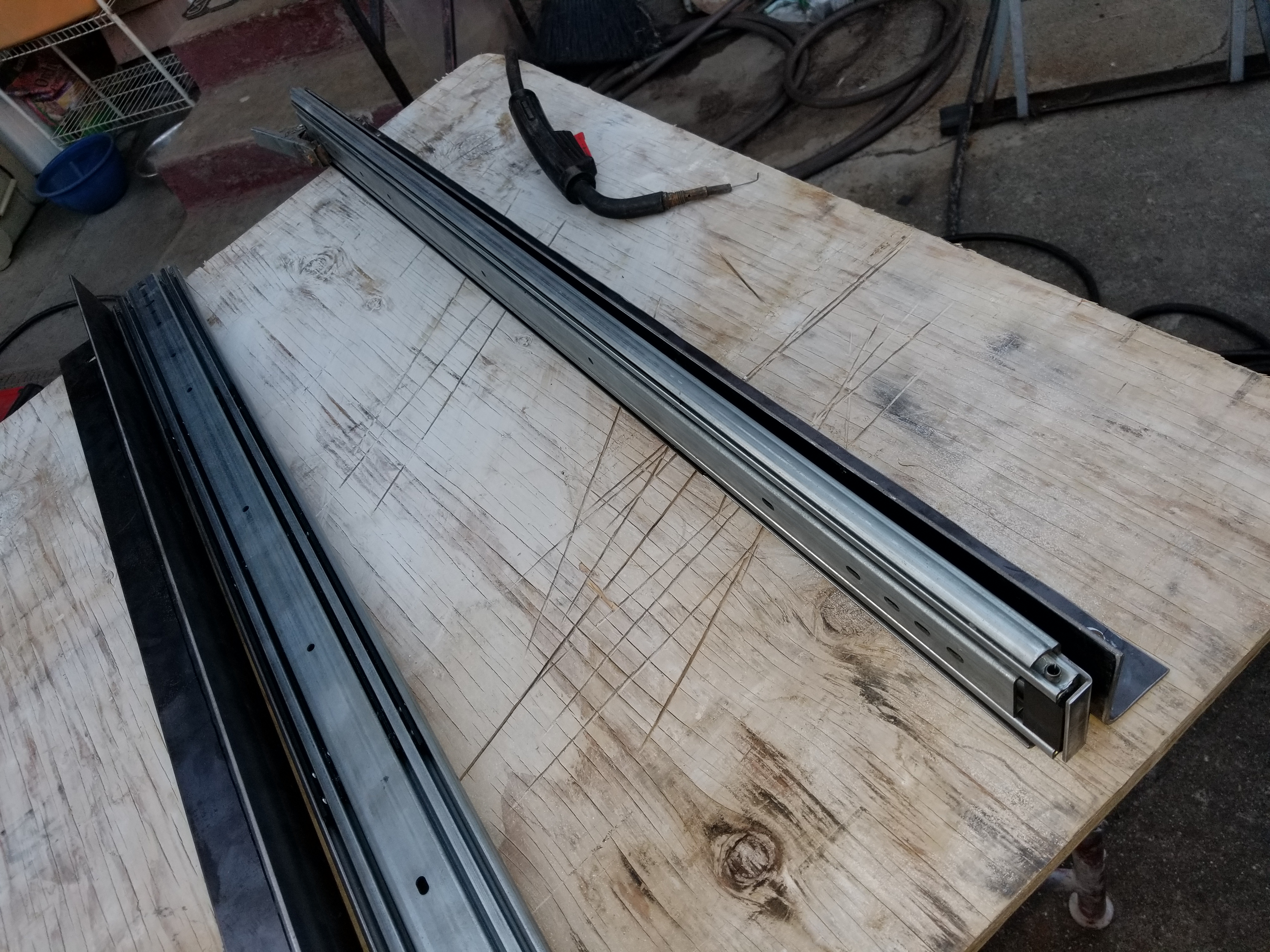

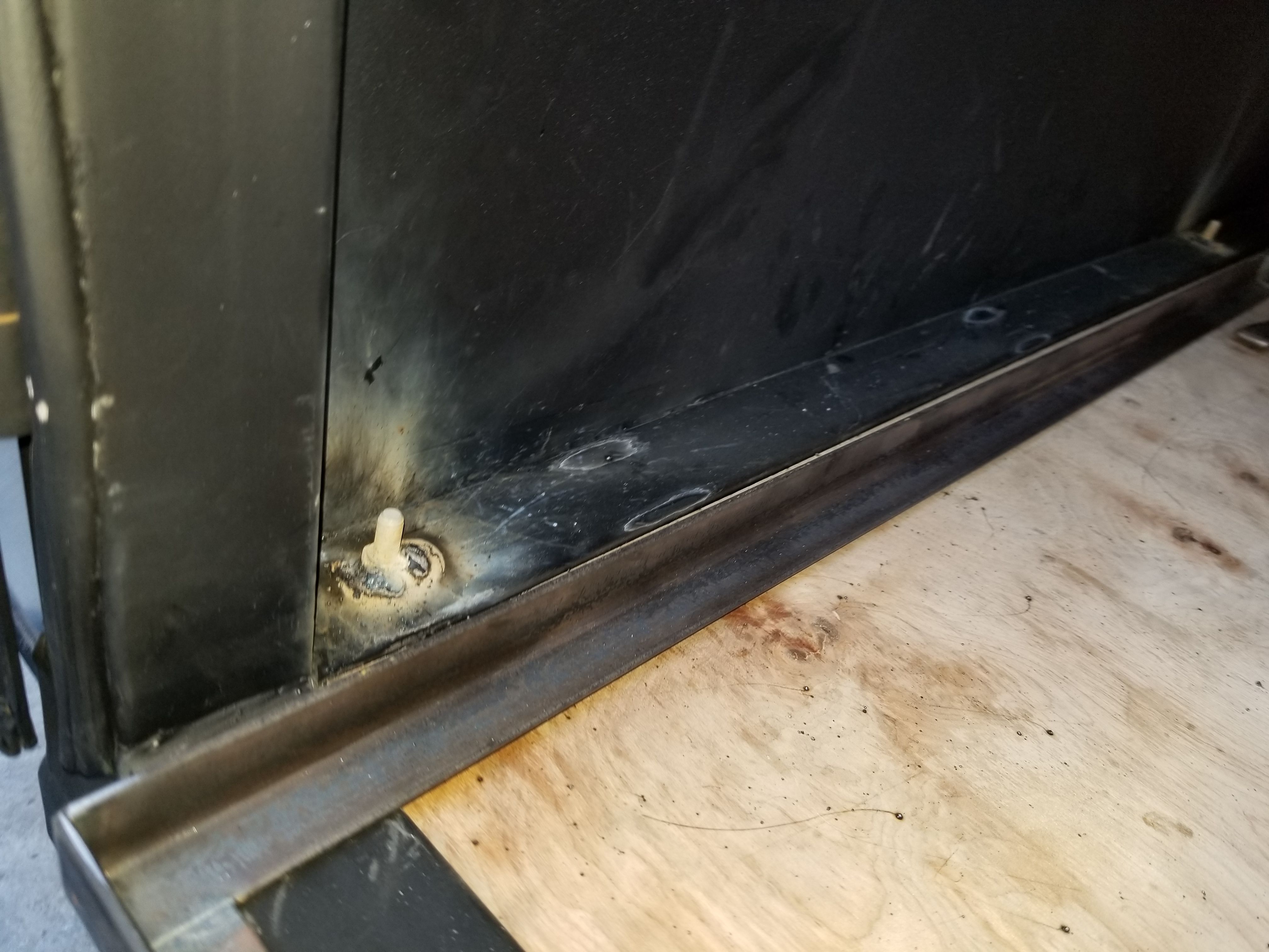

My dad and i finally got around to finishing up the cooler slide out this week. We wanted to make the slide out built to be adjustable to i drilled 2 holes and connected them with a jigsaw creating these oval holes that could then have a bolt through it and be adjusted back and forth then tightened when it was centered at the door.

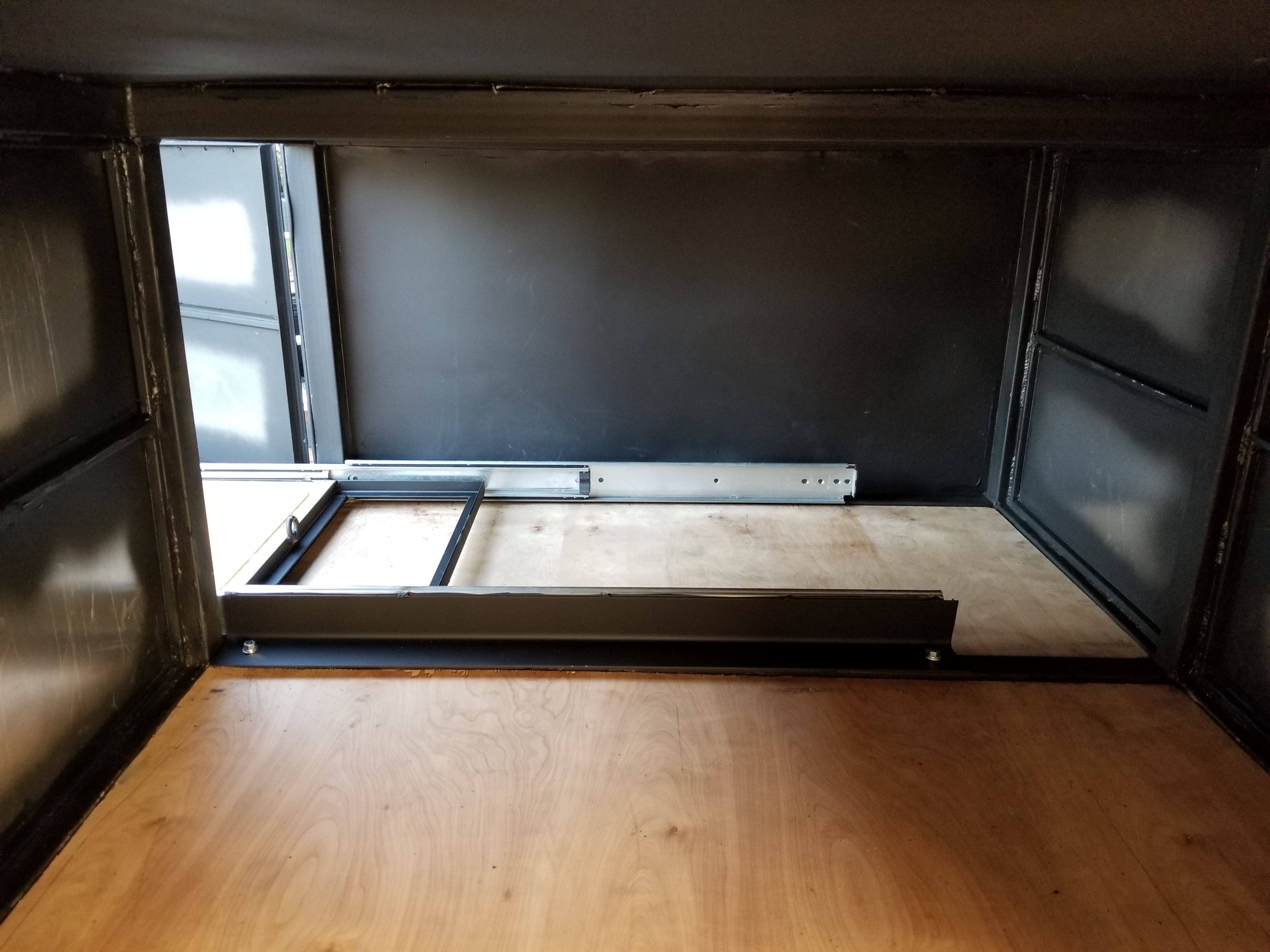

Here is the inside of the trailer. We welded the bolts onto the metal floor rails so we can use a nut on the top side of the slide out bracket to hold it in place. We achieved this by centering the tray that the ice chest would sit on first.
Here you can see how his design would make the rails adjustable.

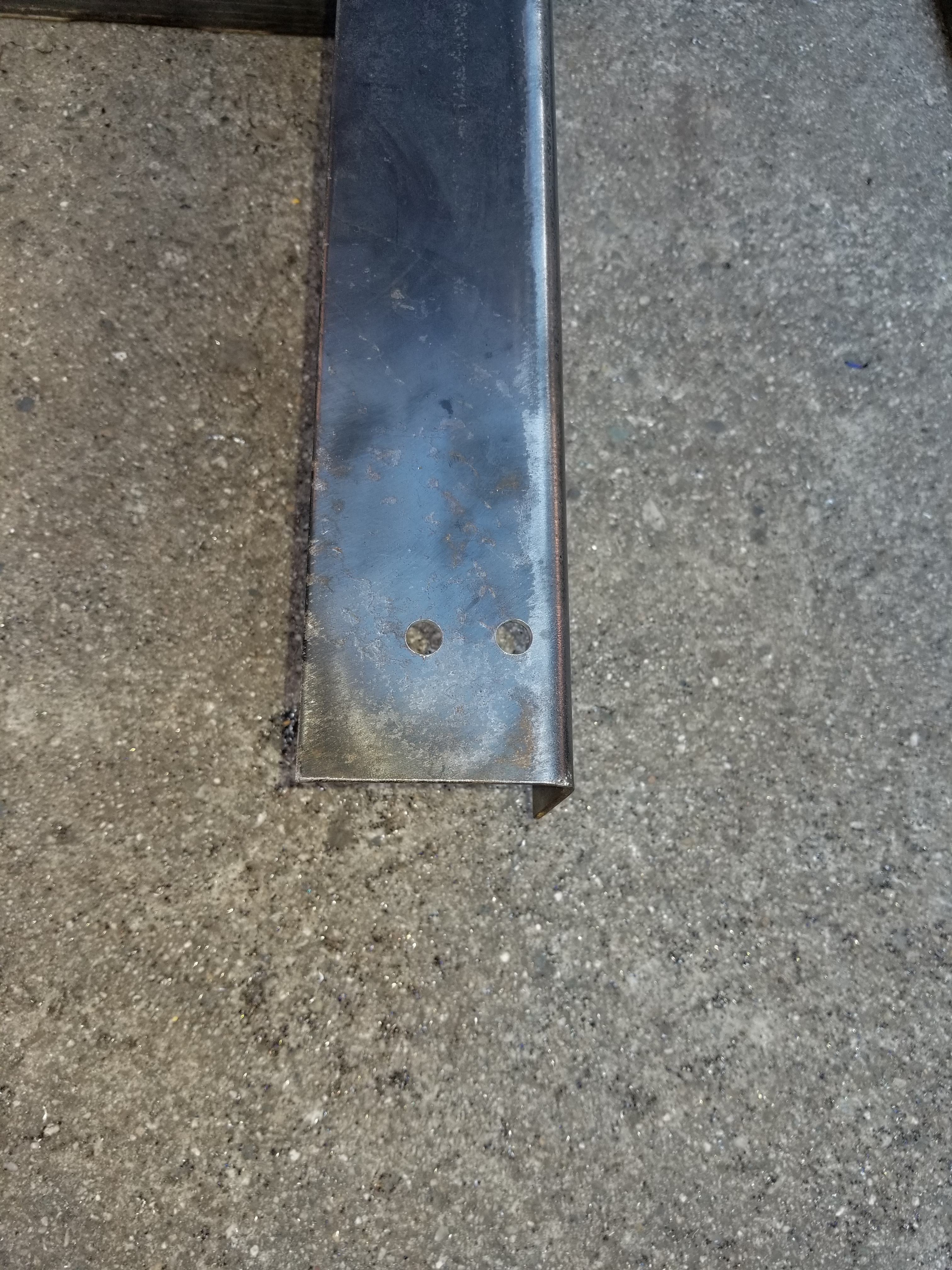

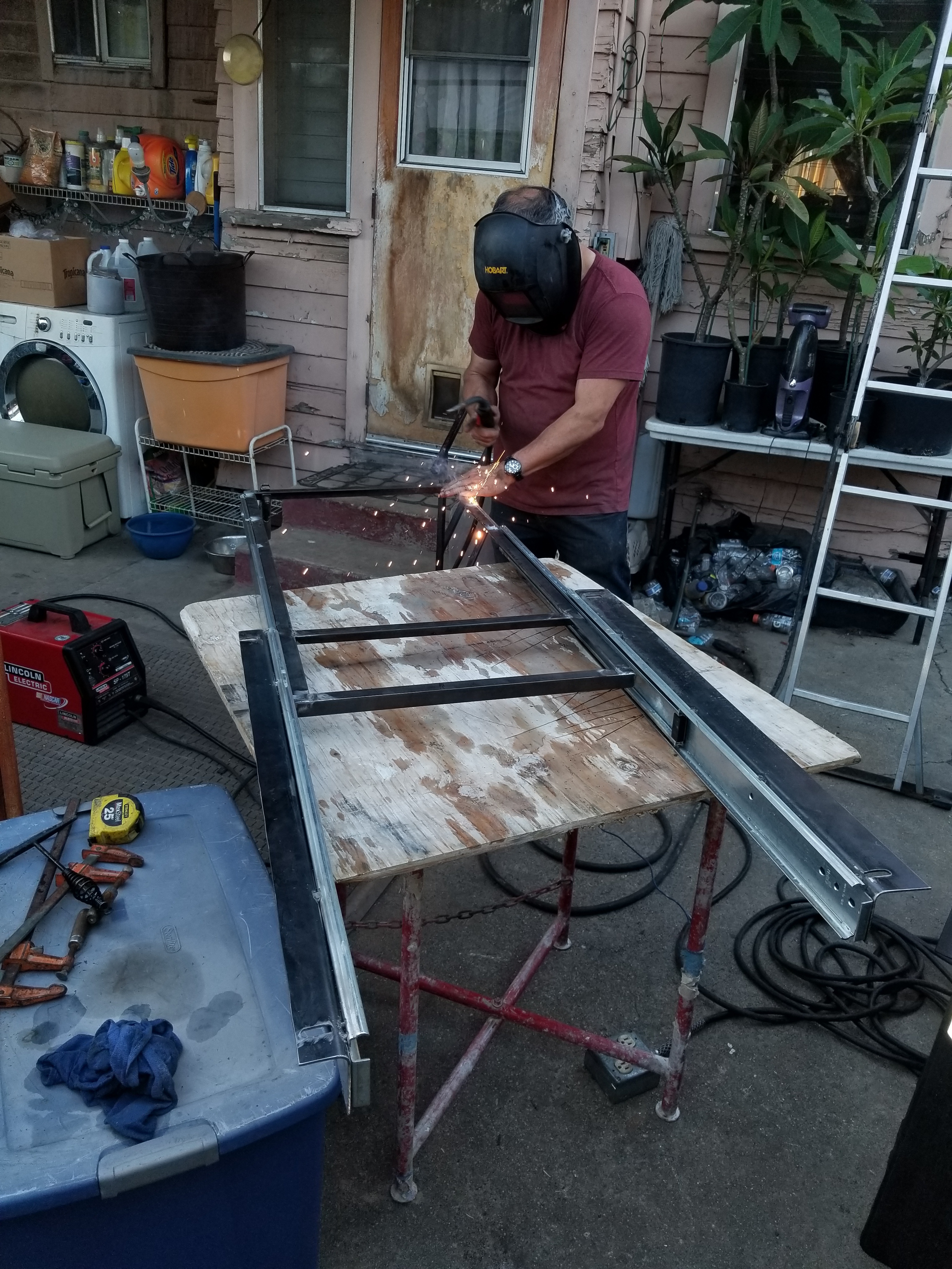

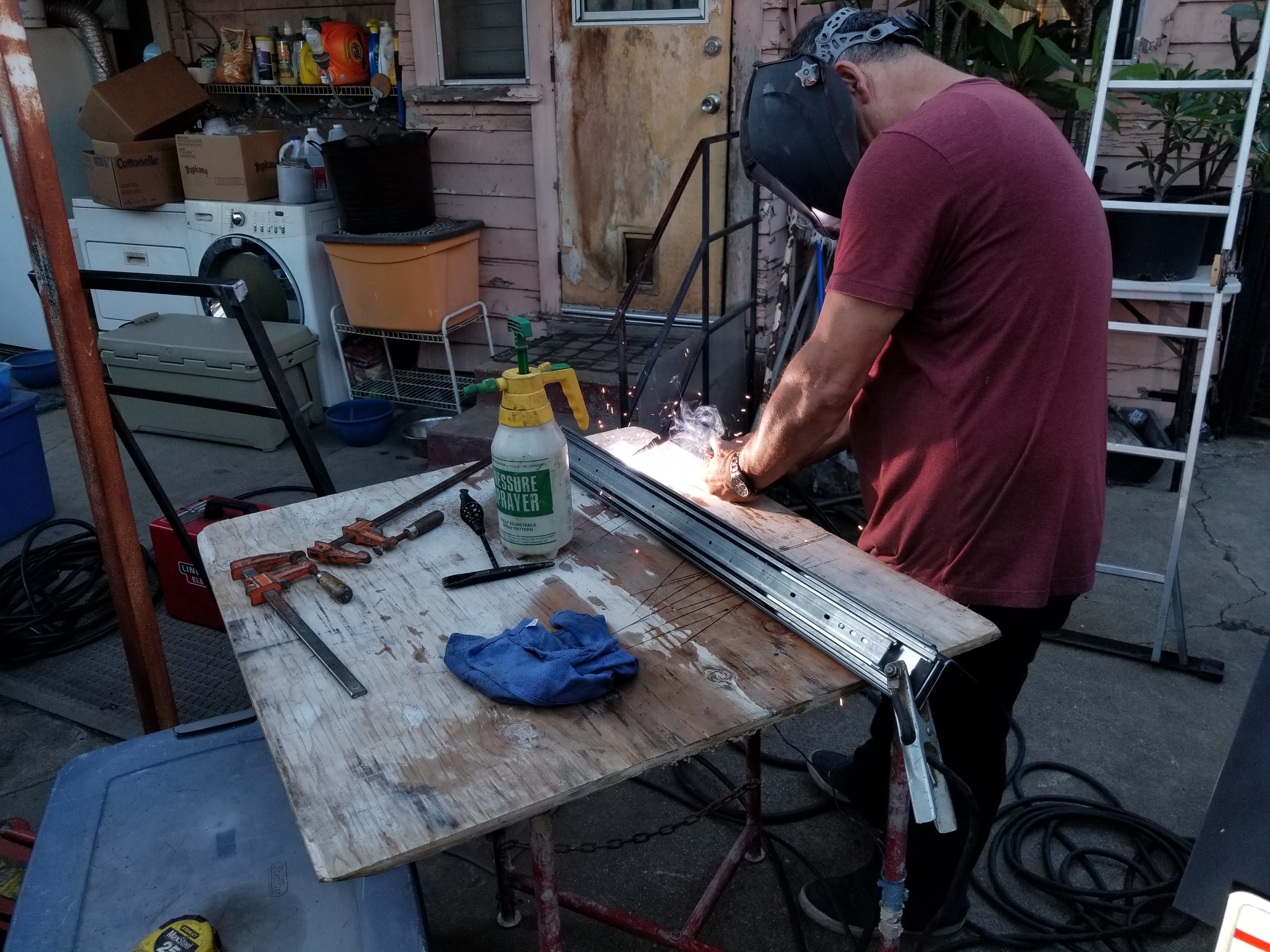

After we were happy with the fit my dad went on to welding the slides making sure not to weld on the areas where the plastic stoppers are on the back side to avoid damaging the slide out. We had a pressurized water spray bottle on stand by in case the rails got too hot which we did have to use a couple of times.
Centering up
Inspecting where the plastic stoppers are
Tack tack tack
and ready for welds

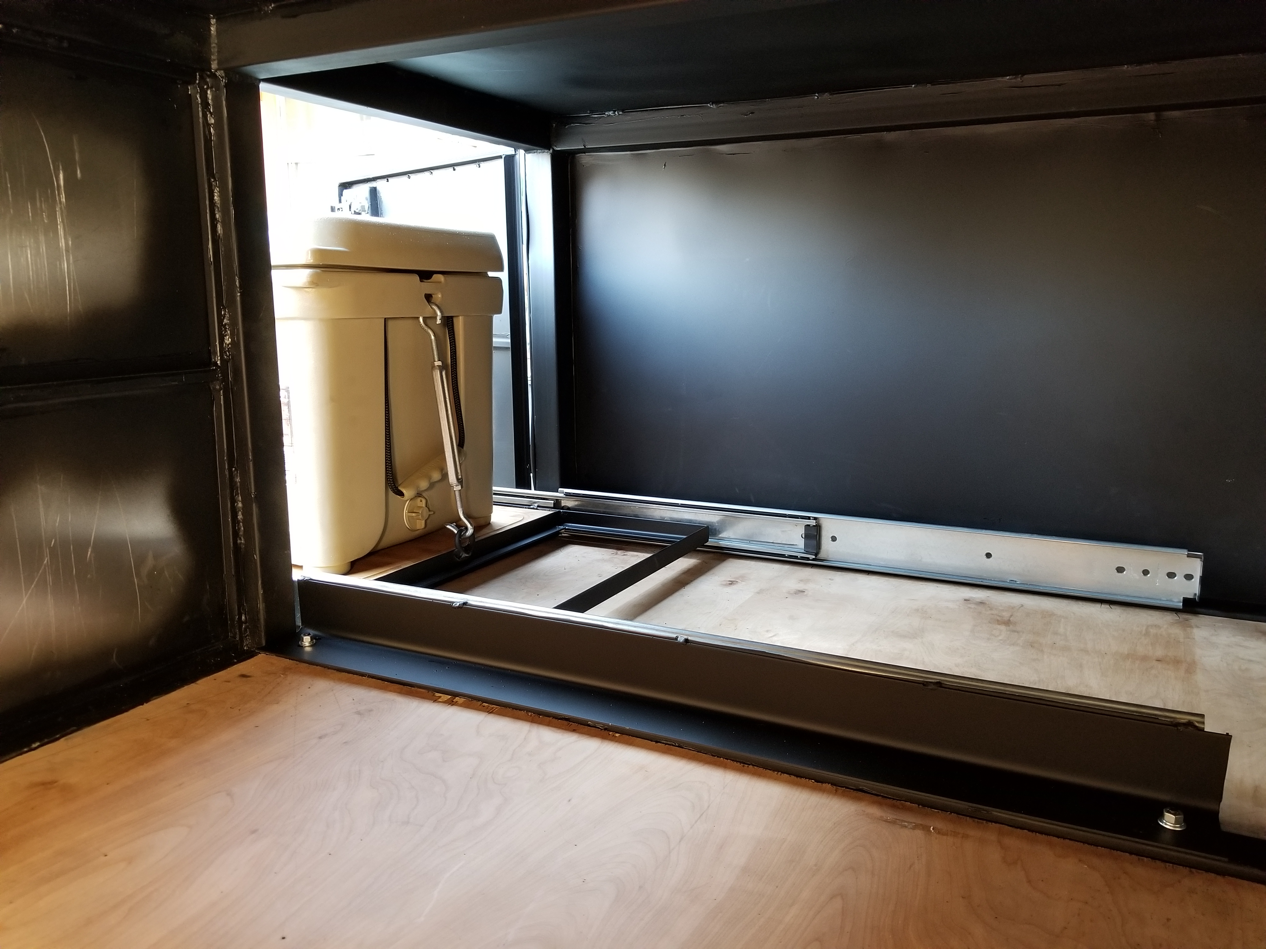

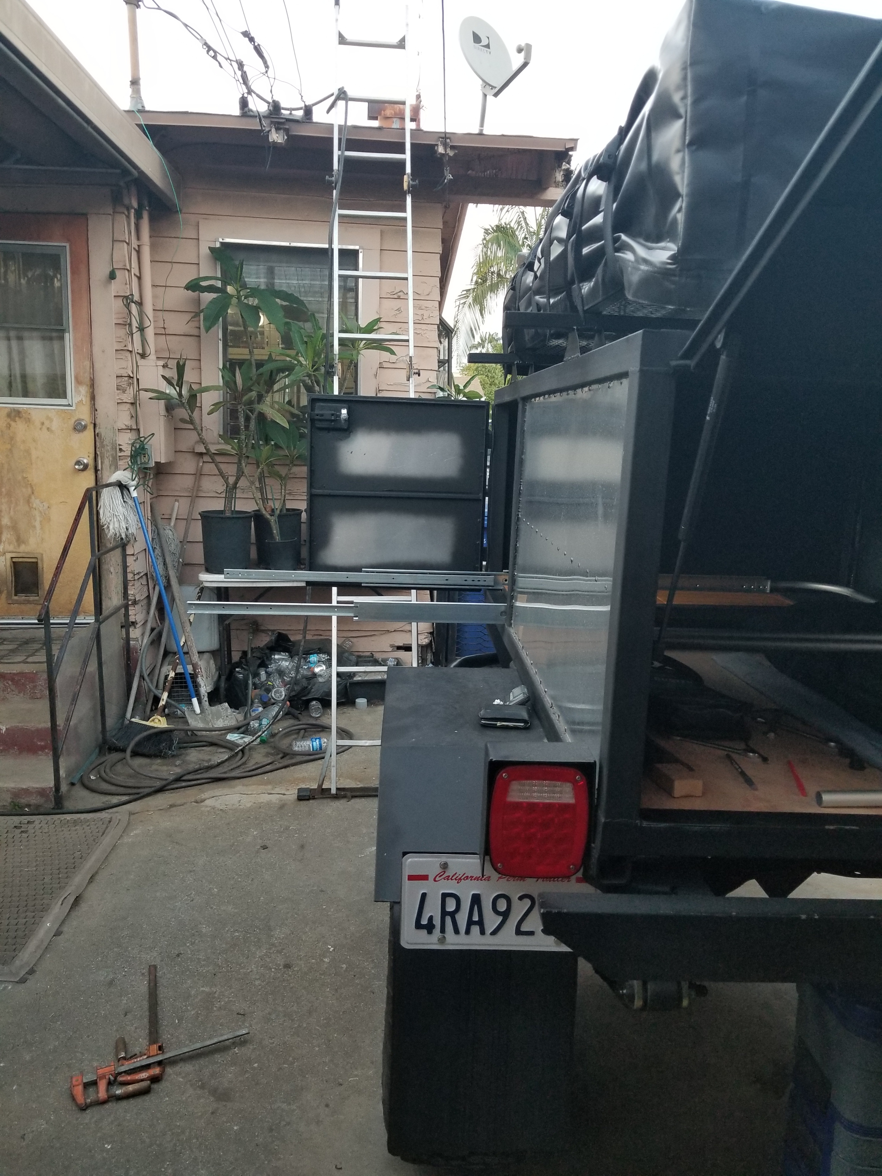

over a couple of days i primed it and then painted it. 3 days later i was ready to install. As you can see it is a pretty tight fit between the door frame. Approximately 3/16" to 1/4" spacing left on each side when you include the thickness of the slide outs. Just enough space to adjust back and forth.
The slides only go up to that point but the remaining portion behind those brackets is going to be for a spice-rack/pantry so the end of that slide out exposes the little cabinet that will eventually be made. You can see the tray for it here on the left.
I bought these steel Hook/eye tie downs for the cooler to keep it in place while on the read, hwy, trail.
Centering up
Tack tack tack
and ready for welds
