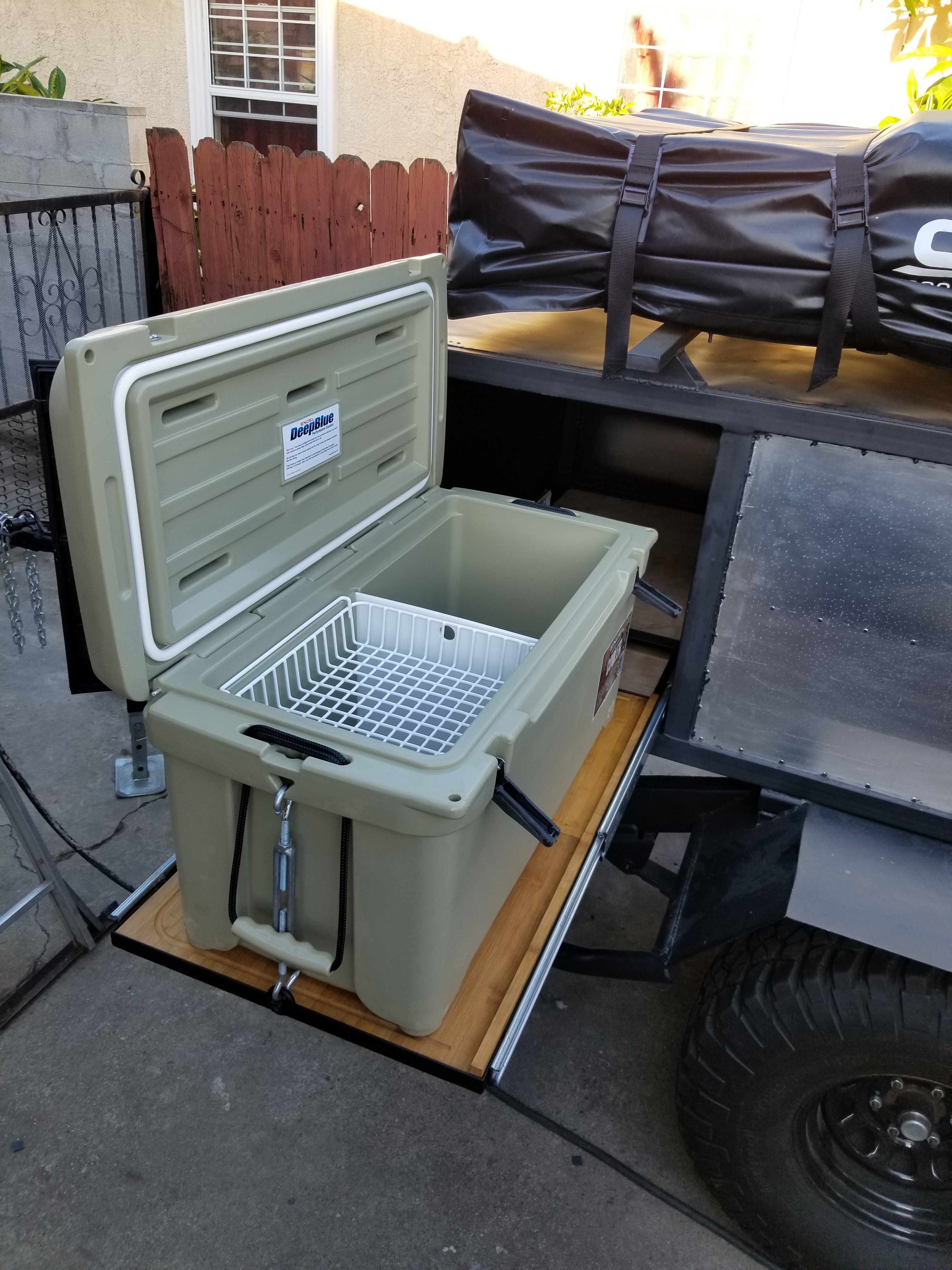

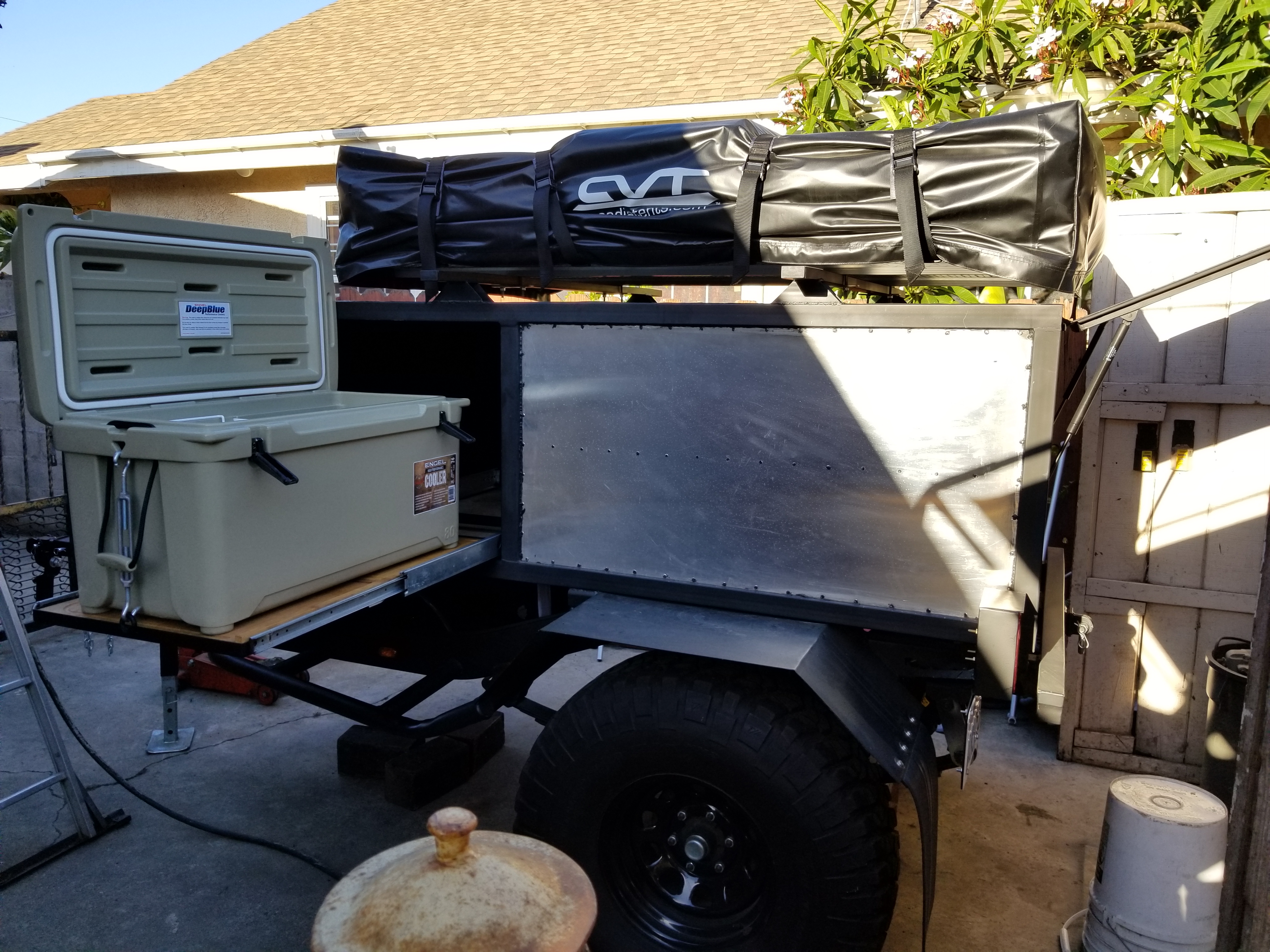

Cooler slide out is done! All set for camping. Now all that is left on my to do list is to fabricate a propane tank holder/mount, install the Propex heatsource forced air heater to warm my cvt roof top tent. Install my @all4offroad rock lights, mount the solar panel and begin with electrical fuse block/wire harness and deep cycle battery bank.

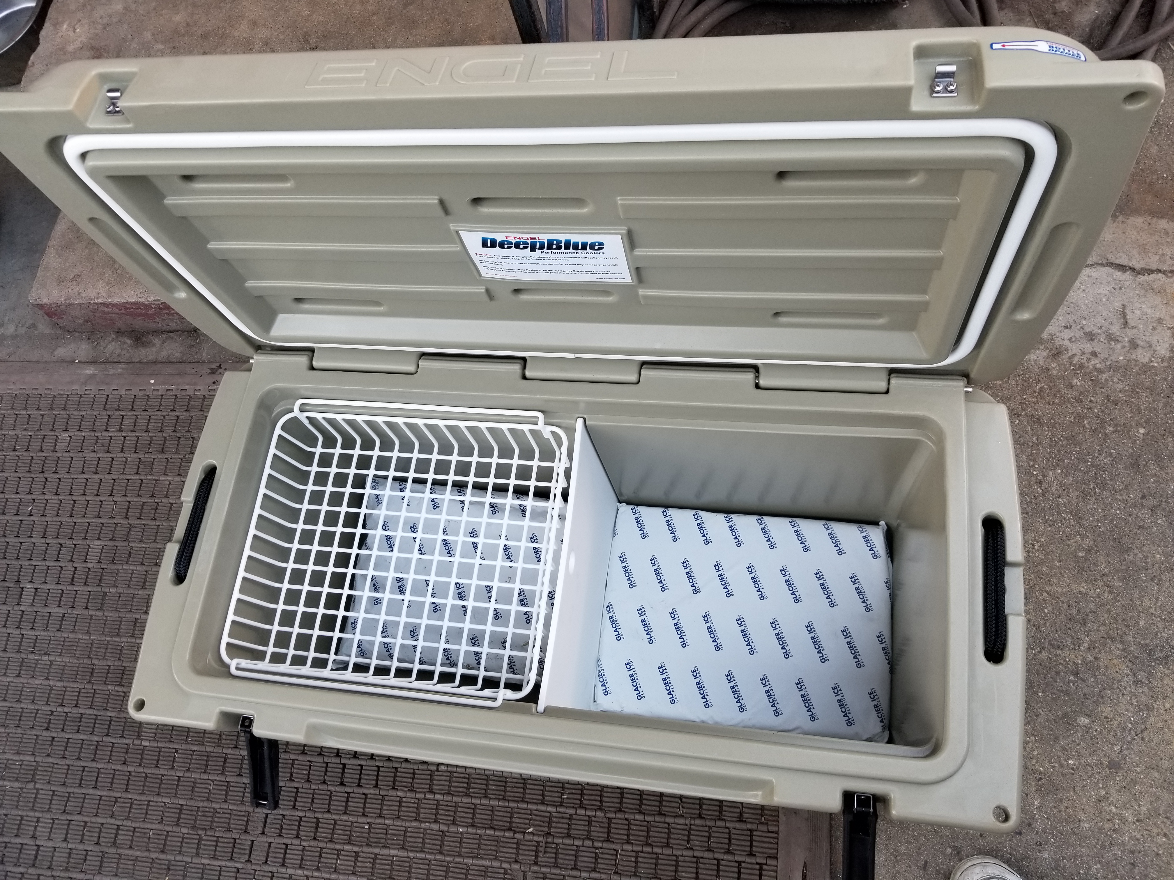

Not sure if any of you guys use BlueApron to order meals online that include everything you need to cook a delicious meal but these 14"×11×1.5" ice blocks that they ship your food with fit perfectly at the base of my 80qt Engel DeepBlue cooler.
I may be able to get away with just one small bag of ice to keep my food cool all throughout a weekend camping trip whenever that time comes.

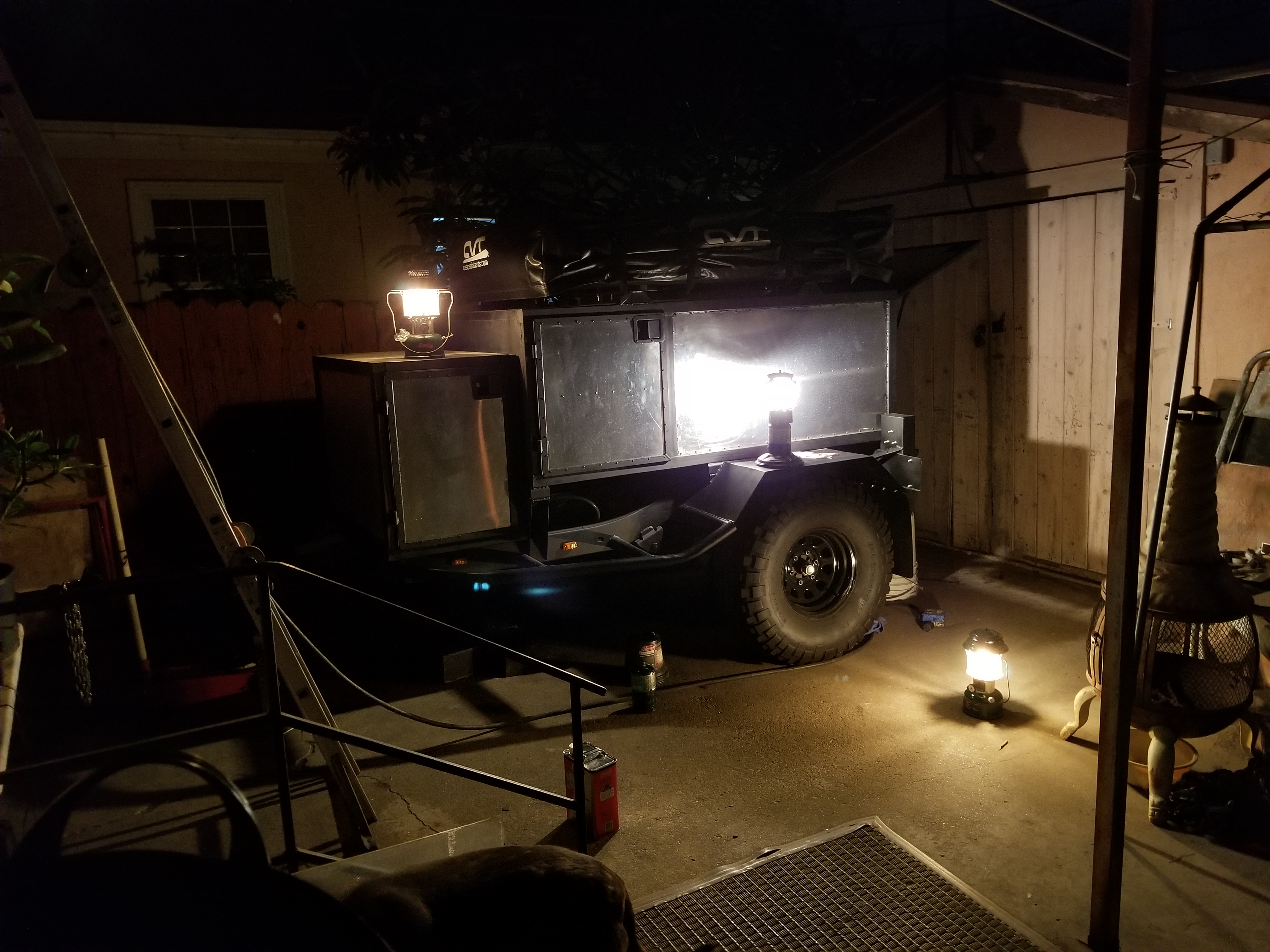

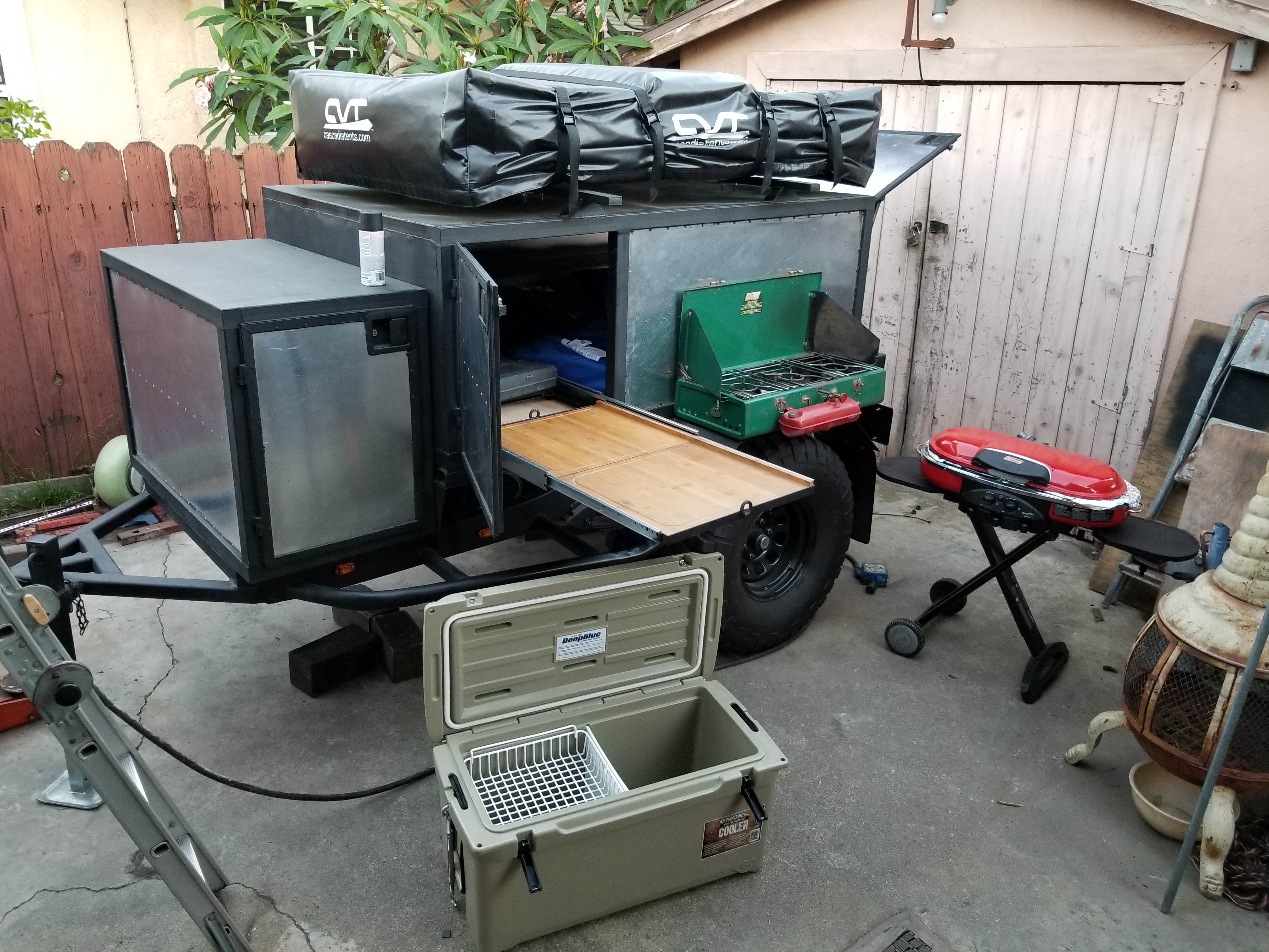

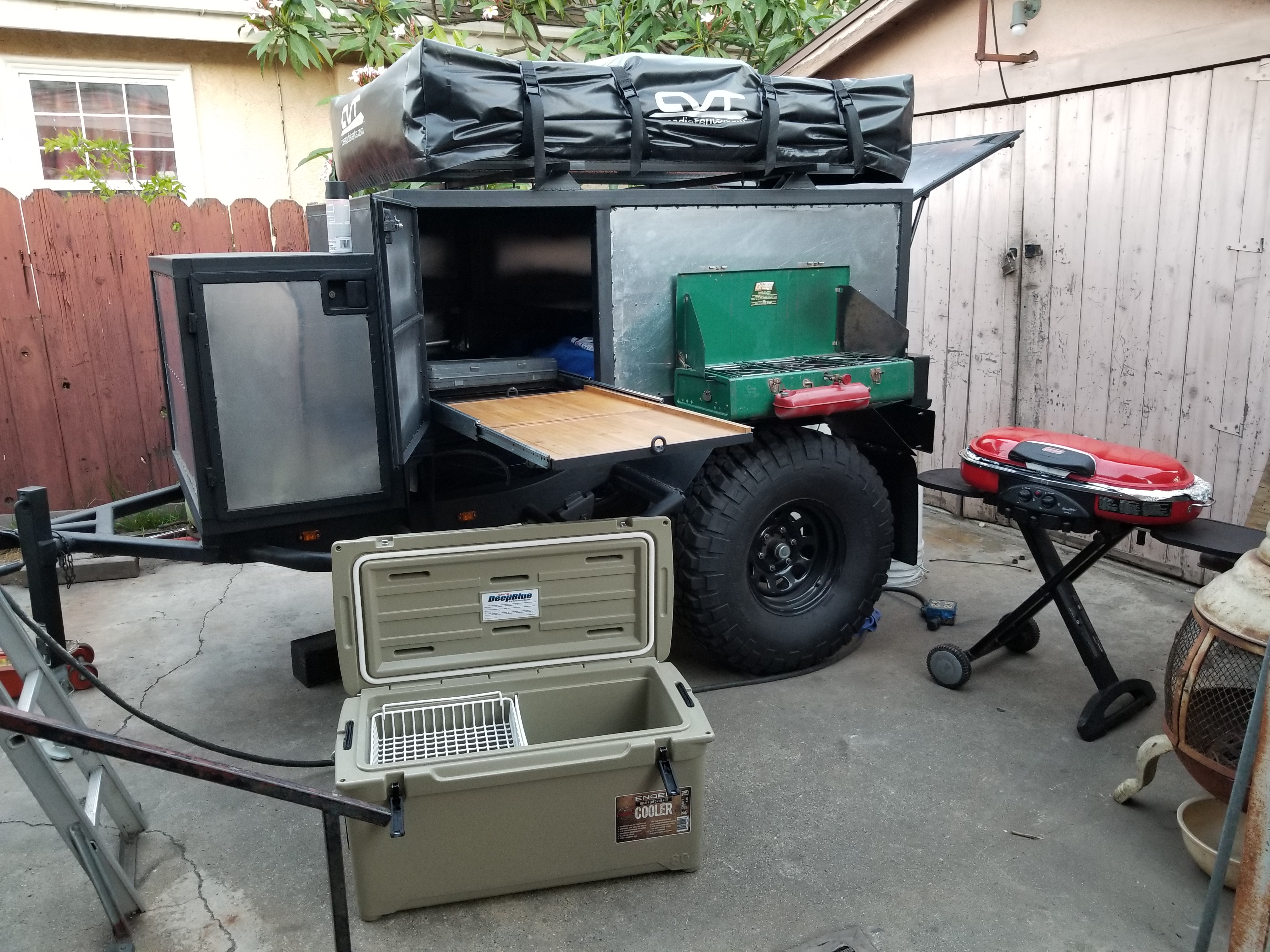

Cooking station ✔ Check.
I have this awesome old-school Coleman 3 BURNER stove that runs off of coleman lantern fuel. My red Coleman road trip grill with cast iron grill top which runs off of small propane bottles and burns as hot as 20,000btu; I'll eventually have a nice hose to connect that grill to my future propane tank.
Great thing about having bare aluminum side walls is that you can use the wall as a reflector to enhance how much these Coleman lanterns will light up the camp ground. I found that the newer propane lanterns are much brighter then the old-school liquid fuel lanterns. But the propane ones won't last as long as the old-school ones. just FYI

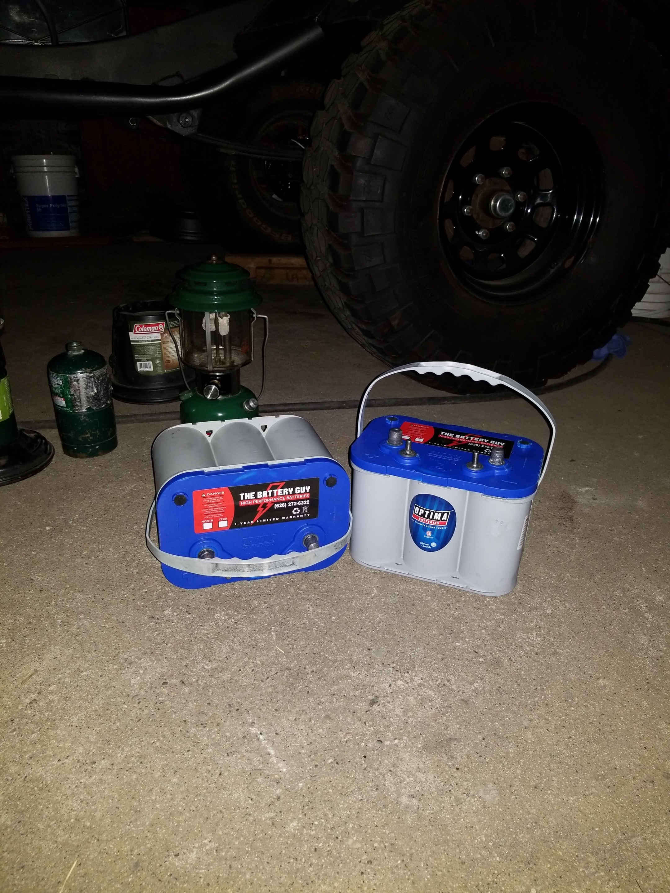

I picked up these 2 babies from a guy who sells blemish Optima batteries out of Long Beach CA. These are optima blue top batteries. He sells both blue and yellow top batteries for 120 each or 220 a pair; with a 1 year warranty on all the batteries he sells. I scored both for 200 since that's all I had on me. Lol. But still a great deal considering it usually costs about $276 plus tax at a local autozone/o'reily auto parts for just 1 of these batteries. I had planned to only buy one. But i really don't want to take a chance at draining the battery past 50%. So 2 should be way more then enough for the applications i plan to run. With my 100watt solar panel and the 12v charging wire going from my 4runner's 7pin tow wire harness I'm sure i will be plenty to keep by batteries charged.

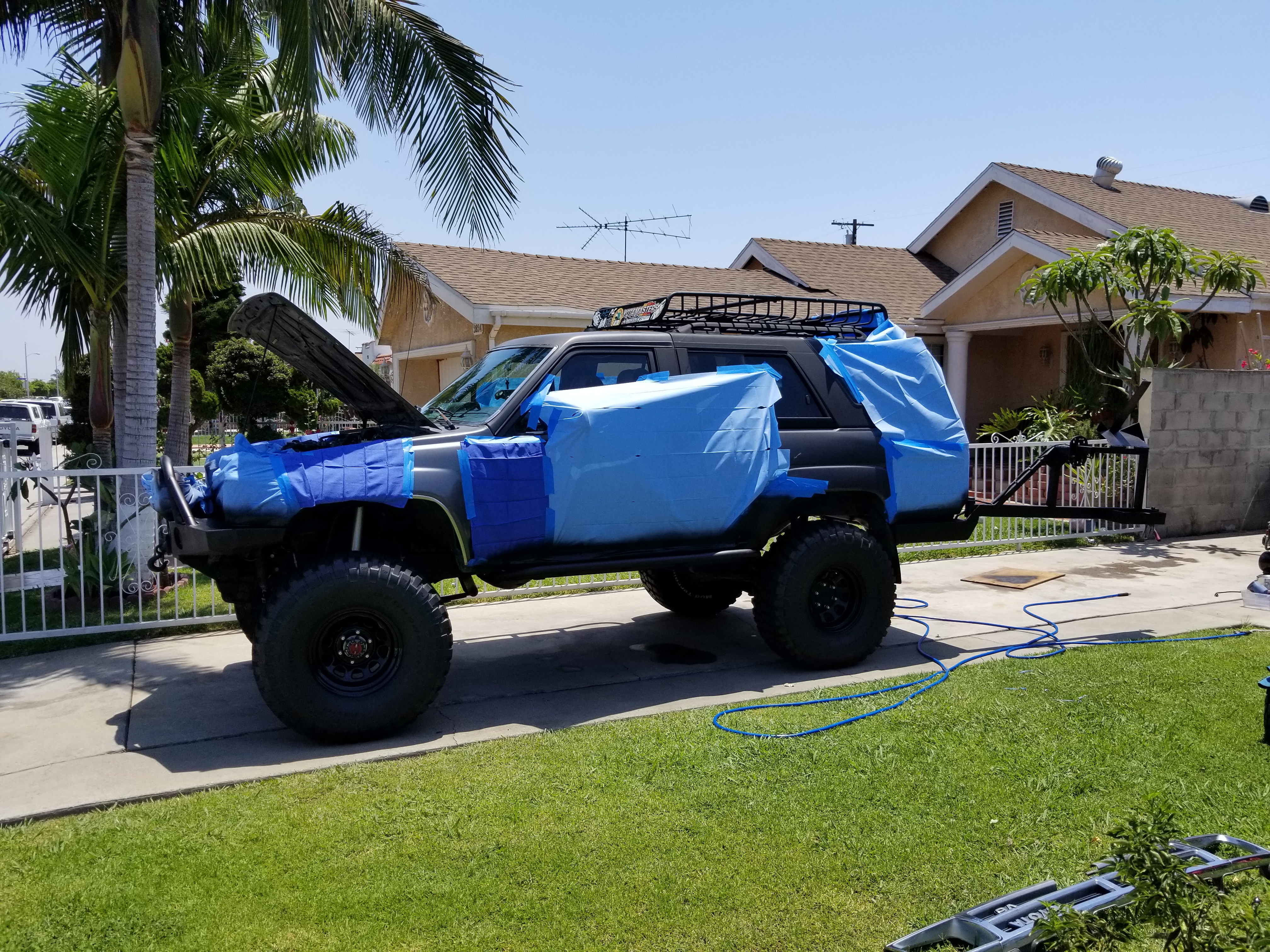

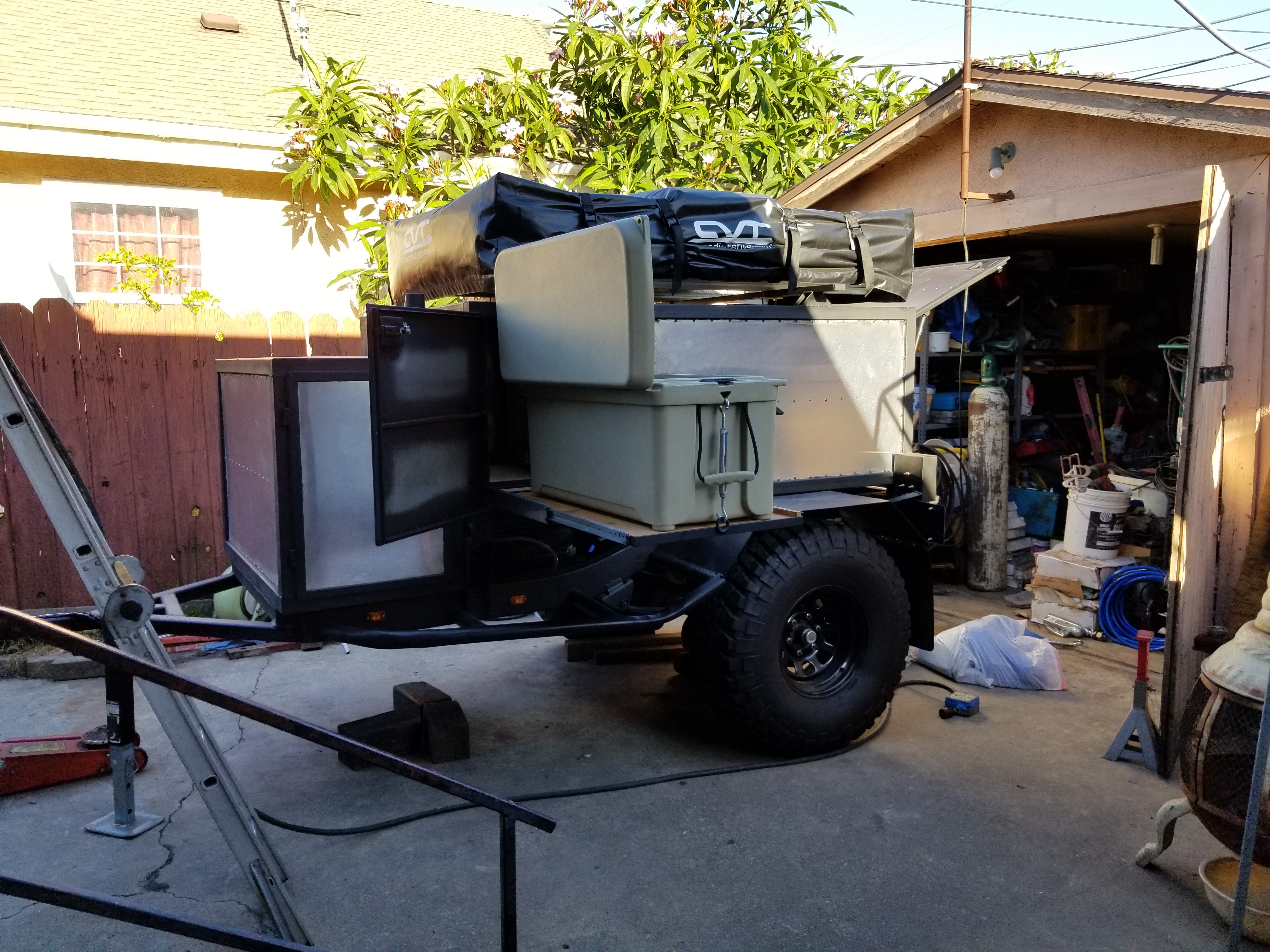

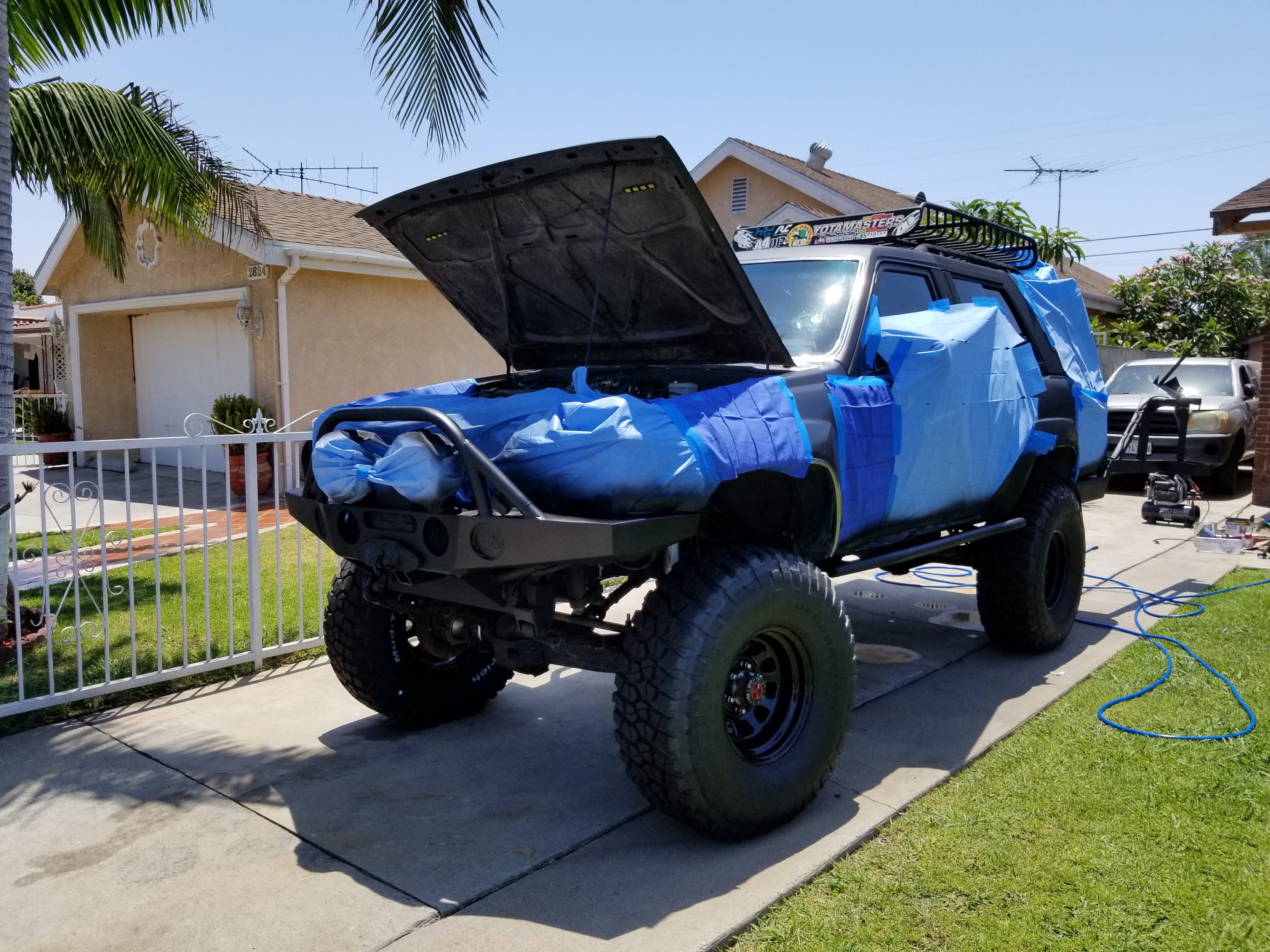

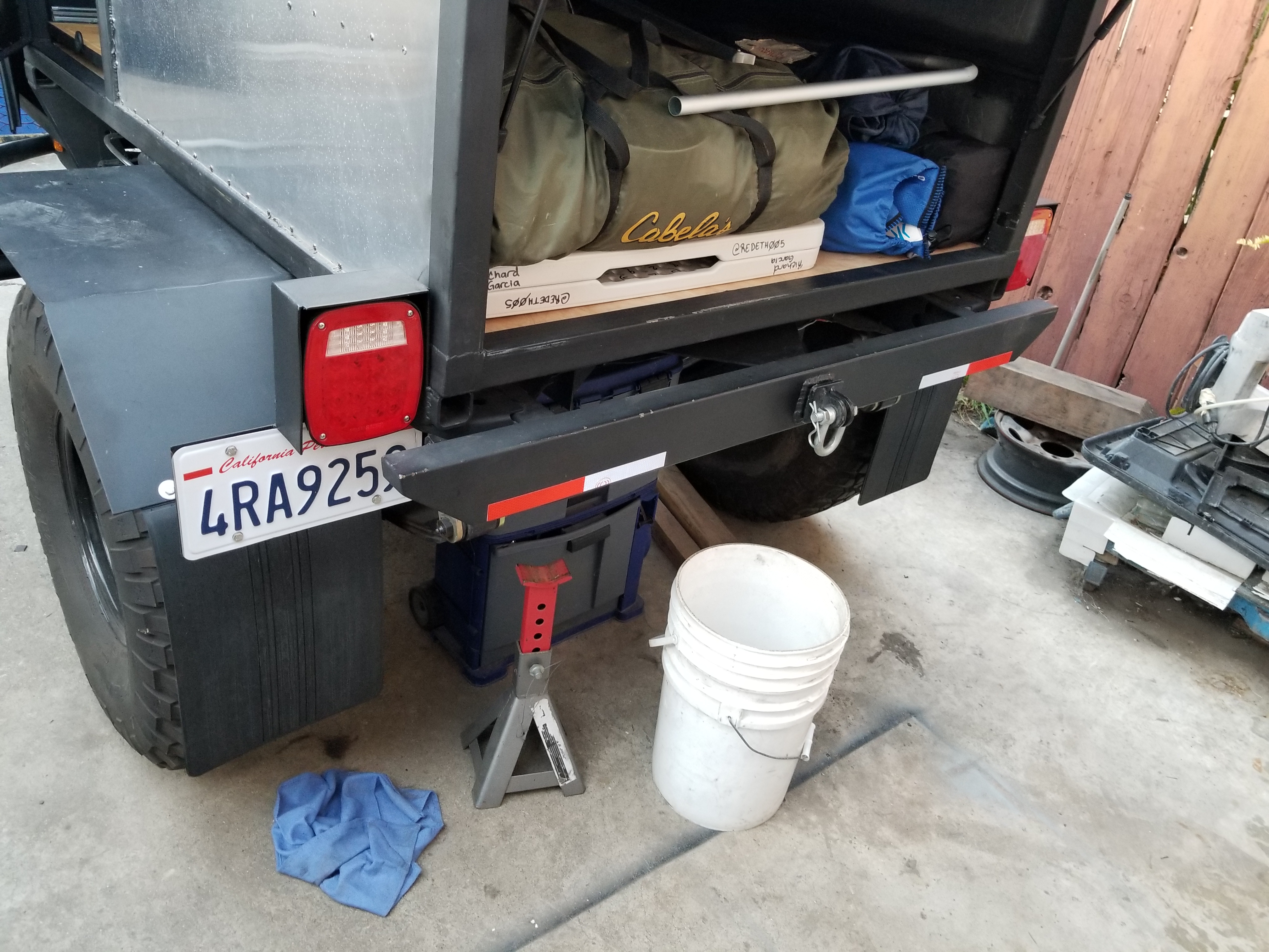

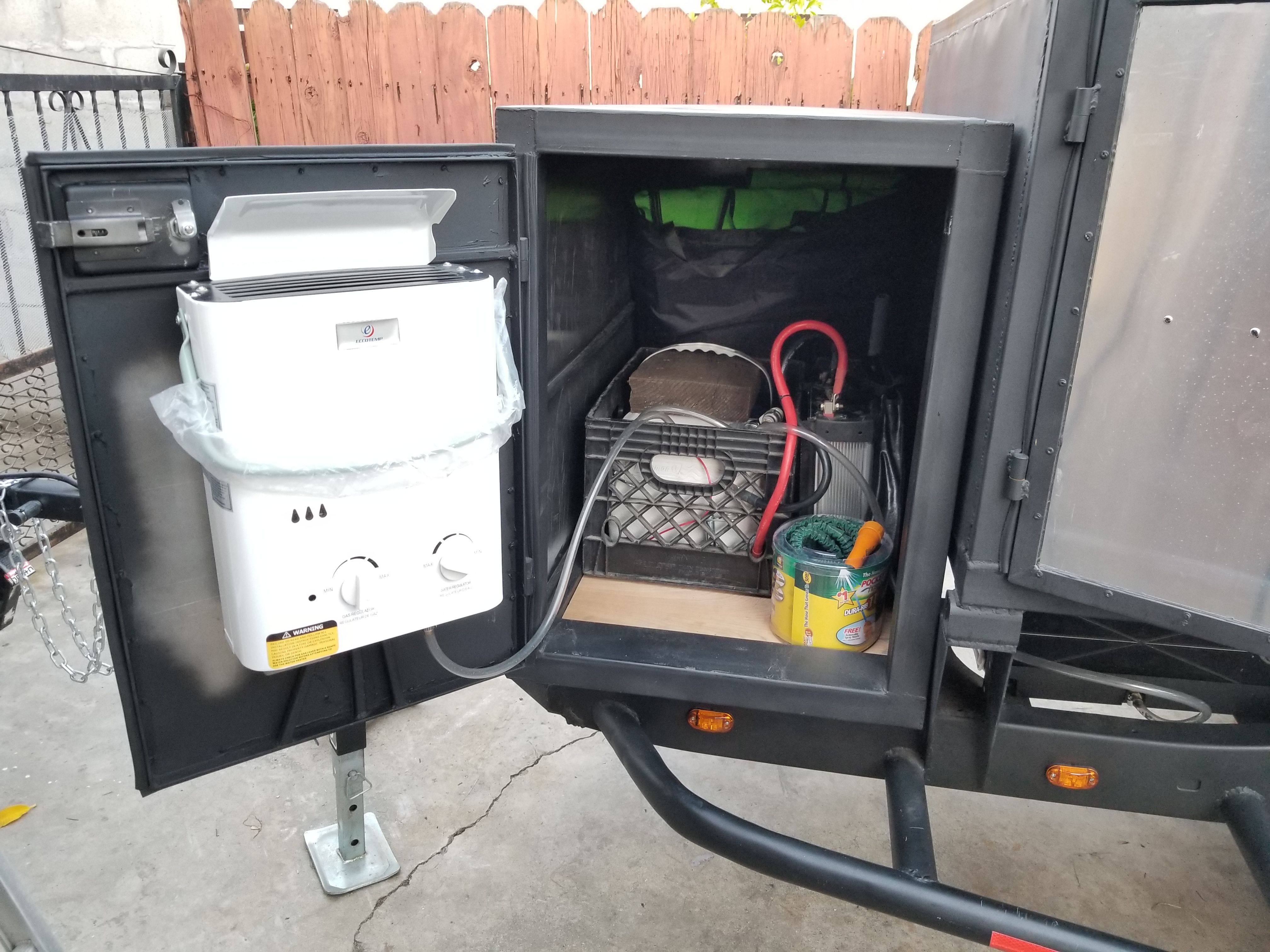

With a such a nice clean trailer that has a new clean coat of paint it was only fair that i gave my 4Runner some love. The bumpers and rock sliders were beginning to look grey from being so faded. Using some impervious surgical drapes as an overspray shield this thing came out looking sexy!

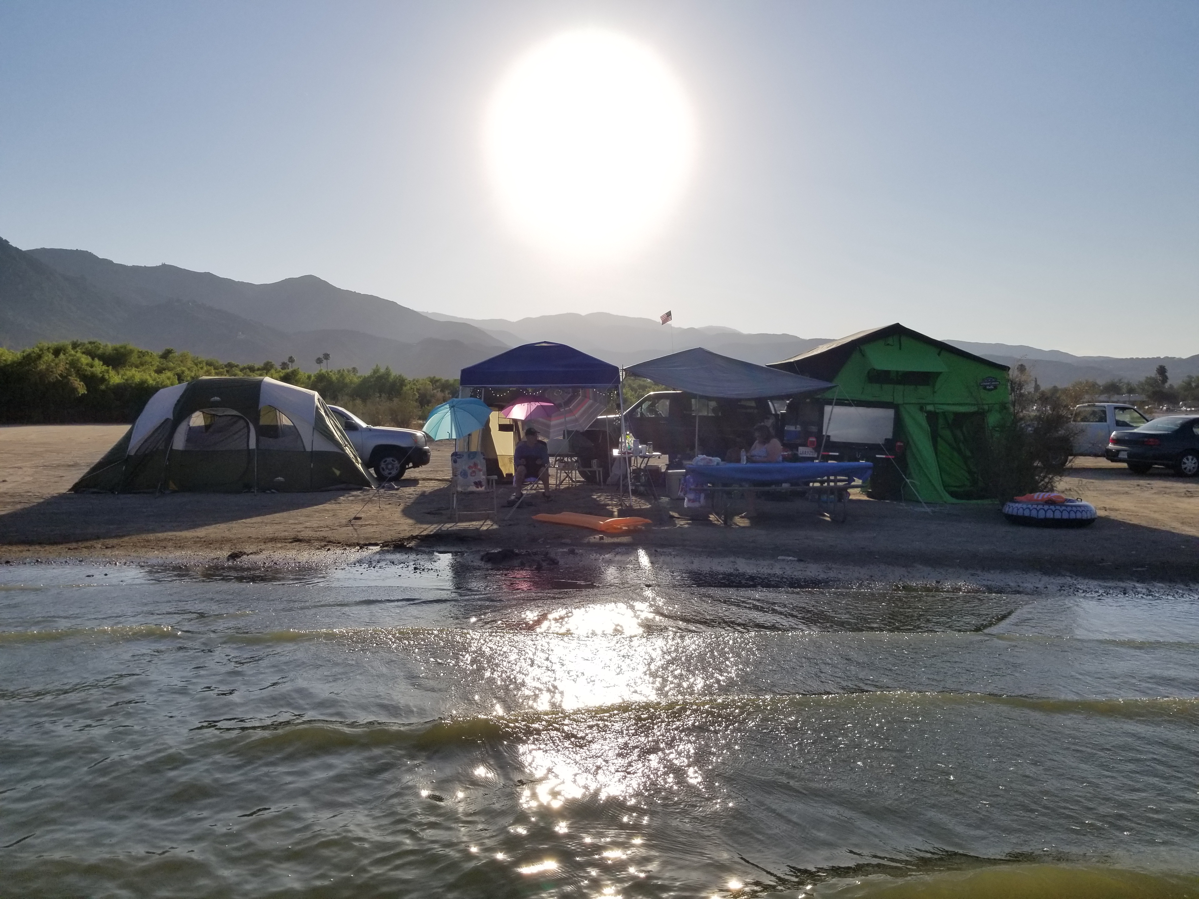

My family and i all agreed to have a 3 day camping this past weekend. My girl and i would be going early friday morning with our 3 year old. And my Parents wih my 21 year old brother would be joining us later hat night around 8pm.
so here are pix of the trip...

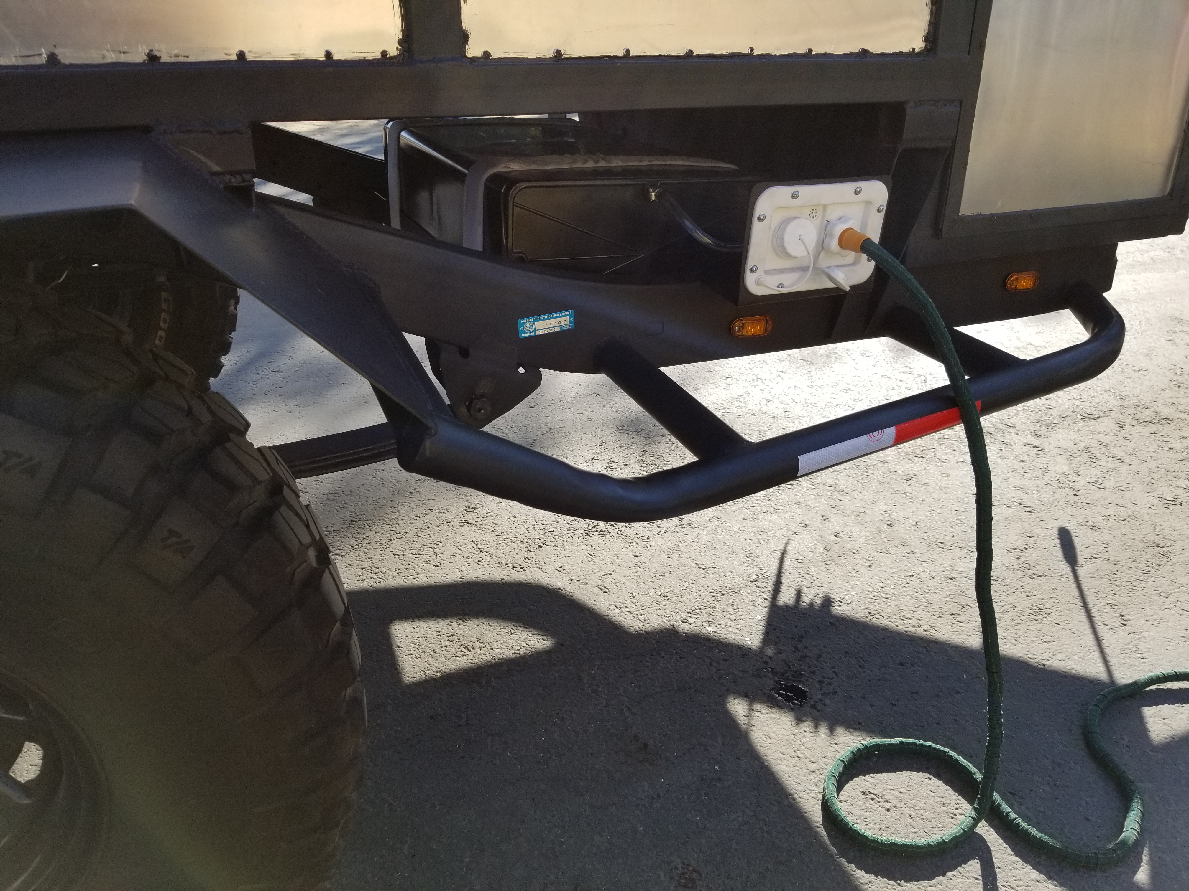

Close up of the water fill area on the passenger side of the trailer.
That is a 15 gallon Valtera water tank under there. I am actually thinking about adding another water tank. IT should be more then enough to shower my family of 3 and soon to be 4 but since i had my parents and brother join us this past weekend so 15 gallons was NOWHERE near enough. If i buy anoher 15 or 20 gallon tank i can run it on the rear side of the trailer and mount it higher then this tank here and just run one hose to the bottom tank so it will fill by gravity pulling the water to the lower tank. This is most likely what i plan to do ..

We were the only ones on the lake most of friday then people trickled in as the weekend approached. Luckily i had already reserved a pretty large space

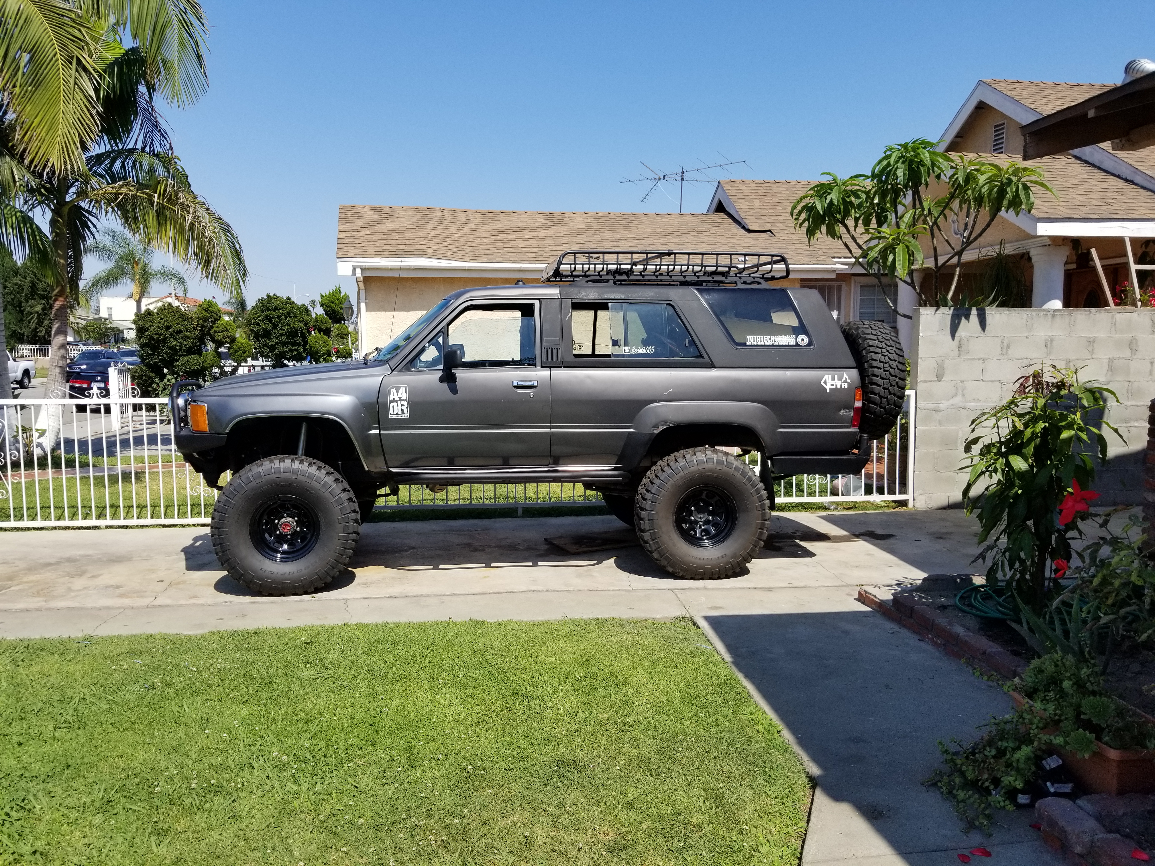

Gotta love a 1st gen 4Runner!

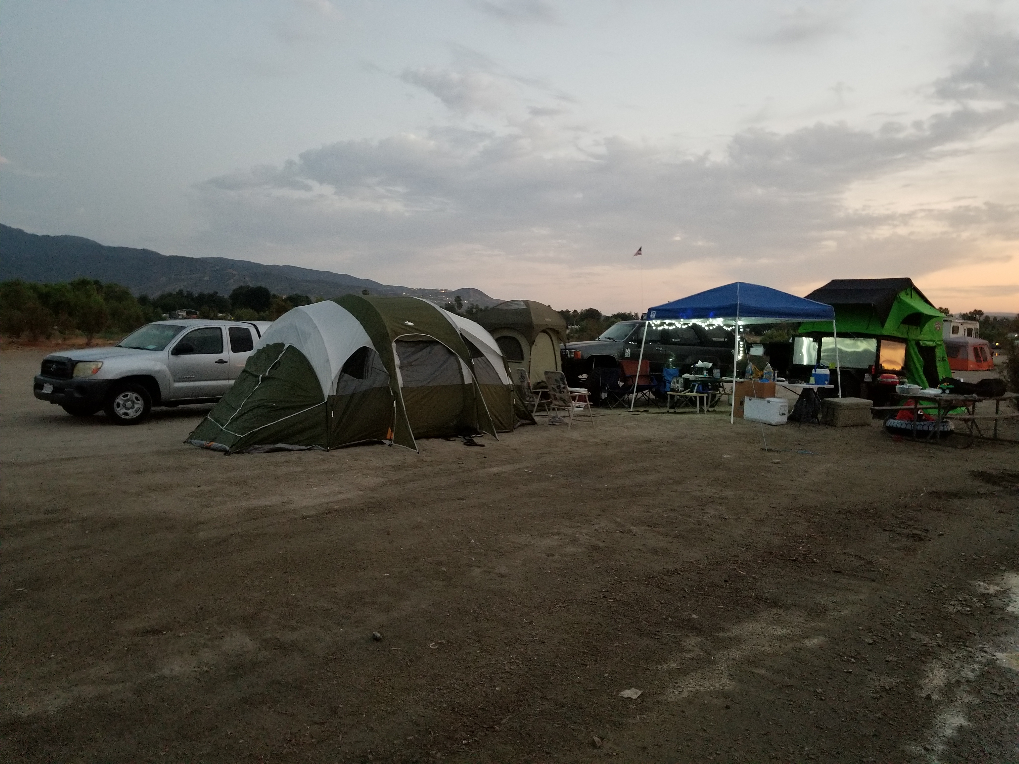

Sun is starting to go down and almost time to begin setting up the night time set up before mosquitoes come out to suck the blood out of everyone.

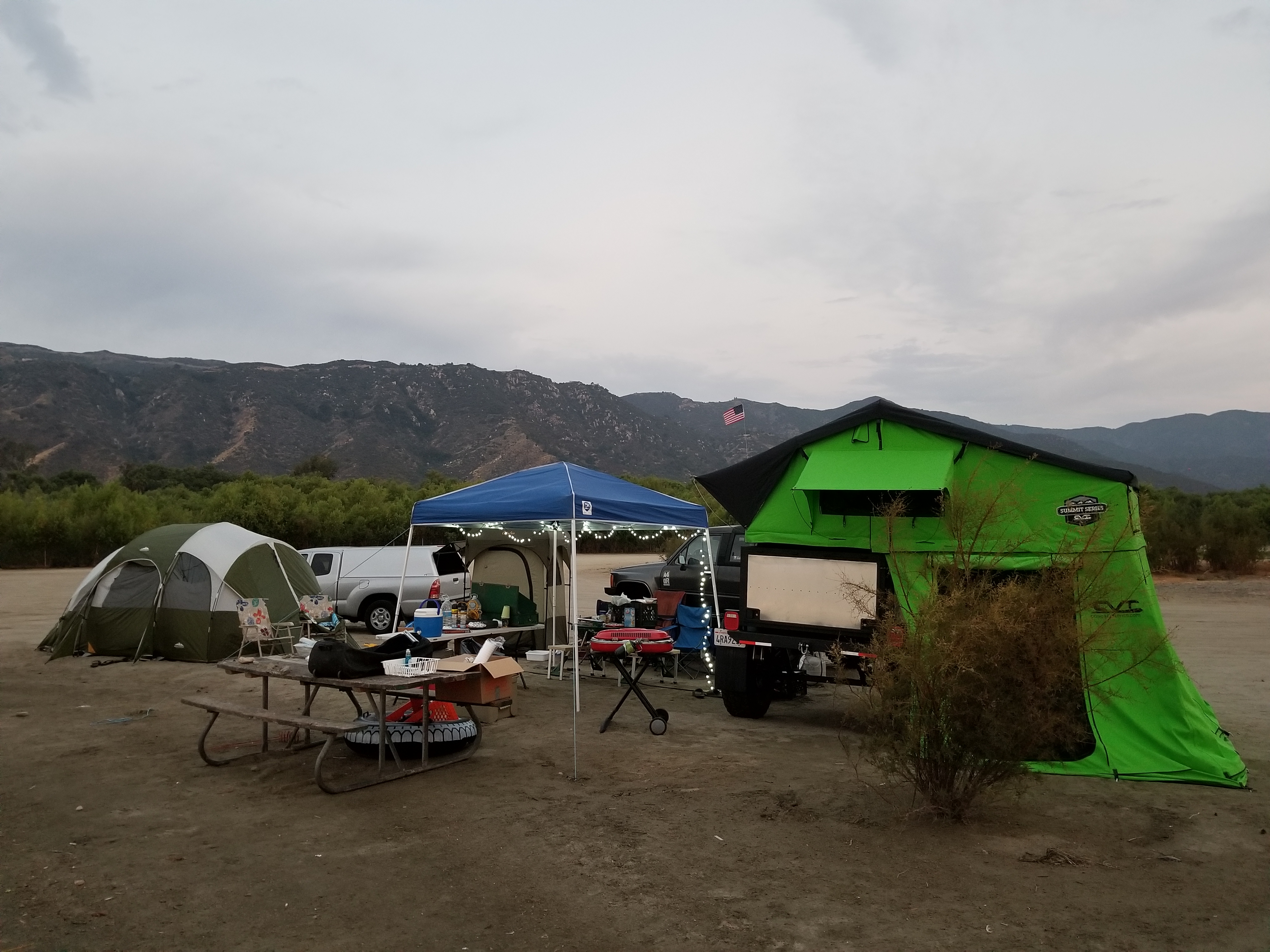

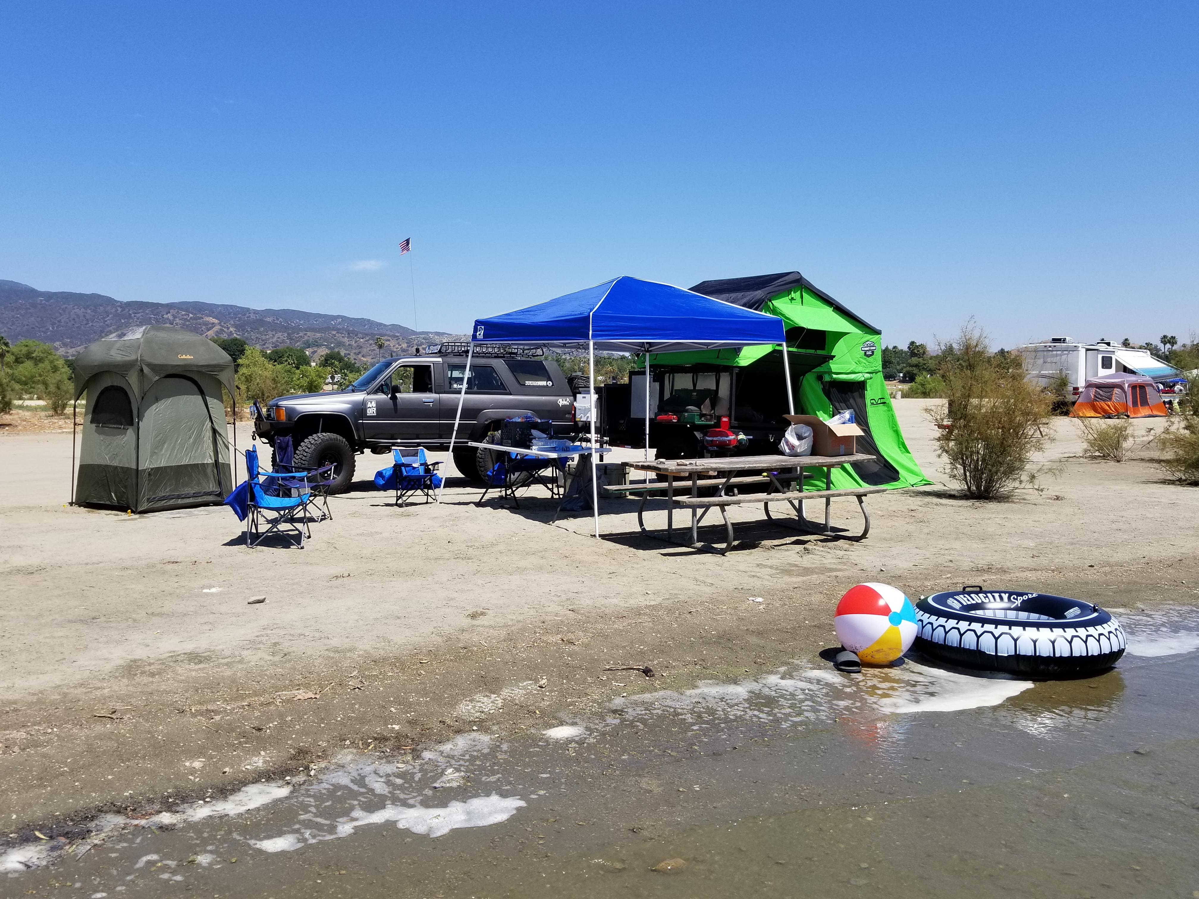

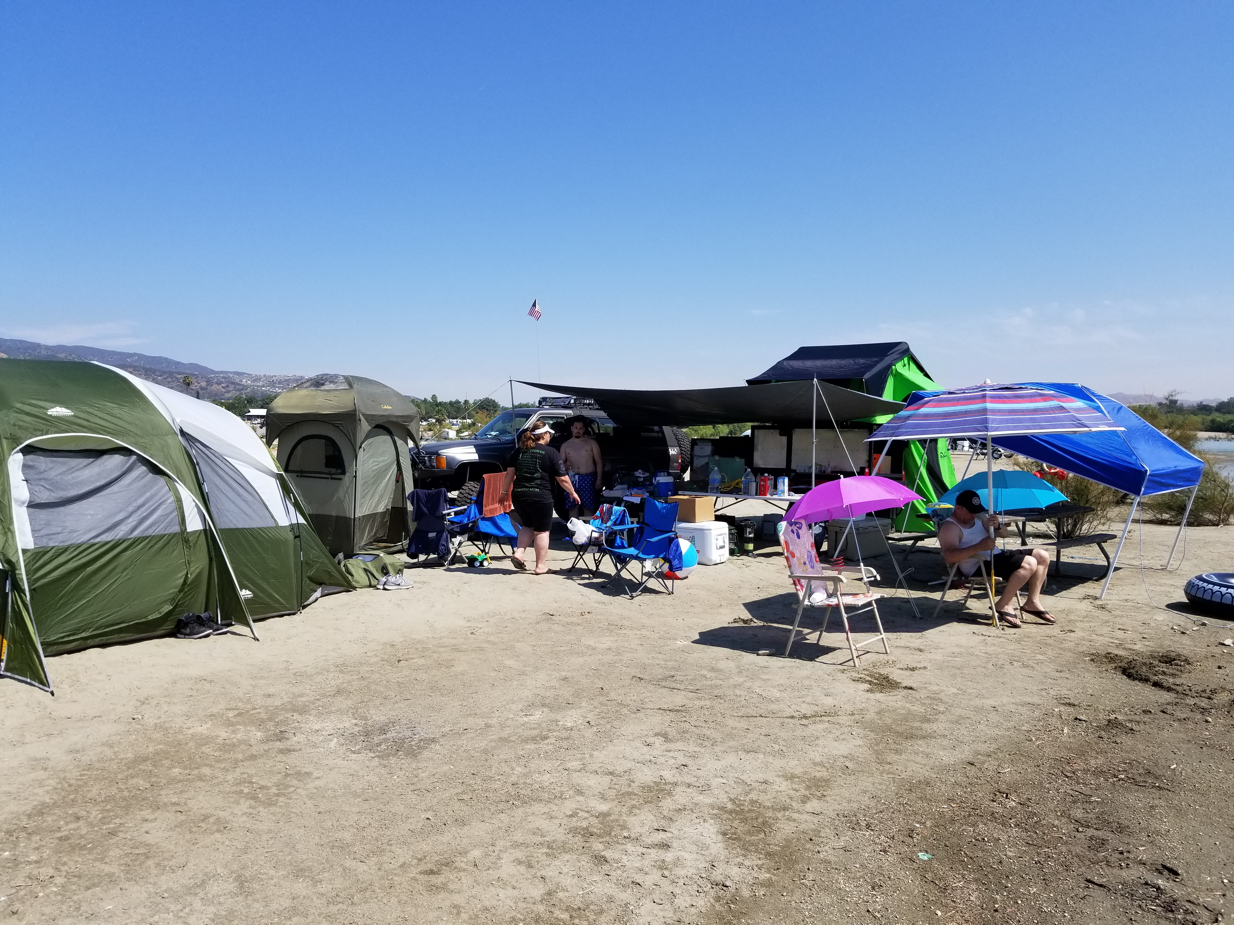

Since the last trip to Lake Elsinore we have taken a trip up to Angels crest national forest for a fun weekend trip of just dry camping with Chefyota4x4 and his girlfriend. This was back in Sepember 29th to October 1, 2017.
Here are the pix for that trip:

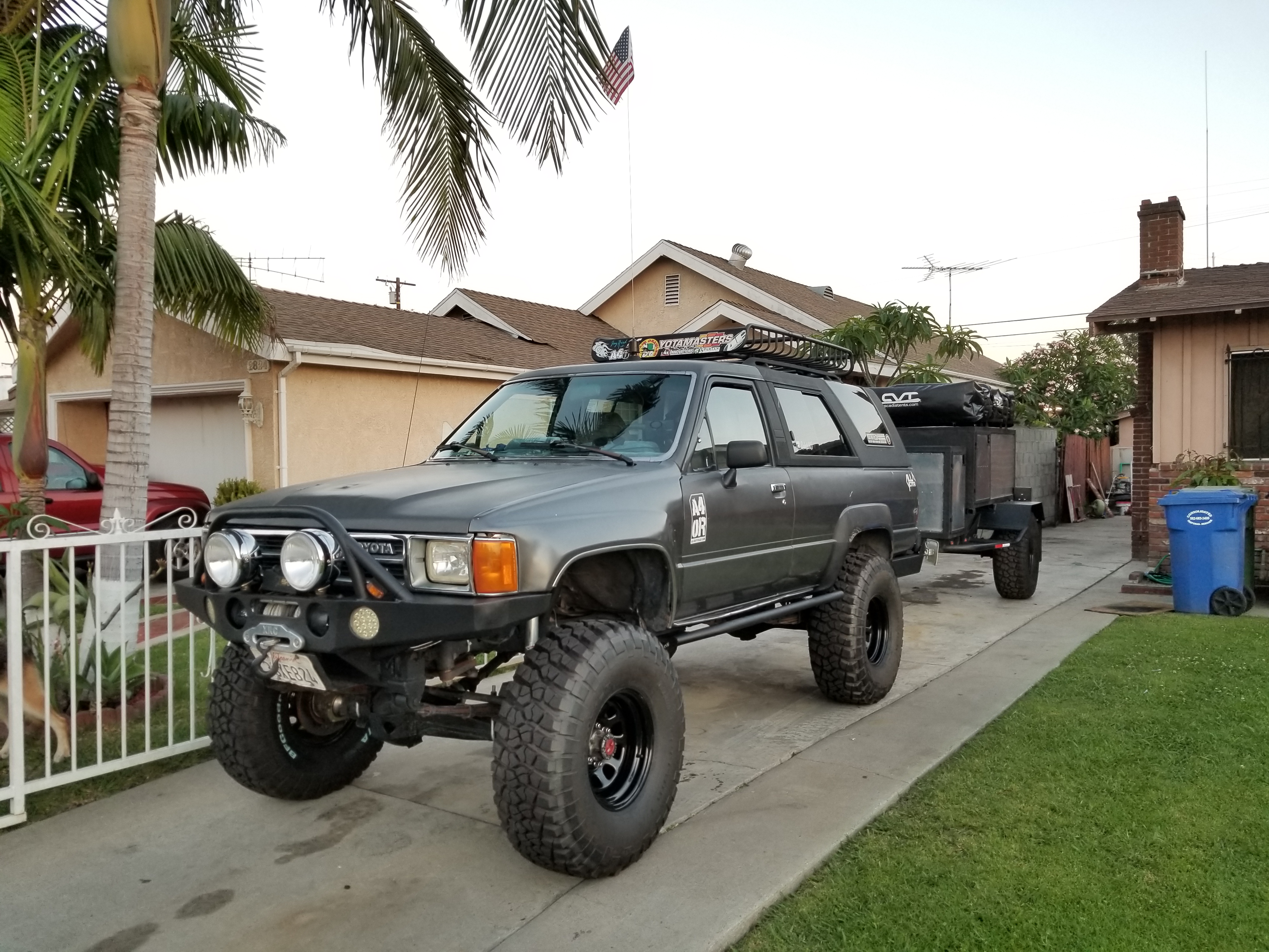

All packed and ready to go
Pix of our campsite
We had a really great campsite. Literally in between a few trees. The other spots were in very open terrain some with maybe only 1 tree. This one was definitely the best.
Mark (Chefyota4x4) and his lady arrived soon after we got there.
The pix of the tow rig with the trailer look great
This is actually the first trip i ever used my Propex heater with the trailer. The weather in the middle of the night pummeled on Saturday night. Luckily the heater worked like a charm. Out of everything on this trailer i was looking forward to testing out this weekend my Propex HS2000 forced air heater was the main thing i was excited about. It turned our chilly cvt tent into a toasty sauna. lol i had to mess with the thermostat quite a bit to find a comfortable temperature. I'm happy it works as good as it did and it is extremely battery efficient; The battery voltage only went from about 12.76v to 12.36v after an entire night of running off of just one of my two batteries. That's hella good! My 2nd battery went from about 12.80v to 12.40v after running exterior LED christmas lighting and running the water pump for 3 showers. That's not bad either. Once i have the solar panel/charge controller rigged up with the 7pole trailer (+) battery charge wire connected my battery bank should be more than efficient to be a self sustained solar/battery storage bank.
Here you can see how i routed the heater duct into the CVT tent through the foldable joint where the tent opens and closes. Also that black thing with the dial is the thermostat. I need to buy some more ducting because this one is only a hot air duct for blowing air in to the tent. The Thermostat can not fully work properly unless i route a air return leading back to the heater unit so the thermostat knows it has reached the desired temperature.
Here you can see that black duct routed into the tent from the bottom side of that window
.....Also as you you can see i desperately need to add a neat battery storage and keep it all enclosed within the trailer. For this trip i just rested the propex heater on top the the trailer tongue but that is a very expensive unit to have out in the open just like that. Same with the dual blue top optima batteries. each is about 250 a piece.
How 'bout them @all4offroad flex rock lights. I love how bright these 4 pairs are. I cant wait to install 4 more pairs to the exterior surrounding the trailer. You can clearly see how bright these lights are under the truck. I'm sure they will provide just enough light for the immediate campground surrounding my trailer. On a side note the interior LED light that comes inside of this Summit Series CVT tents is awesome. i love how it gets that green glow when you see it from the outside.
Either way if those All4OffRoad lights do not end up being enough light i always have these warm LED Christmas lights to use. And Since this trip i have bought another set of these same Christmas lights to add on to the camp lighting. By having a 2nd one i can daisy chain the lights to the portable shower/restroom for using it in the middle of the night
Playing in the ice cold creek
Kicking it at Mark's camp spot

I got the last of my electrical parts shipped this weekend. Now it's time to figure out how to wire everything up. I gotta research what order to do this breaker, master on/off switch, and switch panel. I have 8 switches on there and I ordered 10 relays for each switch and ill have 2 left over.
I have my 100watt solar panel on the roof and wires for it are already routed into the cab. Also have a 12v wire coming from my 7 pole trailer harness as an AUX charging wire that i gotta figure out how to integrate into all of this.
Here is a list of items that I'd like to wire up to this switch panel.
1) 1GPM water pump
2) Propex HeatSource HS2000 forced air propane heater.
3) Driver side LEDs ×3 (where the majority of my camp stuff sets up)
4) Passenger side LED ×1
5) Rear LEDs ×2
6) Front LED ×1
7) Rock lights (Undercarriage lighting) ×3
8 ) Free for something i may want to add for future use.
And on top of all that I have a wireless relay with two keychain Remotes by SuperBrightLEDs.com that I'd like to hook all of those exterior lights up to as well. So we can turn on & off the lights from the inside of our Rooftop tent incase we hear something in our campsite in the middle of the night. But that may be overkill right there.
By the way feel free to share videos or diagrams showing how to properly wire this stuff up. That'll help me out a ton. Thanks!
All the electrical stuff. Plus that wireless relay with 2 remotes at the center bottom of the pic.
My battery bank
I've had this inverter for a few years now. I use it to run a small 3 gallon air compressor when i go offroad. I didnt wanna have to buy another one for the trailer so this is what i plan to use 3000 watt inverter. I believe it is 6000 peak watts. I may need to use a smaller inverter though. I have been told that the bigger the inverter the more power draw you have when you arent using it. Or something like you get less power draw for lets say charging a phone or using the outlet for a light when using a smaller inverter vs something huge like this one. We will see. I'm open to suggestions
Cool thing about this one is that it has a remote on and off switch that can be mounted to my electrical panel too.
12v 1gpm water pump. Pumps at 60psi. Enough to have the correct water pressure to use with my EccoTemp water heater for my shower set up
Propex Heatsource HS2000 force air propane heater. The black thing on the bottom is the thermostat.
Hot air out and return.
All4OffRoad LED rock lights that I'll be using for lighting the undercarriage and around the entire trailer.
Just wanted to show how bright those LEDs are. I used those same lights underneath my truck. So this gives you an idea of how bright they are in the middle of the night
And i also need to figure out a way to incorporate this 12v aux wire coming off the 7 pole trailer harness.
So rather then buy the SUPER NICE Cable gland like i used for the solar panel wires. I went this much cheaper one from Home depot. Only this one is for electrical conduit but it works just fine. The rubber piece inside tightens on the cable as you screw the head and still creates a water tight seal. Only difference is that i used a 1/2" one instead of this 3/4". I passed the 12v wire in front the bottom side of the cab since thats where all the 7pole harness wires are at. then i siliconed around the cable gland underneath and on the inside portion to add on to the water tight seal. This baby only costed me about 2 bucks.
Here is a video of that gland taken apart.
and in prepping for all the interior electrical stuff i decided to add a couple of feet of wire to the solar panel wires tyo have it ready for when i hook everything up.
