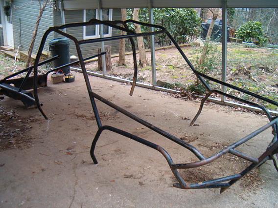

The cage was made for a mid 80's toyota without a bed. I need to make this fit my 88' 4runner.

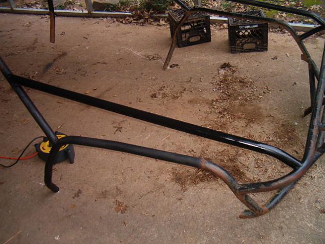

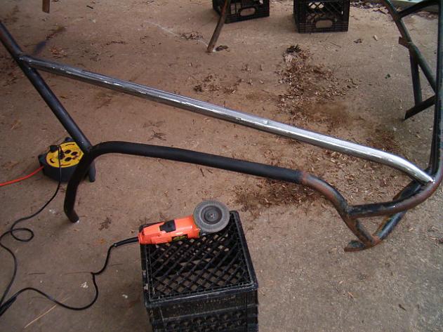

I started chopping up the rear of the cage.
Attached Thumbnails Project Budget Exocage-hpim1789.jpg   Project Budget Exocage-hpim1790.jpg   Project Budget Exocage-hpim1791.jpg

Now to start on the surface rust.

Might want to consider a cowl bar for some support up front.
And some gussets...
I'm surprised it didn't have one. I have to find some more tubing for that.

Originally Posted by 89silverpu
And some gussets...
Everywhere? Or which spots? I've never built one.
Any other suggestions would be great! Anyone know a good tubing distributor?
