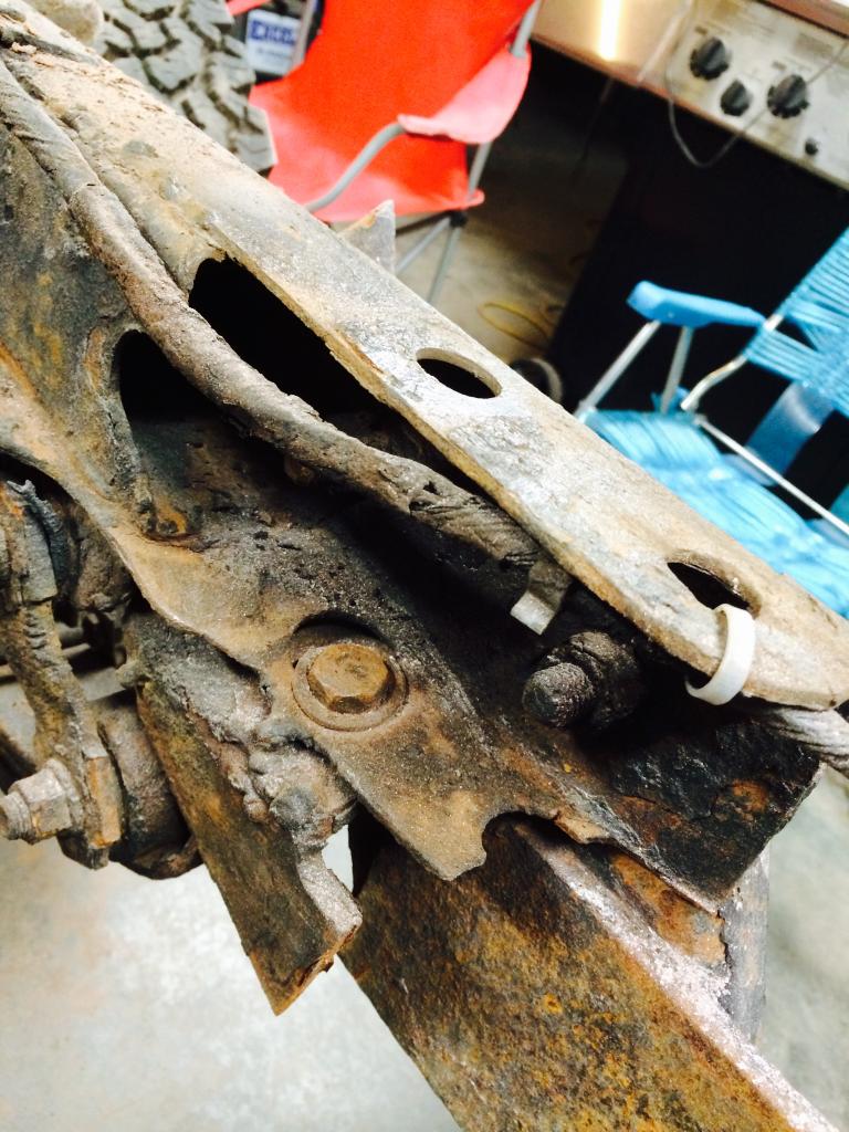

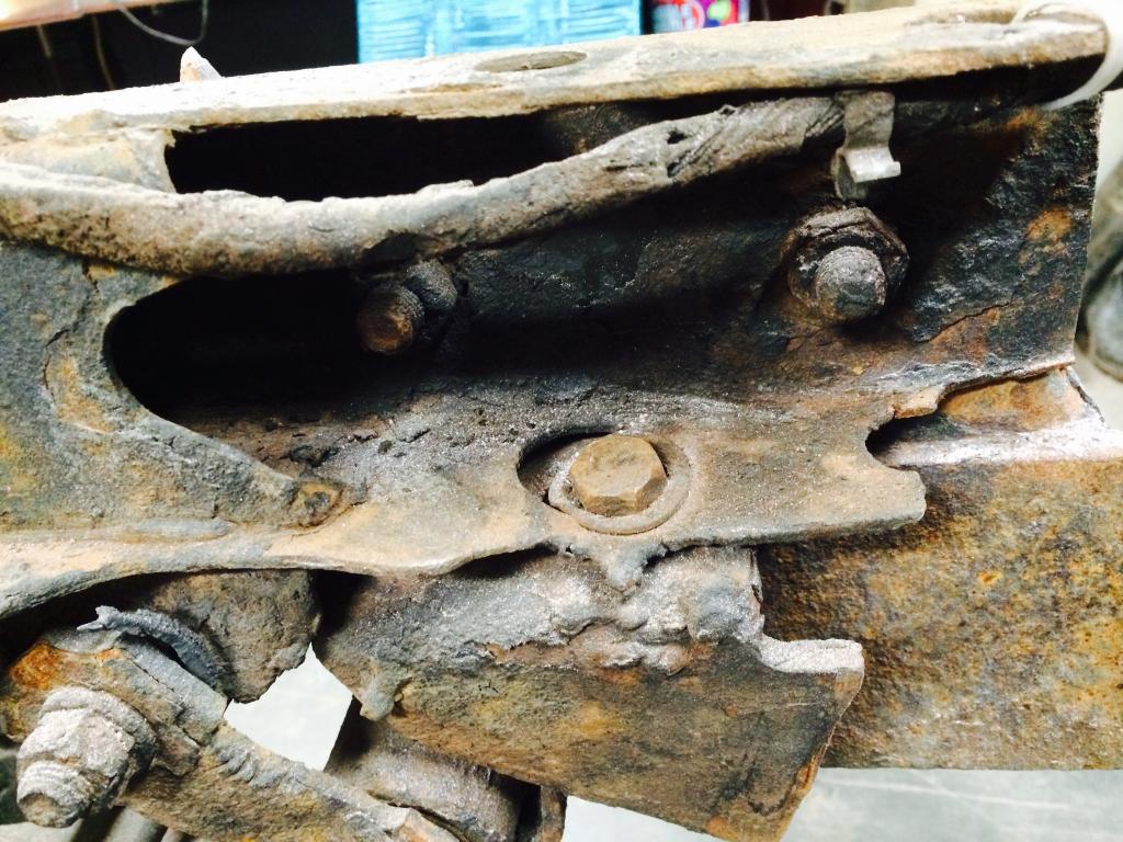

The frame will need to be repaired. It looks as if the old bolts that were once attached to the frame pulled through. I'm planning on boxing the end of the frame in then drilling holes so I can create my new hitch. I'll take a few pictures tonight when I get home from work so you can see what I have to work with.

i'd post up a couple pics of the damaged frame. most likely it sounds like your welder friend will be able to come up with something for you...and it will likely be a significantly stronger version too.

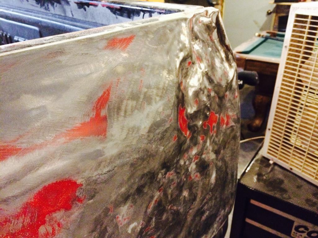

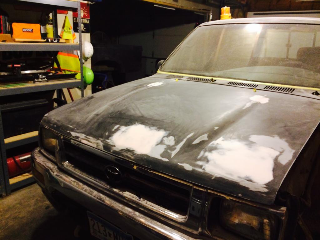

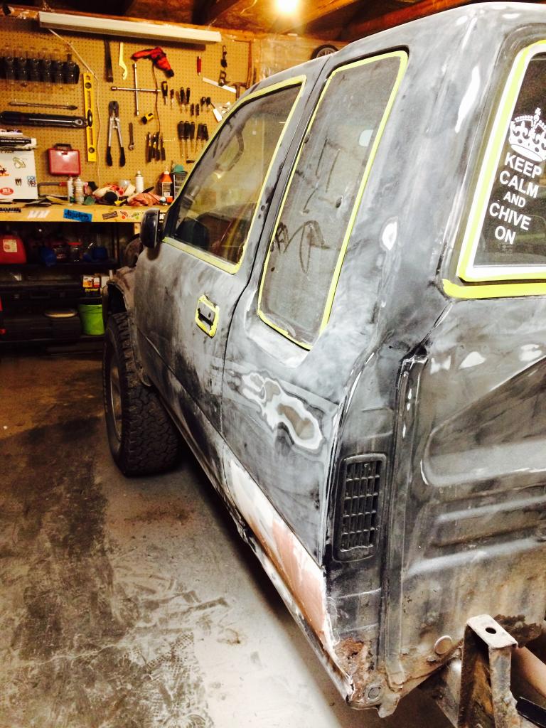

And here are some pics of the rest of the truck as she sits. Hopefully getting the rest of the body work done this weekend and all prepped to paint.
The picture of the box where it is extremely dented was covered by a 1/2 of bondo. Not looking forward to fixing that. The rest of the truck is pretty clean. discovered a little rust hole behind the cab.

The rest of the frame in good shape or does that need work as well??
I know welders who work production who really would be clueless how to build a hitch or fix your frame.

Well after some thinking today, i think i am going to do what Highonpottery suggested. As soon as I'm done wire wheeling the rear of the frame i am going to start drawing up some ideas of what i want it to look like. In the mean time, would any of you guys mind posting up a few pics of how you made your custom hitches? The rear bumper I'm going to keep simple and already have a good idea on what that is going to look like.
And to answer your question Wyoming9, The rest of the frame is in good condition surprisingly. Its covered in surface rust of course but i have yet to find a spot where its rotting out. Im going to get it all cleaned up starting in the rear and working my way up then put some por15 down with some raptor liner over that.

You have done the hammer test on both sides of the frame the worst parts are where the drain holes get blocked right by the spring hangers.Not that I doubt your word but just going on what I see from the back.
Most receiver hitches unless it is for something really off the wall Like when building one for a 1000 HP pulling truck look pretty much just like what you would see on any vehicle going down the road.
It comes down to just what materials one decides to use I have made them from all types.
Like was said if your building a bumper just include the receiver in the bumper as most of the commercial hitches attach the same place as the bumper brackets
