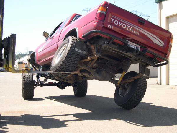

Pics
Here are a couple more. I'll see what else I can drag up. Most are on another PC and my network isn't right now.... These are actually old pics the shocks were limiting, and there is more travel in the back end with new rear 64" chev springs, and new bump stops.
Attached Thumbnails I've got a new cheaper plan!-dscn0505.jpg   I've got a new cheaper plan!-dscn0526.jpg   I've got a new cheaper plan!-dscn0525.jpg
