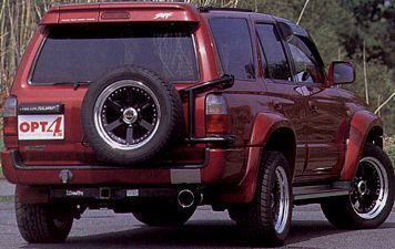

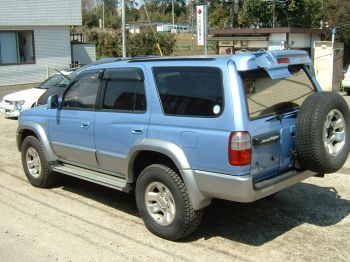

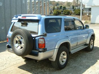

here's some more pics of the JDM version.
Attached Thumbnails I want a tire carrier..... help-zzzz1.jpg   I want a tire carrier..... help-zzzz2.jpg   I want a tire carrier..... help-zzzz5.jpg

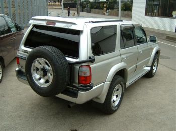

one more-
