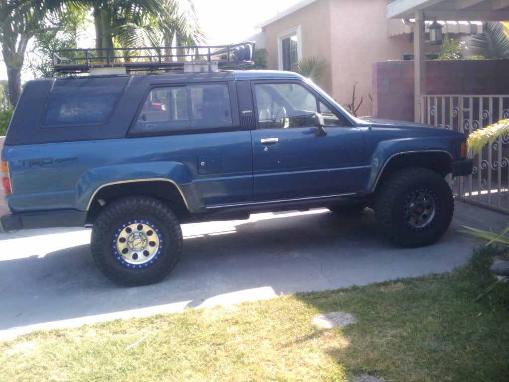

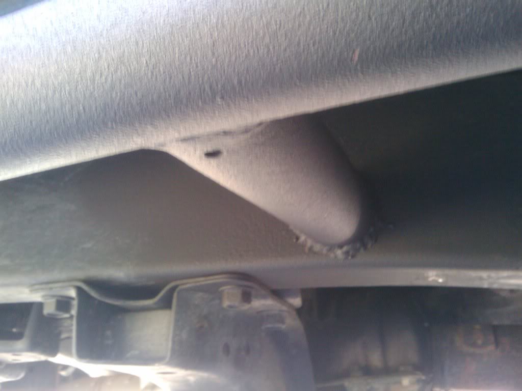

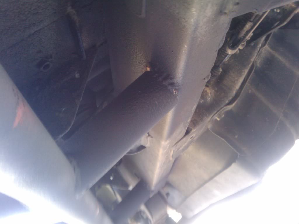

I just got a set of TG rock sliders and I think they are a good bang for your buck.
Here are some pics
From the side you can hardly see them

I would definitely plate the frame at your mounting points. A square plate on diamond is common practice 3/16-1/4.
