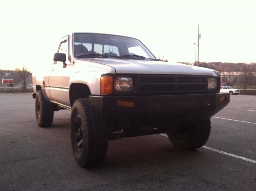

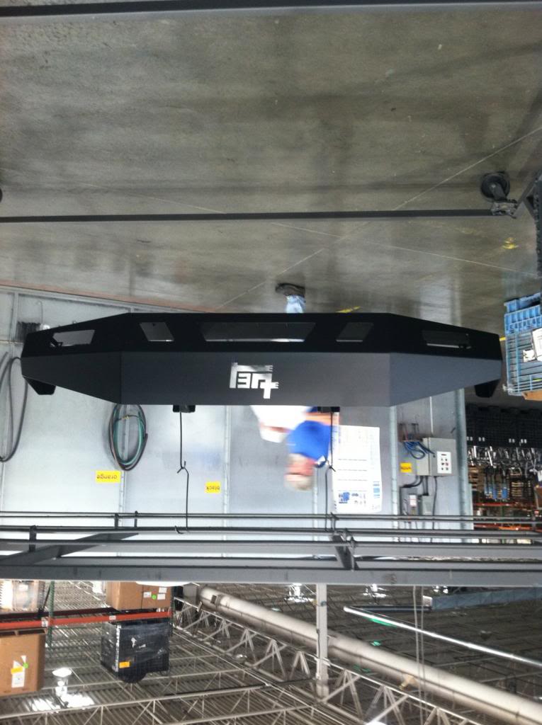

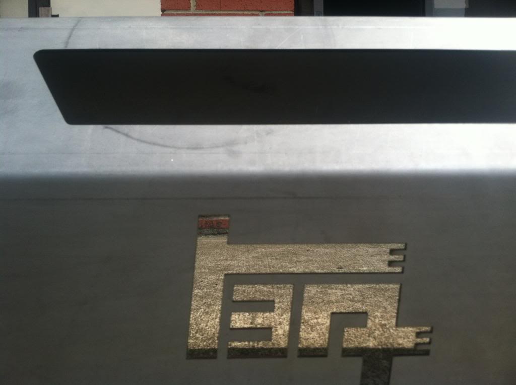

I unfortunately do not have many pictures from the build but I will post my work. I started with my custom billet shift knobs (in the vendor classifieds) and from there wanted to make a bumper. I wanted a step bumper that was aggressive with a off road look also and this is what I came up with:

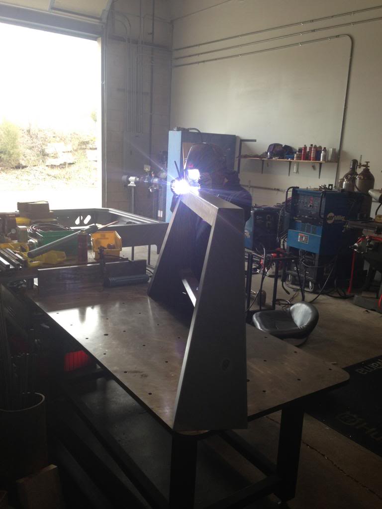

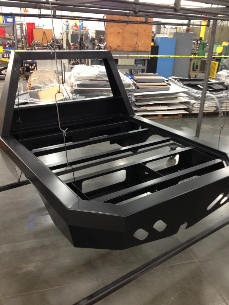

After this I wanted to do a back bumper but thought with all the rust issues on my stock bed I might as well go ahead and do a whole bed!

I think you may have just given TOYOSPEARO some stiff competition for best flatbed. looks awesome!!!

Thanks for all the input! I tried to make it functional and look good at the same time. All of it is black powder coated, the bumper has stainless steel mesh and the "TEQ" logo laser cut out. The flat bed obviously has the aluminum diamond plate and I added stainless steel tie down hooks. Speaking of this I was wondering if anybody knew where I could get a net with bungee cords to keep stuff held down when I'm off roading. I am also going to re locate the spare tire and make my own hitch assembly with either a swiveling tow loop or something like smittybuilts step hitch! I even put silicone between the diamond plate and the bed frame to reduce rattle and harmonics at high highway speeds. I really tried to take my time and make this last and be the most functional.

looks niceand very utilitarian. for the color i would leave it alone unless it's blinding you from the glare. might tone down slightly with time/scratches like a truckbox does. if you were to paint it, i'd go the color of your body vs black, since the contrast looks better IMO. maybe even a matte clear coat would work?
you can usually get those bungee nets at any store that carries bungee cords or truck accessories. heck, I think even Home Depot carries them.
for your spare tire, i would personally mount the spare vertically on the front, side of the flatbed, facing outward. Think old chevy stepside pickup. I've never been a fan of making a nice flatbed and plopping the spare smack in the middle. You could make a simple mount that bolts on to your flatbed with tapped holes, so it can easily be removed for full flatbed access. You could even make another mount opposite it for holding something else, like gas cans or ice chest, etc - and it still leaves you with around 3-4ft of flatbed space between them.
question - how much space is underneath the diamond plate top, to the frame? seems like a good amount of room and you should probably integrate hinges into the diamond plate so you can have cubby storage for tools and recovery gear.

there is a solid 8 inches between the 2 so i think this is a valid option

I was never a big fan of converting pickups into flatbeds but I must say, you have changed my attitude in that mind set....I like it! Outstanding welding skills you have there, good job.
