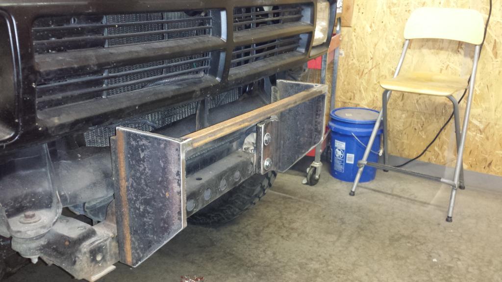

This is mine. But by reading and searching I find allot of folks on here beef up the front cross member.
By the way mine is all custom. So may not be much help.

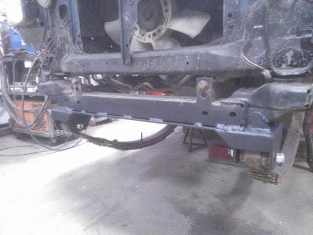

The front crossmember of the early IFS frames and the SA frames are the same up till 95ish (in the US anyway, not sure where you are.) They attach by the 4/6 holes in the front of the cross member.
Like mentioned above the front of the frames are weak, and if you plan to do any winching, plating the frame would be a good idea to stop the nuts from pulling out under load.
Got pictures of the bumper your trying to mount?
Heres the front of my frame, braced with a 4xinnovations brace and a Sky front leaf hanger.
