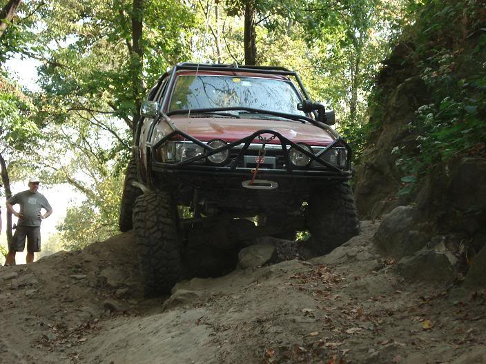

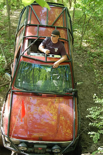

Im one of the few who have exoed a full body and kept it a full body (doors, glass...)
For the kind of trails I run, not only does it protect the body but with out it I would get stuck. One day on some of the black trails @ the Cliffs would peel off my body and the cage lets me slide along the walls and pivot around trees and even use the cage to stabilize the truck by leaning it on a tree. So its not just protection.

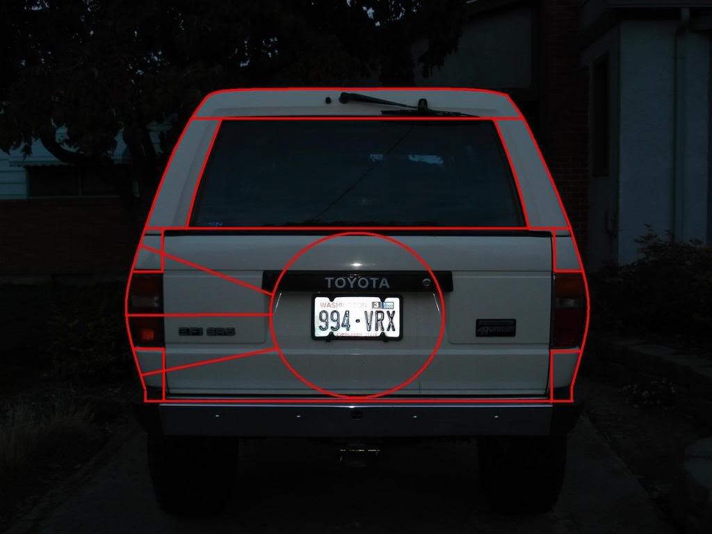

4banger444's Avatar
Joined: Aug 2007
Posts: 115
From: Washington

Looks pretty good. remember to do some triangulating over the roof.
For the above mentioned reasons, an exo is great.

Don't forget to ben the bar up over the hood so that your wipers can move and don't forget some 45 degree reinforcements around the bars where the windshield opening is.
