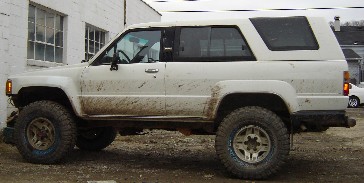

Here is a pic with the MTRs on. 2 inches clears them nicely.

Wow! That's a big difference! Looks great!
How do those 33's do stuffing in the wheelwells? I'll try to stop by next week.

I have had it pretty twisted and it didn't seem to rub. My elocker is now an espool so it wheels pretty well.

Are those 33" x 12.5" MTRs???? I didn't think you could safely mount a 12.5" tire on the stock 7" aluminum rim.

I think 7" wheels with 12.5's will give you odd treadwear on the road if you aren't religious about rotating them. My 15x8's might be on the block (I'd like to move to 17's at some point)
