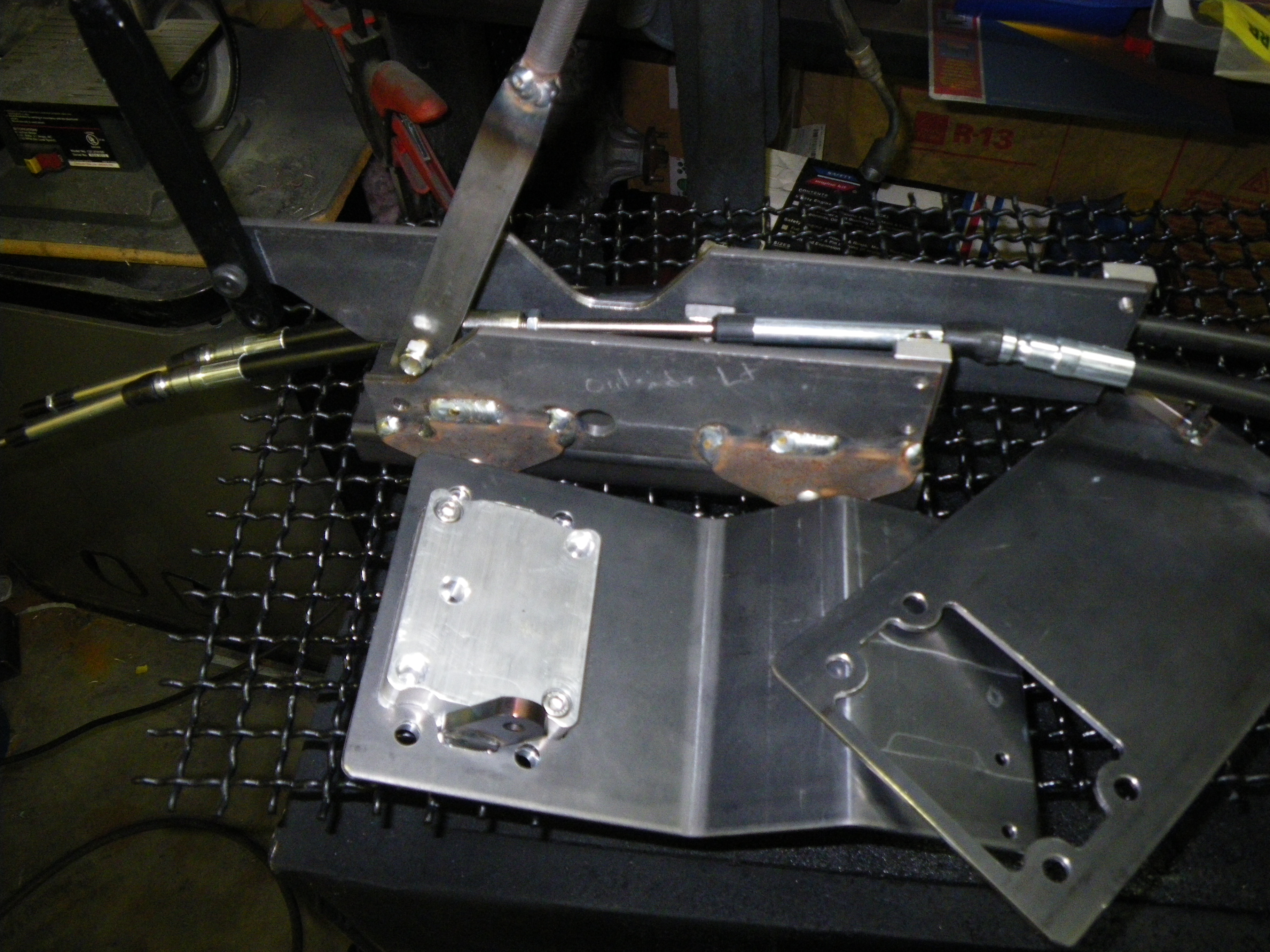

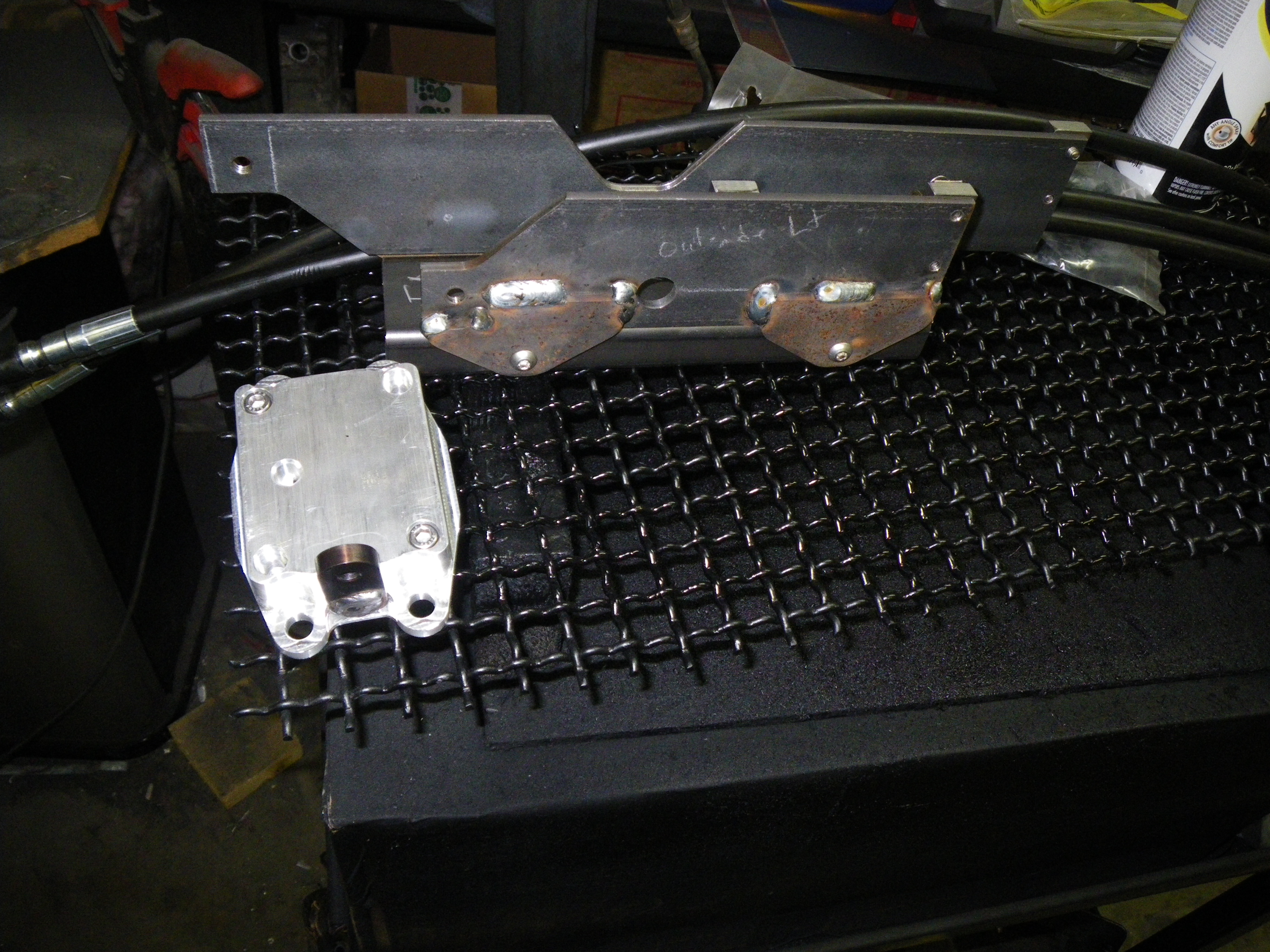

Been wanting to do a Cable Triple Stick setup in my truck. Been building parts but I'm not sure if it will all fit, well without a bunch more hacking the floor anyway. Not that that has stopped me before. The point of this is that the levers will be mounted basically in a straight line front to back. Trying to fit them between the seats with the Winters Modified shifter I want to run.
Heres most of all the brackets, cable and such.

So for a minute this weekend I was not seeing the light, then I had one of those Ah Ha monents. Here is what it's looking like now. Still I have way too much work into this, but man will it be nice when I get this finished.

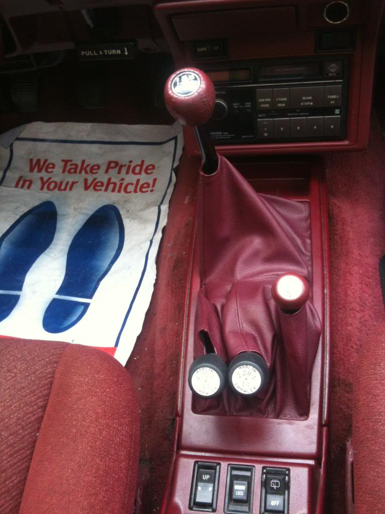

here is what I came up with
[IMG][/IMG]
and here it is once it was installed
it all fits with no body lift!

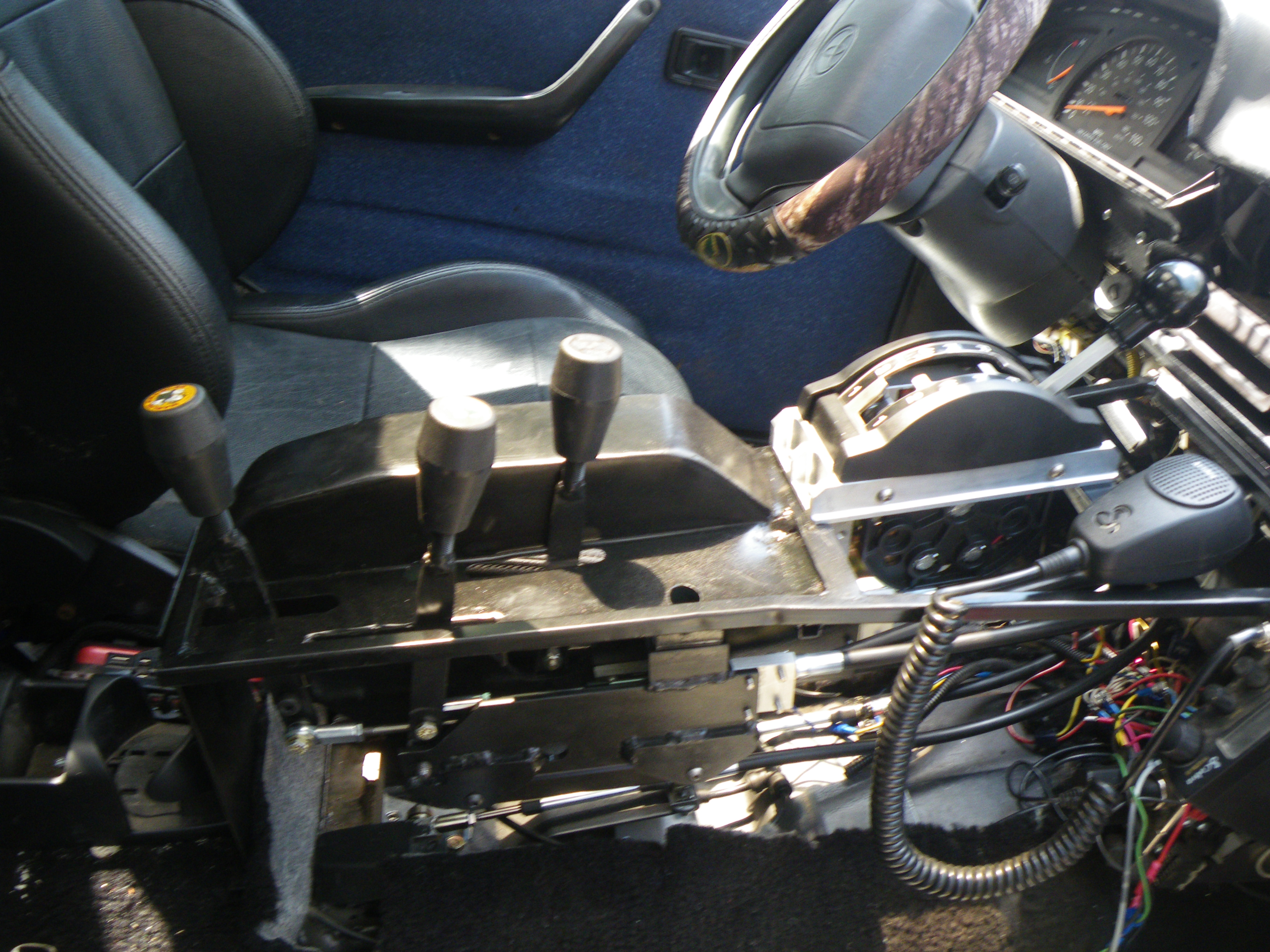

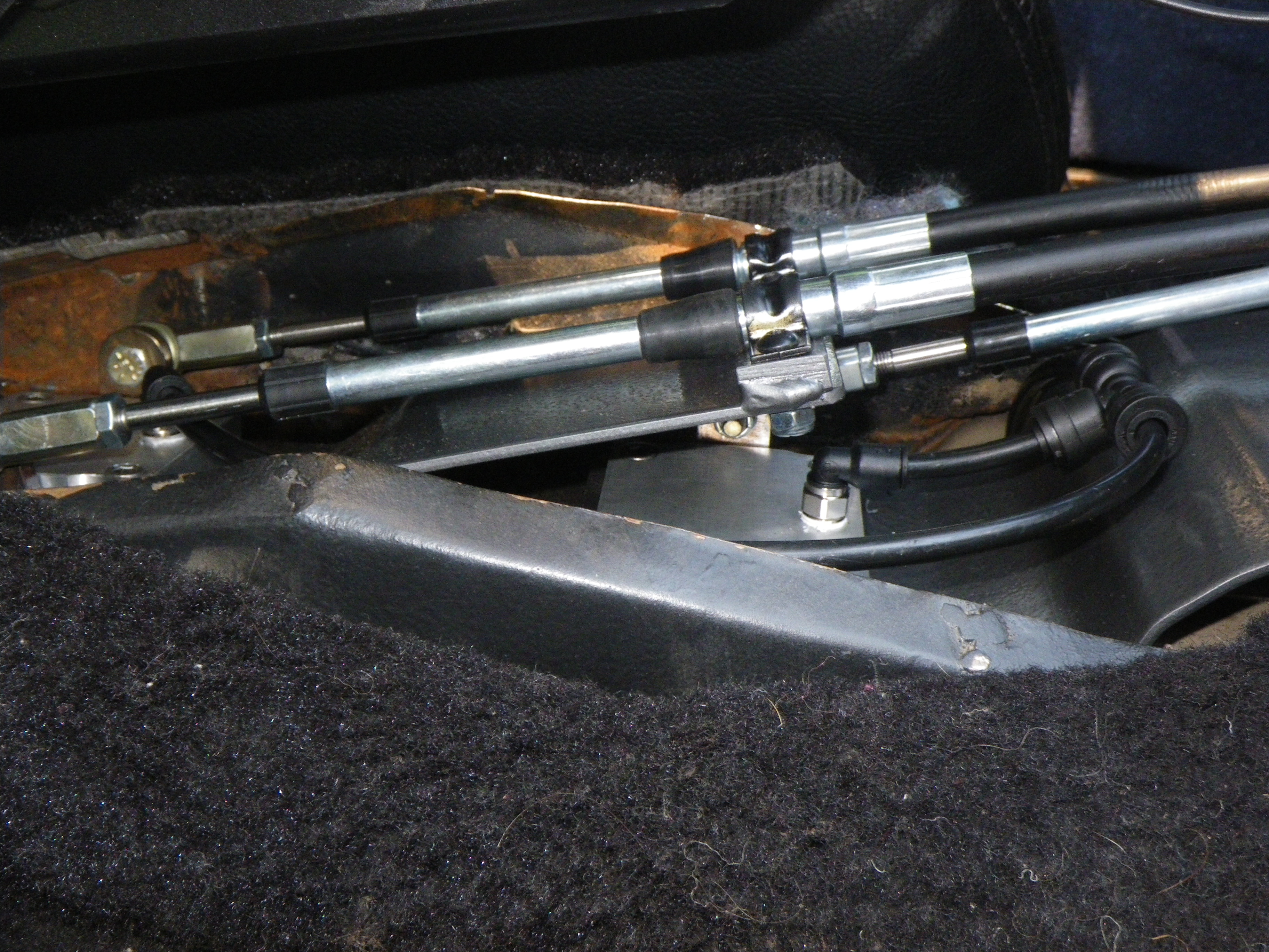

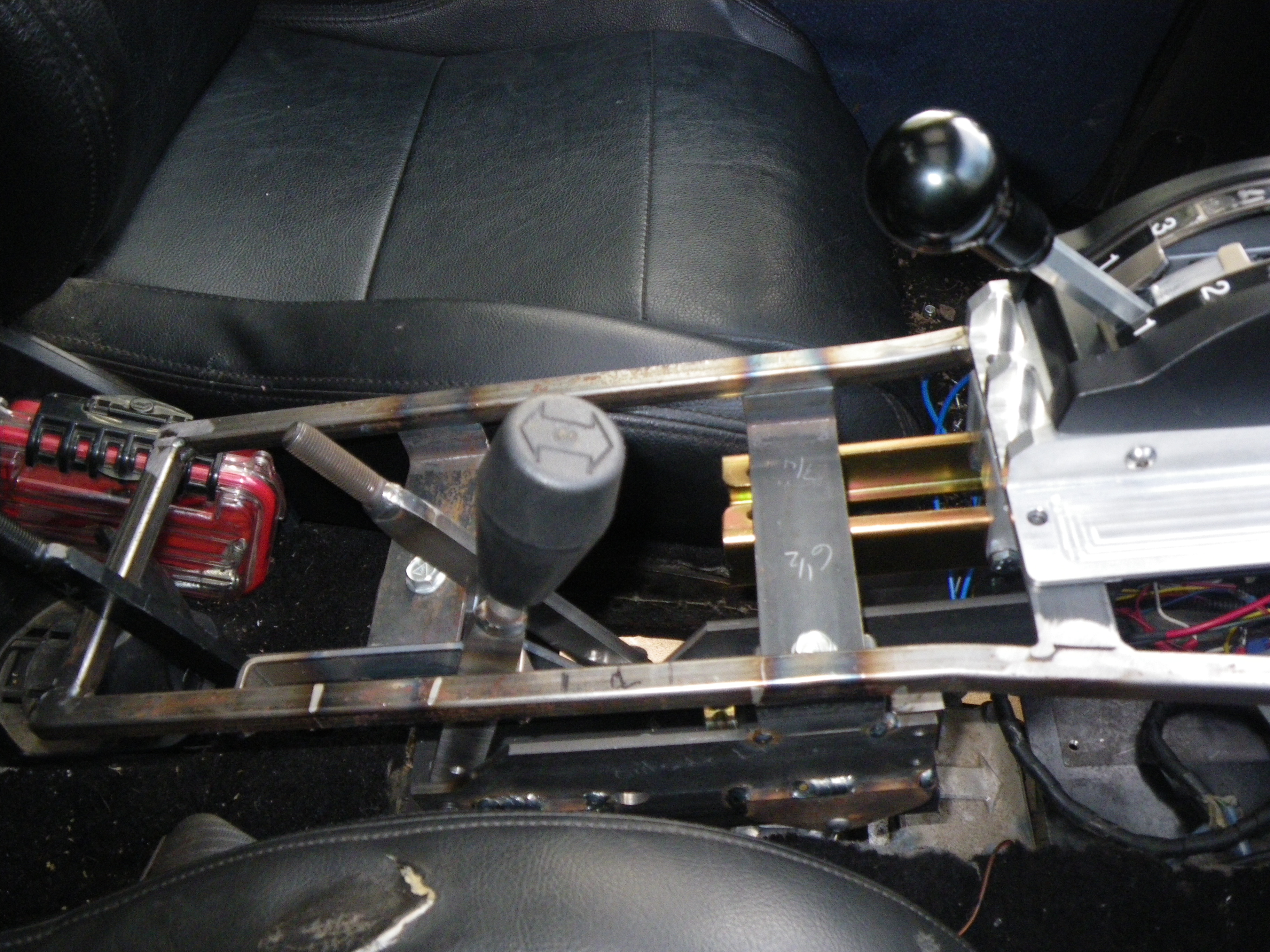

Well it's all installed, still a bunch of finish work to do but it works and what a pain to put together.

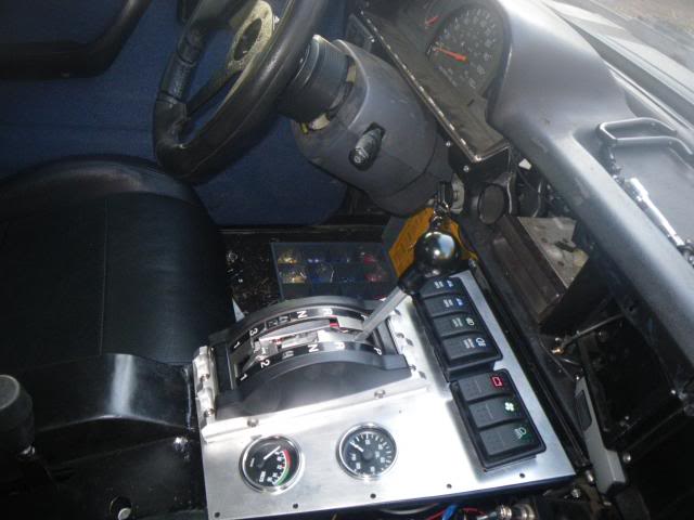

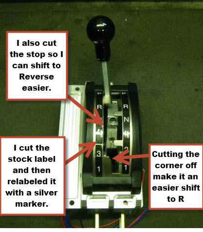

Winters shifter with modified gates for quicker FWD to Reverse shifting as well as custom switches for the solenoids, no TCM needed..................

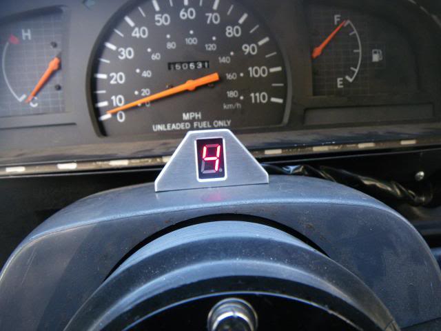

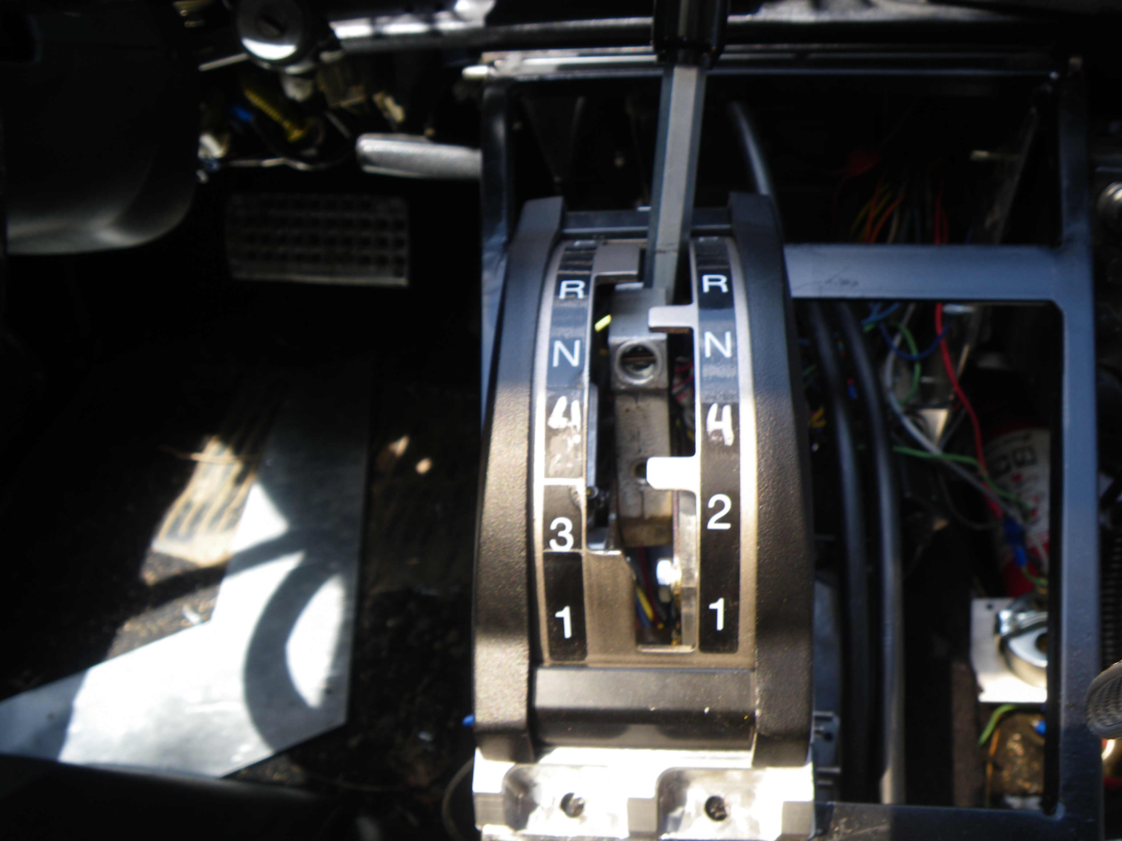

Console buttoned up, tank full of gas, switches wired, Winters shifter with custom switch kit active and a new little doodad, a LED gear display for 1 thru 4. Still have the USB and AUX power units to be installed. I need a custom machine aluminum bezel for them of course. Then I need to attack the dash were the heater controls were.
