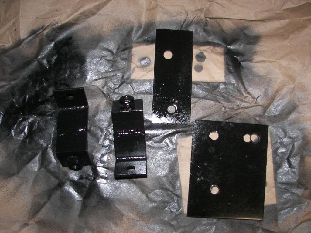

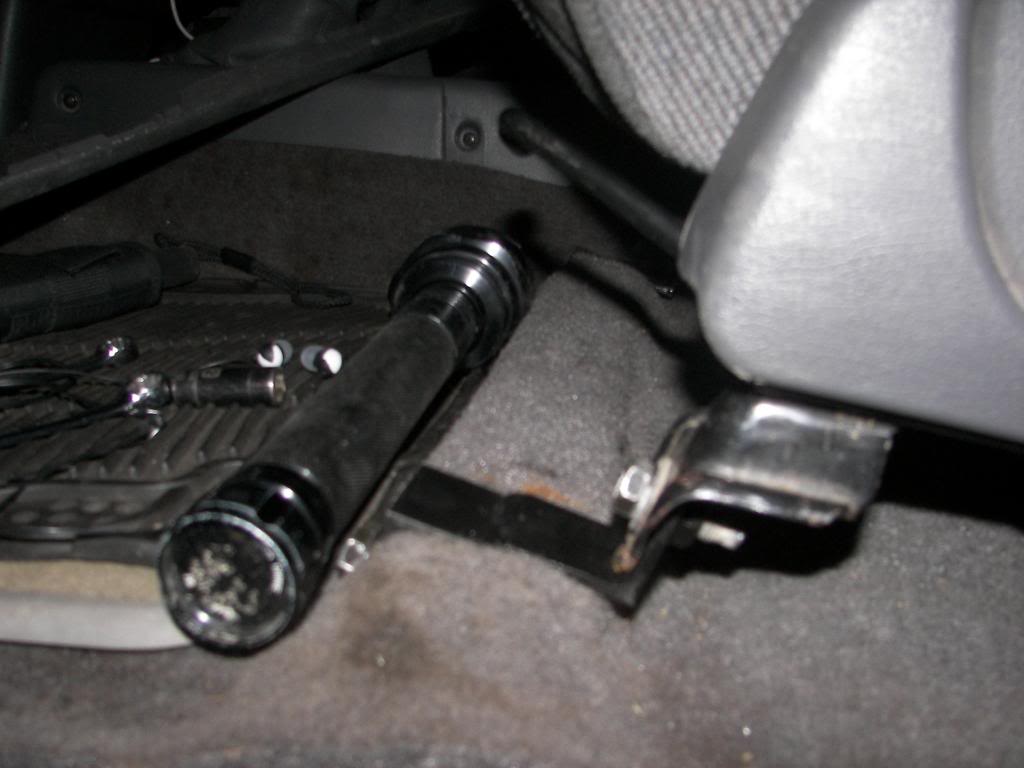

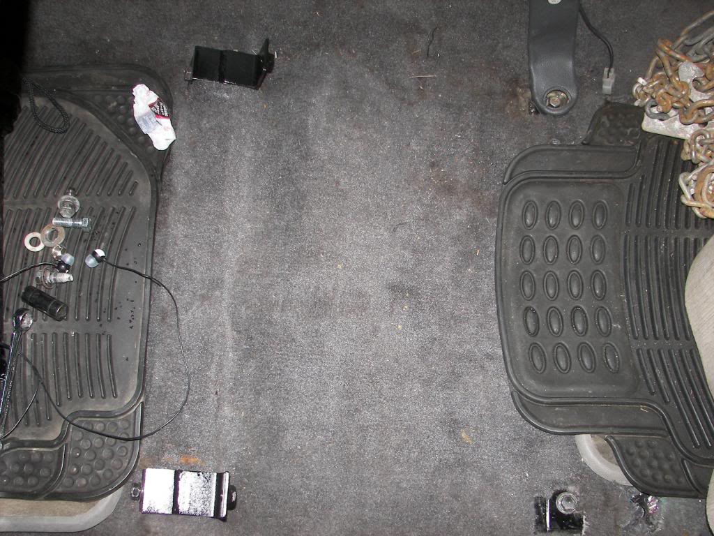

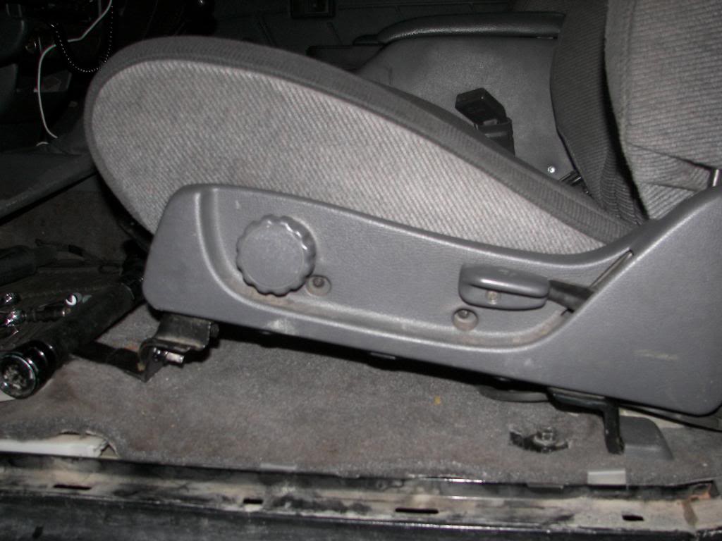

so I finally made some brackets! heres what I did.
the extra 4" make all the difference in the world!
