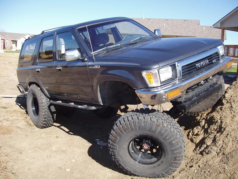

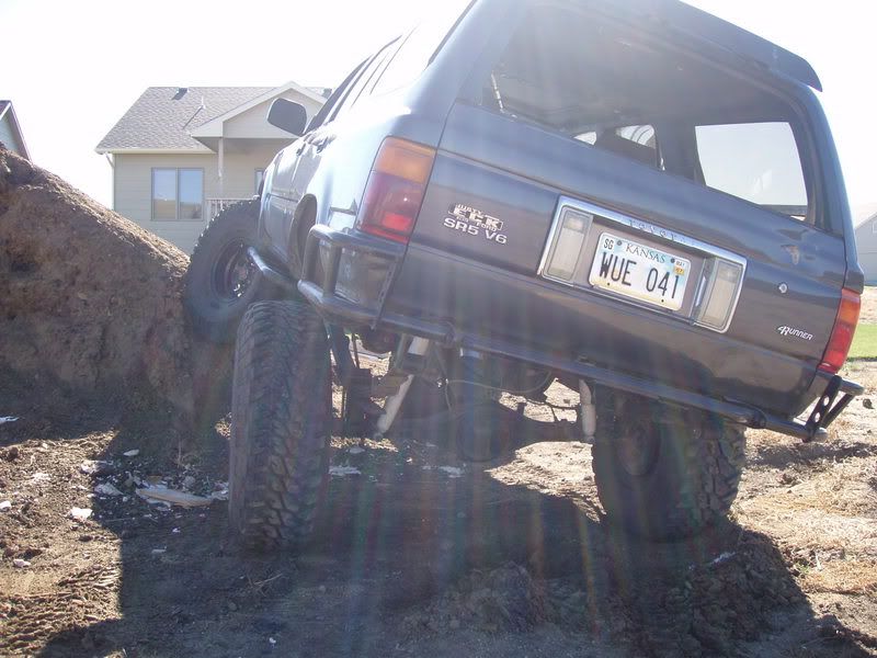

Here are some flex pics taken behind a neighbors house, we don't have any hills around here
Not much room around the tire

Good job on your build. As other have posted, those front shackles look pretty rough. Glad you are taking care of it. I noticed in the 3rd pic you're still missing your front D-shaft, gonna get a long travel slip yoke?

Looks pretty good, with a propper shackle angle up fron you could get that front to drop a lot further... and if you remove the 3" block in the rear your going to need bumpstops for sure... But bumpstops are a good thing as they actually help flex. It also looks like your shocks are limiting the rear drown travel....

here is a shot of the rear spring compressed, looks bottomed out to me. Hell...... it might be bottomed out too. I need to run the numbers on the shocks.
