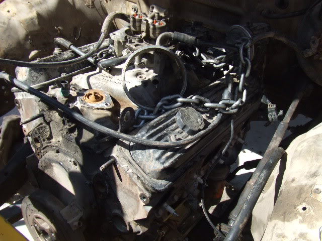

I went with northwest offroad motor mounts for the 350 Also a th350-205 combo Here are some I did in a toy I built for a guy a few weeks ago.

The install is actuall pretty easy. You just have to cool it. Spend the money and get the right parts the first time. If you use an old corvette water pump you gain another 1" roughly. But you need to get brackets to match for the alternator and p/s pump. Or just make yours.
I am building another one with a 4.3 right now. If you check out my build it has more pics.
