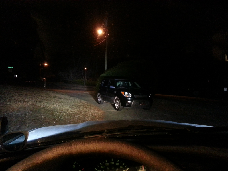

Really not much, these are spots so the beam isn't super wide. I also doesn't hurt that my paint is pretty well faded so theres not much if any gloss.
I can post night pics when the sun goes down.

Just the spots
With the high beams
Glare's not bad at all but also I've got that super cherry paintjob so, you know..
