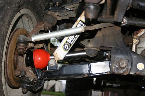

OK, got a chance to plug these buggers in!
The install is a little tougher than OE shafts as it is missing that 3" plunge of the tripod joint so we couldn't collapse the assembly as short as the stock set-up.
RCV did a beautiful job on them, they fit like they belong there and so far everything cycles just fine. We'll take them out for a spin this weekend and see what we see.
For those who didn't read the whole thread, things might look a little off as everything is 3-3/8" longer than OE to fit our Blazeland long travel kit.

Been running the RCV Toyota CV set-up in my 1986 Blazeland low buck LT equipped 4Runner since this spring and loving them. They are very smooth, much smoother than the one year old CVs they replaced. Driving down the road with hubs locked in the only vibration out of the front is the front driveshaft.
As far as abuse is concerned, we have wheeled this set-up quite a few times over the summer, including plenty of high throttle bouncing that would normally break the standard CVs.
A couple days ago we hit the Tahuya ORV area in WA. We did Yellowjacket hill, definitely tamer than the last time we were there, but still plenty capable of snapping CVs and we scurried right up it. We then played on another gnarly rock climb down the trail a little bit and finally ended up out on the rock garden. Next CV abuse trip will be down to Brown's camp TSF before winter sets in.

RCV first sent us the CV assemblies for stock suspension (the original prototypes) and they fit a stock rig just fine.
But obviously for a LT we needed center bars that were a little longer, so we installed just the inner and outer CVs, set the car at ride height and measured from edge of CV to edge of CV and had RCV build up a set of longer shafts and everything fit perfect.
