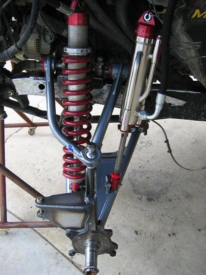

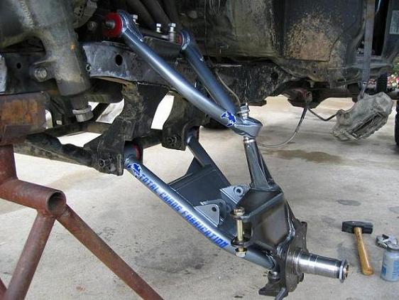

total chaos has built another great kit. its the 3rd generation kit for the 86-95 toyota 4wd pick up and 4runner chassis. this kit features a lift spindle and an extra inch of width per side over the gen. 2 kit. 4wd and torsion bars are no longer an option with this kit. this is more of a "race application" kit. construction is all 4130 chromolly and powder coated very nicely. the arms are 4.5" wider per side and the spindle adds amost 1 more inch per side. so its basically 5.5" wider per side. wheel travel is very near 15" and cycles very cleanly.
after some race testing on my truck this kit will be made availible to the public. so call nicole and tell her you want to order your own "Helter Skelter" kit

MMmmmm sexy
Special backspacing required for the wheels?

nope, any stardard 15" wheel will work. ill be running a normal 15x8 AR-23 wheel.

Looks good, but it's easy to get travel without axles.
Most of teh guys on here won't want to spend that kind of coin to lose thier front drivetrain. You got me excited fro a second too, thinking it had new 4x4 spindles.

like i said this is more of a race kit. you dont need 4wd to go fast. and the gen 2 kit is still there for the guys that want to retain 4wd.
